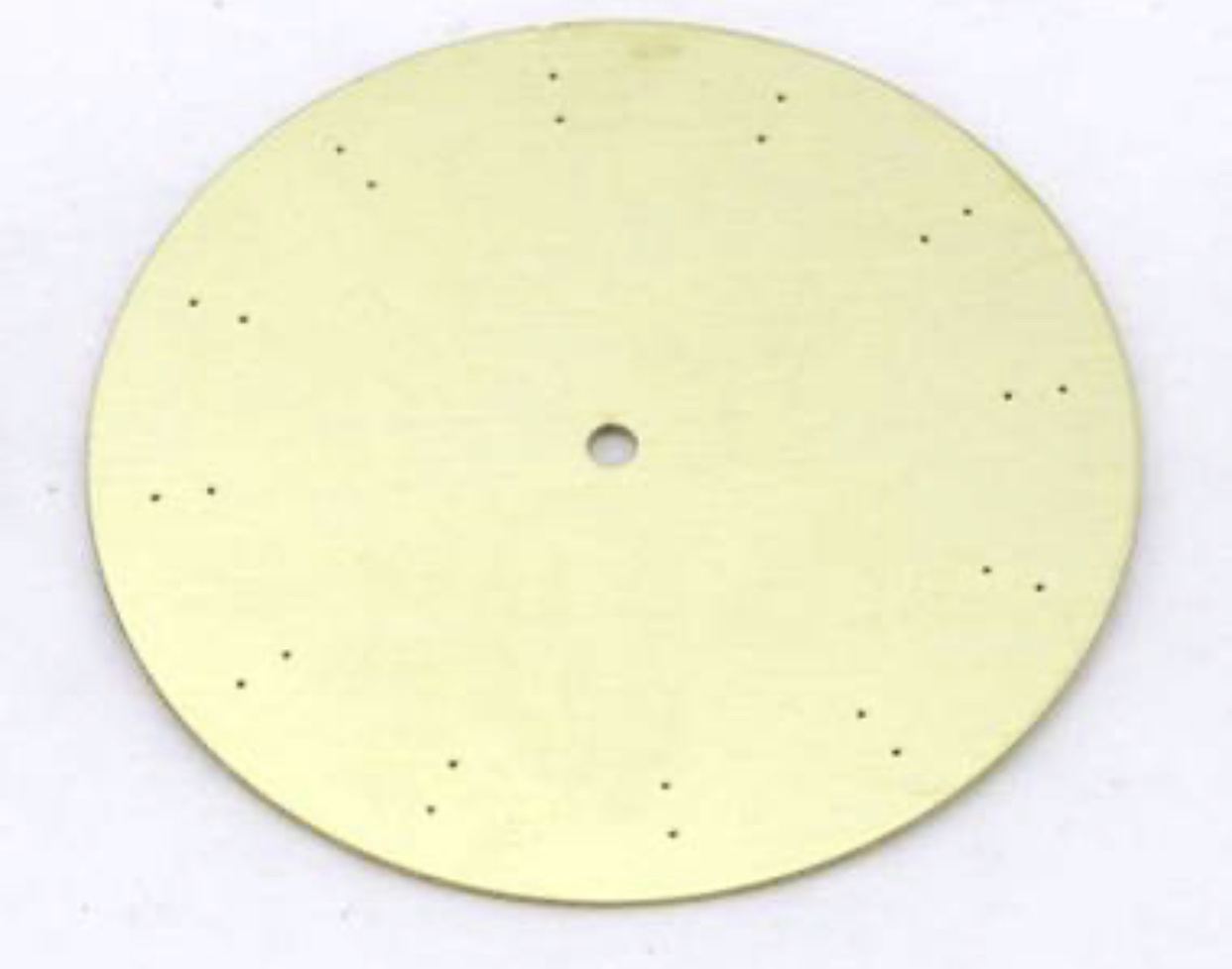

I believe the ‘gold’ color you may be seeing is the dial metal exposed (most commonly brass - potentially plated with something to permit if painting/affixing the dial furniture; though I dont know for certain the dial stock used for these specific watches).
Here, for example, is a generic watch dial blank made of brass stock:
Ah ok, that’s interesting. Thanks for sharing that information. Now that sounds like the most likely explanation.
