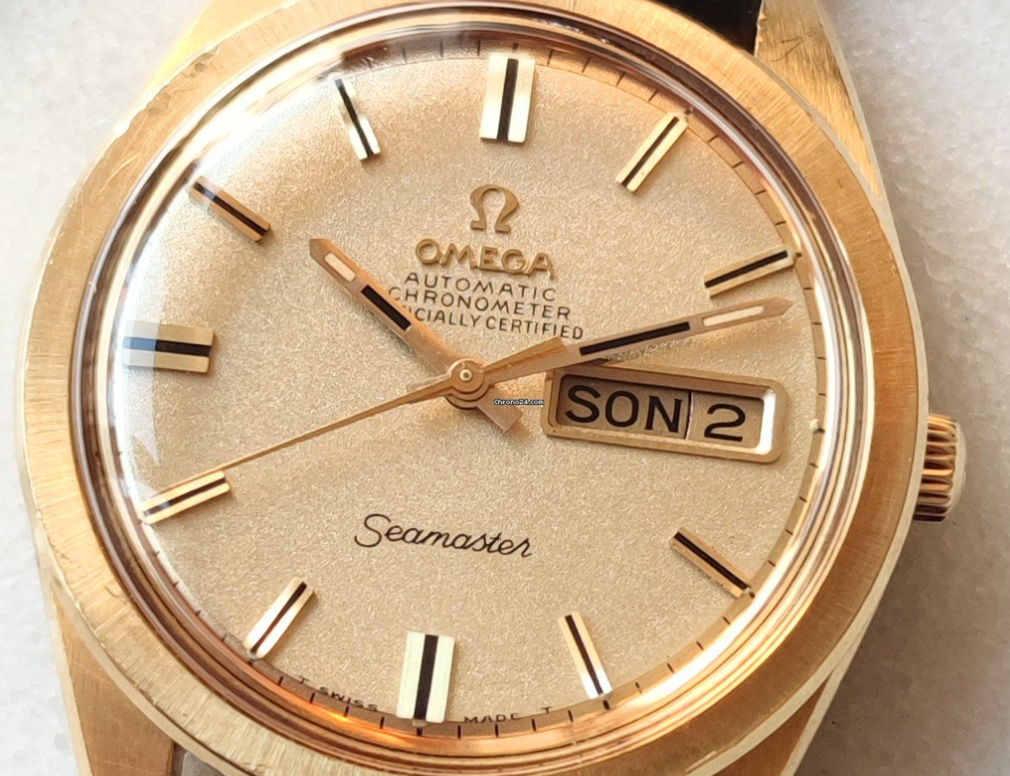

I'm considering pulling the trigger on this 18k 168.023 and I'm wondering if it's an original or a redial. I've searched for these day date chronometer sparkle dials and compared fonts between different pictures ad nauseum. At this point it looks like there's at least a dozen different versions (or a lot of redials) out there. That or my eyes are just starting to notice differences that don't exist. My main concern with this one is the "AUTOMATIC CHRONOMETER OFFICIALLY CERTIFIED" lettering under the applied Omega logo and the "T SWISS MADE T" lettering at the bottom of the dial. Does this look off to anyone? Thanks in advance!

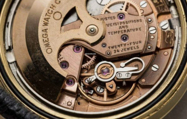

I don't know about the dial but if I were to shell out $3400 I would first have the seller verify that the movement is a 751 (chronometer movement). The listing doesn't specify that it does and the only movement pic doesn't reveal. If it is 752 it is not a chronometer.

If you're after a golden seamaster watch, I'd consider this for a bit. I have a few of these with 564 and 751 and the dial doesn't look out of place to me. The sparkle dials are extremely hard to mess around with. However, I'm not an expert as I'm just starting out. I'd wait for an expert opinion on the dial and meanwhile verify that the movement is the chronometer movement.

The rotor bridge is the correct 751 part.
I would say that the dial is correct though the "T SWISS MADE T" seems placed fairly low on the dial.

I have a bunch of these sparkle dials, and I agree with @ConElPueblo that this dial looks OK based on the photo. The "T SWISS MADE T" looks low on the dial, but I think that's distortion from the crystal based on how the minute markers on the step dial are also foreshortened. I would definitely ask for a photo from a different angle to confirm that. Good luck with acquiring the Golden Seamaster!

+1. I've also owned a few of these and they aren't all equal - I've found differences in many minute details on the sparkle dials. The dial depicted above wouldnt worry me right now, another picture sure is a good idea though - ideally of the dial outside of the watch, but that can't be provided by every seller, admittedly.

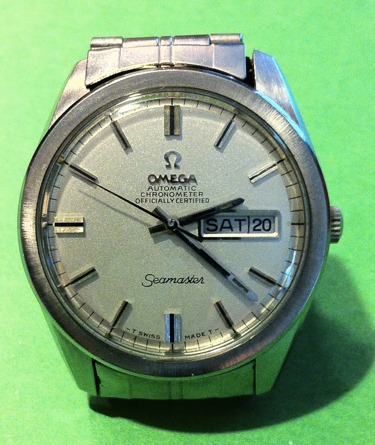

Pretty sure the OP watch is a redial. Compare and contrast with this example:
What do you think?

IMHO this is an all orignal dial
heavily distorted by a wrong crystal

Looks okay to me. The bridge says adjusted to 5 positions which indicates that it is a chronometer movement.
But once there is this much doubt on the originality of the dial - maybe just pass anyways...

The ‘Automatic Chronometer Officially Certified’ text is slightly concerning but I think this is due to the crystal/lost resolution of the photo.
I’d vote original.
The entire automatic assembly was available as a spare part, so that is not a part I would rely on to say for certain that the movement is correct. I would want to see the complete caliber number that is on the wheel train bridge to be sure....

Oh for sure - I am not saying that there is no chance of it not being a replacement part from a wrong caliber, even though the opposite scenario (752 part in a 751) to my mind would be more likely to happen.

It would be my reckoning that the non-chronometer parts are more plentiful than the chronometer-specific ones. If a watchmaker has access to order new parts, he could just as well order the 751-specific part, but if he has to use what is available to him without ordering through official channels, I would expect it to be more likely to be the 752-part that was readily available.
While I naturally haven't kept count, I would say that this is also what is most often seen on OF as well.
