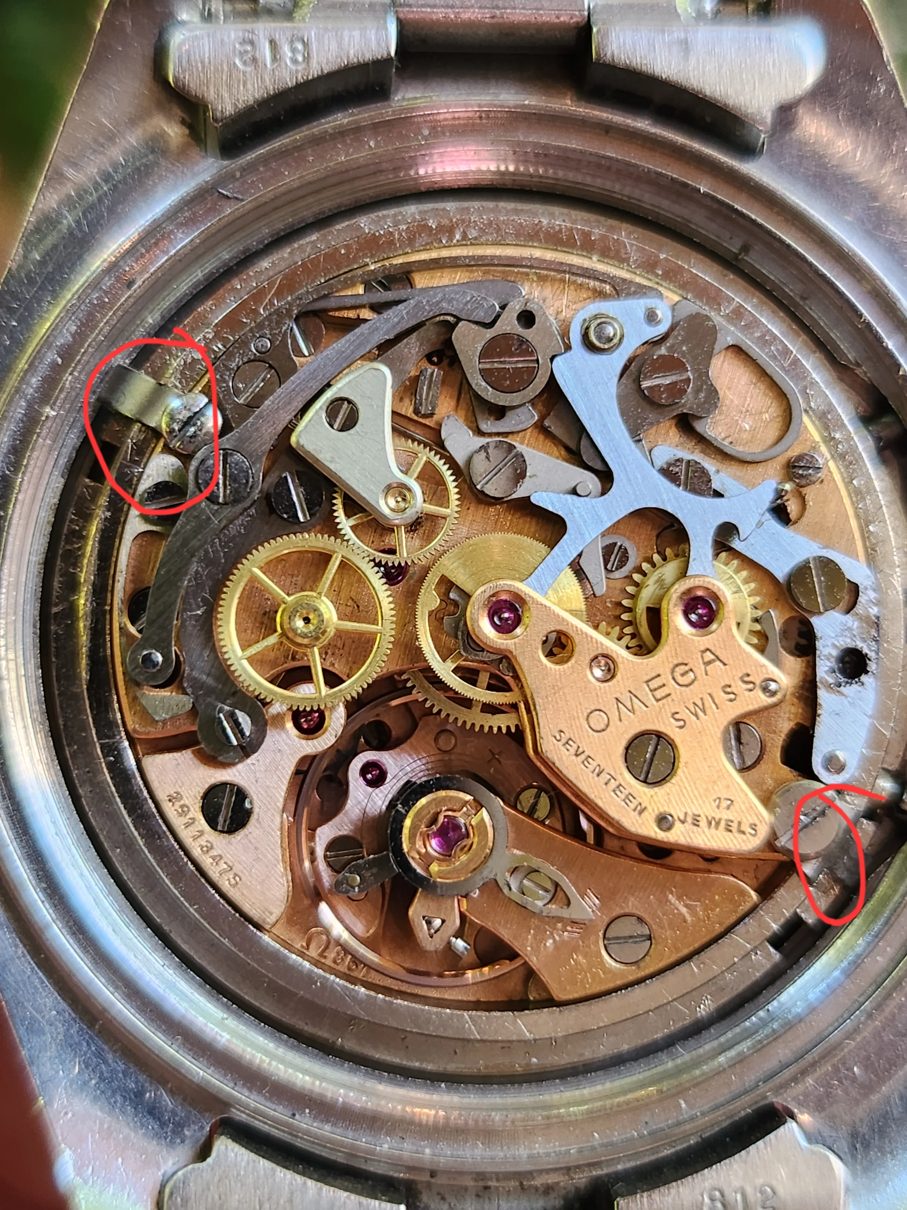

Hi All.
I recently purchased this lovely 145.022 69
Ref 861. The movement is loose. When I pull the crown the movement moves towards the crown. The watch needs a service and will be getting it but any part I can order to fix this present issue?
Thanks all for your help.

You appear to be missing the inner anti-magnetic cover. This cover goes over the movement spacer, and is held down by making contacty wioth the case back - this arrangement keeps the watch firmly in place. Since that cover is missing, someone has tried to add case clamps (which are not used on this model) to make up for it.
Those should be removed and the inner cover installed, and the movement will be held solidly in the case.

Thanks for your helpful response Archer. I've sourced one from England for £90. Hard to find on US or Can eBay.
