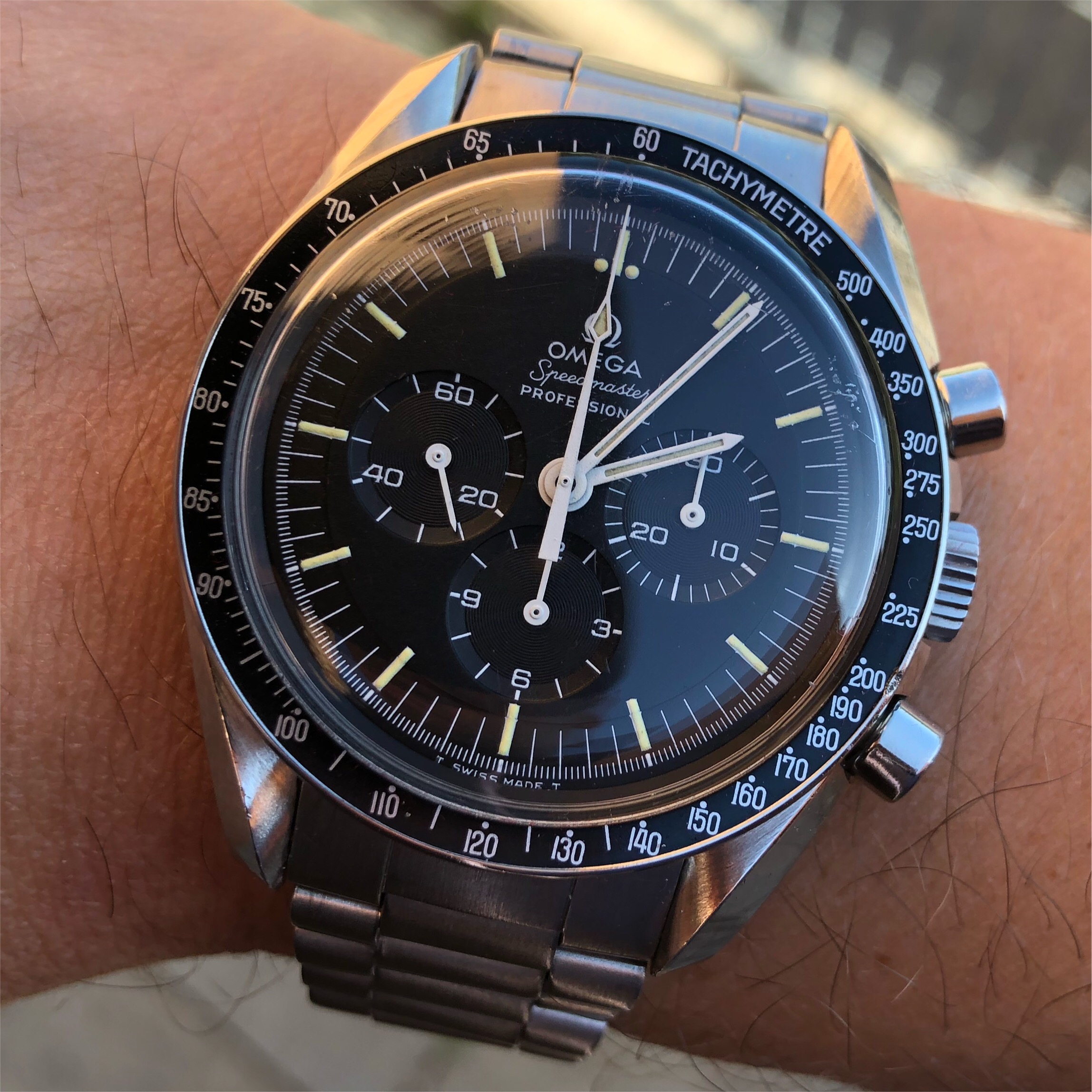

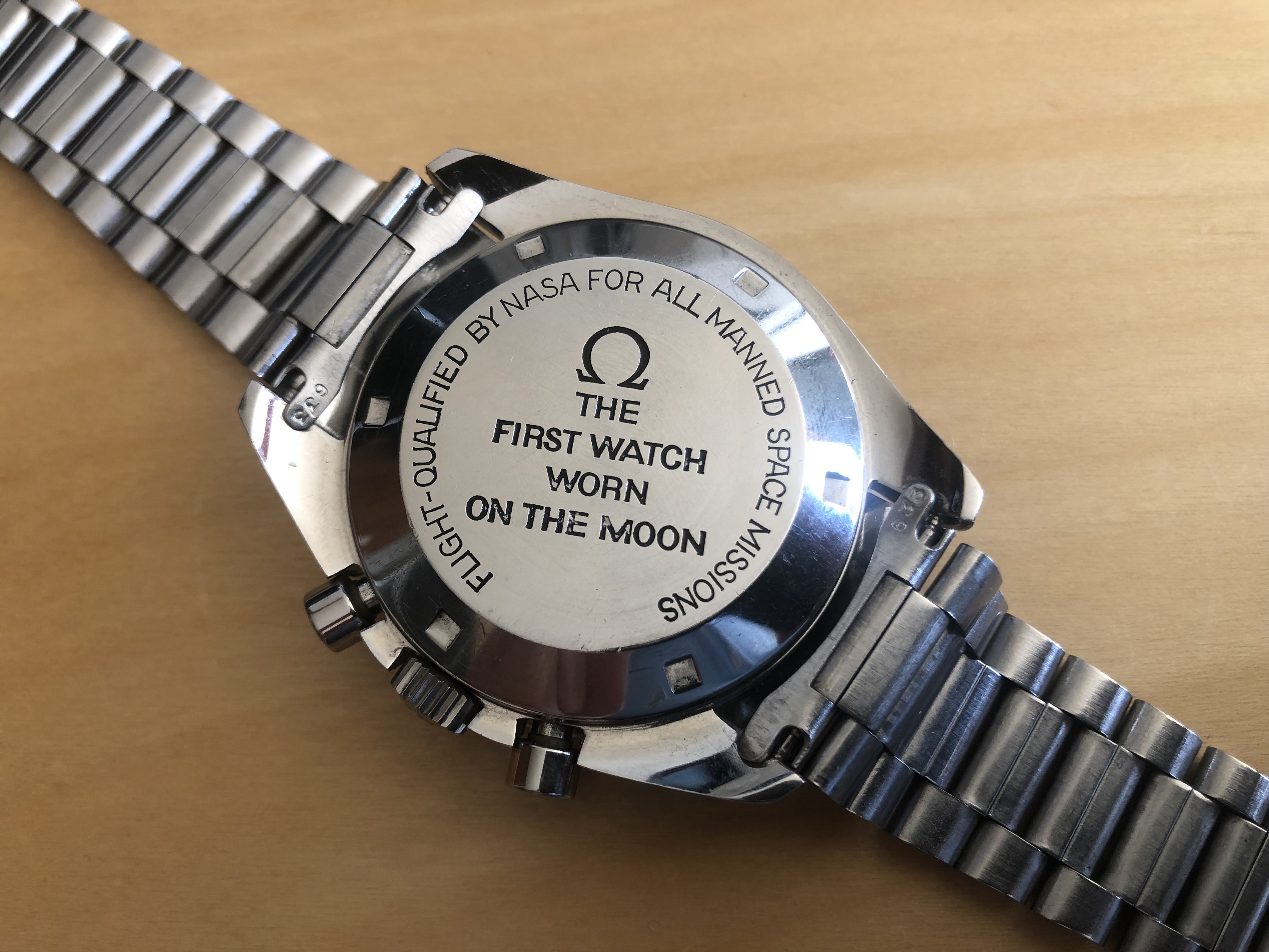

Hi,
Recently I saw a 145.022-69SW with a movementnumber (305x.xxxx) that fits at a 145.022-69 according tot Speedmaster101.
The watch has a DNN-bezel and a correct caseback, so from that point of view it is a 145.022-69SW. However, the SW movementnumbers begin at 31xx till 32xx.
Could this be a 145.022-69SW with just an older movement? Or is this definitely not original?

Yes, it can definitely be.
I recently bought a 145.022-69 SW with a 30.592.xxx serial, DNN and a Straight Writing caseback.
It comes from its first owner who bought it for Christmas 1970. The extract I just got confirms production in September 1970, delivered to Switzerland (where its first owner lives).
I had the same doubt and asked the heritage team for their opinion before I buy the watch, they confirmed everything to be okay and correct. 馃憤

I've posted the second picture on purpose. 馃槈
Look at this case and see how an untouched / not redone case from 1969 looks like 馃榾 Particularly the tips of the lugs 馃槜
