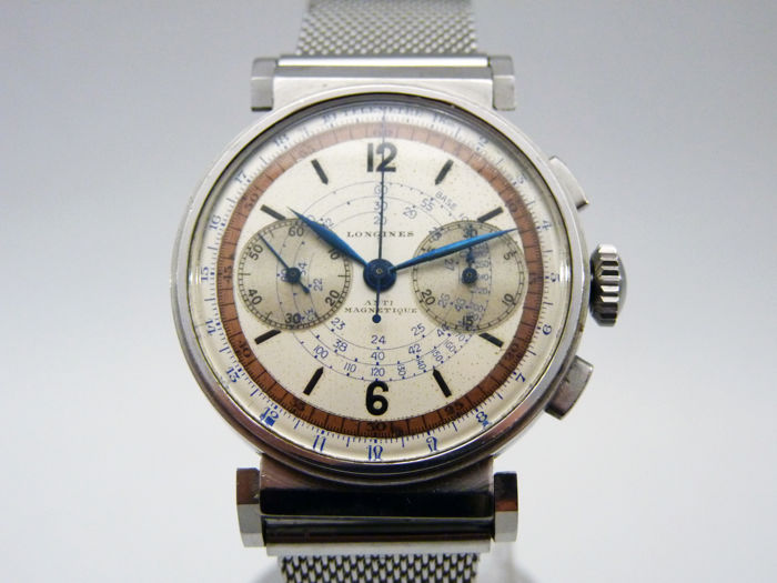

It appears very nice to my eyes but whitout any knowledge and having followed some auctions in the past, those beast tend to be sold at rocket price...Quite surprise to see one like this on the bay

What are your thoughts about this one?

1. The lack of the word "Base" in the tachy scale
2. "Telemeter" (instead of "Telemètre")
3. "Longines" = wrong type
4. Incorrect hands (and scales) in the counters
5. Red second counter hand
6. "SWISS" on an early 13ZN dial

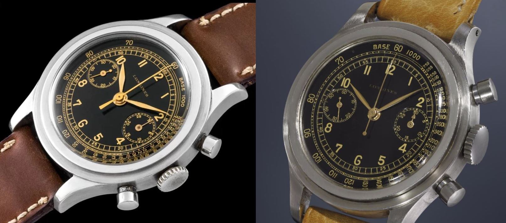

The example on the left (6'152'xxx) is slightly earlier than the one on the right (6'398'716). Though similar, the cases and dials are not identical. However, I believe that the crown, chronograph seconds hand, and sub-dial hands on the earlier piece should resemble those found on the later one.

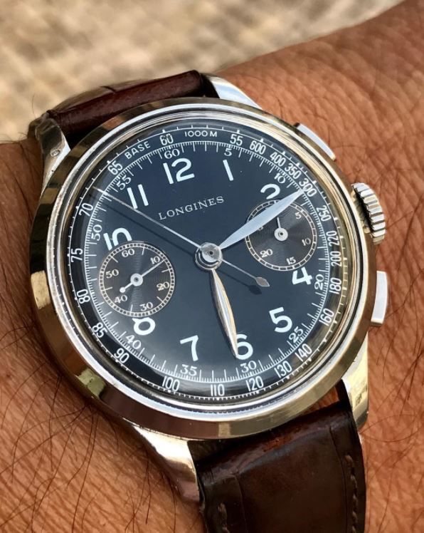

Another one of these unsavory, black dials appeared on Instagram today. The signature is not the same as others that I've seen. Still, this dial is not original.

13ZN dials can indeed be found with large subdials, "10, 20, 30" counters, black and blue scales, and possibly even printed winged hourglass emblems. Can they be found with all of the above? Who knows.
Rather than attempting to establish a rule, which is bound to have exceptions, I would suggest that you assess each dial individually; studying its specific nuances.
Well, now we know Longines did produce this style 13zn dial.

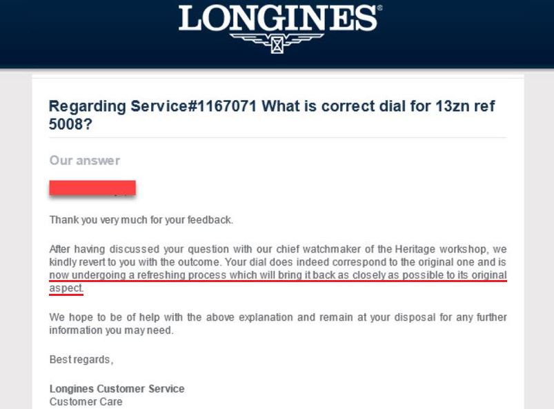

As I have stated multiple times. It is created and printed by Longines. No other company other than Longines was involved in the final outcome that is certified authentic by Longines St. Imier Heritage Workshop. You are welcome to send an email and ask about Service Request 1167071. If you wish to do this, I will privately give you my serial number for the watch as well.

I am not questioning that Longines were the only ones involved in the refinishing process. I would simply like to see a piece of evidence that suggests the existence of original (from the early 1940s) 13ZN dials with these design traits. It seems that Longines did not provide you with such evidence apart from a written statement (underlined below). I will inquire...

Please do contact them. I contact Jennifer frequently and wish to avoid wearing out my welcome. You are correct in that I did not insist on pictorial documentation. I was hoping to get an Antimagnetic or Copper Dial and asked by phone if that was possible through the New Jersery office. They informed me that St Imier will not change the dial design from its original design. If they know what is correct for that watch, the head watchmaker will not allow a change is what I was told was the response from Heritage Workshop.

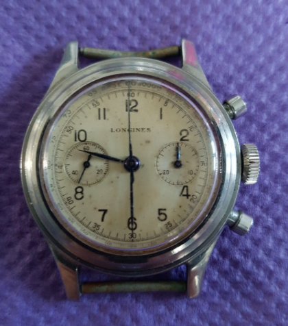

Looks like a ref. 5415 with a snap-on back. These are more commonly found with radium numerals and no tachy scale. Parts that are often replaced, such as the hands and crown, all appear correct. The dial looks good from afar, but the numerals are different than the ones on the other tachy-adorned example that I've seen. I imagine that you do not have better/more images...

Its from an ad, case back marked 23485, looks like seller didnt know what she had until someone told her. Asking for offers....
