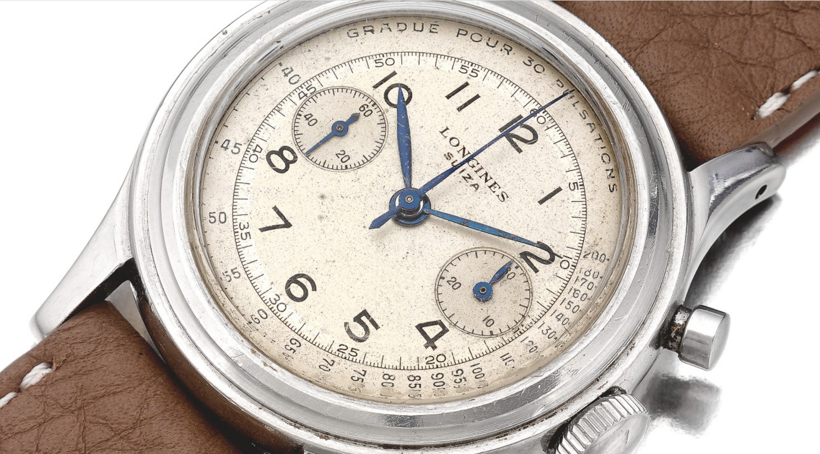

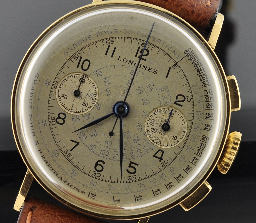

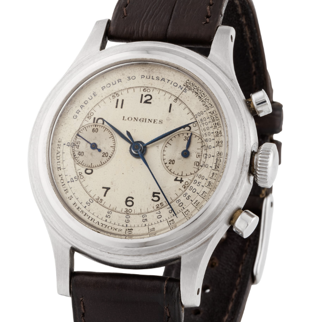

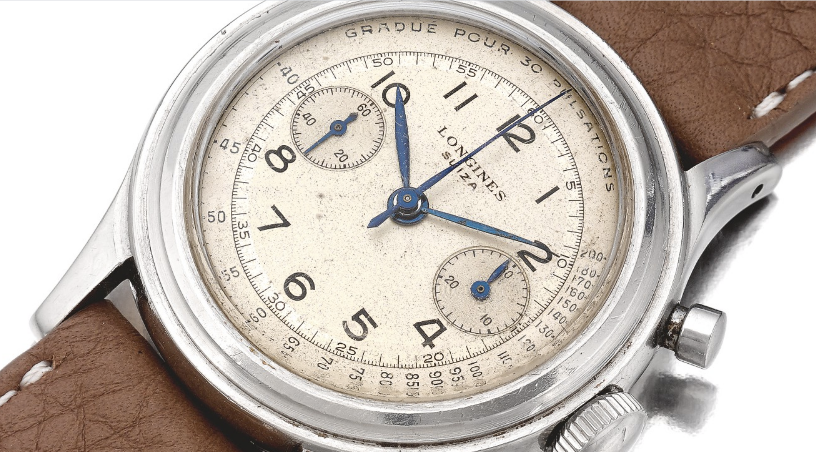

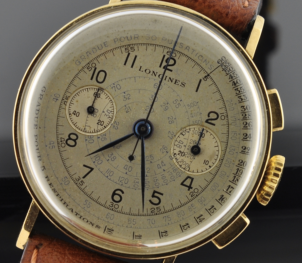

Dial looks original but is a relatively uncommon variant. This is the earliest example that I have seen with this type of pulsation dial (sub-dials with 3 numbers). Crown is correct. Chronograph second hand should have a circular counterpoise. Sub-dial hands correspond to another example that I have seen, but this example was from 1946 (6.98 million serial). Assuming dial, movement, and case were born together, the price is not unreasonable. I would strongly suggest contacting Longines to get an extract, prior to proceeding.
Thank you - the watch is offered together with Longines extract information. They did confirm the numbers, watch was sold in 1939
74
113
The extract will not mention the dial.
I think what he means by "contact Longines" is to both get the extract information (which you have) and also to see if they have dial information. Many times (but not always) they will say something like "this serial corresponds to a silver colored dial with pulsations scale and Arabic numberals" or something like that. Before buying a 13Zn recently, they told me the serial refers to copper dial with tachy, for example, which matched the watch I was looking at.
It's worth asking this before proceeding, in my view.

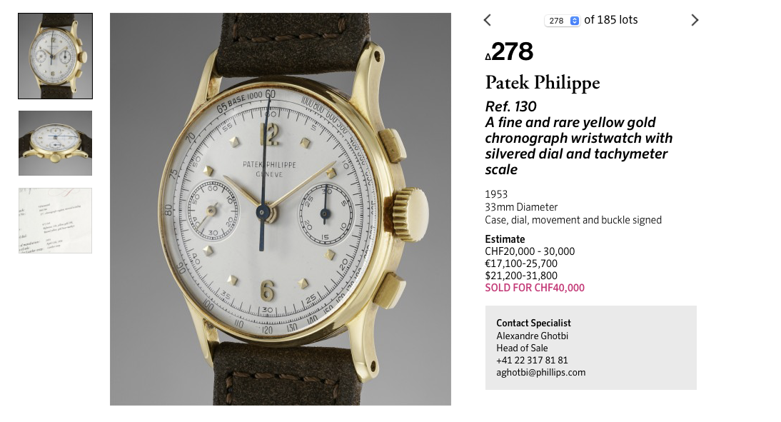

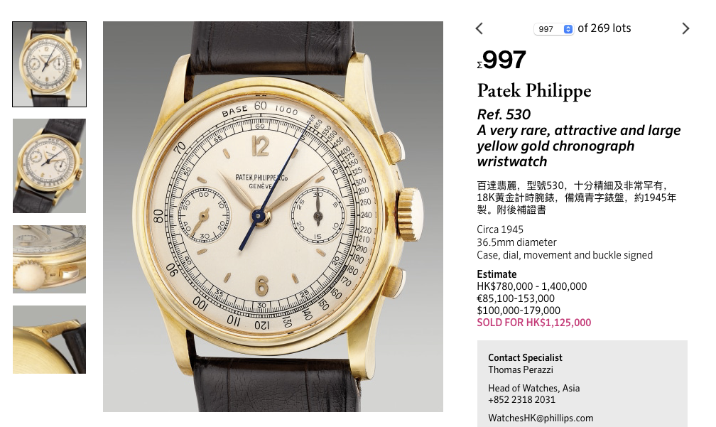

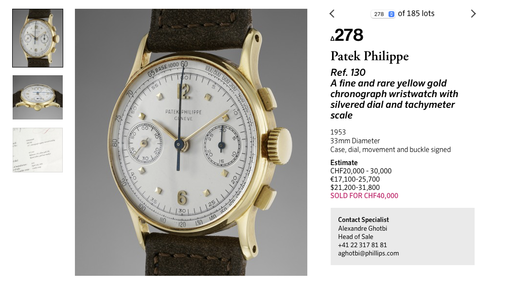

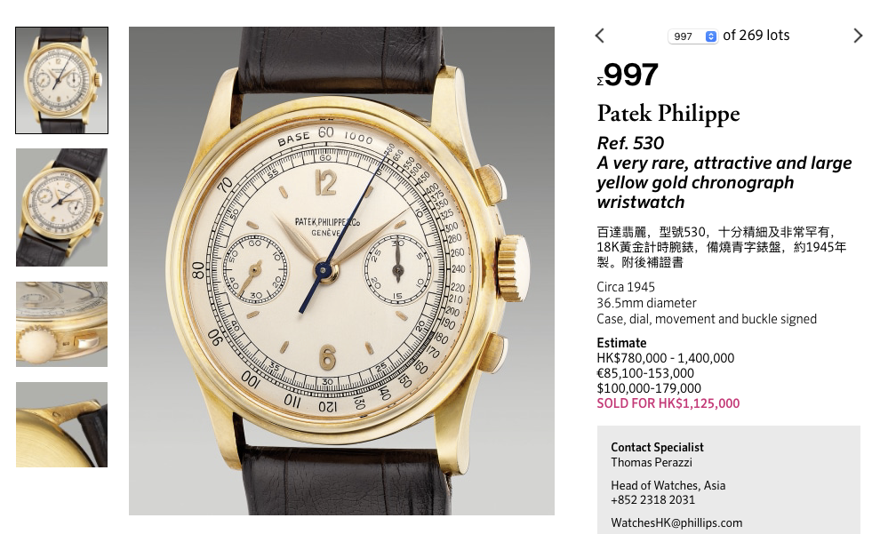

Intersting to read - I dont remember to have seen a "real" 40mm 13zn - but of course the well known 13zn12 Sommatore has 39,5mm. I did see 40mm with a Longines Valjoux 22GH. They majority of 13zn have 35 or 37,5mm up to my mind. An interesting sample not a true comparison is the price difference between an "ordinary" vtg. Patek chrono Ref 130 with 33,5mm and the big model Ref. 530 with 36,5mm - see attached pictures:

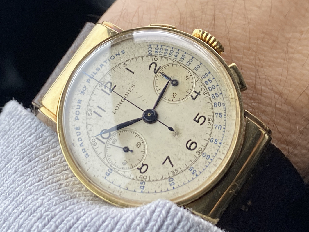

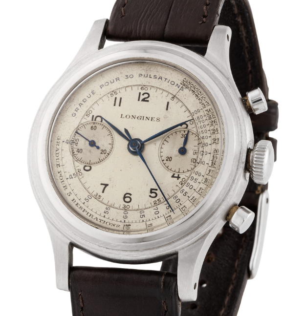

I just discovered this one offerd for 8,5k € Whats your opinion?
Is it just me, or do the hour and minute hands not seem proportionate? They are stylistically identical, but the hour hand seems too thin and short, or the minute hand seems too fat. Does anyone have an example of this handset elsewhere?
Agreed. Judging by the first example that I posted above (which appears to have an entirely correct handset), the minute hand of the watch in question appears to be too wide.
I agree.
