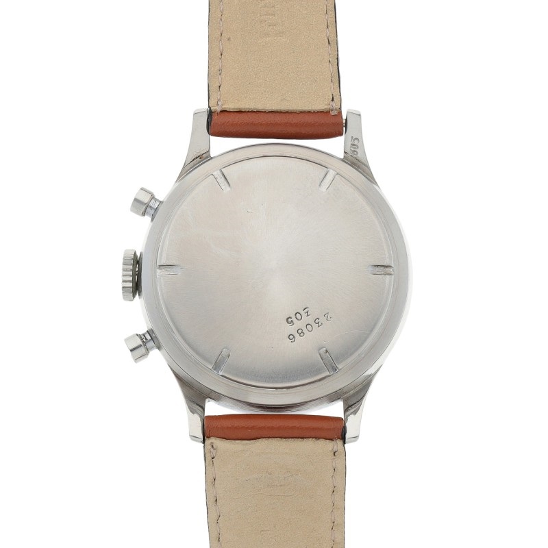

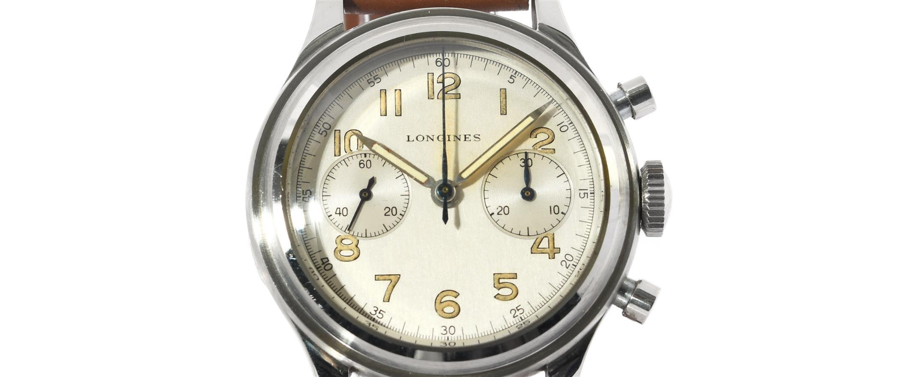

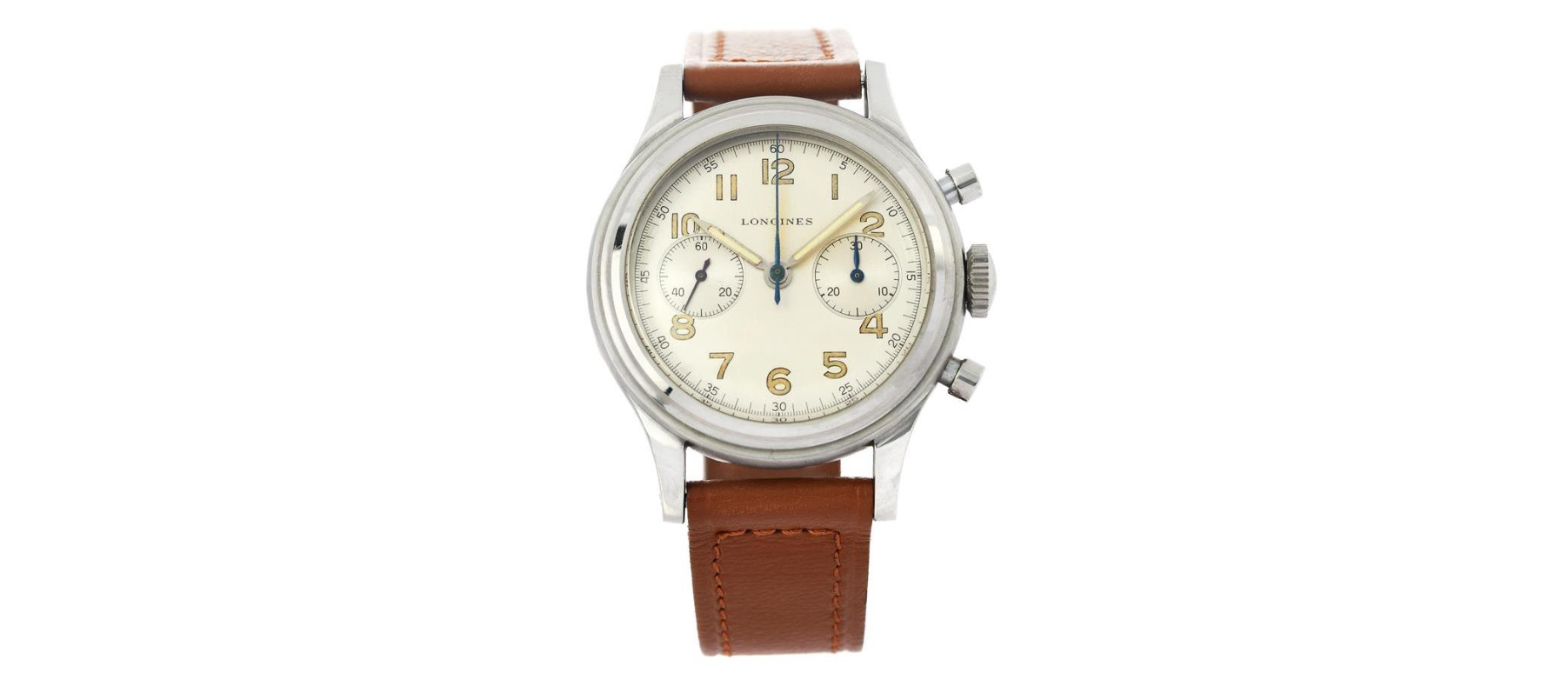

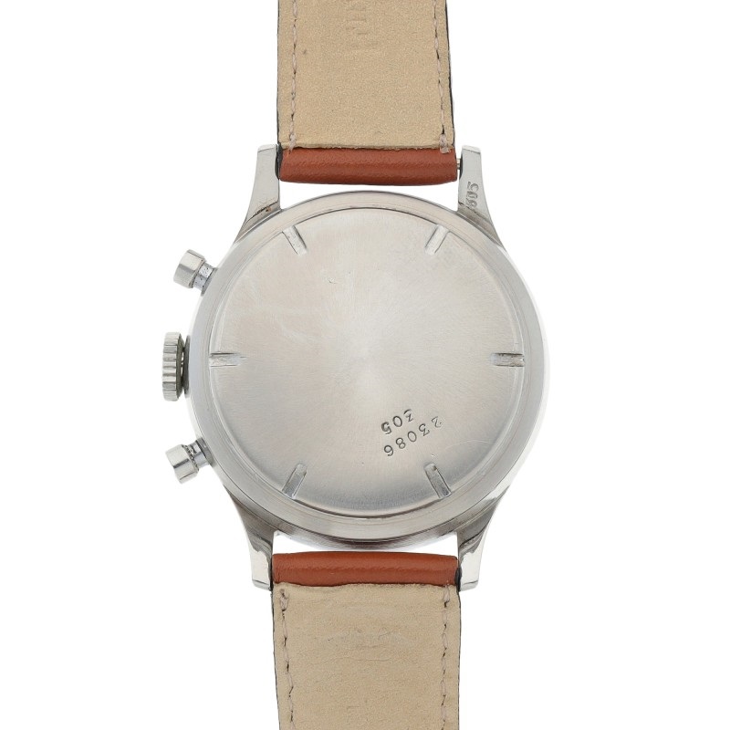

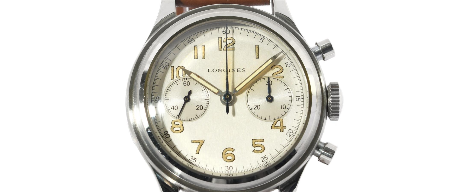

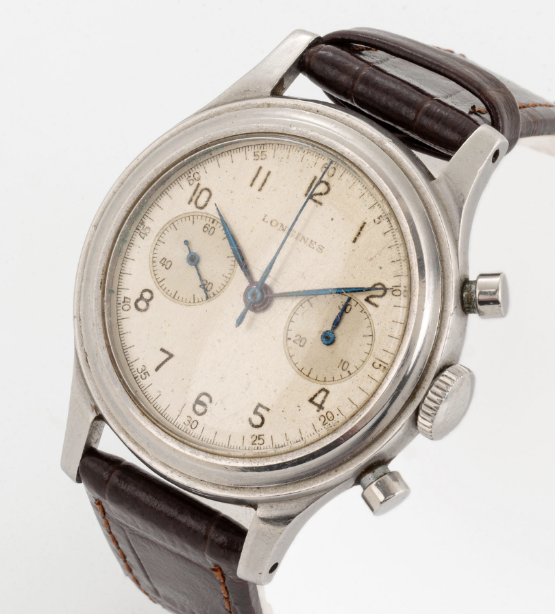

This 5415 from 1949 just popped up on a Swedish auction site - looks a bit too good to be true, which normally means it is. However I cannot really find any faults in the dial, case, crown etc other than that is really clean. Thoughts?

I am intrigued by the hour and minute hands. Firstly, a combination of blue and silver hands is atypical. Secondly, they appear to have been re-lumed. Though the watch may be NOS, it does not appear to be untouched.

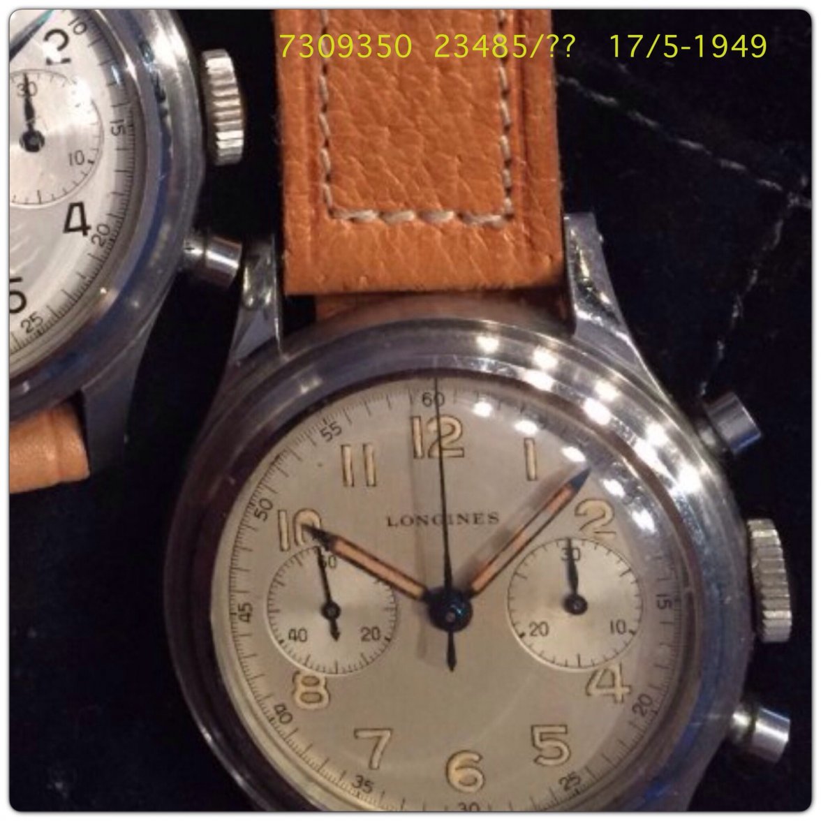

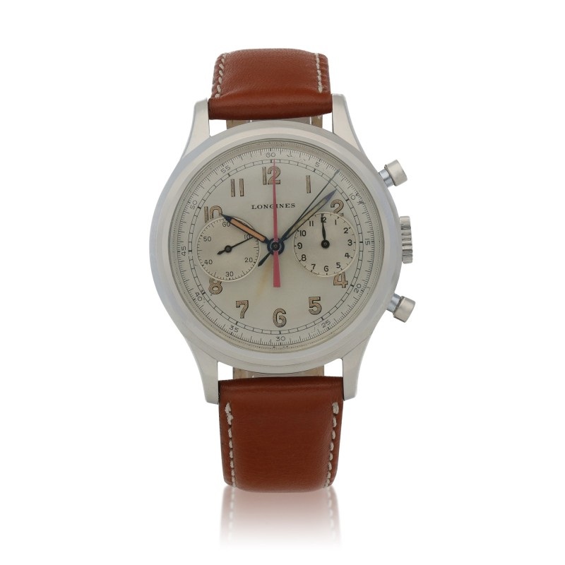

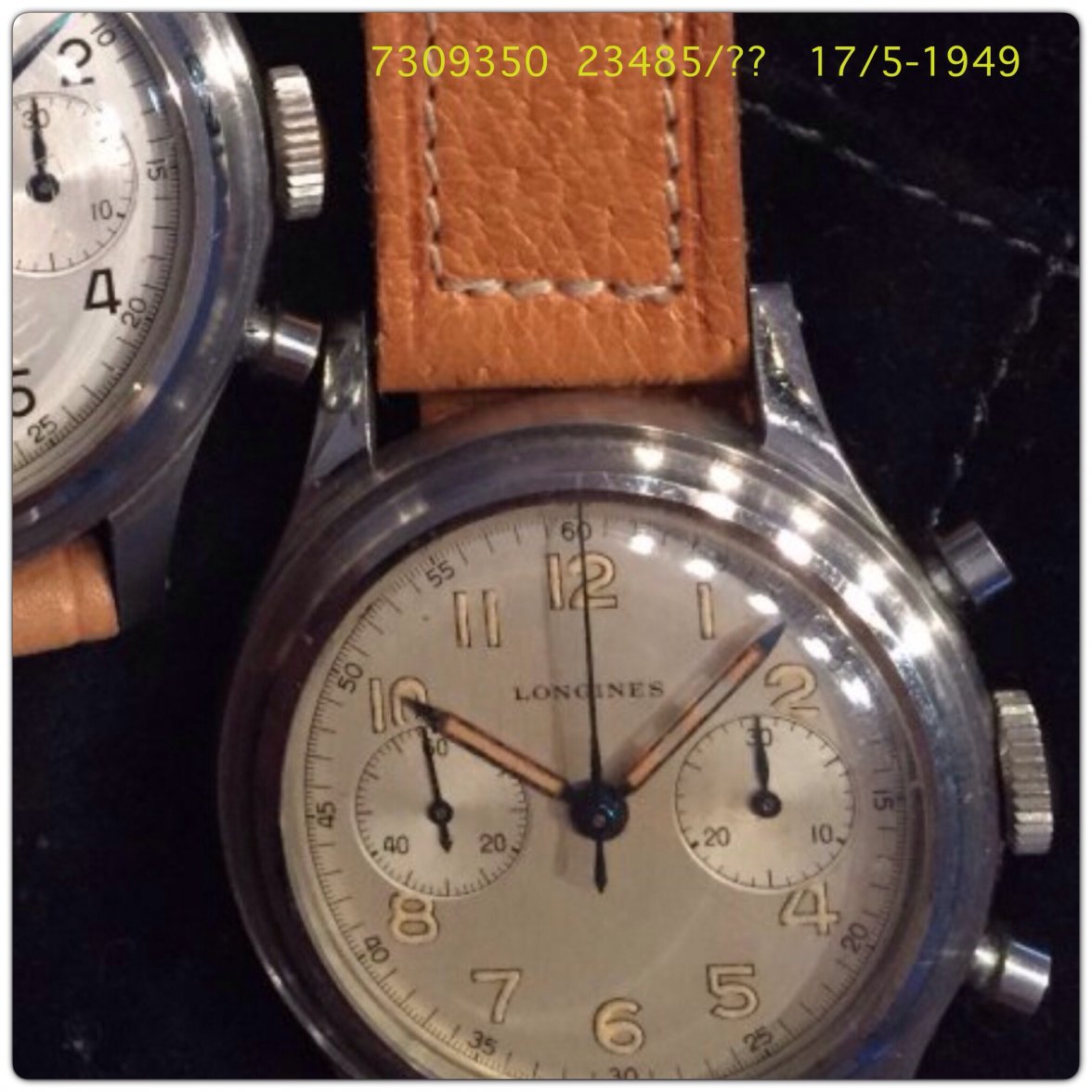

That would be a crazy thing to do, but I agree. Here is another from the same
batch and invoiced same date....

Thanks for sharing - just to be clear you are suggesting its the same watch right? (sorry if I am being slow, sometimes the irony is lost through online posts.. 😉 )

I don't think he was being ironic, just providing info. Not the same watch.

No, they are 11 units apart in the serial number. But they were sold to the
norwegian agent Hausammann on the same date 17/5-49 Witch BTW is our
Constitution Day

Ah right gotya, thanks! Someone at Hausammann was obviously in a festive spirit ordering a batch of these watches haha

Current price is 90k SEK (about 9k EUR), plus buyers premium, but suspect this will go up beyond my price range unfortunately. Beautiful piece regardless, so good luck to whoever gets it.

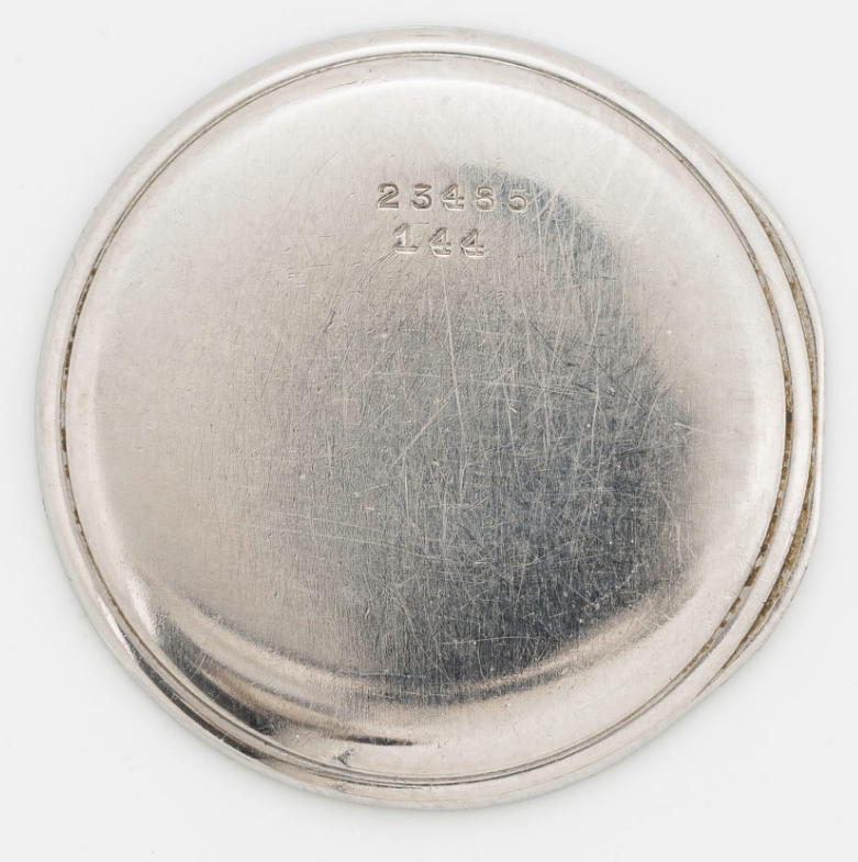

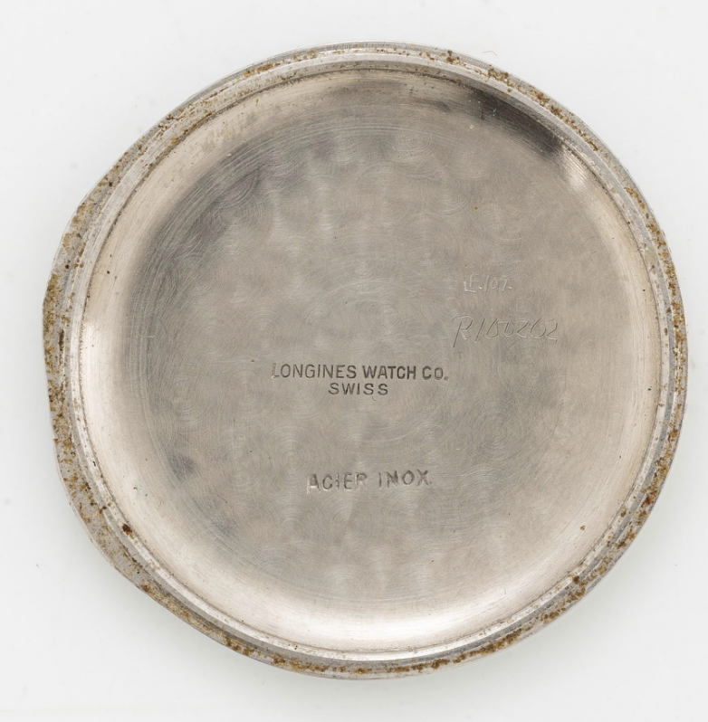

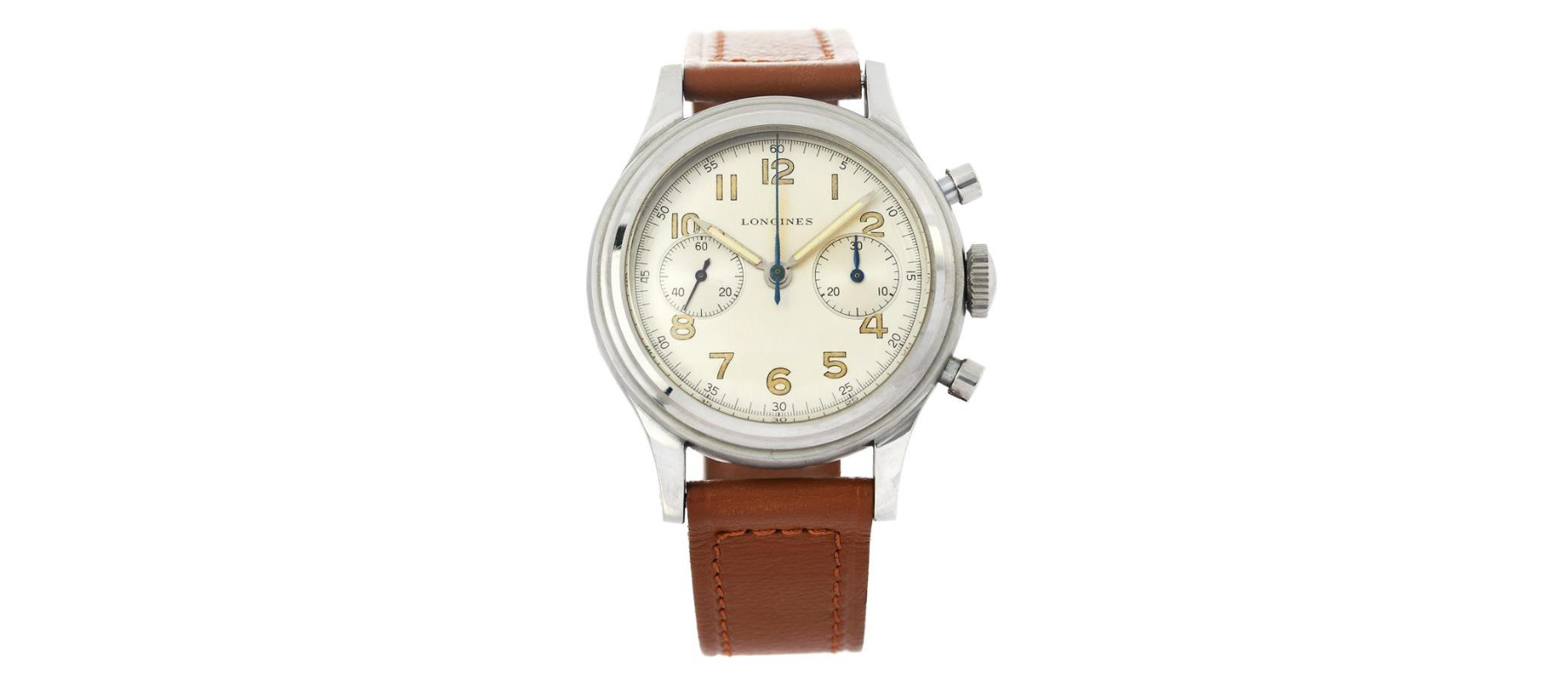

Maybe @Radiumpassion has already saved/posted photos of this watch for posterity. I wonder if anyone has noticed other mismatched case-backs (with regard to lug number) on 5415s? Quite a few ref. 5699 seem to have them.
"Longines Extract from the Archives, tillverkad 15 juni 1949, levererad till Norge."
1,145
5,654
Yes, and it was not sold. The estimate was probably a little high due to
the wrong caseback?
