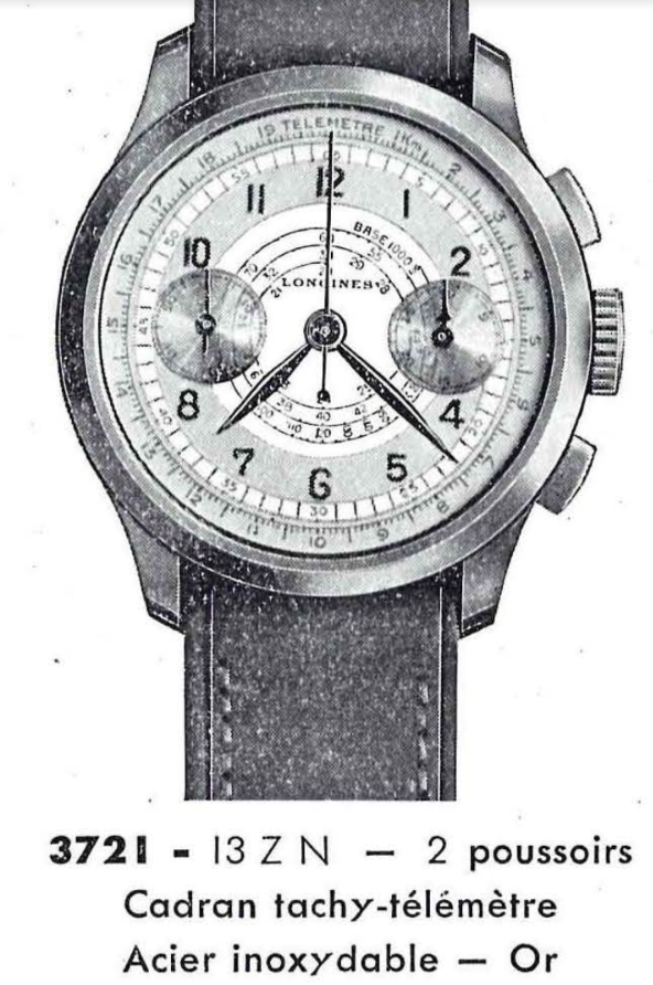

Thanks again for the feedback. I was looking for something else but noticed this example in the 1937 French catalog from the vintage Longines site.
https://drive.google.com/file/d/1PwRLIxwRlS36fhhj24k3bF2-jSesmx0P/view
Dial and case look nearly the same but for the lack of "Fab. Suisse" and slightly different spacing on the "Base 1000" and the subdials. This leads me to think the example in the catalog is a slightly larger dial. Would I be right?

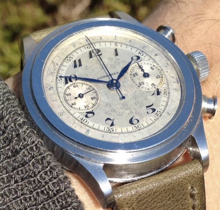

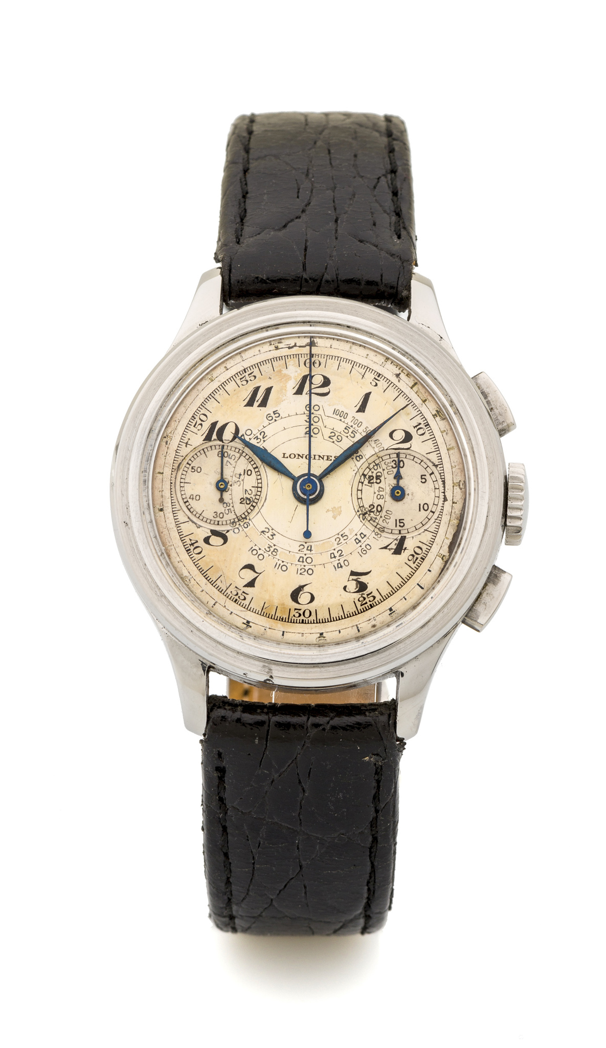

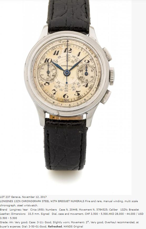

As @nicola1960 mentioned in his 2017 post on O&P (linked by @Mark020 above), the strange attribute about this dial is the central tachy scale. The steps at "60", "30", and "20" are very atypical. I have seen a couple of other examples of this dial (see below). Comparing this design to a period advert, we see the exact same dial except for the tachy. With regards to AQ's assessment, they state that the watch is "Circa 1950" so they obviously know what they are talking about. 🙄
103
96
I believe the dial has been cleaned but not refinished. I think that is what the prior listing meant by "refreshed." The AQ example is in fact the same watch posted by @DirtyDozen12 which also appears here - http://watchexpertise.com/oldlonginespassion/Longines_Passion/13ZN_parte_2.html
The website roughly says the following about the watch:
"An example of a 34 mm case, one of the first dials made with 12-1 deco indexes, two-tone silver background, blue helical tachymeter scale and blue peripheral tachymeter scale, beveled bezel, lever buttons, blued leaf spheres, a very rare piece."
If you're not sure they're the same watch, look at the dial marks at hour 5, 3-4 minutes, and 48 minutes. Whoever "refreshed" this dial make it worse IMO considering the dial looks better and more vibrant in the earlier picture.

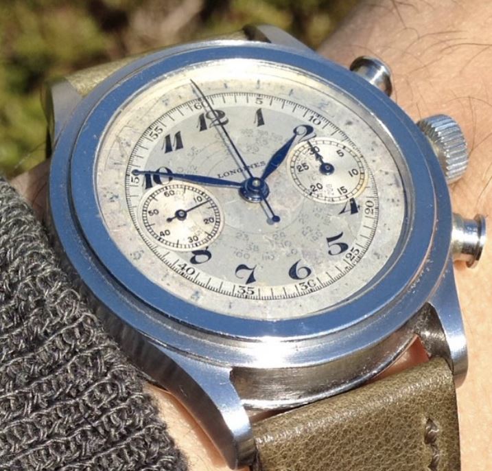

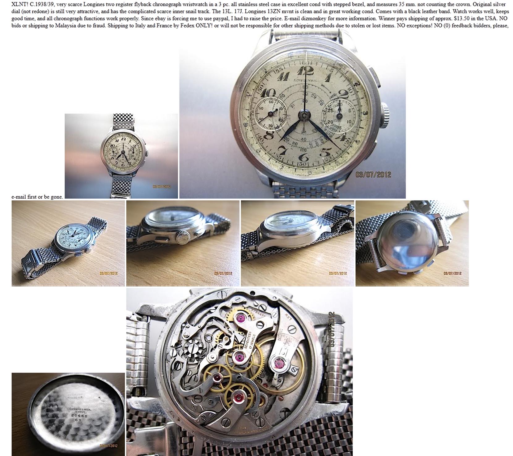

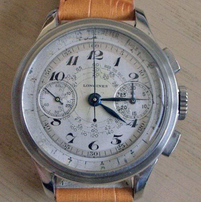

The wristshot posted by @DirtyDozen12 seems to be a similar example of the same dial, but in a different case and with the silver tone reversed. Nonetheless, this gives more credibility to the originality of the odd tachy scale.
The wristshot and the advert also seem to confirm the odd layout and printing of the subdials. I note the advert shows a different placement of the Longines logo as does the one below with seemingly the same dial. This advert below calls the watch a "146T" which I would assume was a reference for the US Market. Unfortunately, I do not know the year or source of this ad.

Firstly, @rondeaux is right. The dial in question is the same one that I posted above. Secondly, the design and execution of the sub-dials does not bother me in isolation. Though uncommon, this variant can be seen elsewhere. For me, the only issue is the tachy scale that is very unusual for a 13ZN dial. However, given that essentially all other elements of the dial appear correct, I am inclined to say that the dial is probably original.

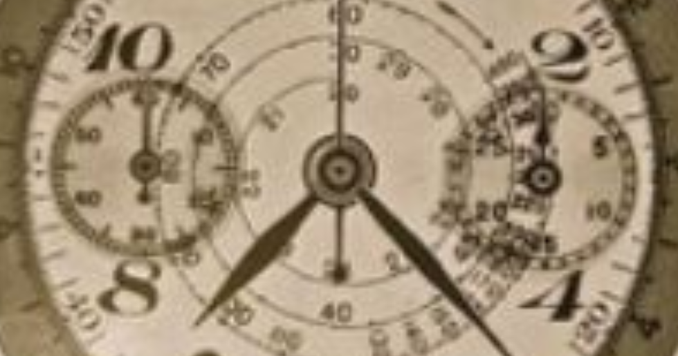

Still (for me) strange the right index seems to be darker printed than the left one. Also the the printing of the 2/4/8/10 which continues into the indexes seems off.
74
113
I am inclined to believe it is original as well.
The 2/4/8/10 printing is consistent with the 2 examples posted by @DirtyDozen12 as well.
While "darkness" inconsistency looks odd, but it is consistent - notice the 34 from the track being much lighter than the 32 above or the 36 below. And then the 60 50 40 30 from the left counter being light, similarly. And on the outer mile track, some remnants of 7 8 remain, butby 9 it's all gone. So the "consistency of fade" here to me gives more credence, as opposed to a reprinted counter where usually this consistency is lacking.
Agreed it is strange but take a close look at the ad. I get the same impressions - the minute counter appears darker than the running seconds and at least the 10-8-4 are overlapping the subdials. It seems probable that these are actual qualities of an original dial.

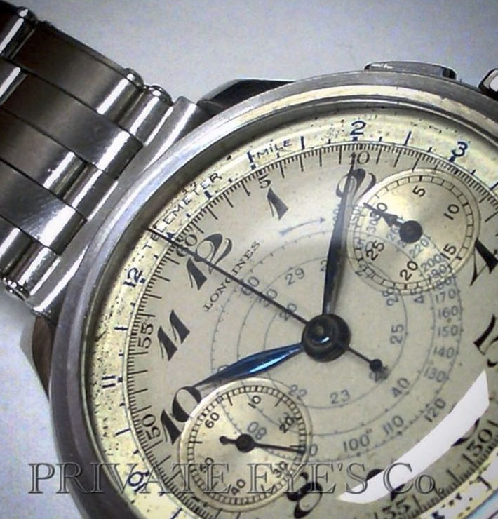

I wonder if the AQ dial has "Swiss" at 6. I can just make it out on the dial that @minutenrohr posted, which is from the same order (20448) that surely went to the USA (see LXW import mark on the balance cock). Below is another example with the high signature and non-stepped tachymeter scale.
As best as I can see, I don't think it does. Do you have any more information on the below example you posted?
