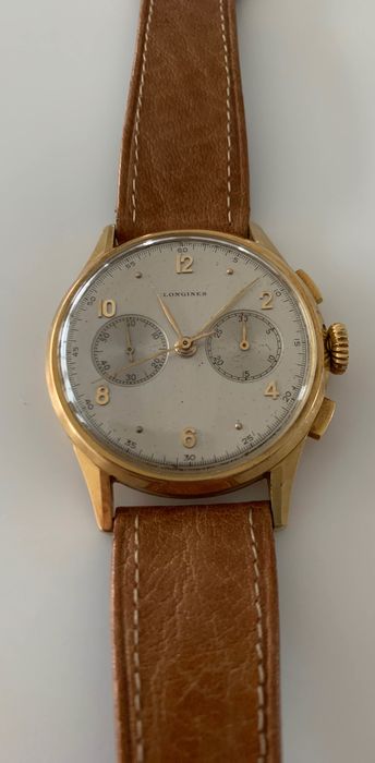

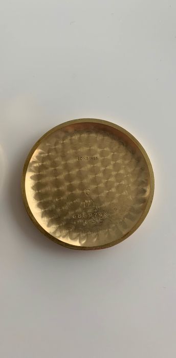

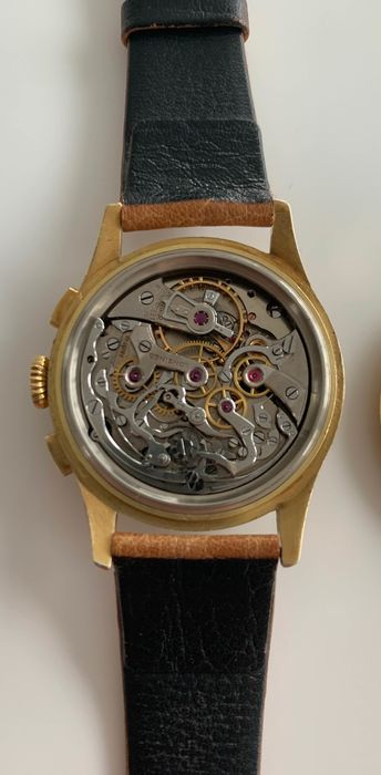

Hi everybody,
Very interesting and educational thread this is! Not sure I'm understanding everything 100% since English isn't my native language though.
Would anyone be so kind to give his/hers opinion on the 13ZN below?
I'm following this one on an online auction which is due tomorrow and has an estimate of 6- 7 kEUR with a current highest bid of 2.2 kEUR.
Reference on the movement and inside case back do match, not sure about the crown and perhaps the dial is too clean for a watch dating back to the forties.
Many thanks on your input,
Tupaja

Hello, and welcome to the danger zone馃槈
I am not familiar with this model, but based on the poor pictures provided
I think it looks ok. Maybe the sweep second is broken or a replacement.
What is the diameter of the case?
3
Yes, I know the pictures aren't that good but those are the best offered online.
I assume a replaced sweep second hand isn't the worst there is.
The seller claims a case diameter of 37mm.in rose gold.
No it is not, but please get a second opinion before you break the bank.
37mm seems right based on the pictures, and if the dial is original I think the
estimate is within range.

The (re)dial is my main concern and, off course, the movement but since it are matching numbers with the inside case back, I'm not too worried on the movement (also being a non-flyback which is correct for what I know). The copper base point of the dail on the movement gives me some courage. Thanks for your opinion, much appreciated!
2,057
25,237
The watch looks correct to me. Probably not all hands, but movement, case and dial are in my opinion typical (and not restored) for a gold 13ZN from the mid 40ies.
Better pictures would allow a better evaluation.

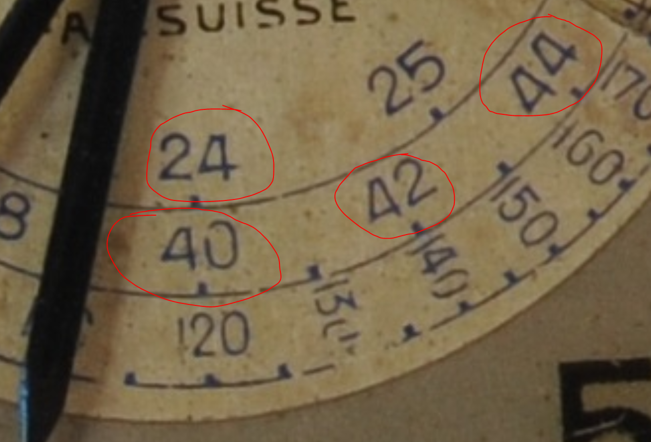

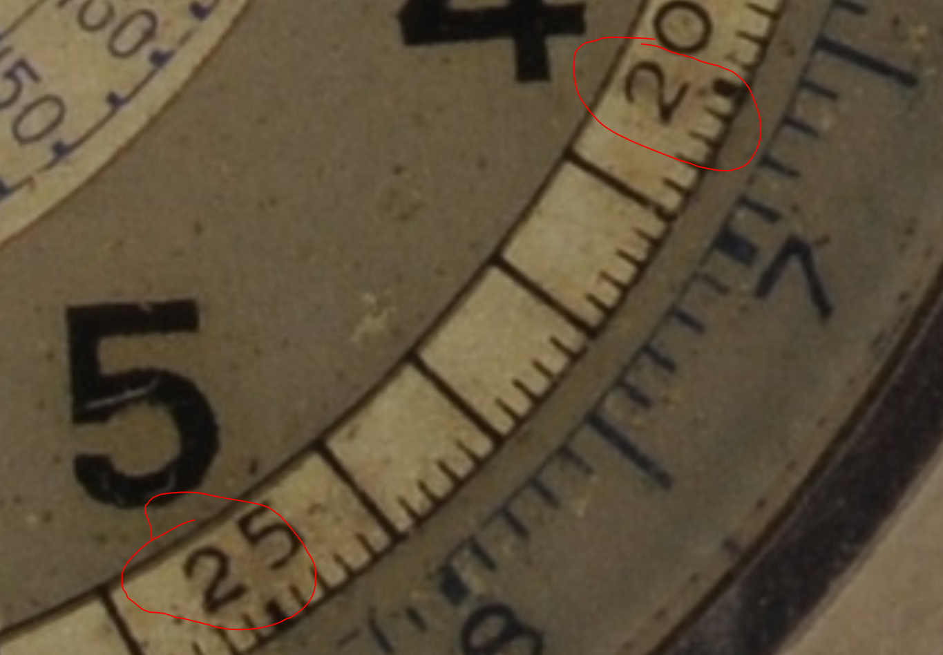

Well I've had this thread saved for a while now and now I've finally had some time to sit and read through the whole thing. Thank you all for sharing your knowledge and for sparking such insightful discussions. I may never actually come to own a 13ZN but I definitely have a deeper appreciation for all of them now. I've also had quite a lot of fun going through and reviewing the examples to see which are redials and which are legitimate.
I think I understand how most of the opinions are reached here but the dial below (posted on p. 30 on 3/8/19) has me stumped. The majority of details seem right but there's a few small things bothering me. I'm hoping someone can explain what I'm seeing so I'll have a better understanding going forward.
I know there aren't really many bright line rules when it comes to examining these watches and it's more of a factored analysis. But generally, I thought numerals and letters should be identical within the same fonts or functions - e.g., all the 0s in a minute counter or all the Es in telemetre should look identical. On this example, the 2s in the minute track and the 4s in the tachy scale seem inconsistent to me. The 2 in 20 seems much thinner and a little straighter through the middle than the 2 in 25. Also, the 4s in the tachy scale seem especially varied in terms of style and thickness as I've circled below.
So, if this dial is legitimate, what would explain these variations in the numerals?
2,829
4,948
Inconveniently, this is not always the case on original dials. The variations that you highlighted are widespread.
74
113
Variation of the 20 and 25 is very common, as proven in archival pictures from Longines showing the original watches. I see no concern over this (my guess is that it has more to do with the angle of print than anything else)
Broadly speaking, I think you are givint too much credit for it to be "identical" - this was circa 80 years ago when the dial quality was amazing but it was not machine generated exactness. They "should be in the realm" but I think if you are striving for 10x zoom exactness, in some cases with certain dials that happened and in others there is a slight variance.

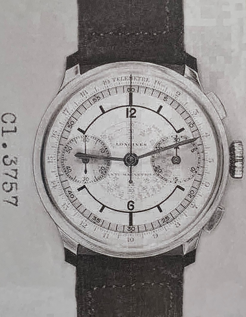

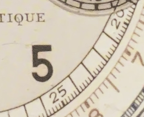

A few examples of known correct dials (with 20 25 variation) and 1 archival image from Longines (sorry it's not crisp but it has the same 2 variation in 20 25)

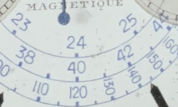

Same holds for the 4's question you have. Here is another known correct dial - and I have the Longines original archival image showing the same but that is black and white and not as crisp, so go with this one - but you can see variance all over. Look at the 3 in 23 and 38. Heck, look at the 2 in 24 vs 120.
So I believe your question of "what would explain these variations in the numerals [in legitimate dials]?" was based on a false notion that you had where "generally, I thought numerals and letters should be identical - e.g., all the 0s in a minute counter should look identical." - that just is not true and was never true and the Longines original archival images themselves show that not to be true. Hope that helps somewhat.
103
96
Thank you both for the explanations! Would it be more accurate to modify my original statement to say "numerals and letters should be relatively similar and of the same style within specific fonts and functions"? It seems like the consistency I'm looking for really depends on the specific dial batch.
As a further follow up, how can I learn about how dials such as these were made during this time?
