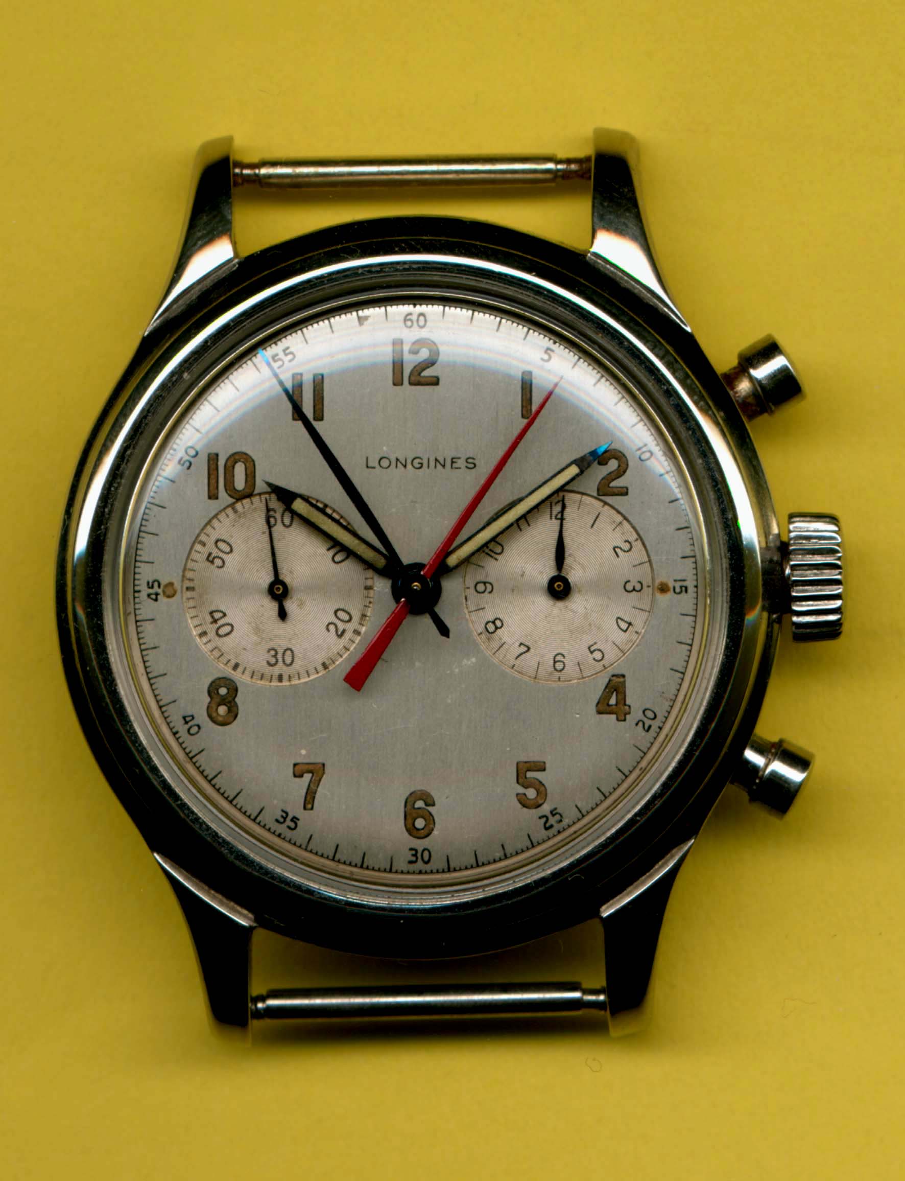

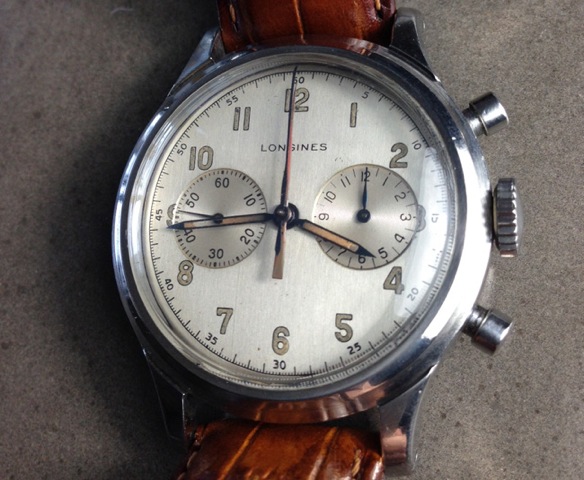

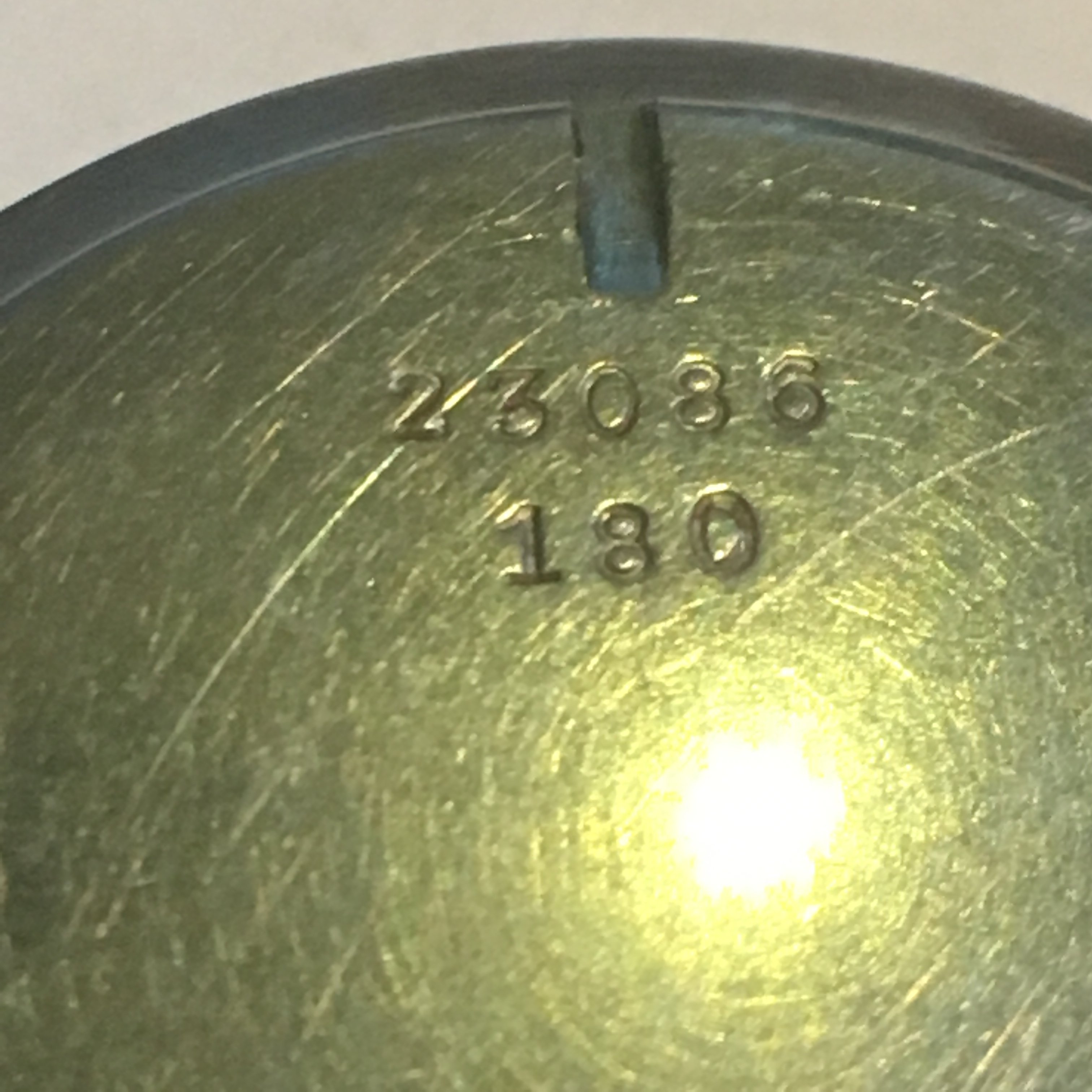

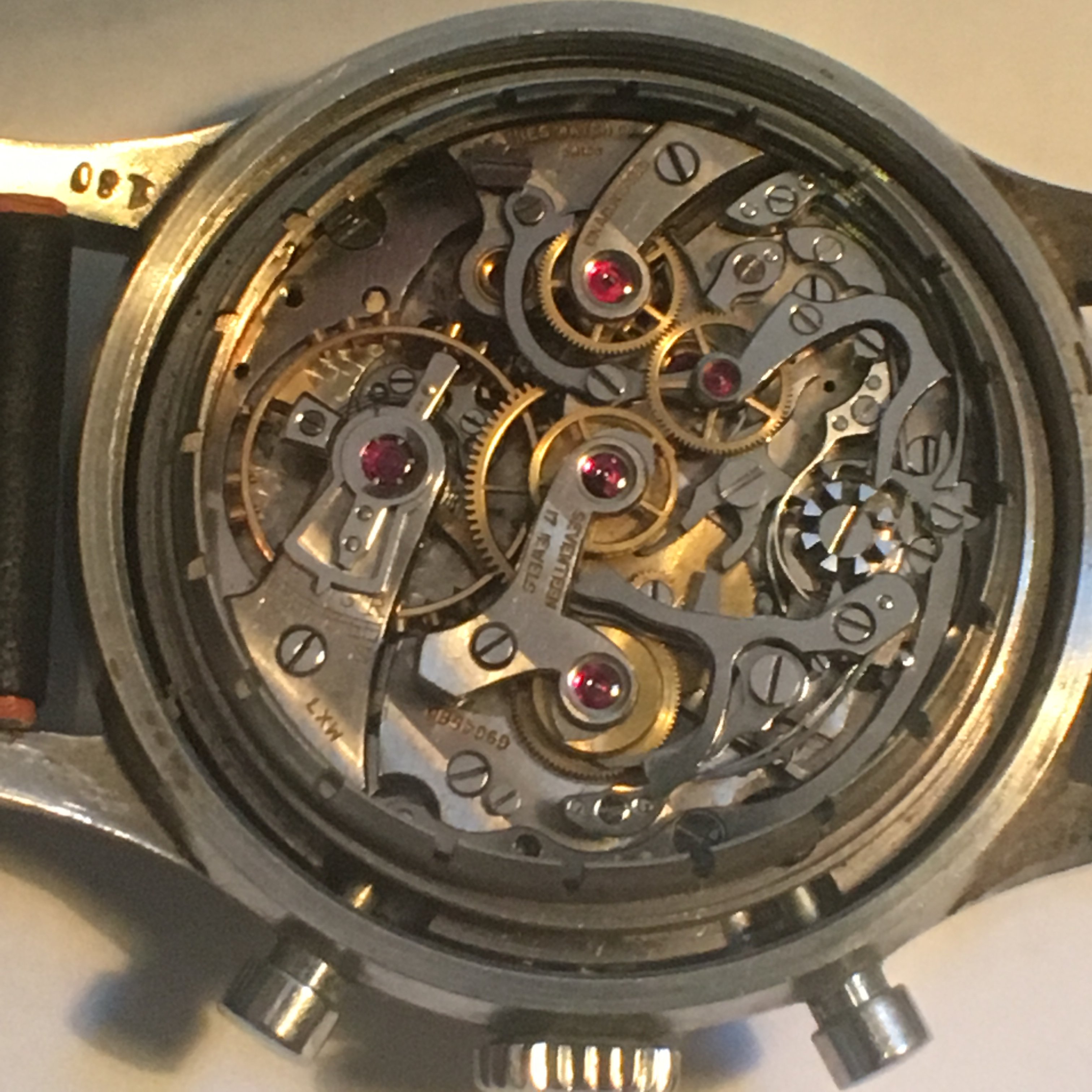

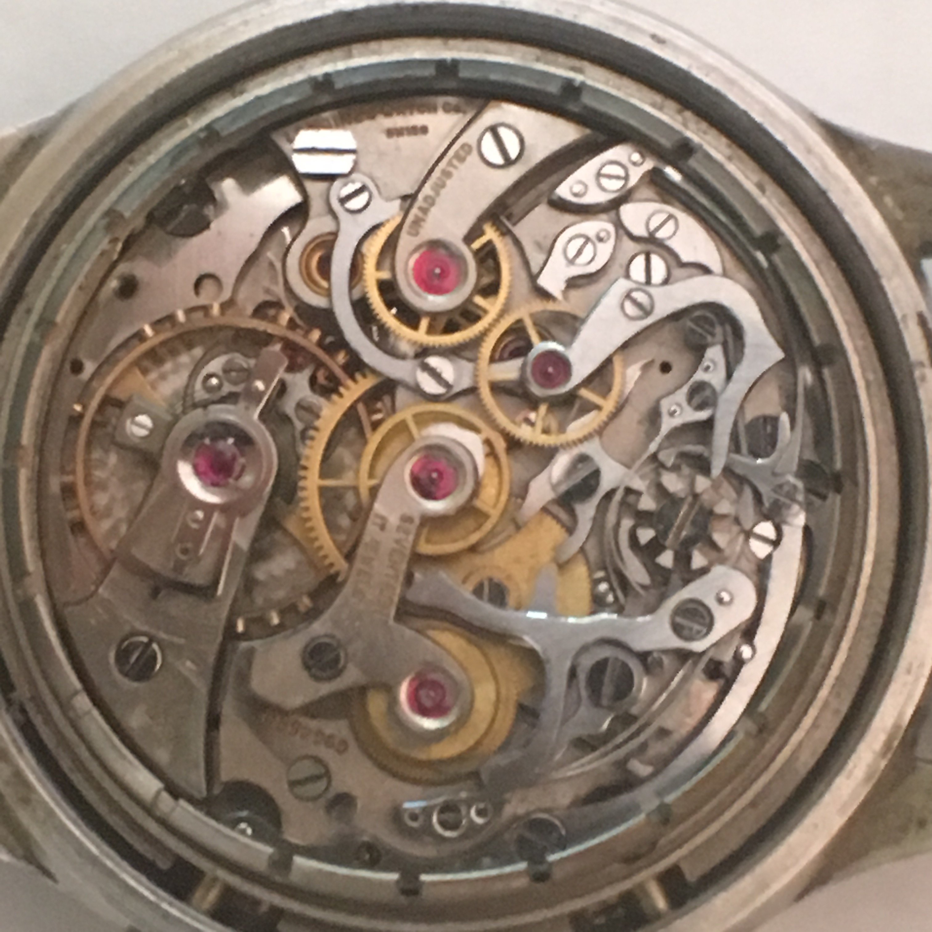

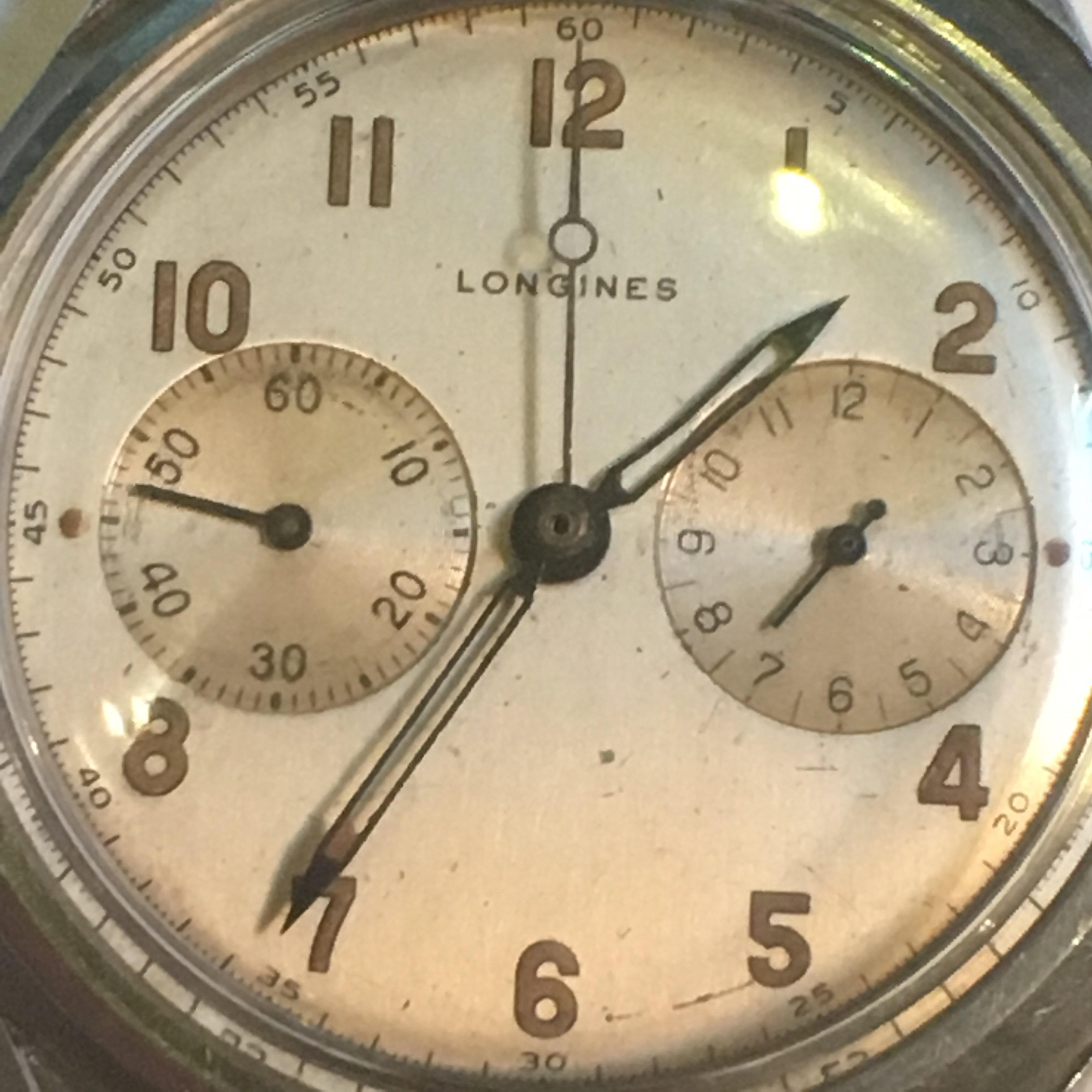

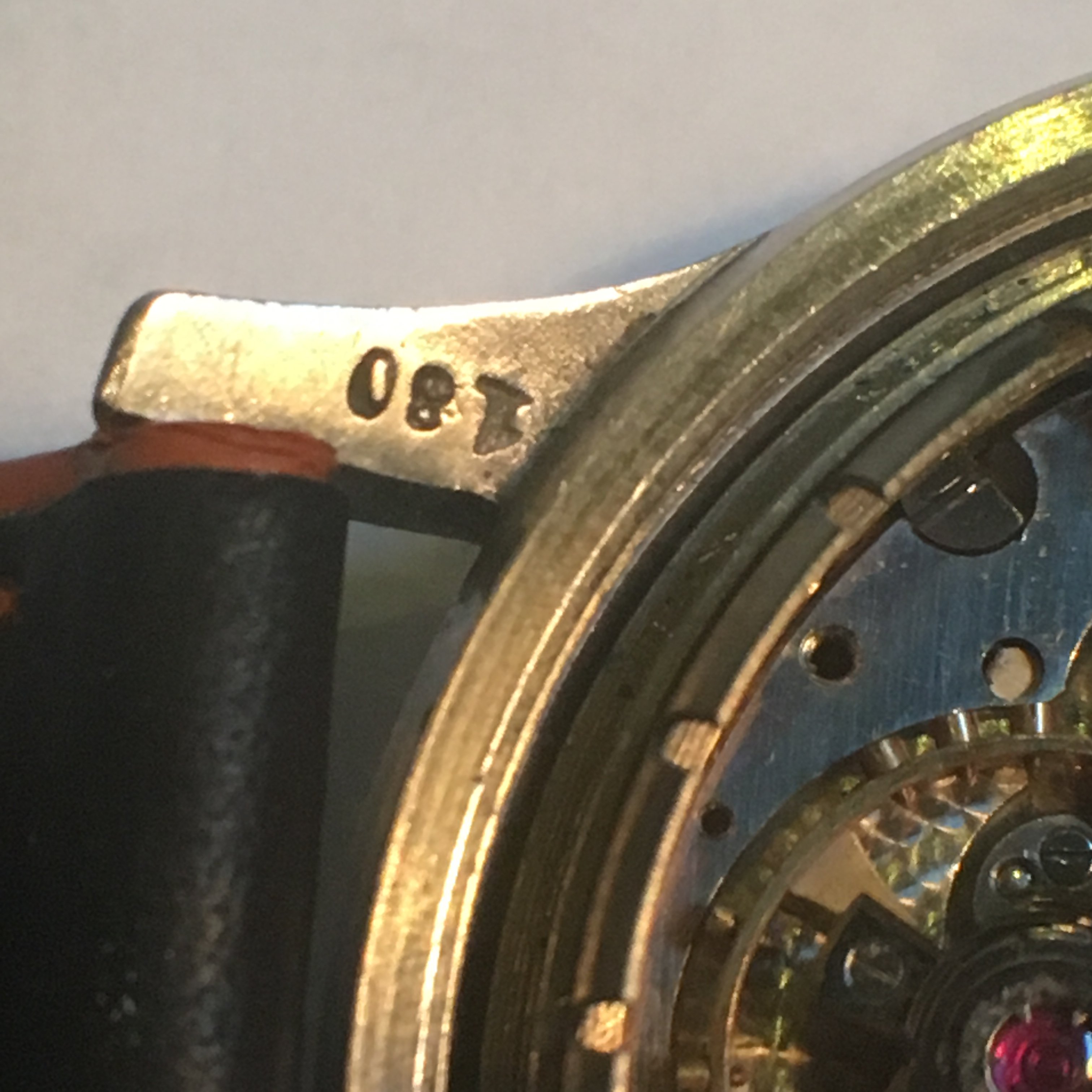

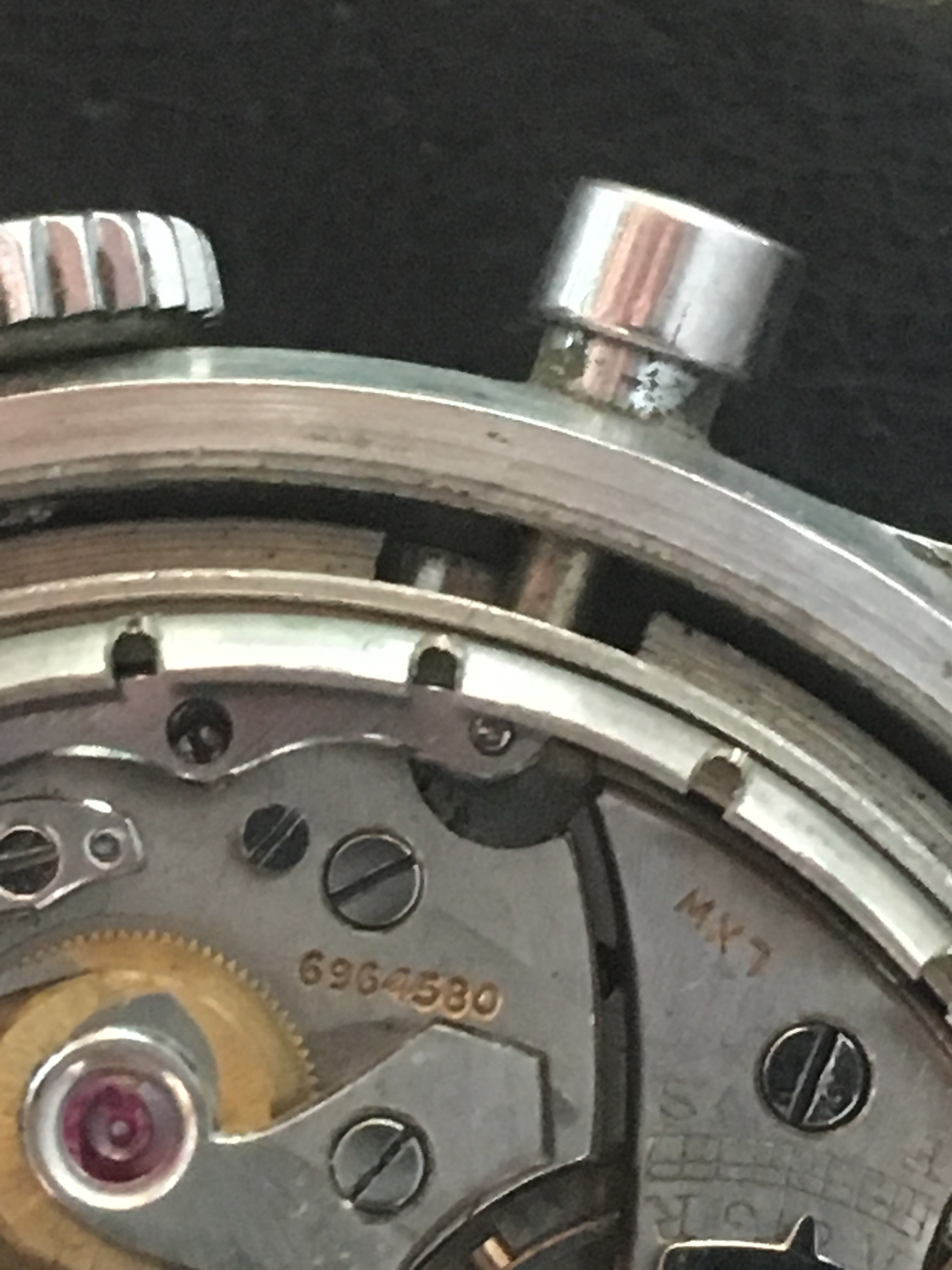

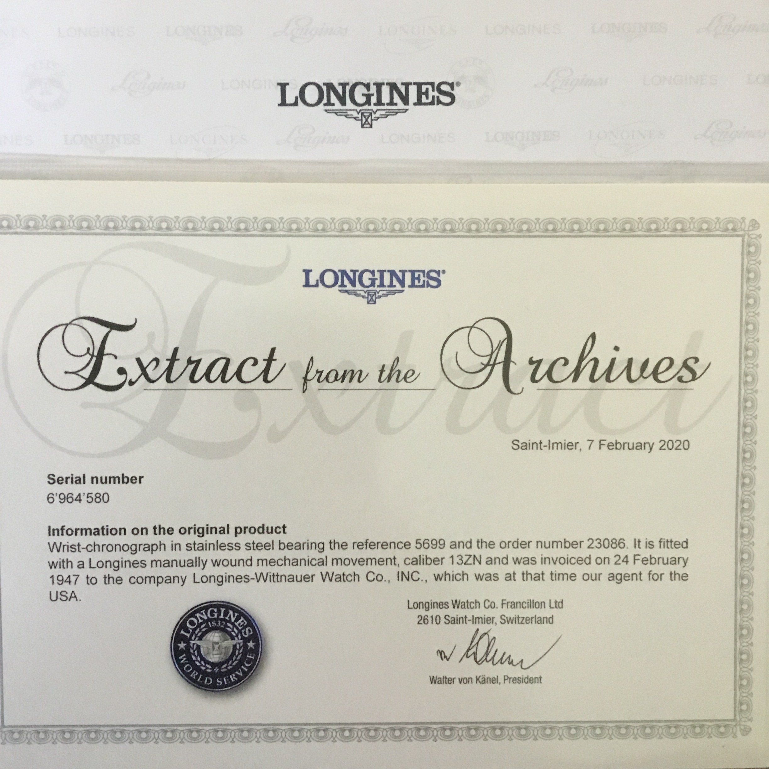

Hello all, I’ve been following along for a couple of years trying to learn from your wisdom before jumping in with my inquiry seeking advice. How far to go with this 13ZN-12/Sommatore/Doppia Lancetta? I have picked up on the importance of original dials and even with my limited understanding I’m fairly confident that this is not original (but could be talked out of that in short order). And, therein lies the quandary. Full restoration including the dial or skip the dial and restore the movement, hands, etc? I know this conversation somewhat happened with DNEM’s inquiry November last but this is a bit different because of the dial.
Thanks in advance for your input.

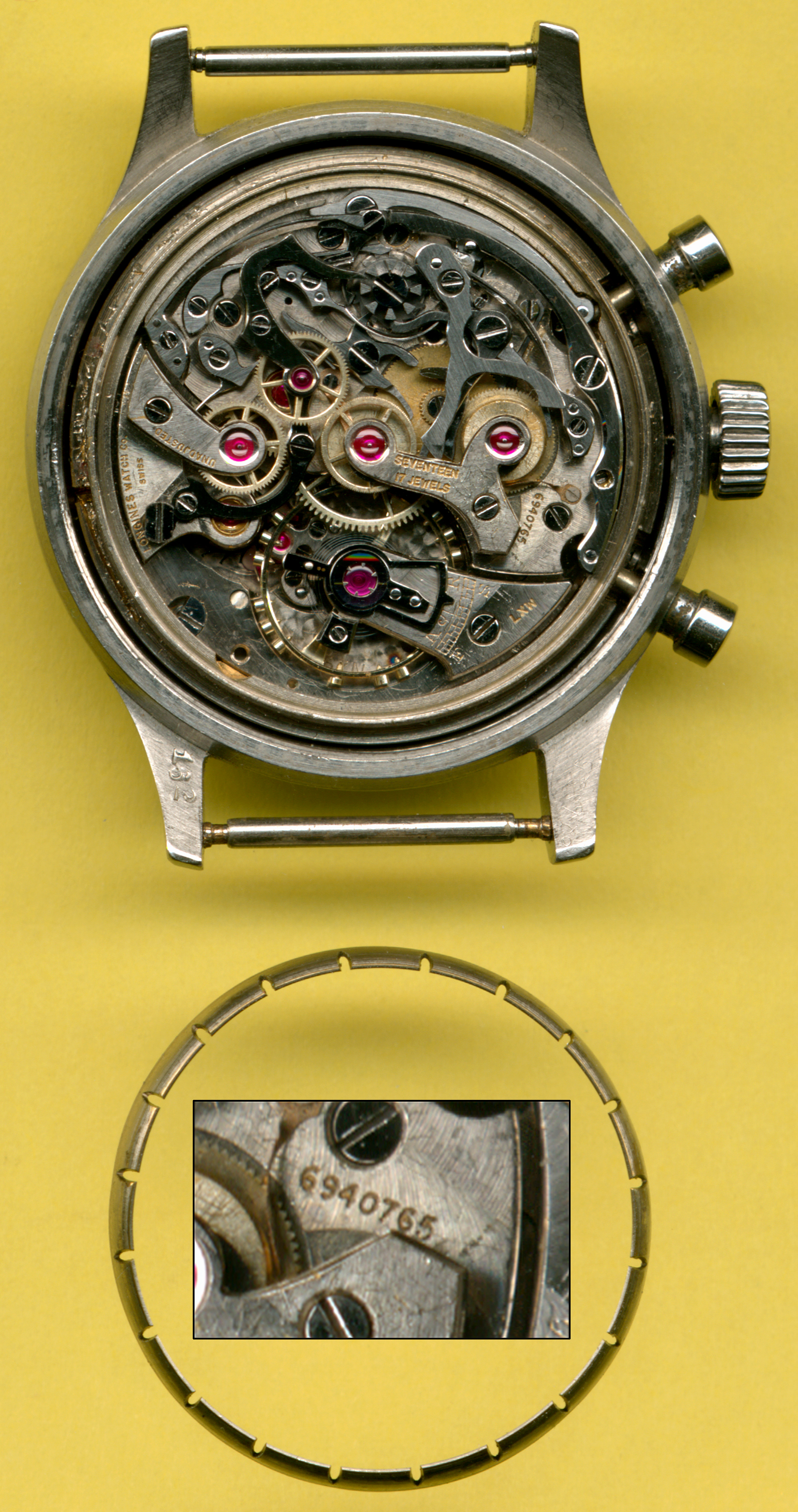

This seems to be the same redial as these two. I would leave it that way, because a restored dial always looks much too new, whereas the watch is from the 40s. At least the luminous material looks like radium...
I also think it's better if there are several (re)dials of the same kind. Then it could be a "service dial" - even if it is unlikely in this case; because of the length of the hands, which does not match the dial.
1,145
5,654

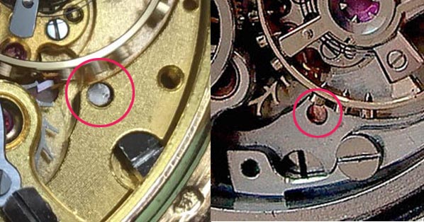

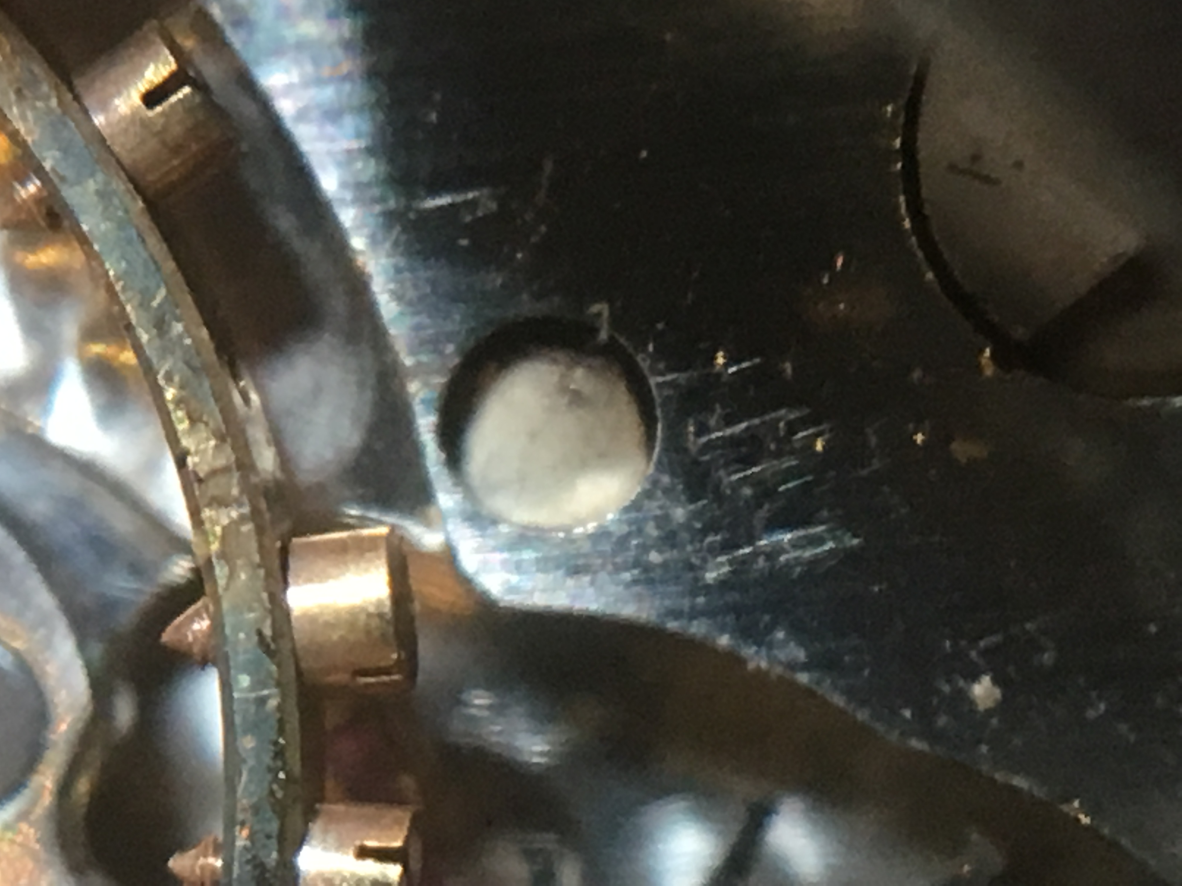

I could live with that dial, and I would just focus on getting the correct hands setup. Looks like there is a broken pivot for the sweep second hand to. @haggler

Ps those redials look really nice actually. The edges of the subdial and the printing are so clean, I’d be easy to convince they’re service dials- even though I know nothing about those 13ZN dials.

I would be happy if these dials were correct for this reference. Even if I don't collect watches for money, mine would be worth several thousands more. Here are some nice examples with matching dials:
http://watchexpertise.com/oldlonginespassion/Longines_Passion/sommatore.html
And as usual: Look for the correct lenght of the hands and in this special case the font of "Longines". Not to forget the dial feet, which are silvered (not coppered or copper)...
