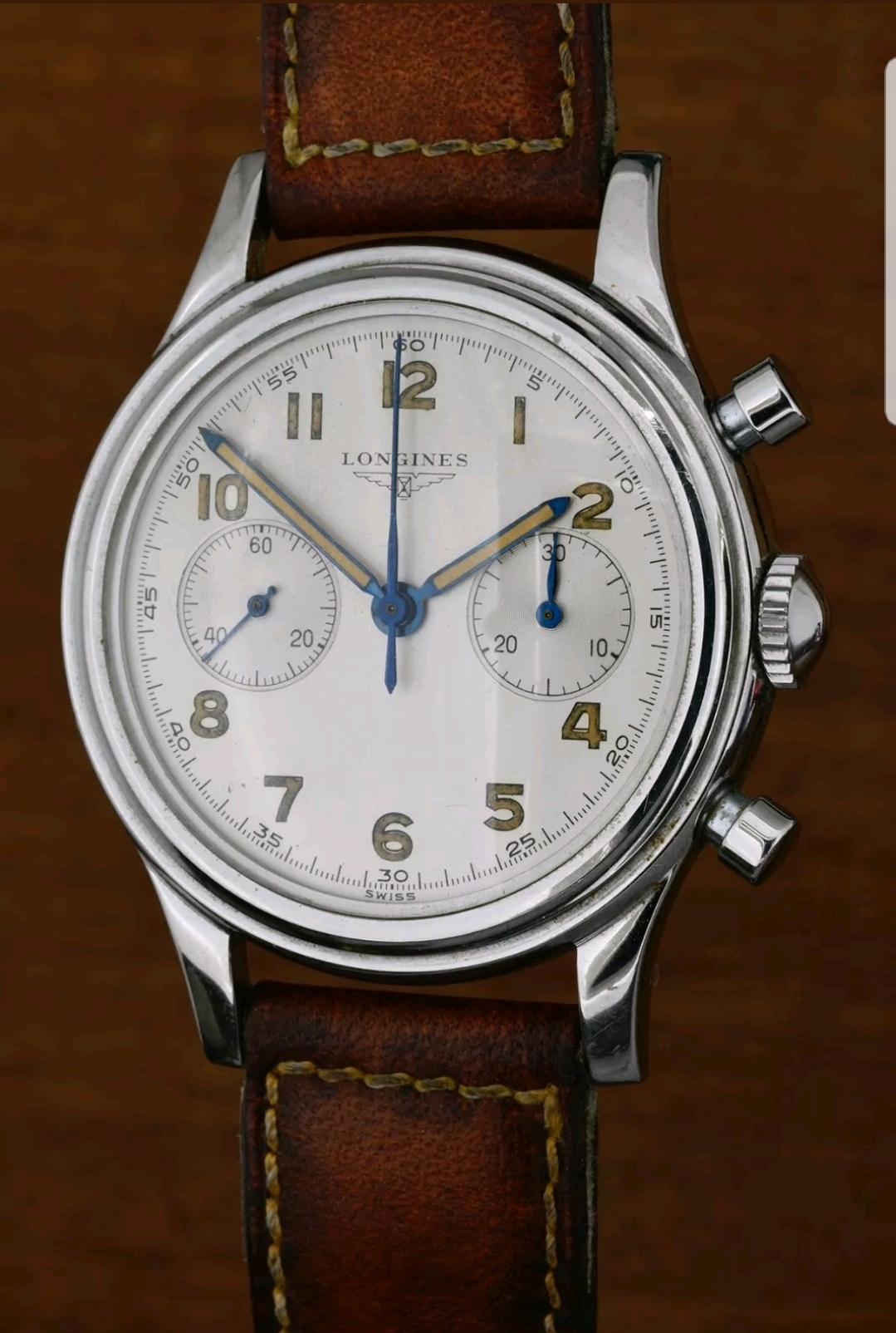

@LogisBizkit Great watch. Both case and dial design are relatively uncommon. Looks to be around 34 mm in diameter and from circa 1942.
@olivecrona and @minutenrohr It is difficult to tell from the photos but I wonder if either of you think that the dial looks to have been lightly cleaned?

Unfortunately not, I asked Longines for information about the serial number and they told me, that it was sold in Milano 1942

Franken?

Case-back is from a 30CH so yes, a franken. The printed winged-hourglass on the dial is also atypical for a 13ZN, especially given the approximate production date of 1943. Of course, a 30CH dial would not fit on a 13ZN without extensive modification. It would be nice to see the back of the dial but alas. Additionally, the crown is more indicative of a 1950's waterproof Longines (e.g. 6474 or 6075). The ends of the hour and minute hands look shorter than usual too (especially evident in the hour hand).
Maybe @divetime can shed some light on this one?

P.S. I will add that the backs of the lugs appear to have been polished. This conveniently prevents comparing the case number on the back (3) with the one on the mid-case to confirm their originality.

Many thanks for the insights! My point was that I never saw a genuine 13ZN dial with hourglass logo. I didn't noticed the issue with the case back or the polished backs of the lugs. I have a kind of feeling that the seller might be well aware of all this 👎

In my Opinion it is a 13ZN dial (though I haven´t seen one with printed hourglass - usually transitional 13ZN dials have applied hourglasses) because of the asymmetry of the counters. But the 6,4xx xxx movement number does not match a transitional dial. The case is for sure from a 30CH. Furthermore the minute hand is too long.
So we have a movement from 1943/44, a dial (if it is legit) from 1947 and a case from the early fifties (3rd revision of ref. 6075)
Edit: or a caseback from the early fifties, if the case is earlier. But (imo) this case style does not match a 6,4 mio movement...
