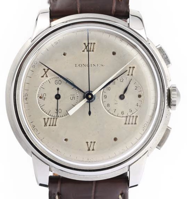

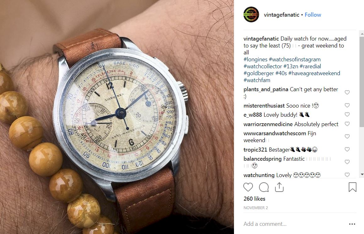

beautiful original patinated watch in a lovely small case. As we can see the crown was replaced to an original one! What are your estimations how much will it make?

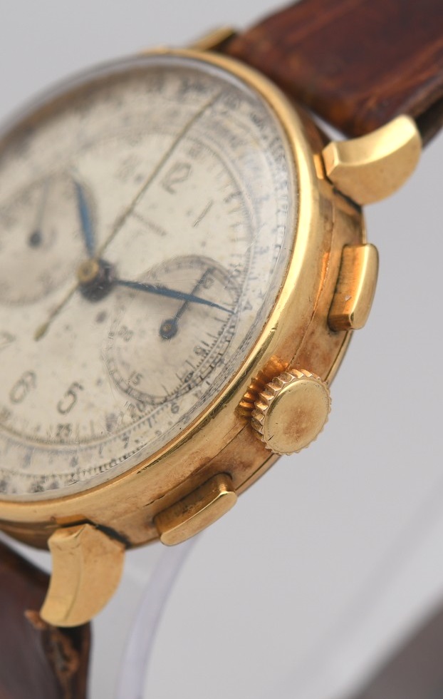

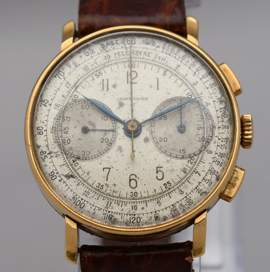

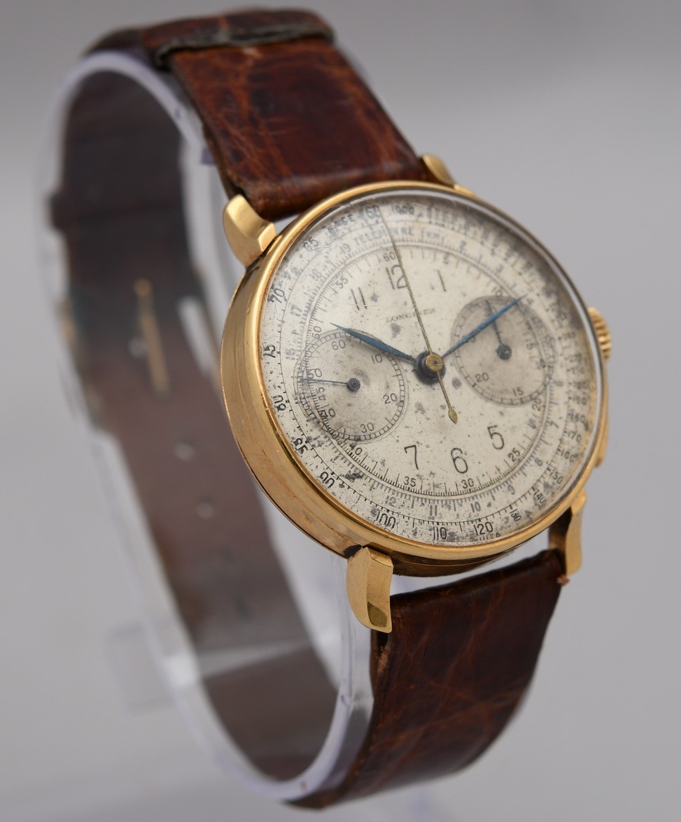

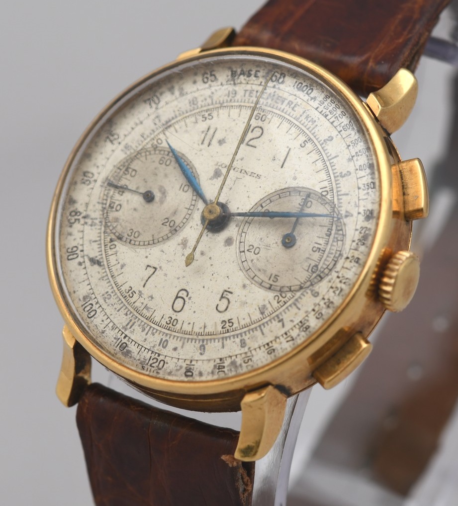

I have a friend who wants to sell his very nice enamel dialed original 1935 (Valjoux operated) 37mm chrono at a very fair price. The watch is 37mm bracelet width is 18mm. Watch has an abstract and numbers are confirmed. I would like to help my friend (I don't get any commission!) - if anybody of you (or friends of yours) might be interested I bring you in direct contact with the owner. Feel free to send me a dm
I believe that this exact watch was discussed a while back when it was on eBay. A number of hands appear questionable, as does the dial signature. Not one I would recommend.

Here are the pertinent facts, as I see them:
The handset is not consistent with other examples from the period.
The dial signature is not consistent with other examples from the period.
Numerous examples of this exact dial can be found without a signature/sterile.
My belief is that the original dial was replaced with a generic one for the Val. 22GH, and a Longines signature was poorly applied. The dubious handset supports this belief as it indicates that the watch has undergone alterations, which were not in keeping with the original design.

Thank you dirty dozen! Very appreciated. If this is the truth i would obviously not recommend the watch either. Nor I nor the owner were aware that this watch was extensively discussed previously - and he was a bit shocked about this. The owner bought it on Ebay and the seller guaranteed the dial to be original... However the current owner decided not to sell it, He will have it examined in St. Imier and he will let us know about the result.

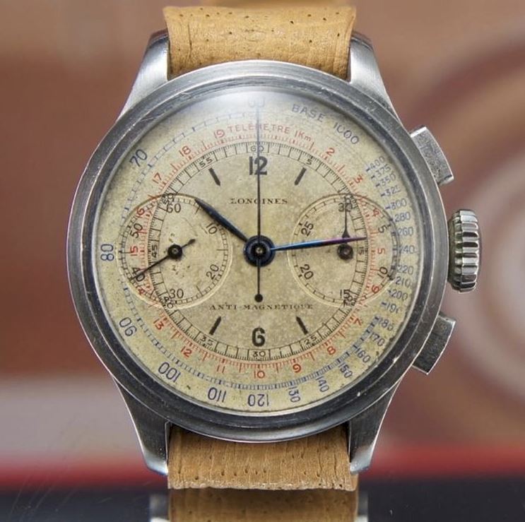

Well of course if everybody keeps posting live auctions they are bound to become hilarious one way or another.
I sure am glad I'm not buying chronographs. I certainly would not be laughing if people were posting an auction I'm targetting.

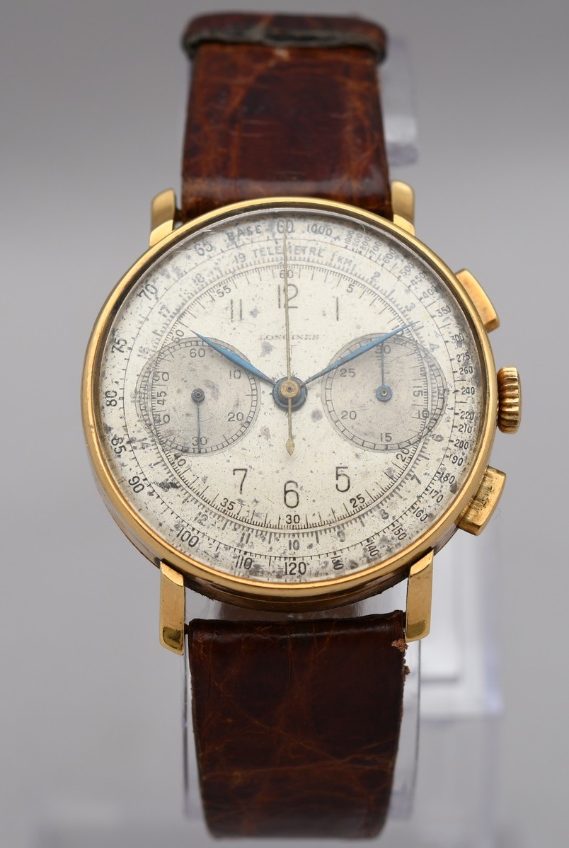

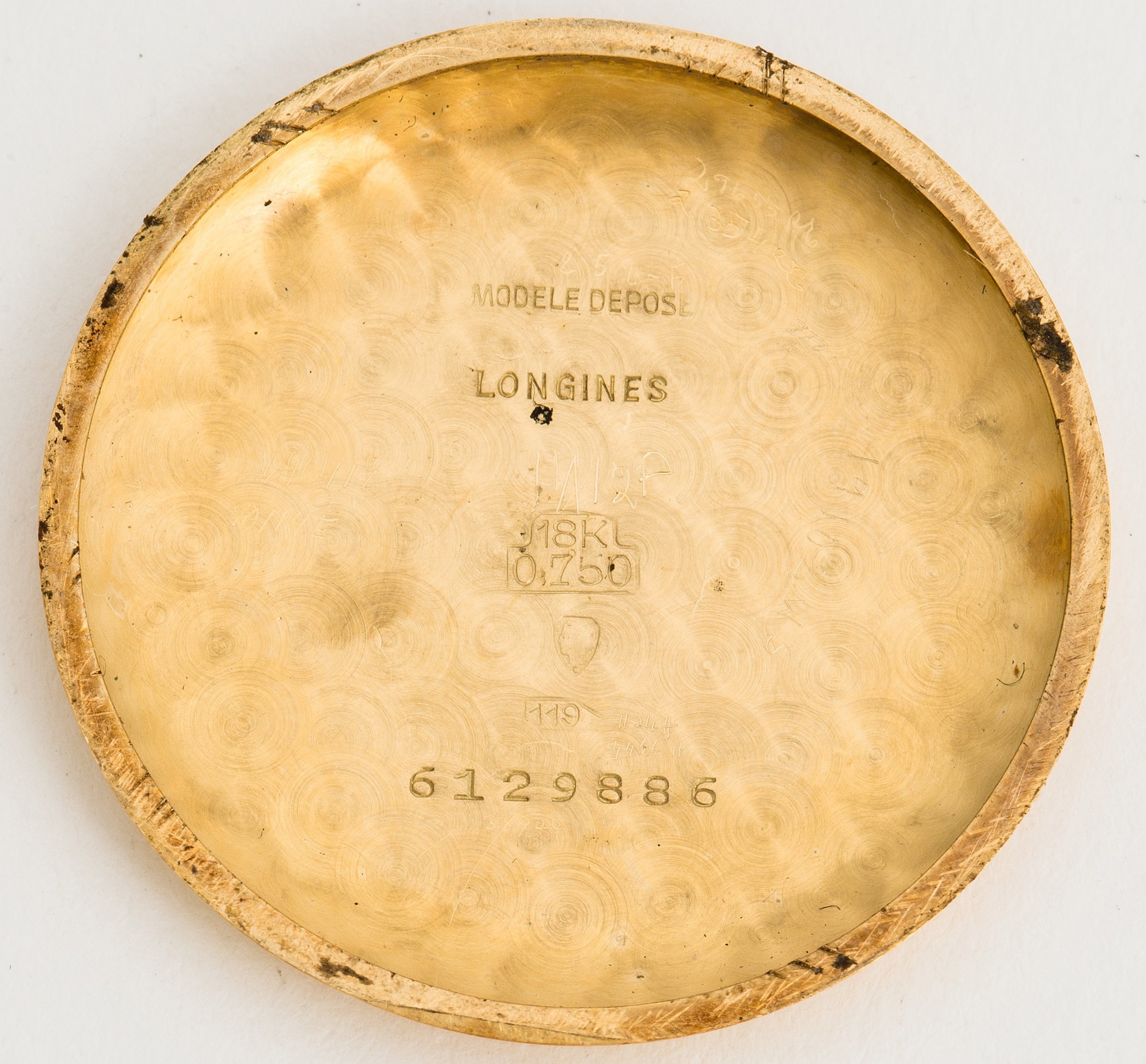

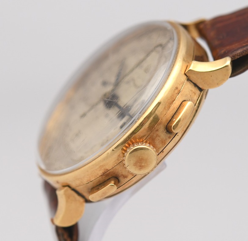

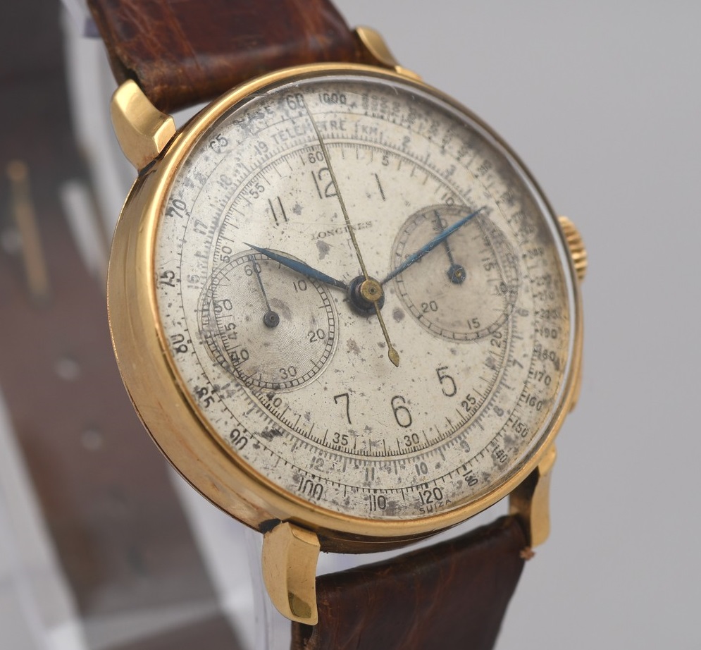

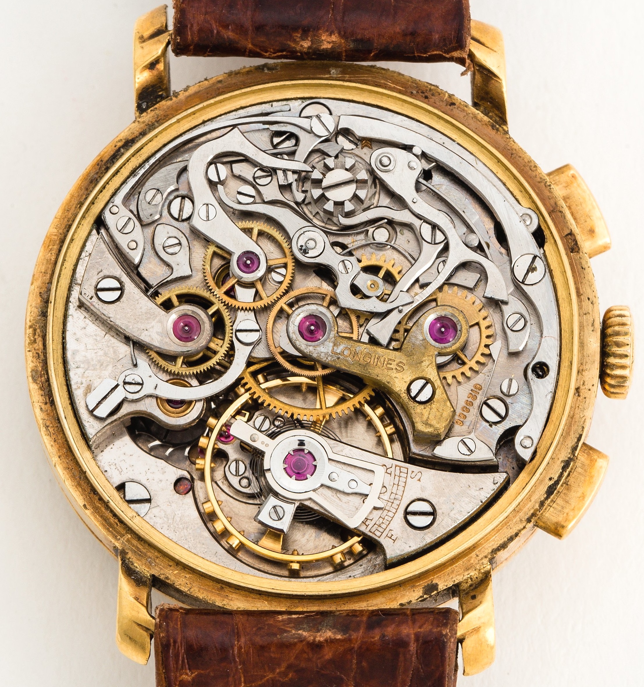

On the other hand this is a completed auction.... has it been discussed before somewhere around here?
https://www.ebay.co.uk/itm/Vintage-Longines-18K-38MM-Chronograph-w-13ZN-and-Original-Dial-/132854556729?hash=item1eeebfa839:g:IH0AAOSwq2xb2Ynr&nma=true&si=7YRRJ%2FOVq4bCEI5b50aEqNVdE%2Bg%3D&orig_cvip=true&nordt=true&rt=nc&_trksid=p2047675.l2557
