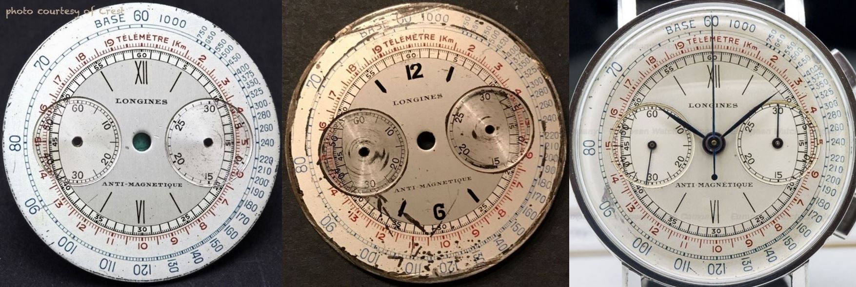

What would be the value of this type of dial if original?
2,057
25,237
Depends on the size. 29, 32 (flat) or 34mm (domed). F.i. if you buy a "Tre Tacche" or another sought after steel/waterproof design with an ugly redial for maybe 5000-7000USD or €, then a flat 29mm with matching hands would be worth between 15000-25000 (or more).

I disagree. For reference, here is another cal. 25.173 with the same style of case, made in the same year. Notice how the sub-dial is identical to the "Chinese" piece.

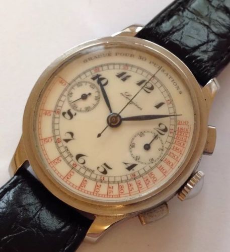

The hands are to long...
I.e. not matching. So the dial could be a replacement, maybe taken from a 13.33Z.?
There are not much 13ZNs with enamel dials. But ok - the movement number is an earlier one.
1,525
4,430
Possibly later crown too.

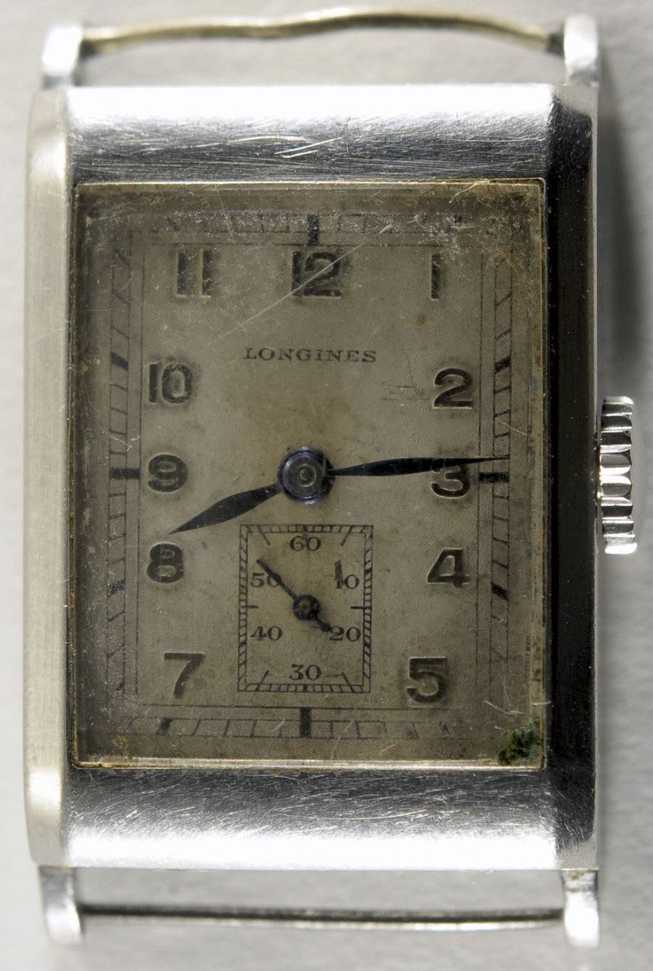

The 13.33 in Goldbergers "Longines Watches" (the 1st one) with the same "swiss made" dial has a P+D on the inner caseback. That´s Pérousset + Didisheim, Longines distributors in Argentina. Movement 4992138.
2,829
4,948
Should it not be "Suiza"? Not certain.
2,057
25,237
Maybe they took the "Swiss made" because of the symmetry 😁.
Let´s forget about this watch. A 1929 dial on a watch from 1936, wrong hands and a movement state that points to a water damage.
In my experience the dial dies before the movement if humidity works on a watch.

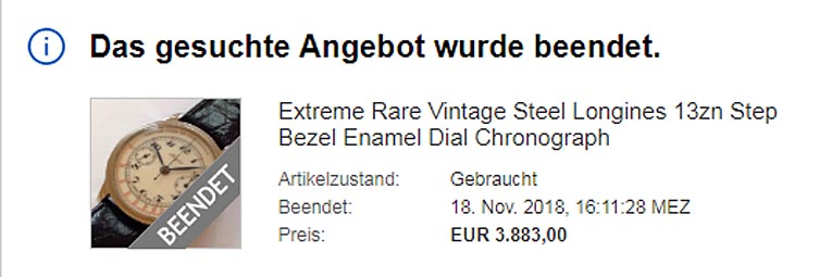

What say the gurus? 🍿
https://www.ebay.com/itm/Longines-M...e=STRK:MEBIDX:IT&_trksid=p2060353.m1438.l2649
