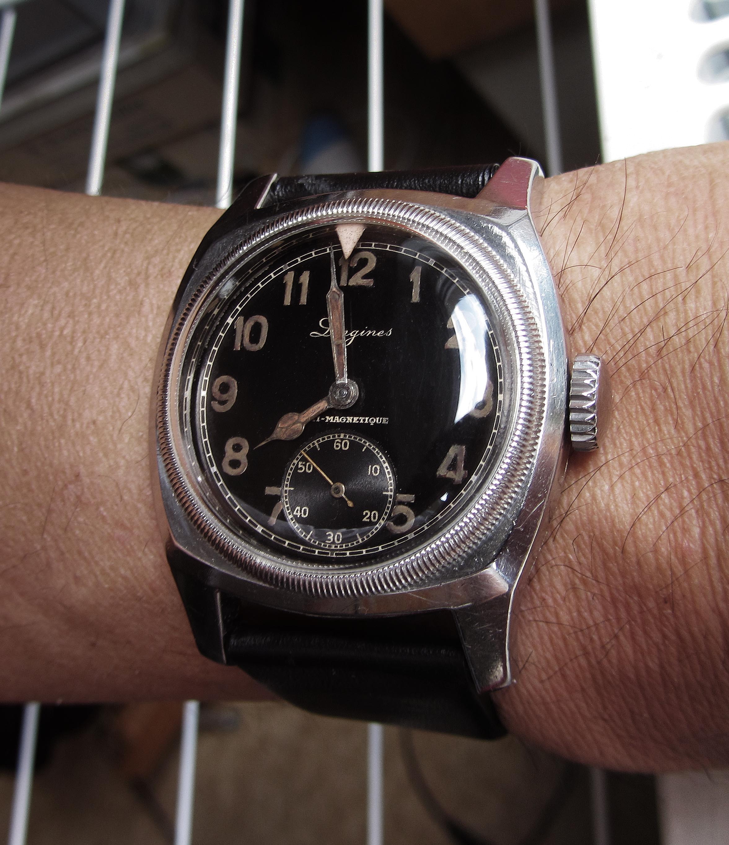

Case should be French as movement bears an "M". Signature and other details closely resemble those found on 5415 dials that are seemingly correct. Not a 13ZN that attracts me.
57
47
Case and movement serial are matching too.
If the papers come back with France as the country of destination then those things begin to line up. The outer track and the subdials are identical to several well known 5415s. The hour numbers are not identical. I can check my 5415 to see if my dial says Swiss on it
2,829
4,948
Agreed. Case serial number could have been added by anyone at any point.

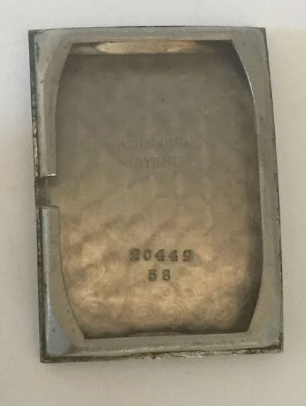

The stamp puzzles me. Below is another one from the late 1940's. Also below, it appears on a steel case bound for China in 1939.
What does the front look like? I’d love to see a Chinese market watch for that era!!!

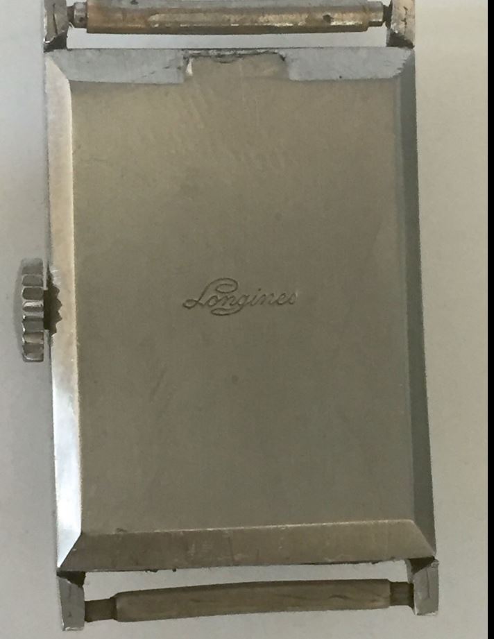

As you will note, a cursive logo is quite unusual for the time.
Nice.... and interesting. Thanks for showing! Is it yours?

Not mine. The movement has an interesting marking so I saved the images.

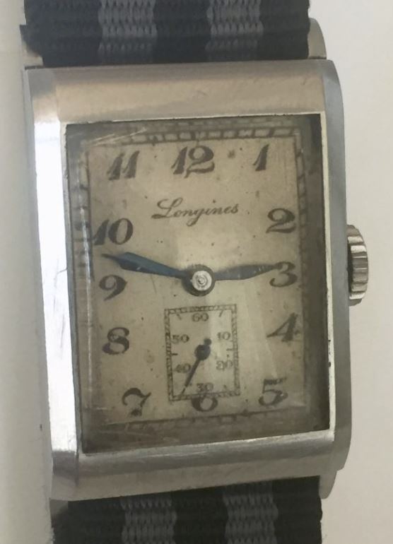

1,127
3,950
Seriously?! I am not a Longines expert... could you tell us why this is a redial? I am very curious about it!
2,057
25,237
...because the edges of the subdials are rounded and the character style of "Longines" and "Anti Magnetique" is not correct.
