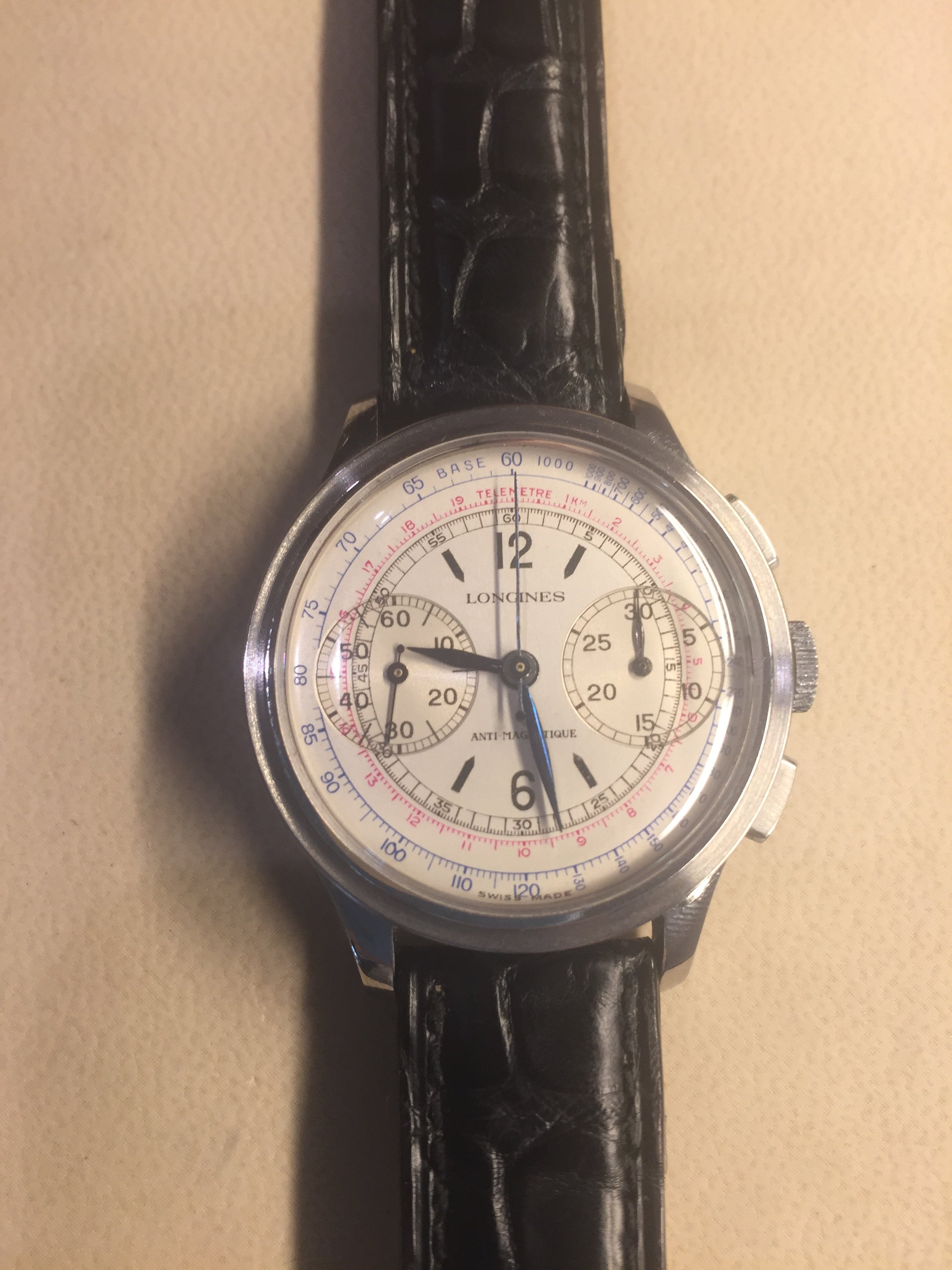

What do people think about this one? It is a 1940 model. I am interested in views on the numbers on the two small dials and the 12 and 6 on the hour. Thank you.
5
Hi, thanks for commenting. I was considering purchasing when I first saw it, so I would appreciate if you could provide more detail and views. It has a certificate, it is in steal, it is in very good condition but personally I have questions on the dial. But I am by no means an expert on classic watches.
1,145
5,654
First of all, when you find a desirable dial from the 40's in such crisp condition the alarm bells should ring. No fading on the coloured scales. Numbers on sub-dials
are too large. Longines logo is too large... I would
But please get a second opinion, I'm just a collector. No expert.....
2,057
25,237
I麓m not an expert as well, but the dial above is a redial (as Radiumpassion has stated) and the value of a 13ZN is dependent on its dial.
5
Is it possible for an original dial to have different styles? In the watch above the 6 is Open at the top but closed in the hours or the two small dials. I just wonder.
2,057
25,237
Yes, it麓s possible to have different types of "6" (open and closed) on the same (untouched) dial.

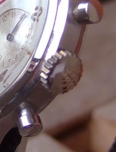

Very nice watch. Send a message to member "aldo"
He麓s able to produce such crowns.
2,057
25,237
4650 isn麓t so much for that watch - even it is only 34mm. Maybe the seller considered the problem while he thought about the pricing?
Crown looks worn but ok to me.

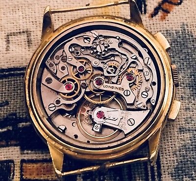

1,015
3,986
LXW on balance cock doesn't jive with Fab Suisse...
