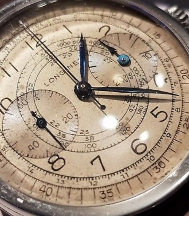

Correct me if I’m wrong but this one sure looks refinished...

Edges of sub-dials look a bit soft but fonts appear spot on from this distance. Would be nice to see a larger shot of the signature but I vote original. Hands, case, and crown look good too.

I agree with DirtyDozen's assessment. Looks like a nice original example. Also, I chatted with the dealer and it sold within a few hours of being listed...good pieces move fast!
To me those subdial edges would feel dispositive and I agree a higher resolution picture would be needed, but I’m removing the picture as I don’t want to cast a shadow on the watch if you think it’s legit.

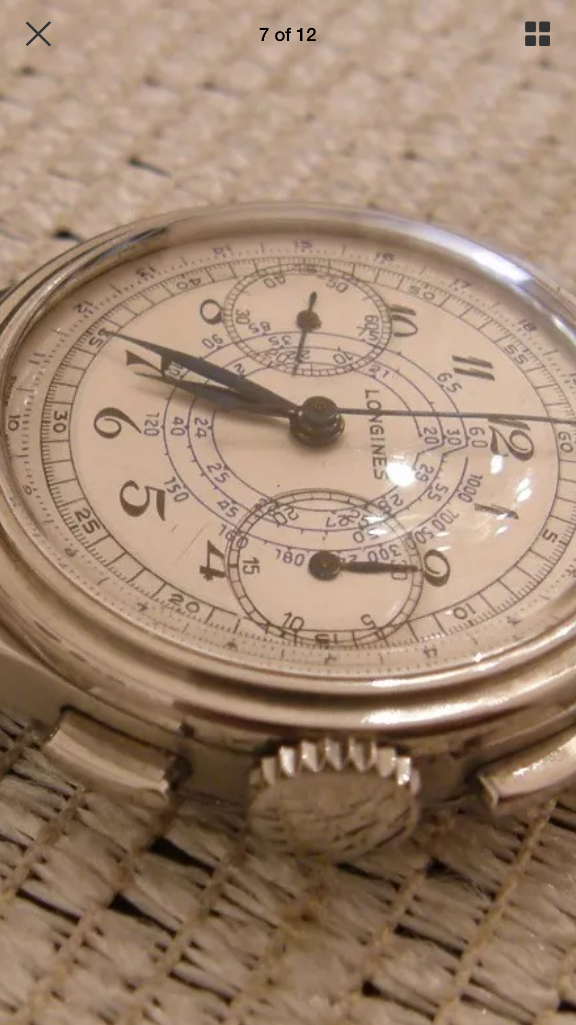

I am.a bit confused on this one...
What do you think?

Impressive print quality. But does look like the subdials do not have original surface. Bad photo noise reduction? If truly looks like that, I wouldn’t pay original dial prices. Maybe redone by Longines?

Hi,
I´d say look on the lenght of the minute hand (too short!), the uncommon "Longines" characters (never seen on a 13ZN dial) and the design of the counters (more like the dials past ca. 1944, not matching to a "tachymeter-spiral"), the lack of the word "BASE" in the tachy-scale...
rgds - h.u.
1,525
4,429
It isn’t a spiral either. Very odd, first time seeing that. Just concentric circles, not usual Longines. Similar problems, not likely Longines dial here.
What do you think?
This is a redial.
Also a redial.

This is a redial.
Also a redial.

This is a redial.
Also a redial.
How do you tell if something is a redial?
Pending link I'll bet 😜 Lol
Familiarize yourself with the nuances of comparable, original dials.

If subdials on a vintage metal dial on a 1960 and earlier Longines watch are completely flat, it is not in original condition. Skimming a dial to remove the original surface and print was a common method to prepare a dial for reprinting.
