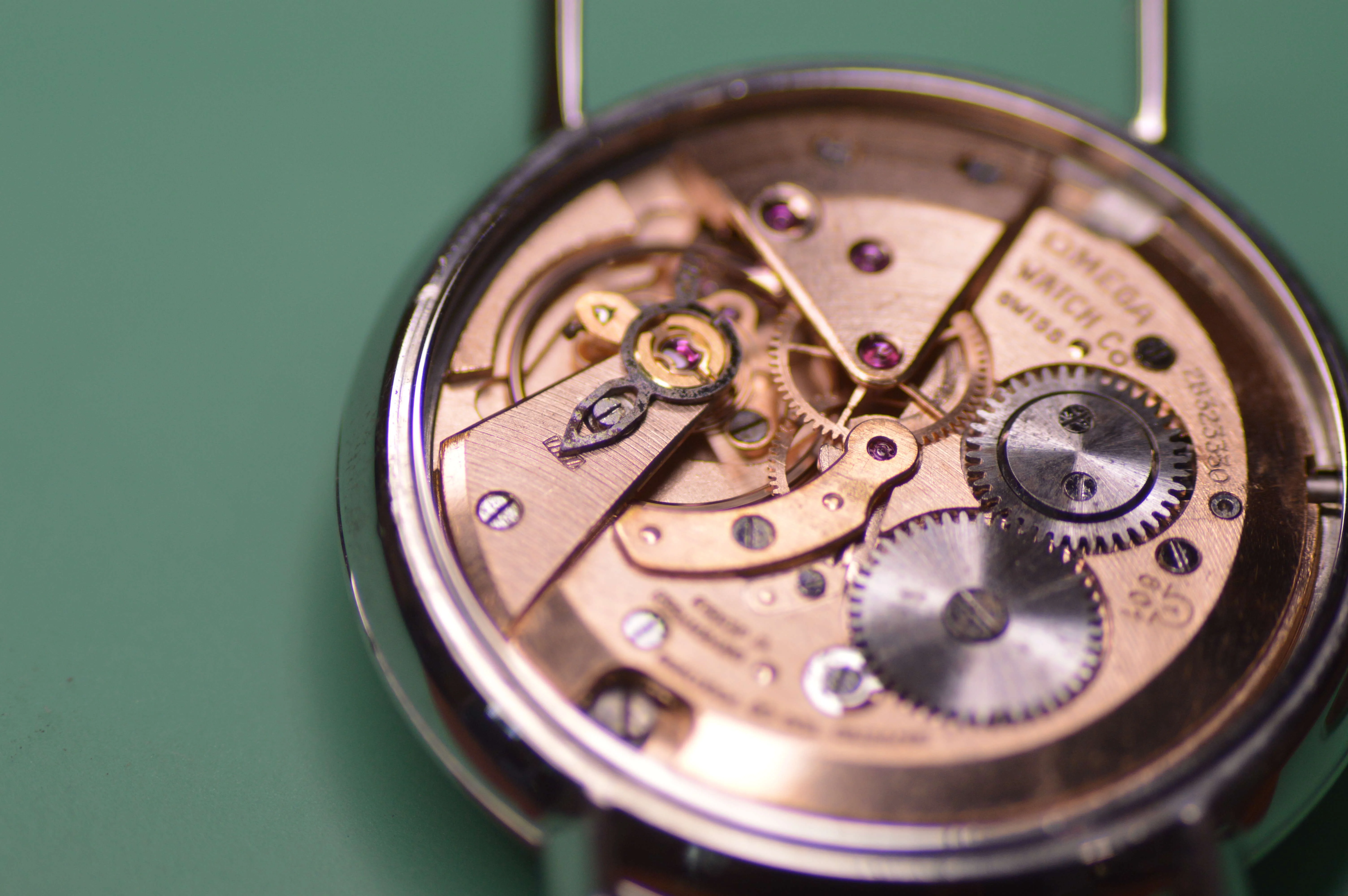

Hi all-

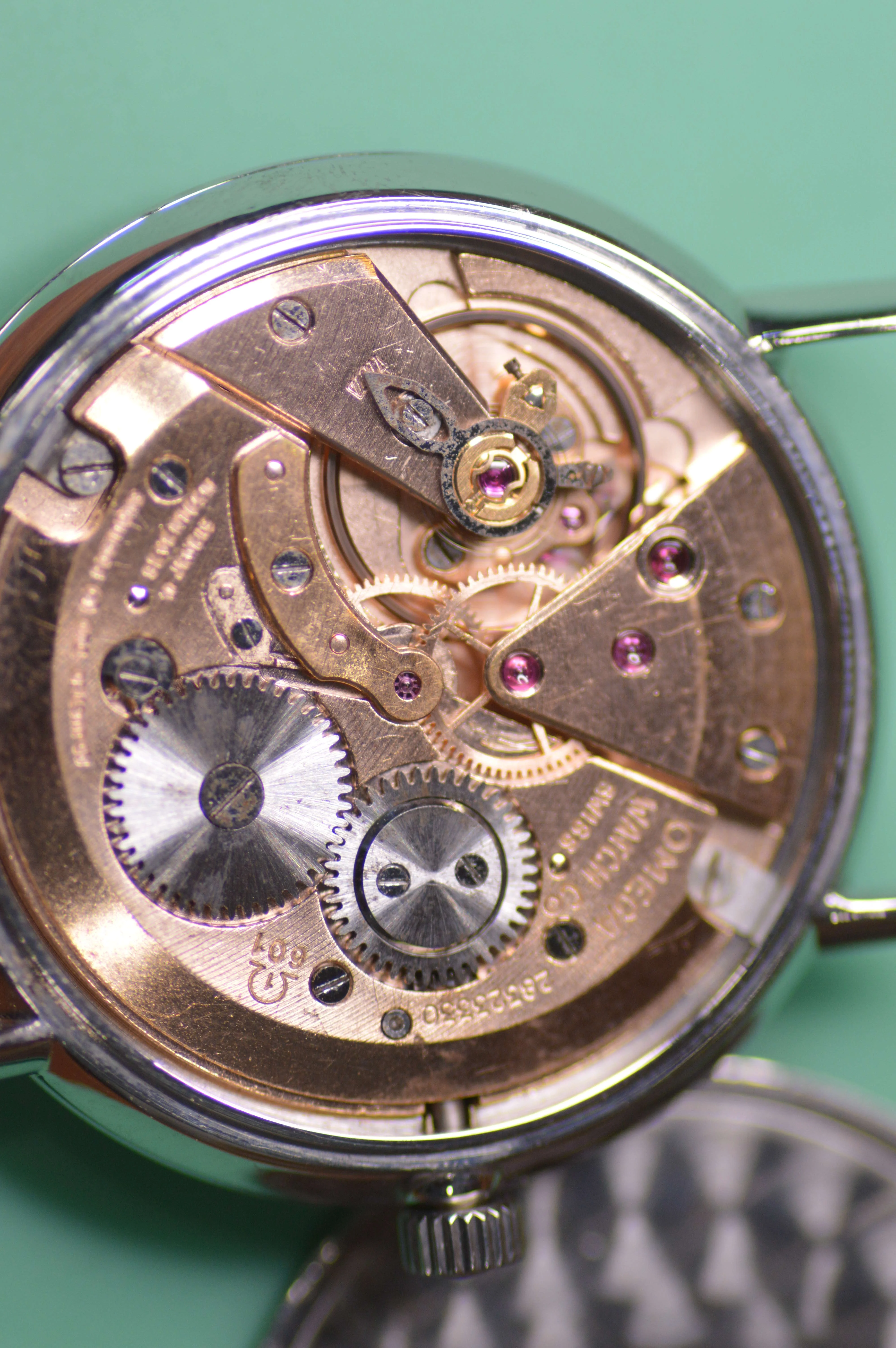

I've mentioned in previous threads my attempts at my Omega 601 with the busted dial foot/glued on dial. I finally got to taking it apart today (and it actually started running, low amplitude, but encouragingly!) and have many of the replacement parts already. However, the one I am unable to source is the crystal. It seems to be the kind that comes with the bezel ring attached. However, mine looks like it was replaced with a non-OEM at one point so is very clearly not the right one, and doesn't fit in the tension ring anymore.
IS there a good place to find a replacement for something like this (in a silver finish)? Or at least: figure out something compatible?

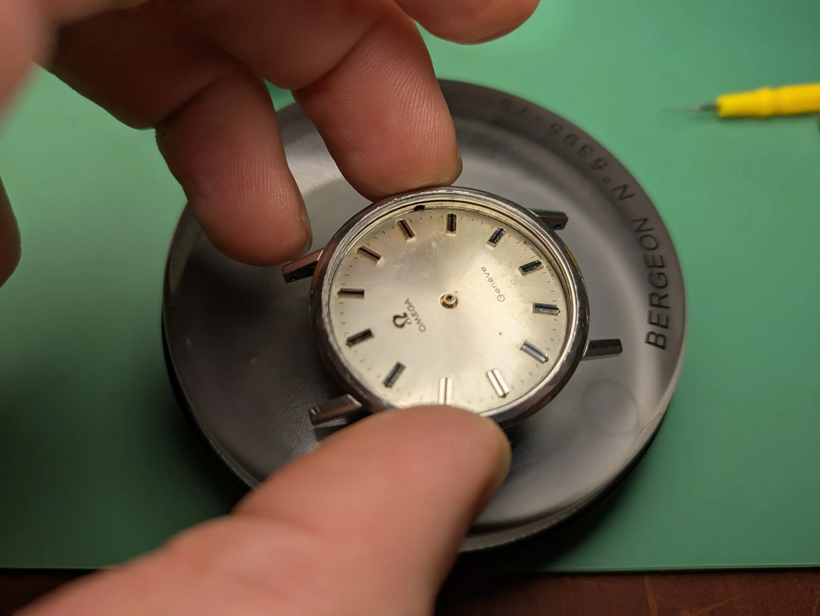

You wouldn't be able to tell me if there is a movement ring, or the dial diameter too, would you?
I'm trying to case the movement, but I'm finding that when trying to put the movement in place, the dial lets it go 'too deep' into the case, to the point the dial is below the stem. There doesn't seem to be anywhere for the case clamps to 'hold onto' either.
I guess a 30.5mm dial (it came with a 29.5mm dial, and my replacement is as well) could potentially be 'clamped' by the bezel, then the clamps could push it 'away' from the case back against the bezel? BUT every 601 dial on ebay seems to be a 29.5mm, so that makes it seem like I've just screwed something up, or am missing something.
Here is a photo of hte movement 'front loaded' (pardon my fingers, I'm back and forth between the computer trying to figure this thing out), and how far down it goes. This ALSO has the case clamps out. The ONLY place I can catch the case clamps(and barely) is on a ridge that woudl stop it from dropping all the way through.

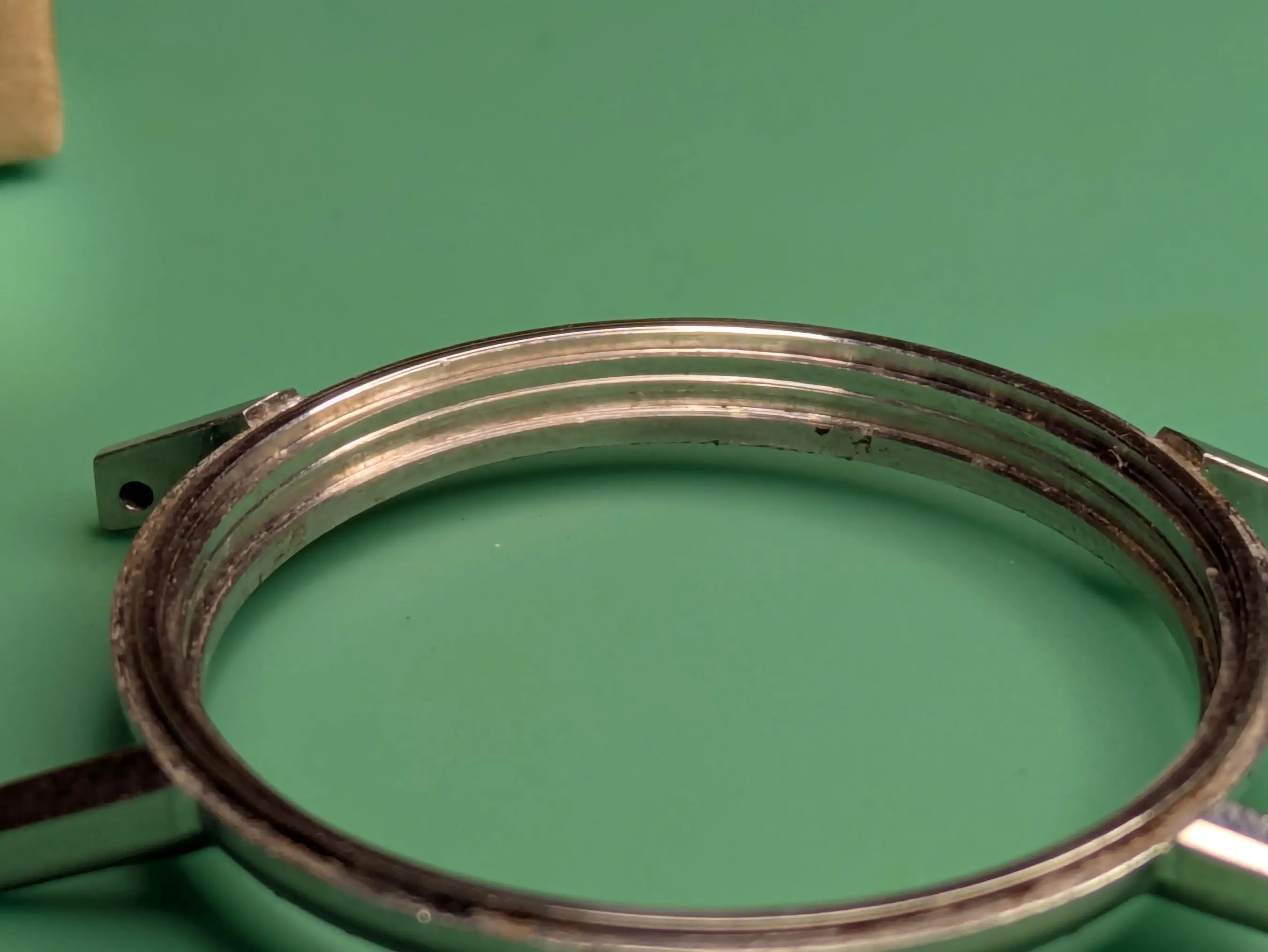

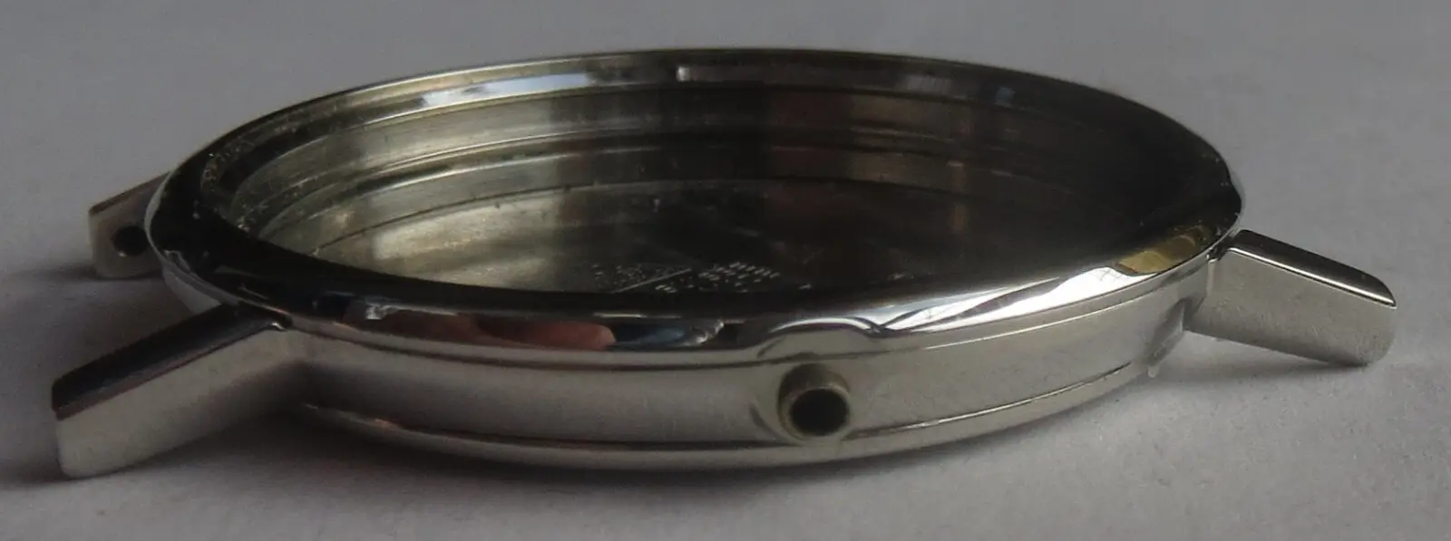

Actually.... DID someone modify my case?!?!
Check out the ~4th picture here: https://www.ebay.com/itm/326765194642
VS the inside of my case:
I'm missing the 'top' ridge! It looks like the case clamps should sit in that ridge in that other movement.
The plot thickens 😁 I've done a 'make an offer' on that ebay listing, It is a way nicer case than mine ANYWAY (even if it IS quite a bit polished), and as I said, already way past "good money after bad" 😀

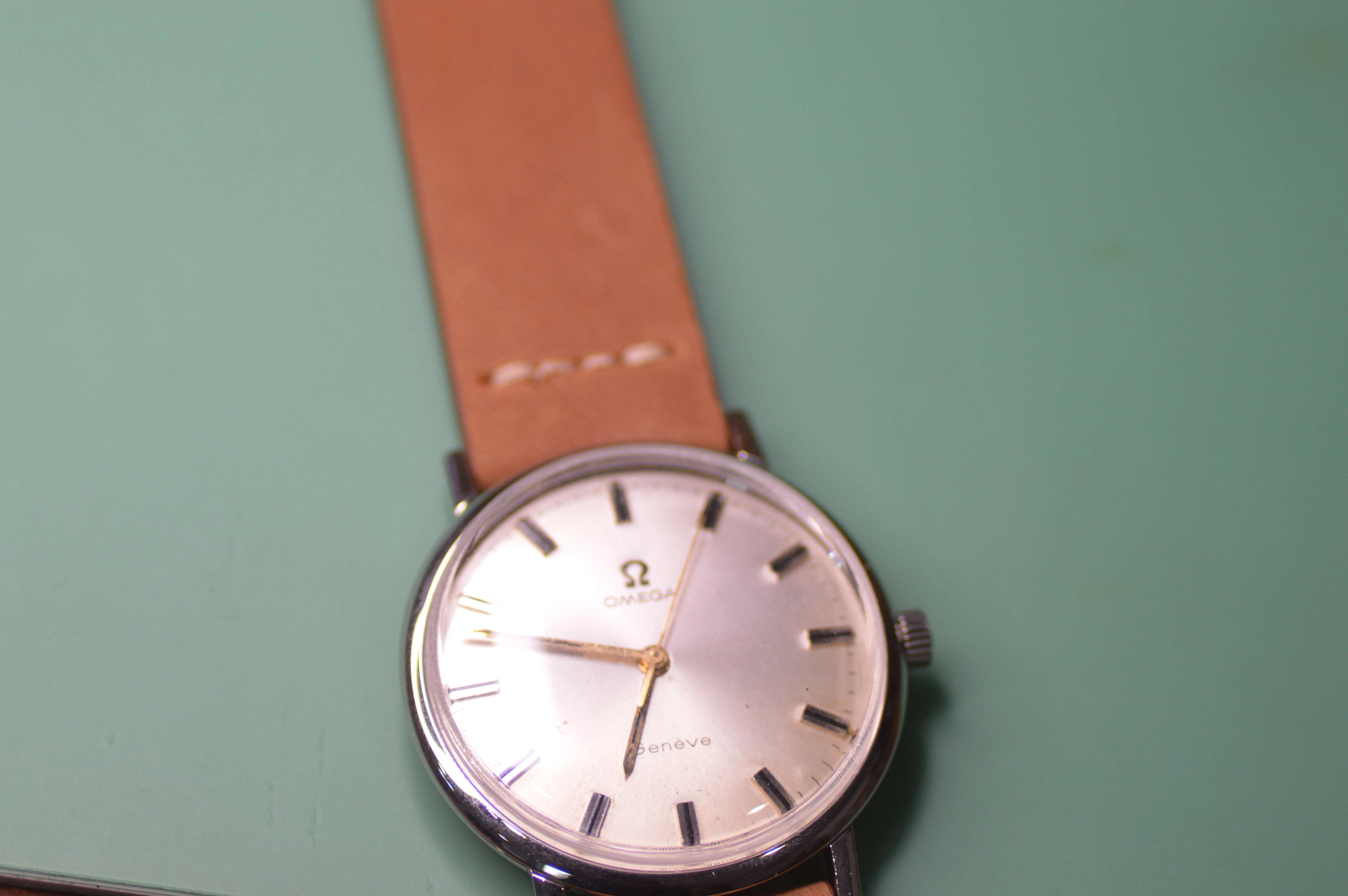

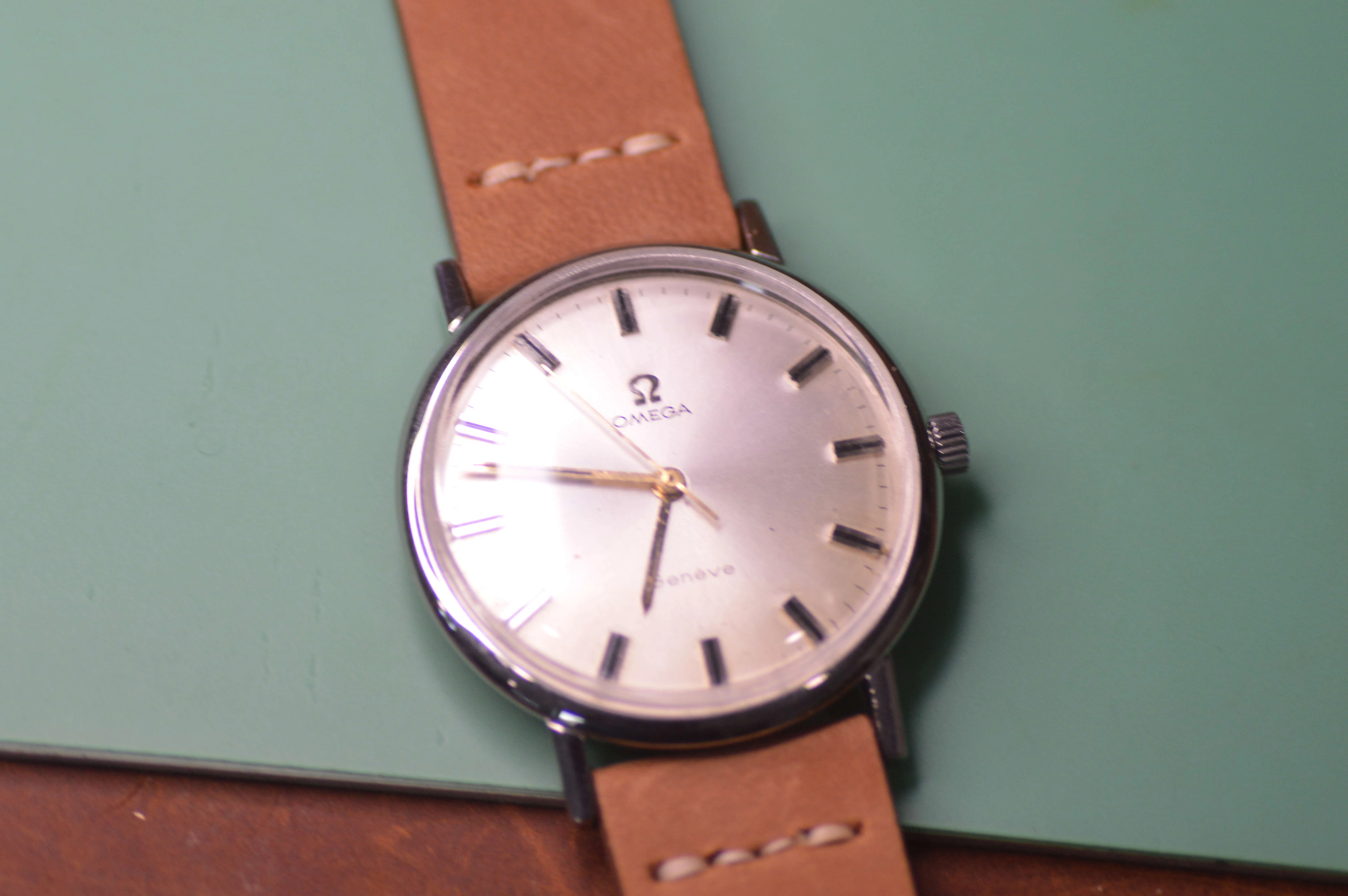

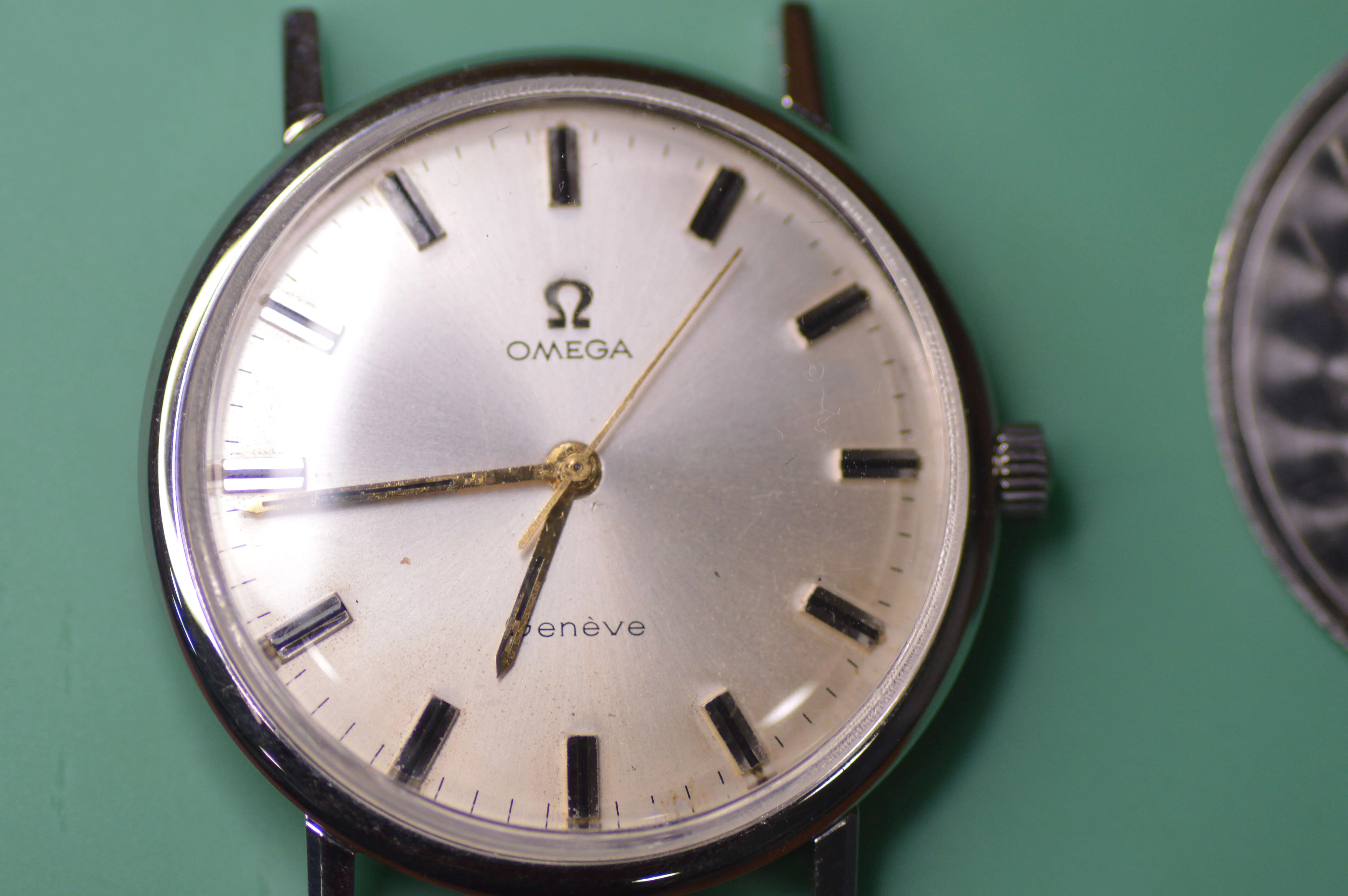

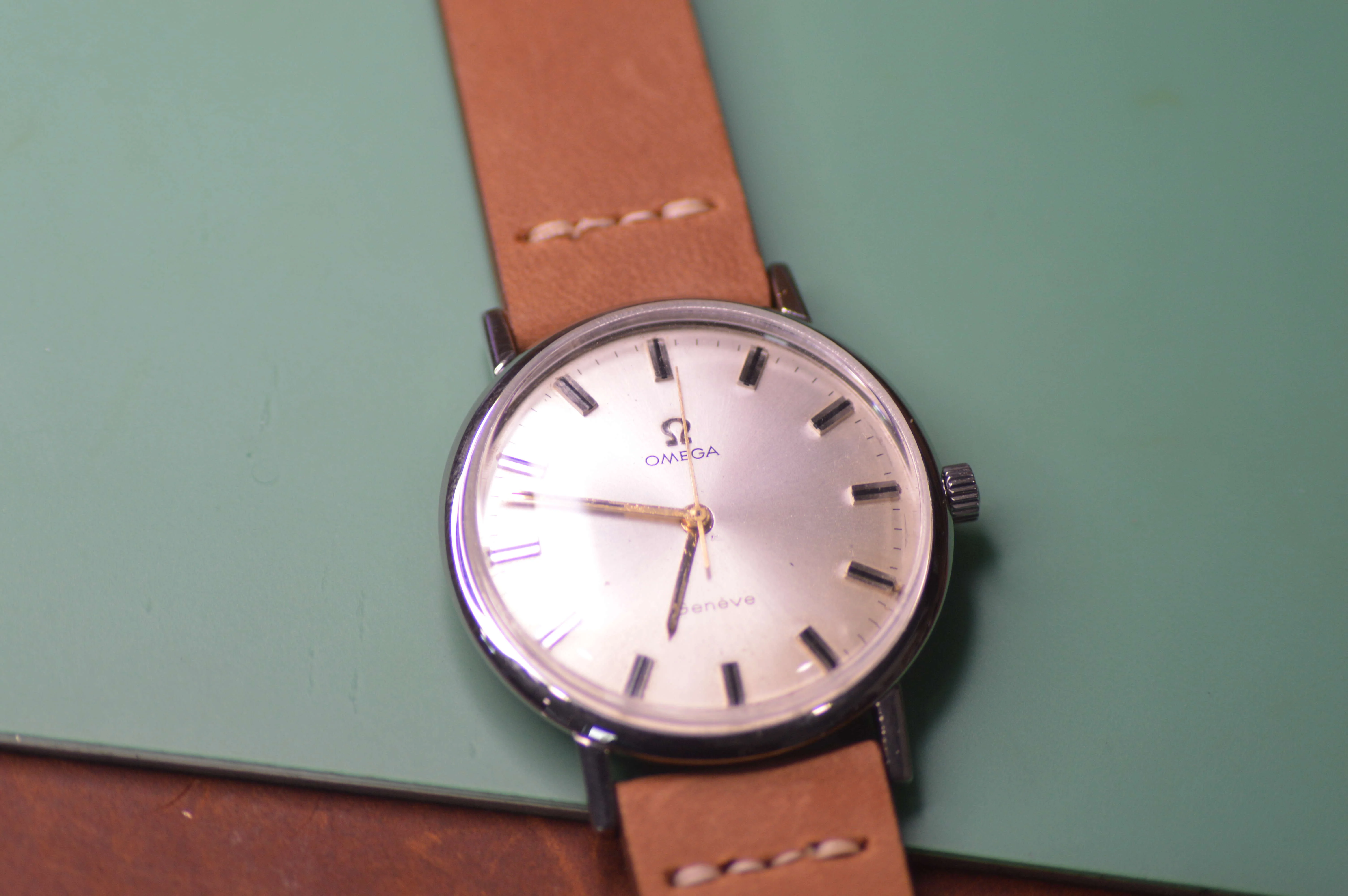

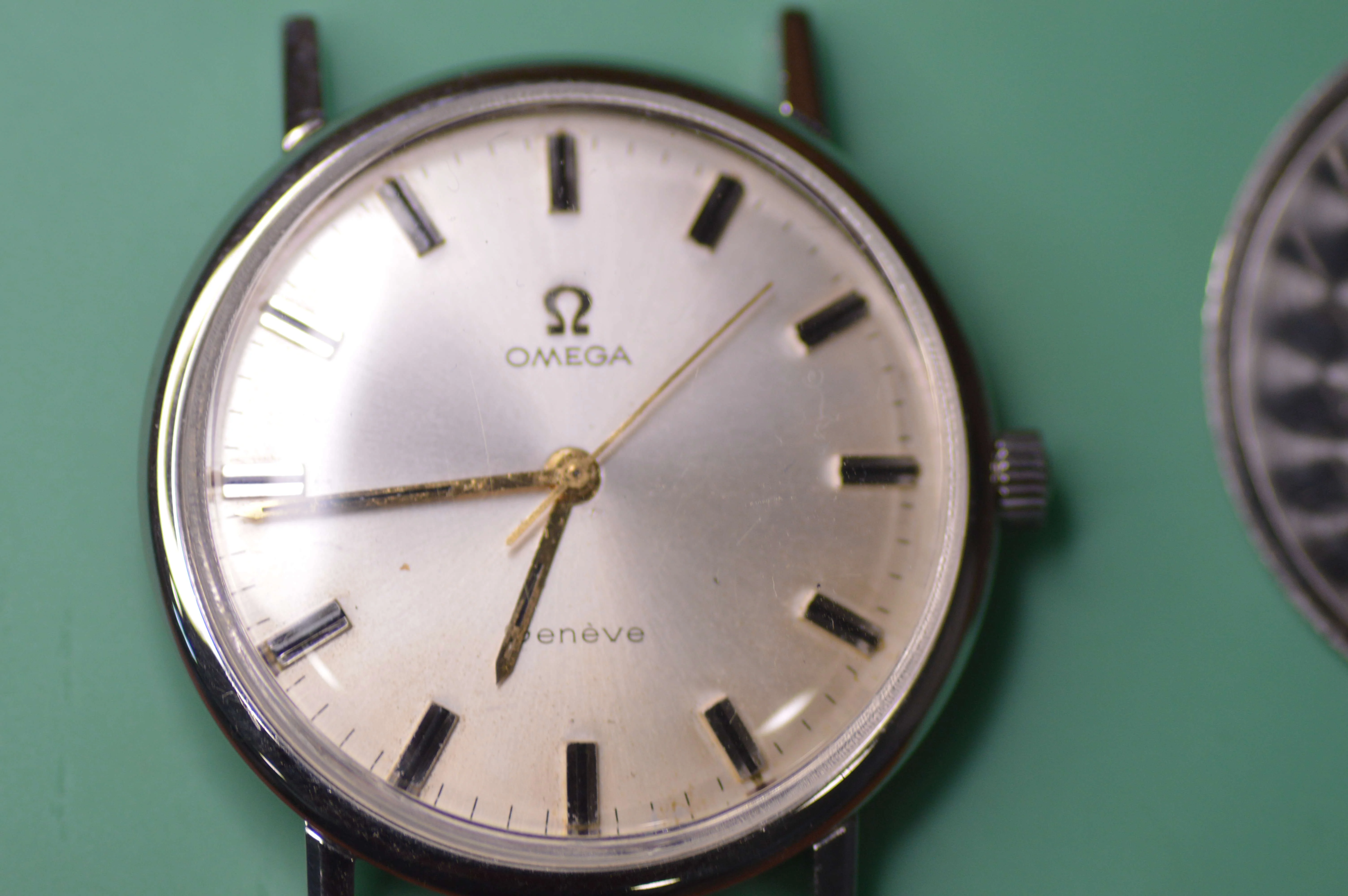

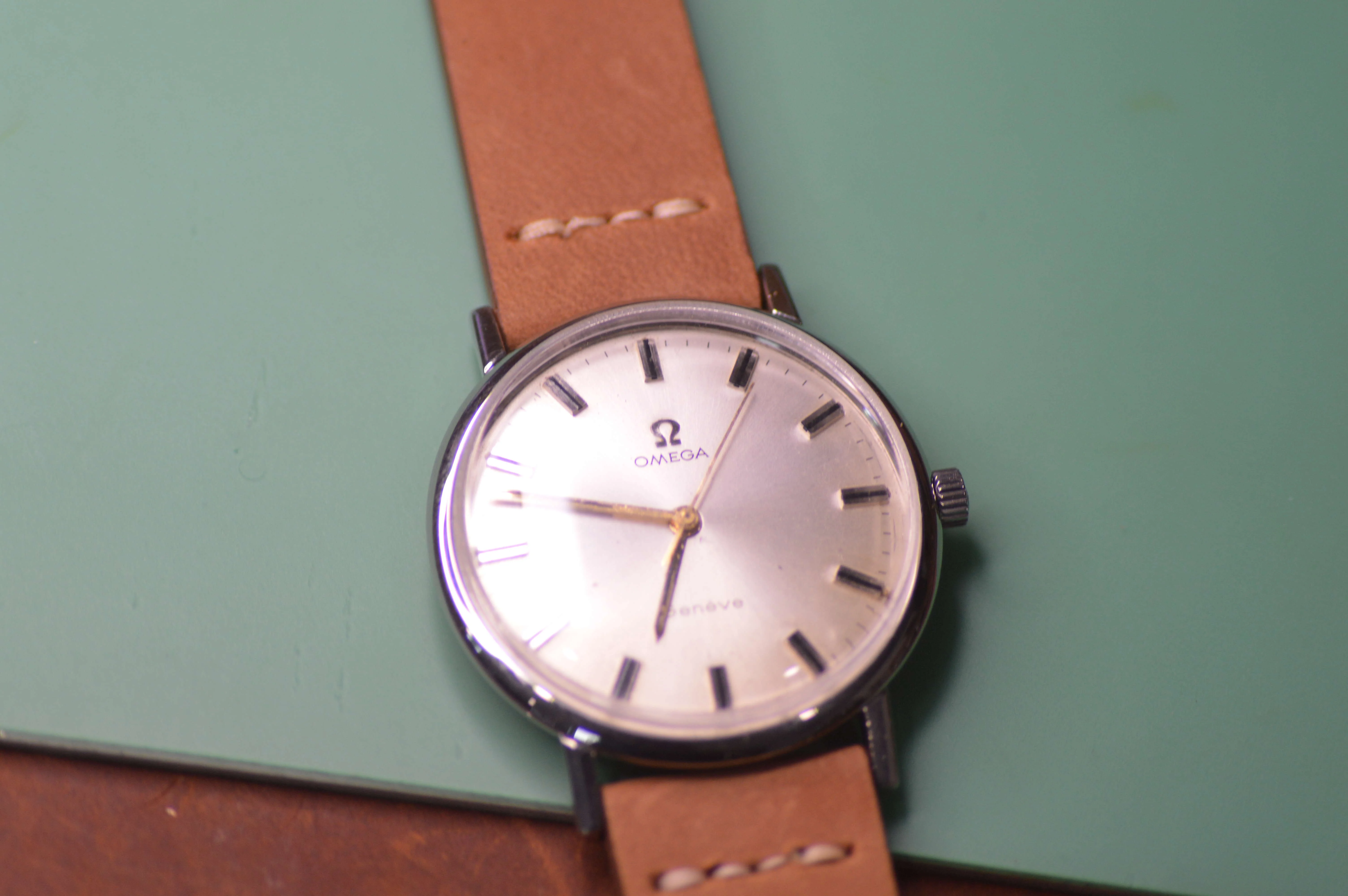

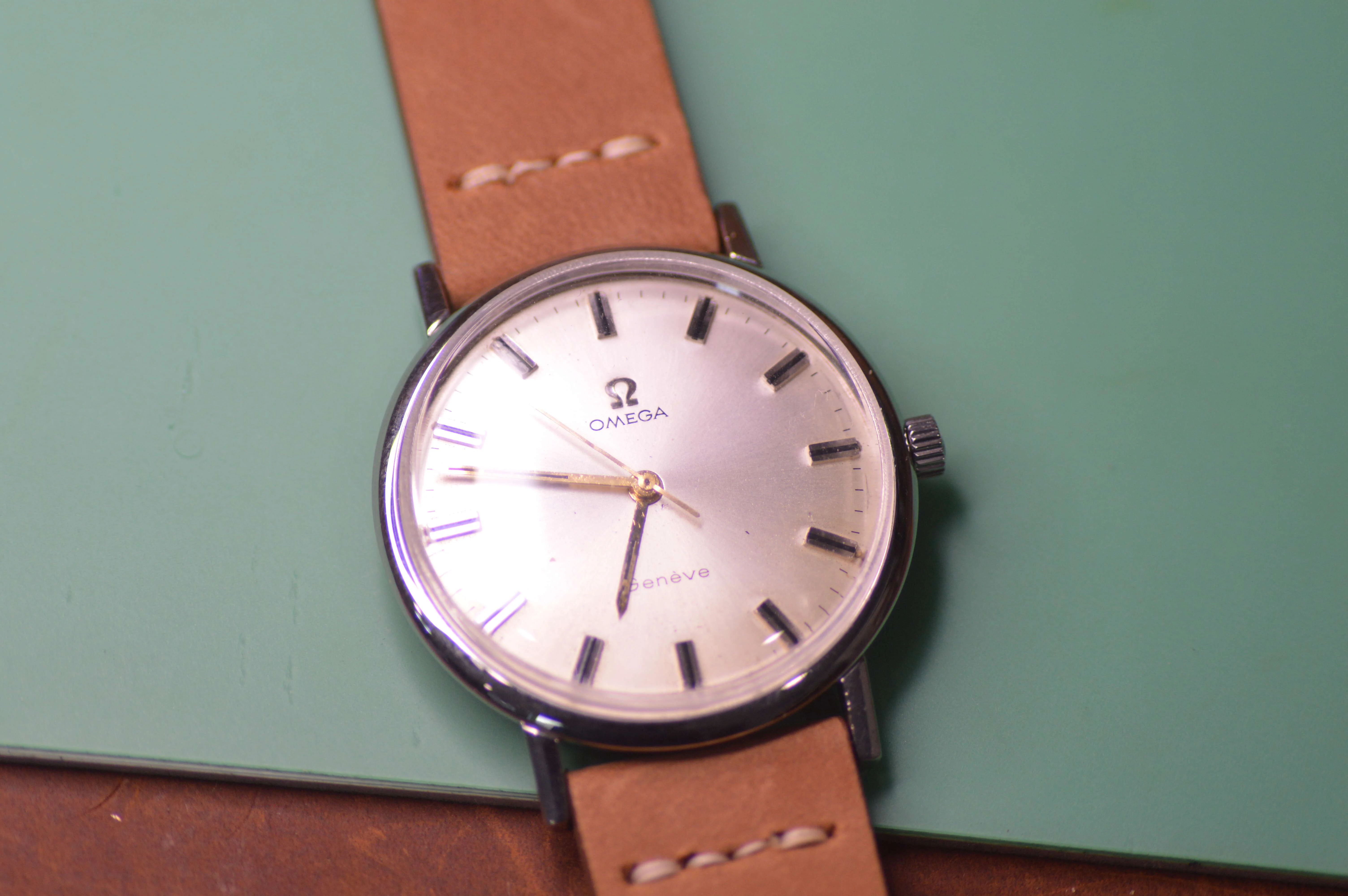

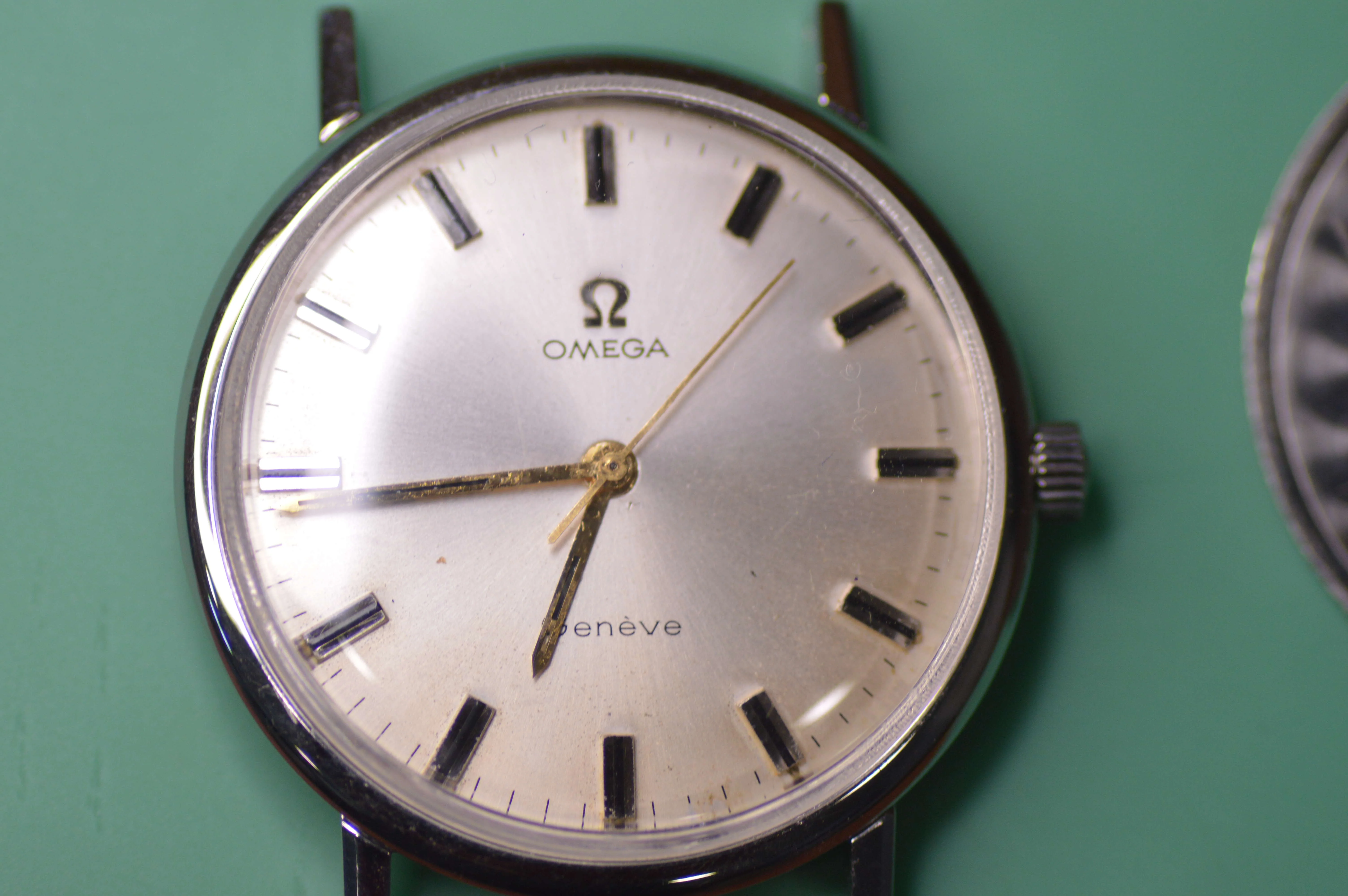

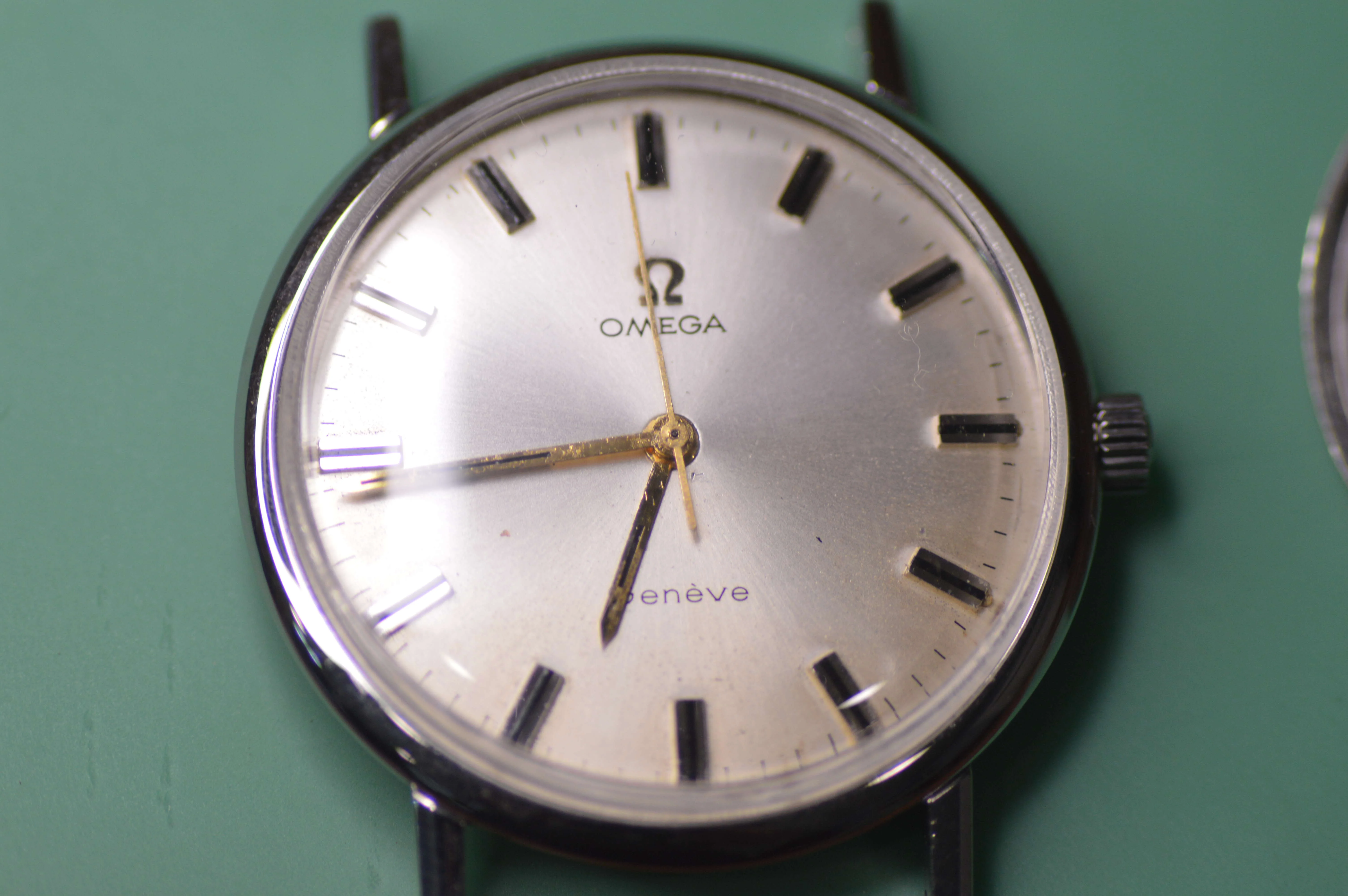

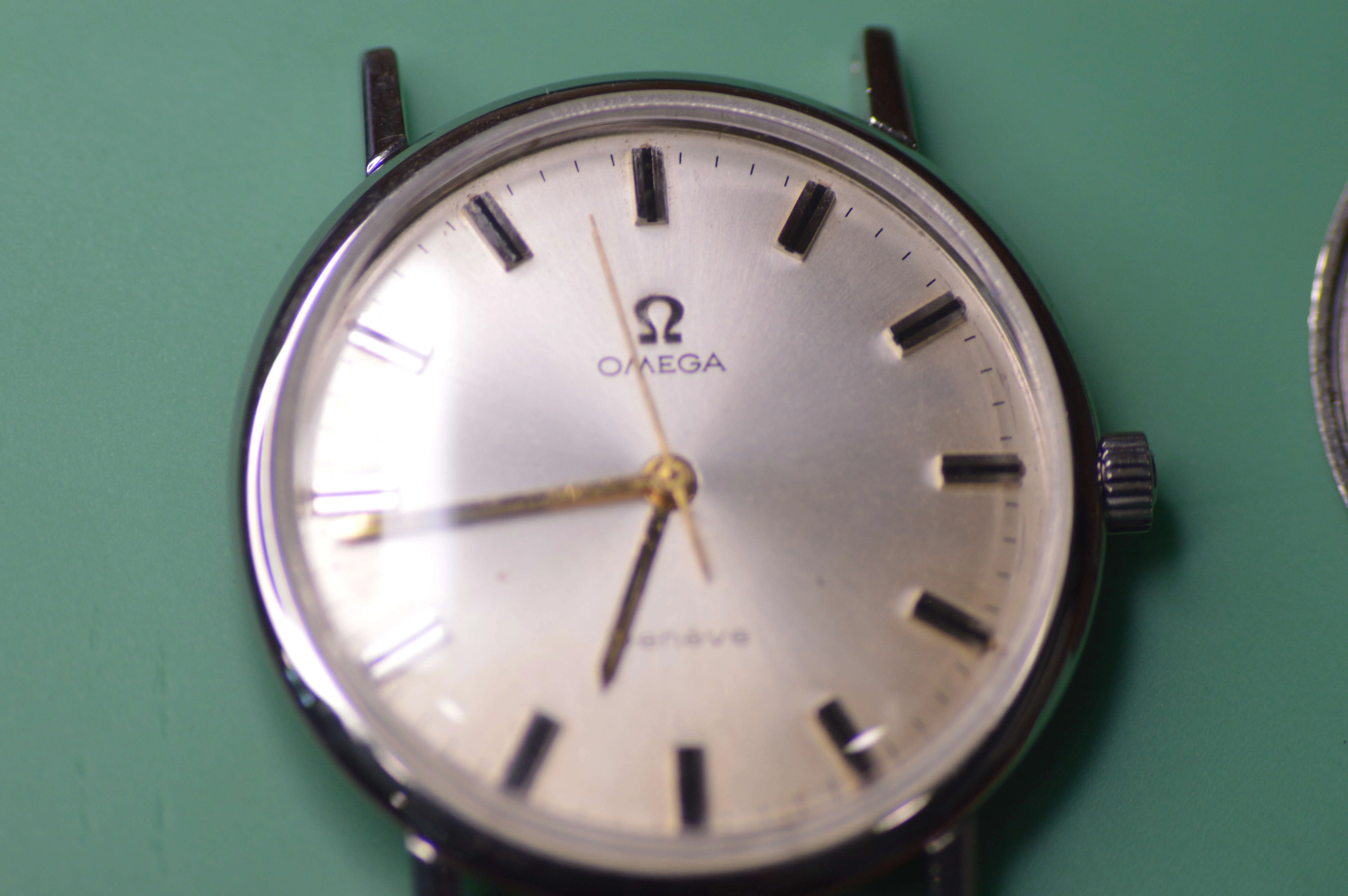

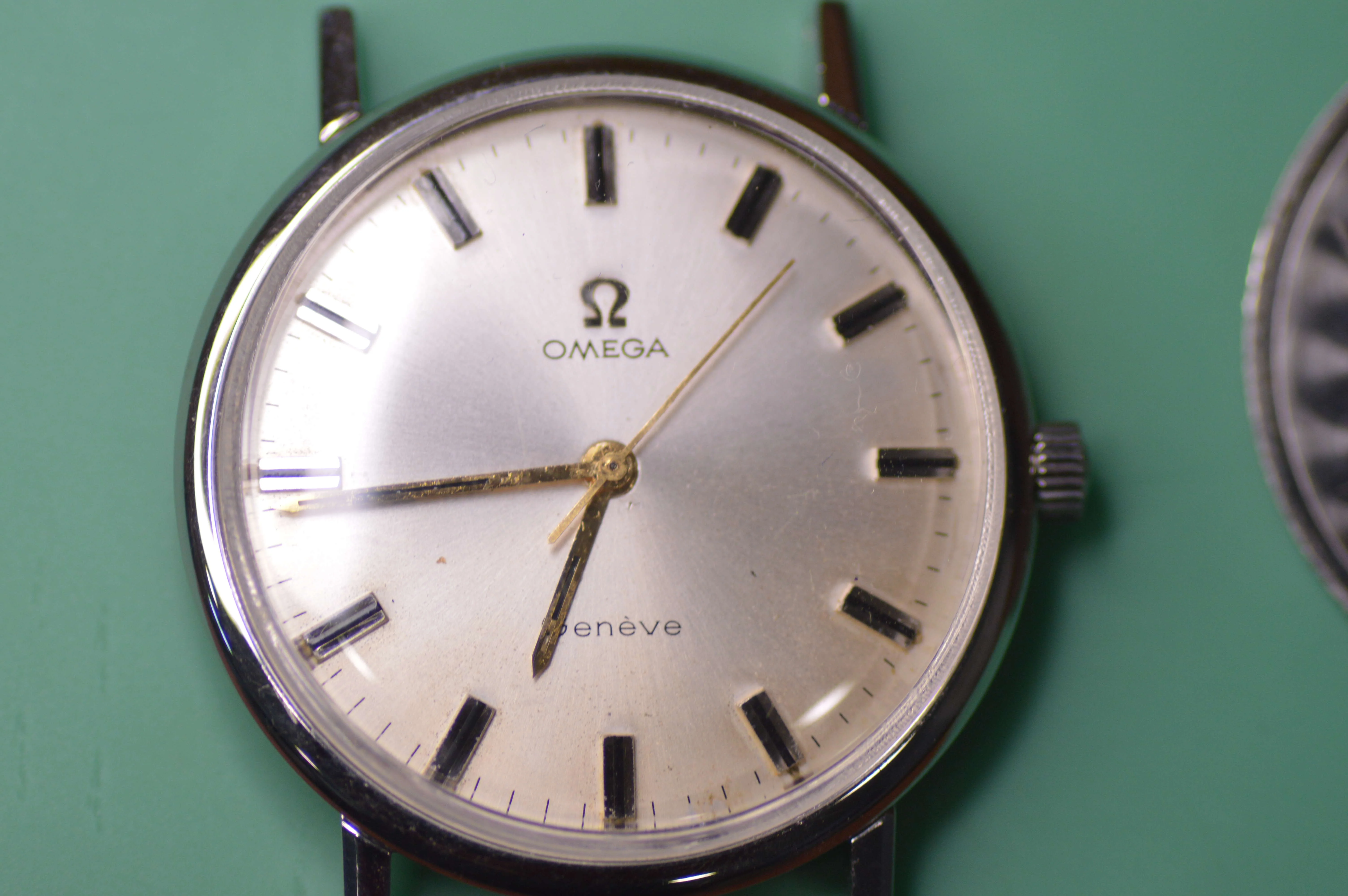

Decided to play a bit with my new-old camera (D3200) and just got this guy finished up! The new mid-case worked perfectly and the replacement dial looks good! I love the new crown (the old one was super tarnished) and think it goes great! 34mm case is a touch on the small side, and it isn't really my style, but this is my first 'Omega' watchmaking success!
The new case is lovely, it is in great shape. and the rest of it looks nice. The hands didn't clean up as much as I wish they did, but otherwise, its a great looking watch 😀 I'll have to find a friend with a naked wrist to wear it!

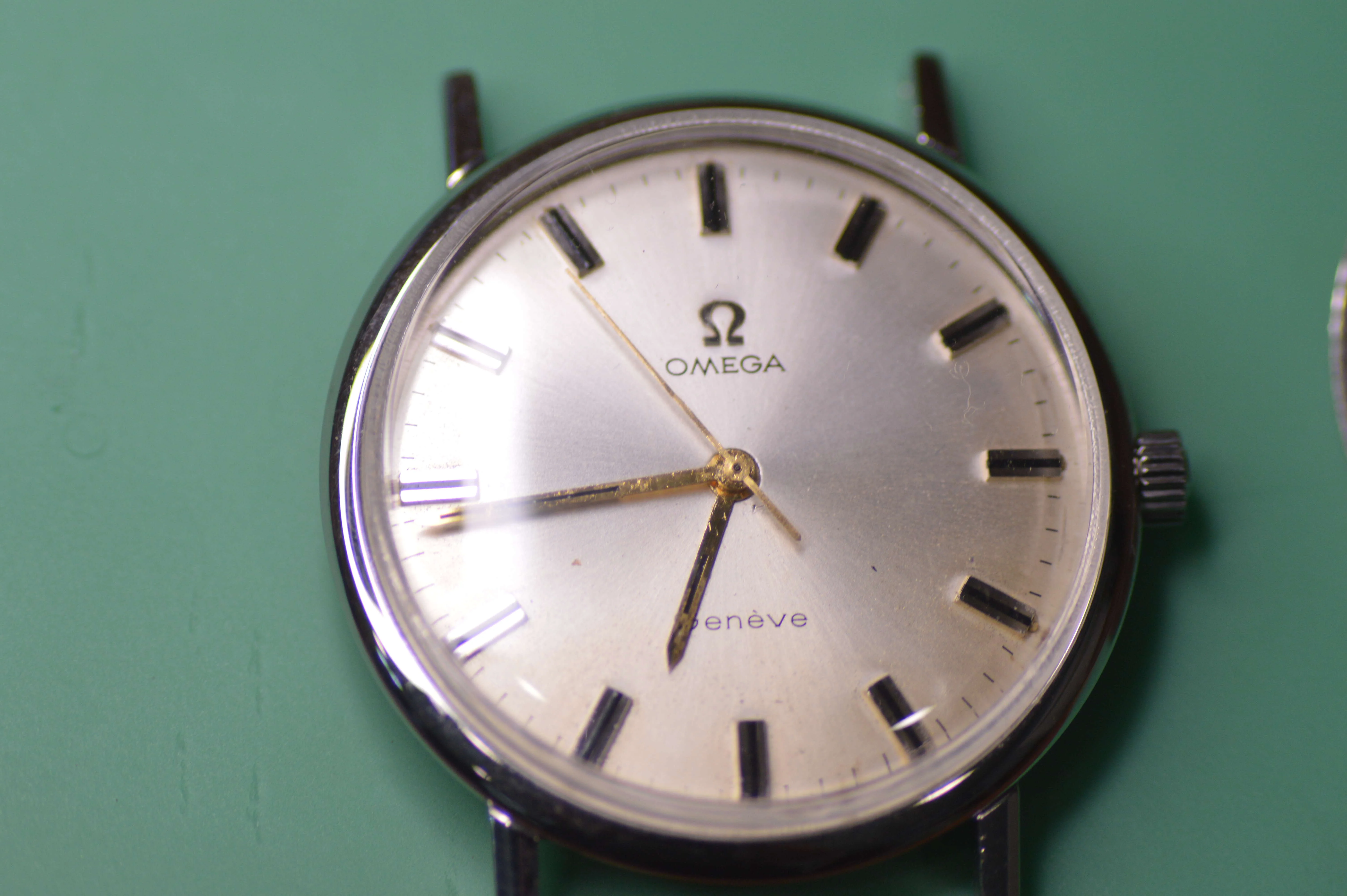

WELP, I spoke too soon. I WAS able with some finagling to get the crystal inserted, though it had a bit of a 'creak' as the watch was touched.
A few minutes of playing with it and it managed to break all the way around! I just couldn't get the non-high-dome ones to work either, and my two crystal lifts are basically impossible to compress it enough to get it in. So the 31.1 seems to be a bit too big 😁
The one that came off/was loose when I got it, measures at 30mm even, so I'm tempted to just pick up a $15 crystal on ebay at 30.5mm. WDYT?
