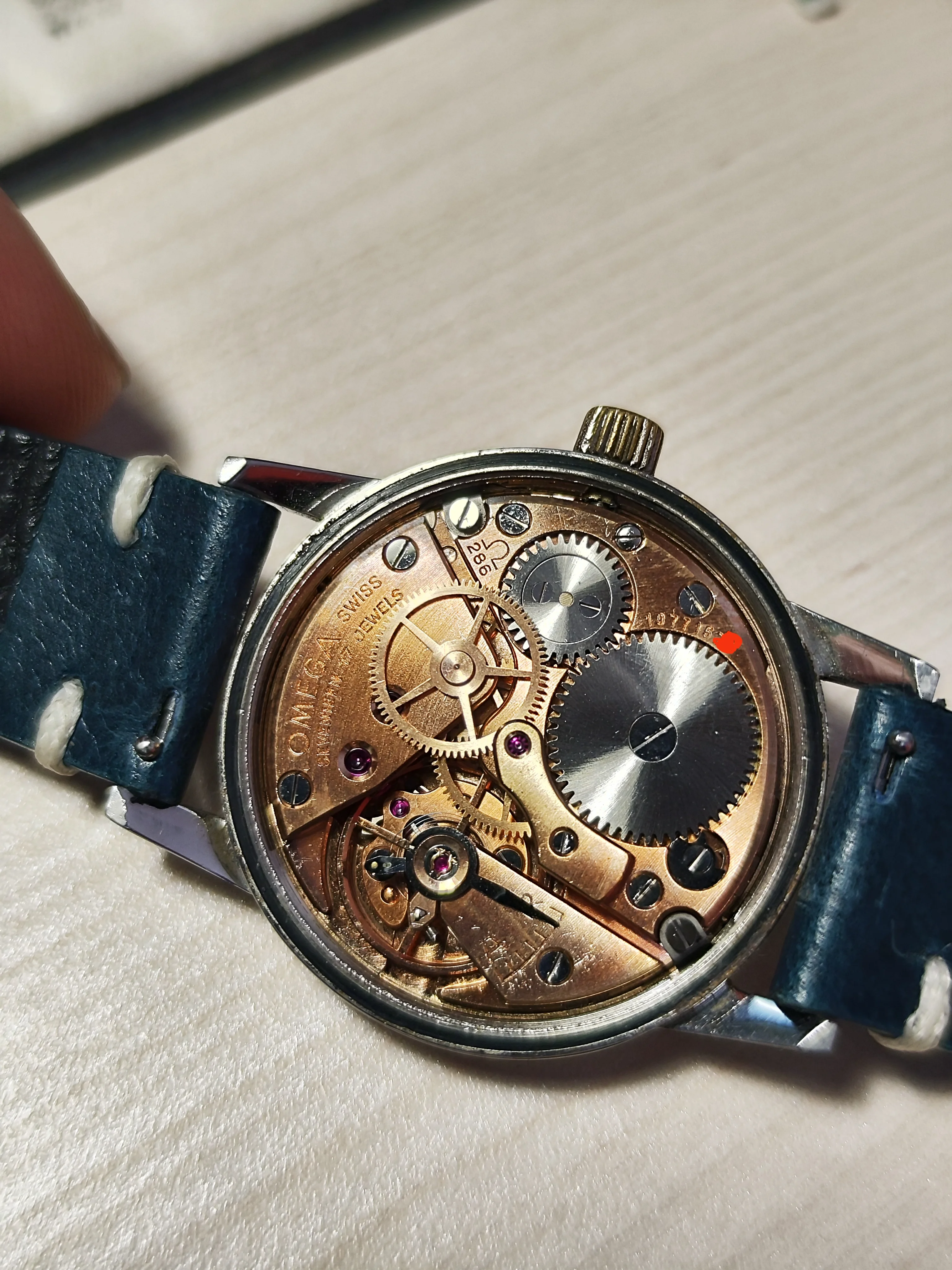

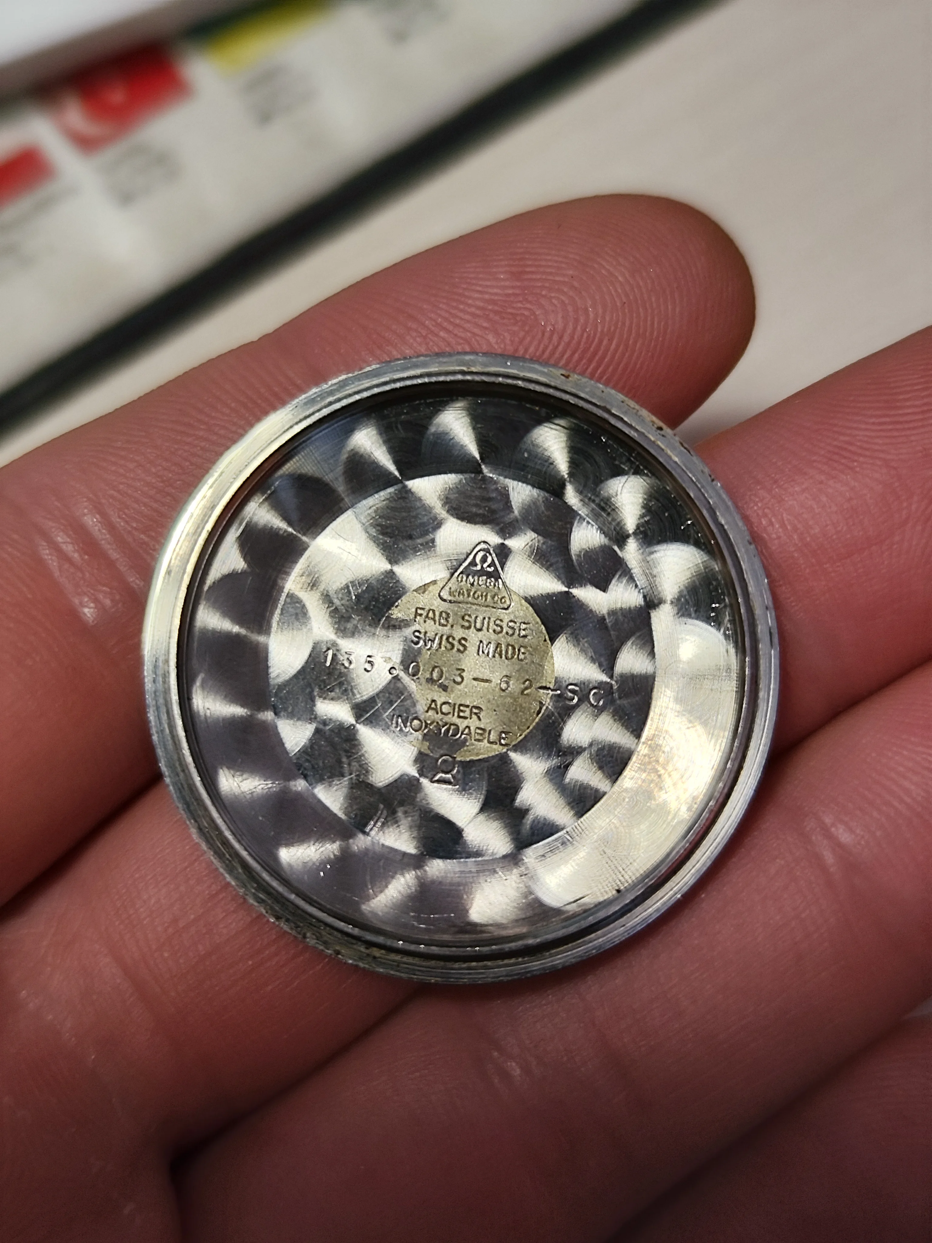

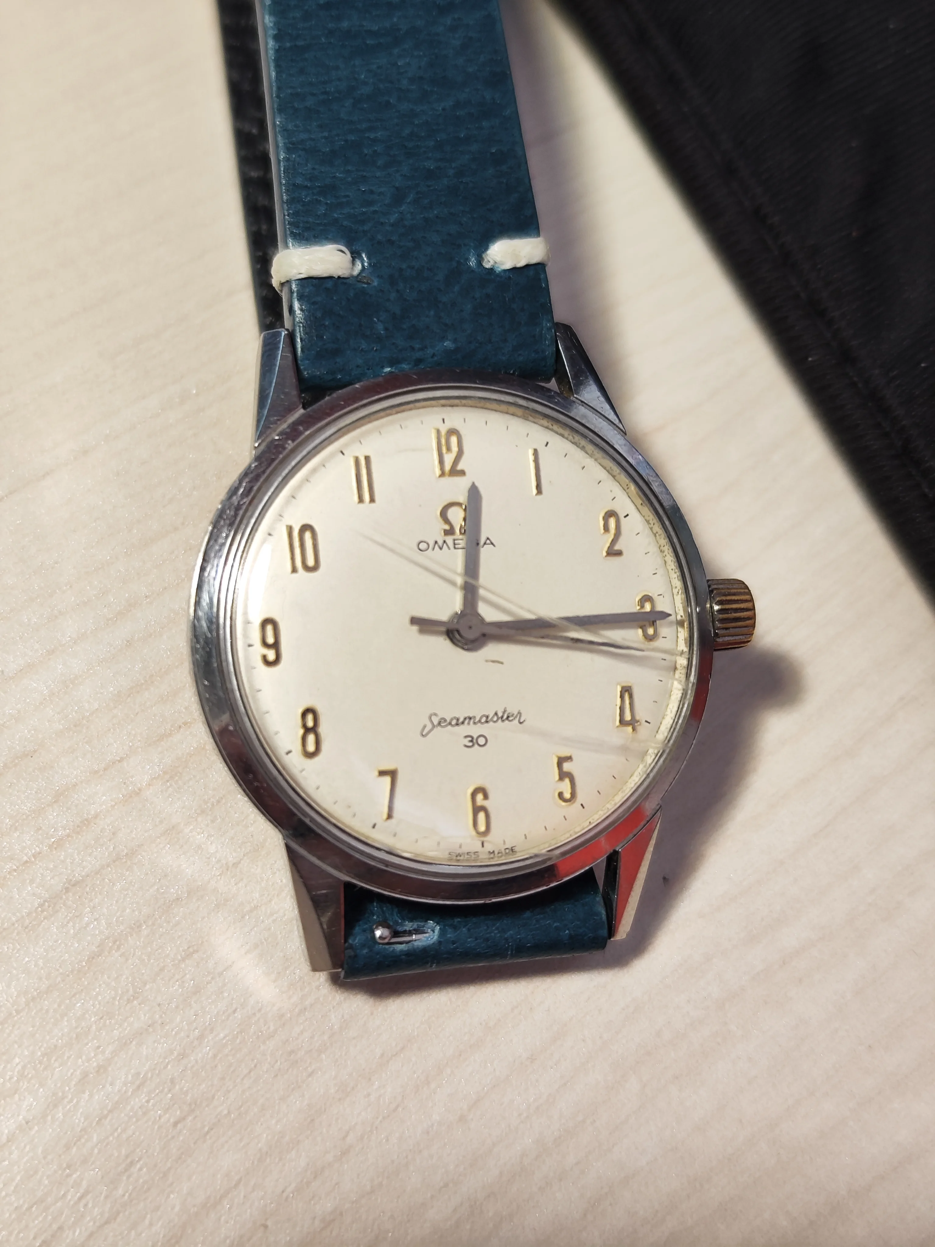

Hello everyone,
I recently acquired an Omega Seamaster 30 with caliber 286, reference 135.003. I’m planning to have it serviced and restored to its original condition.
While searching online and here on the forum, I found a PDF listing the correct crown and crystal references. However, when I look up the crown reference indicated in the document, I only find a rose‑gold crown, which differs from the one shown on the official Omega website and from other watches of the same reference currently for sale.
Could you kindly help me identify the correct crown and crystal references for this model?
Thank you in advance to anyone who can assist. I’m attaching photos of my Omega.

Hi and welcome here!
Looks like you need correct hands too... 😉

Thanks so much for the warm welcome - I really appreciate it. I believe the dial was replaced at some point; to me it looks like it comes from reference 135.007. In any case, I’d already be happy just to find the correct crystal and crown 🙂
4
I should clarify: it doesn’t have the dial of the 135.007. The numbers are different - the top surface of each numeral is silver rather than gold, while the sides are gold.

The crown part number is 069ST45004.
The crystal is 063PZ5005.
