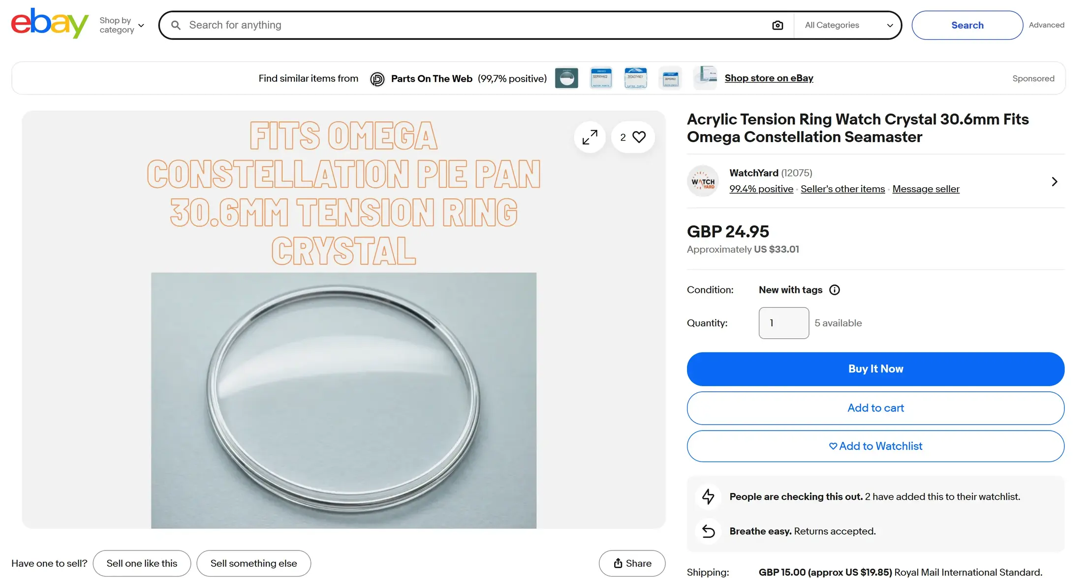

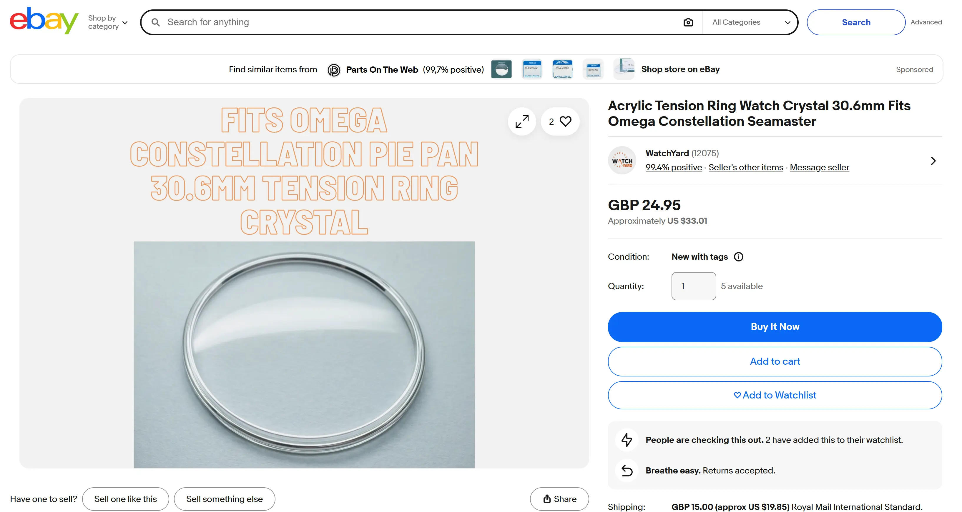

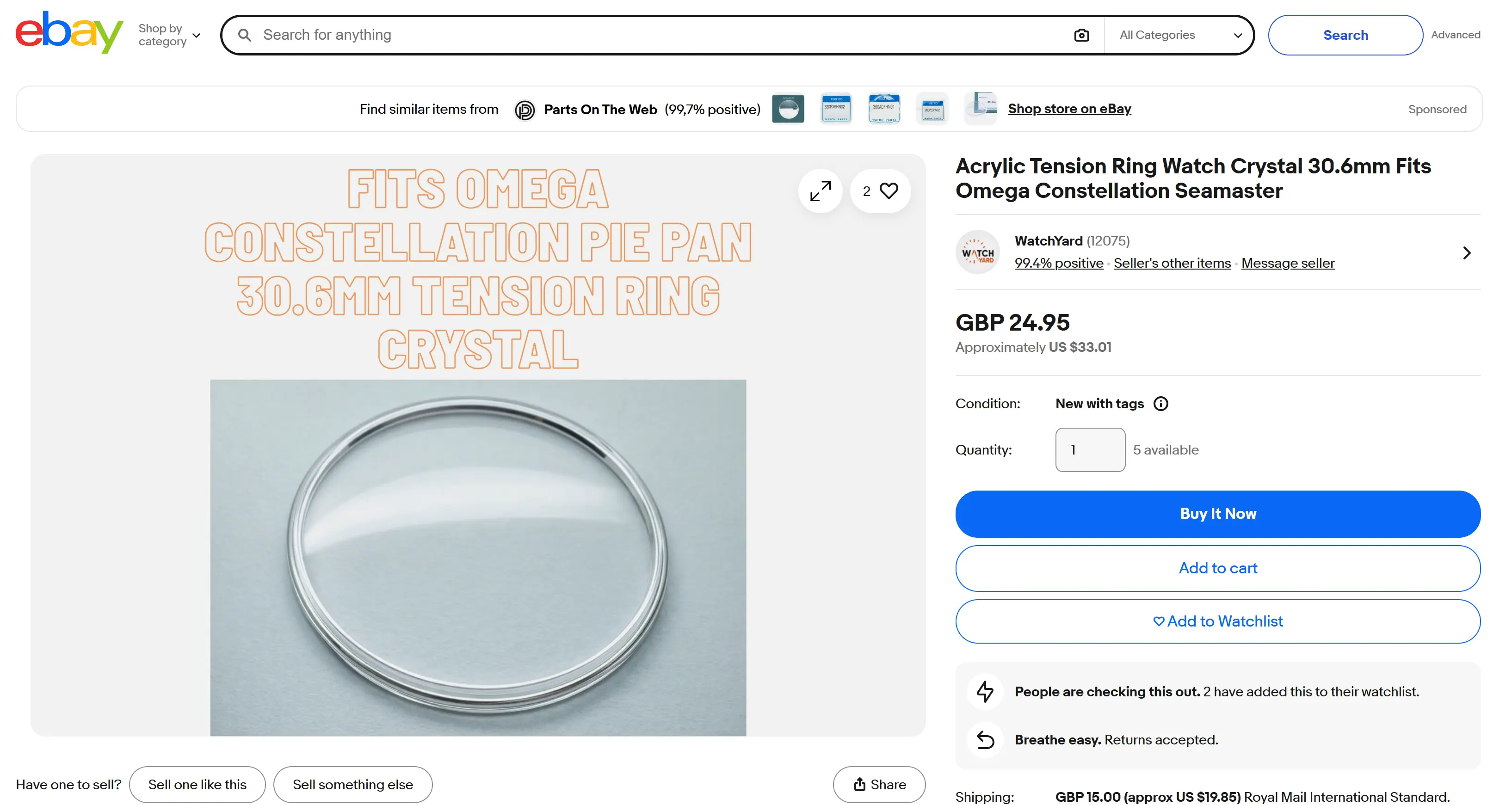

I recently serviced one Omega Pie pan, but accidentaly broke the glass. My Problem is, i cant find another one anywhere in europe. At least nothing im not sure if they are.
Already saw some interesting threads about that, but nothing that show where to find them:

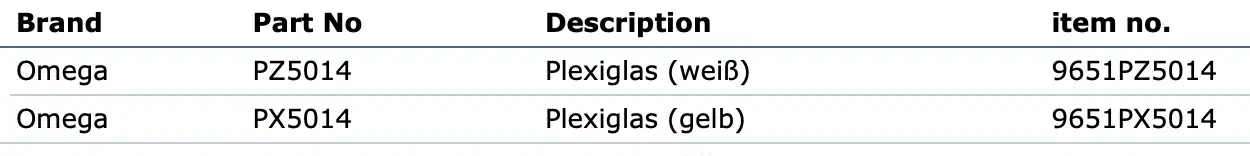

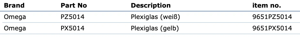

063PZ5014 | GLASS PLEXI ST RING D30.62 H5
063PZ5015 | GLASS PLEXI ST RING D30.62 H5.5
Is this one ??
Thank you for taking your time to help.
Kind regards.
5
Another question i forgot to mention, the pic i sent is the only example i found of the possible glass fot he watch, but it only has the silver tension ring. My pie pan is gold cap, so which one should i buy?

For a gold watch you need a crystal with a gold tension ring, unless your dial furniture is silver, not gold.
So, a PX5014.
