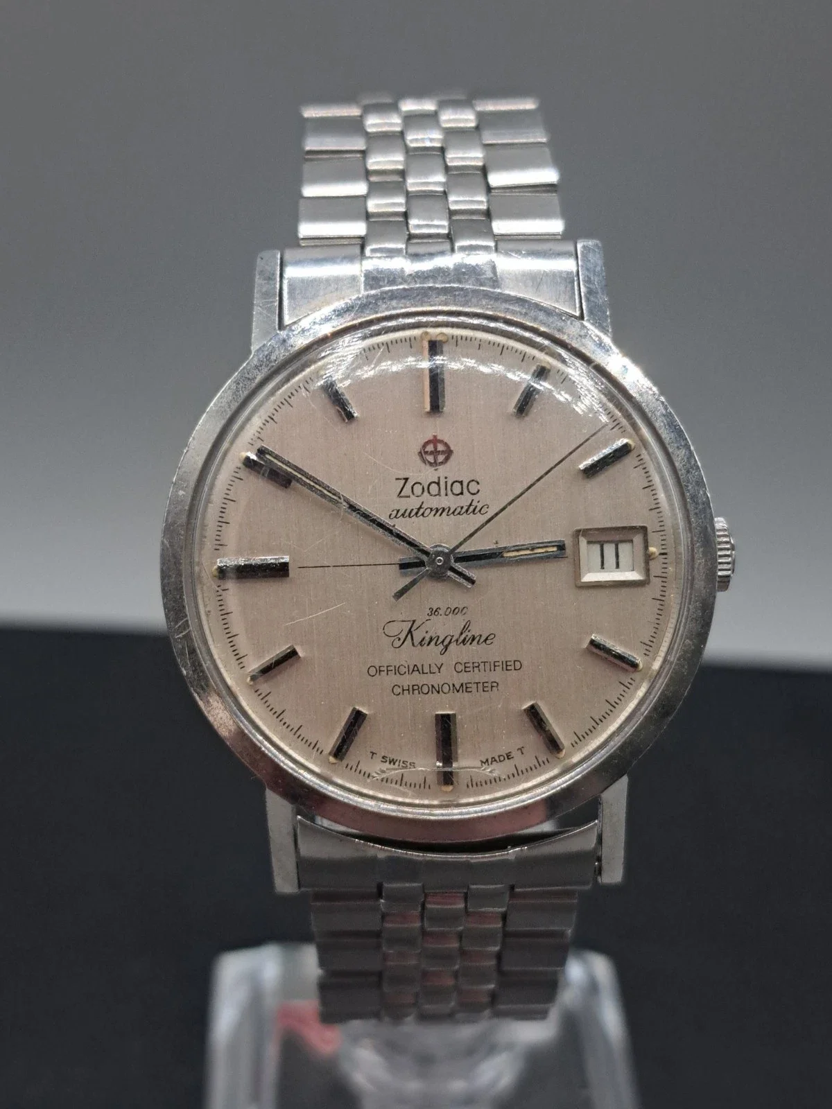

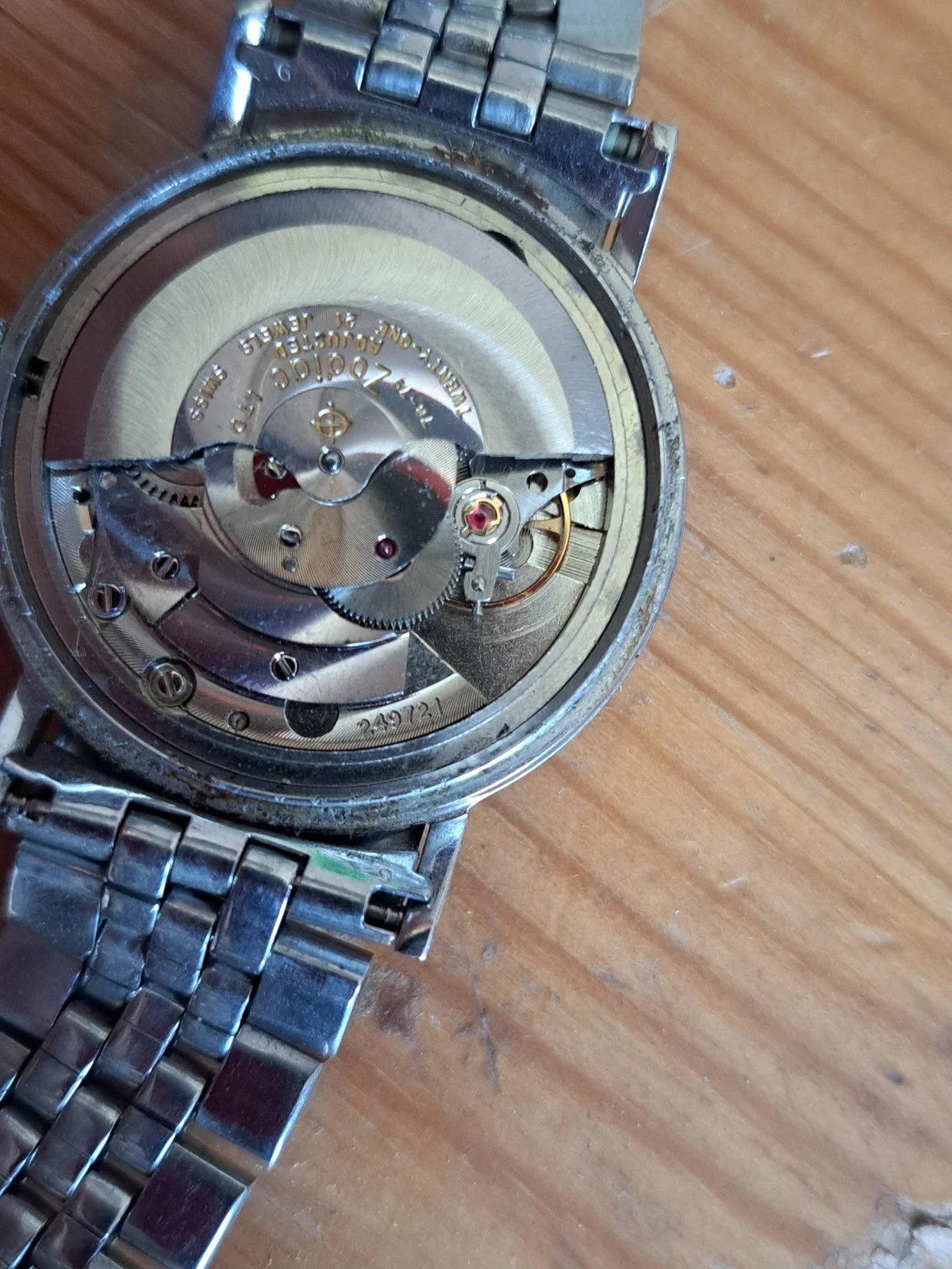

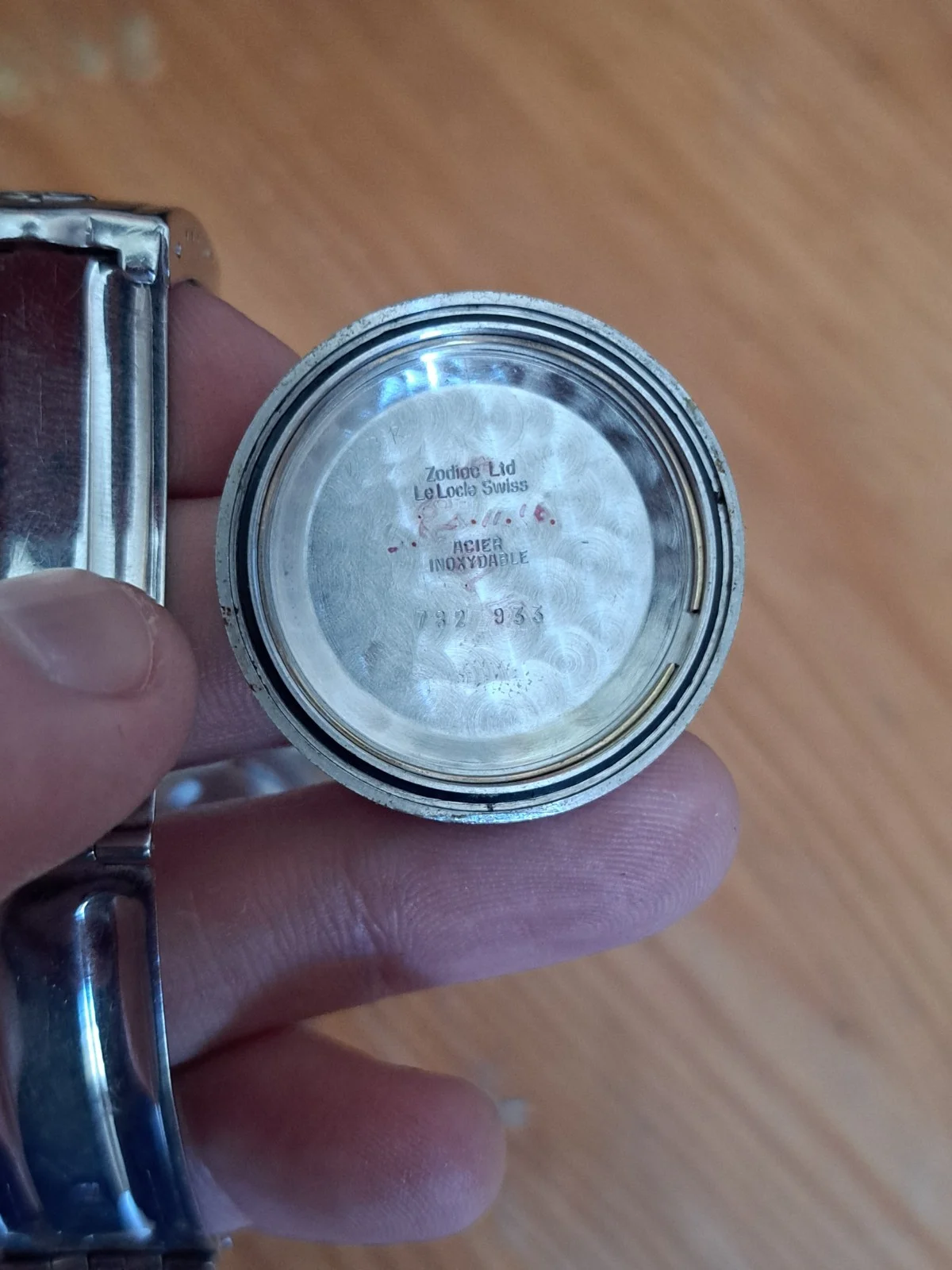

kindly I picked this watch up for $300 Do you think it is ok price? and can I have your feedback on this watch? it seems the service cost will be high as parts are not easily find
112
3
It is equipped with a chronometer-standard, 10-beat/36000 high-performance movement. I would like to hear from your experience, please
112
3
I tried and did my research by using a pretty helpful video on you tube channel from a nice guy, since I am no expert on this, I would still like to hear your notice

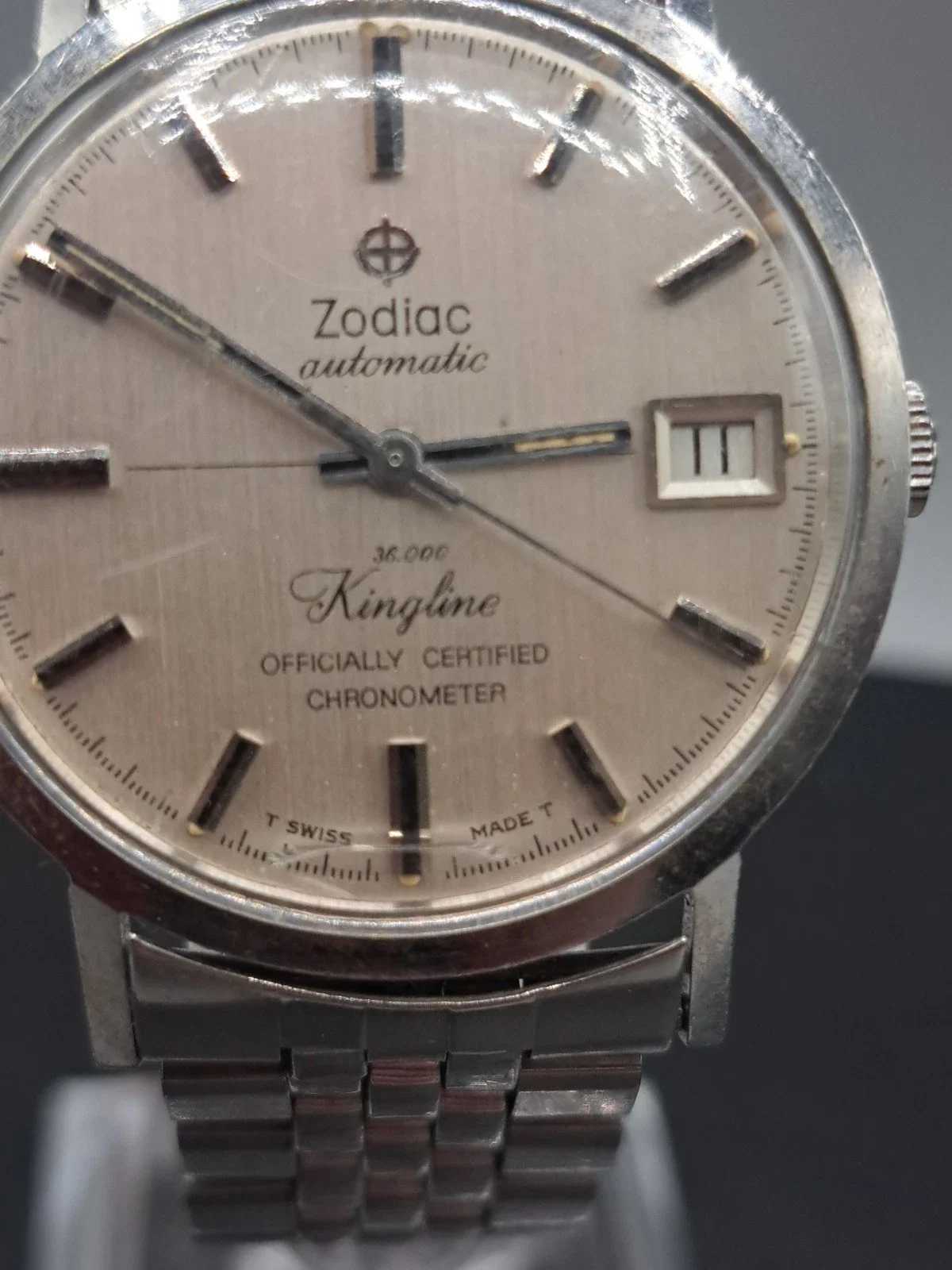

Thank you so much for your comment. I love Zodiac as a brand. I believe the history of Zodiac is much better than it is current situation. I'm not sure if this model will be appreciated in the future or not, but it is so nice and COSC certified. Seawolf is a watch I would love to have; my only concern is that Zodiac Cal. 76 automatic day/date parts are not easily available, so it will benefit you if you can fix it yourself, but unfortunately I do not have knowledge on this yet. do you believe the watch is in good condition or any observation I should care for, thank you

Do you think the watch glass has to be replaced, or should I leave it alone to preserve its value?

I would definitely have the glass replaced. A crystal is a "service item", not even the most hardcore of collectors will insist that it be original (unless there's an etched logo or something, but that should not be the case here).
The "Kingline" models were their top-of-the-line watches in the late 1960s / early 1970s. They are virtually unknown and not in much demand today, though.

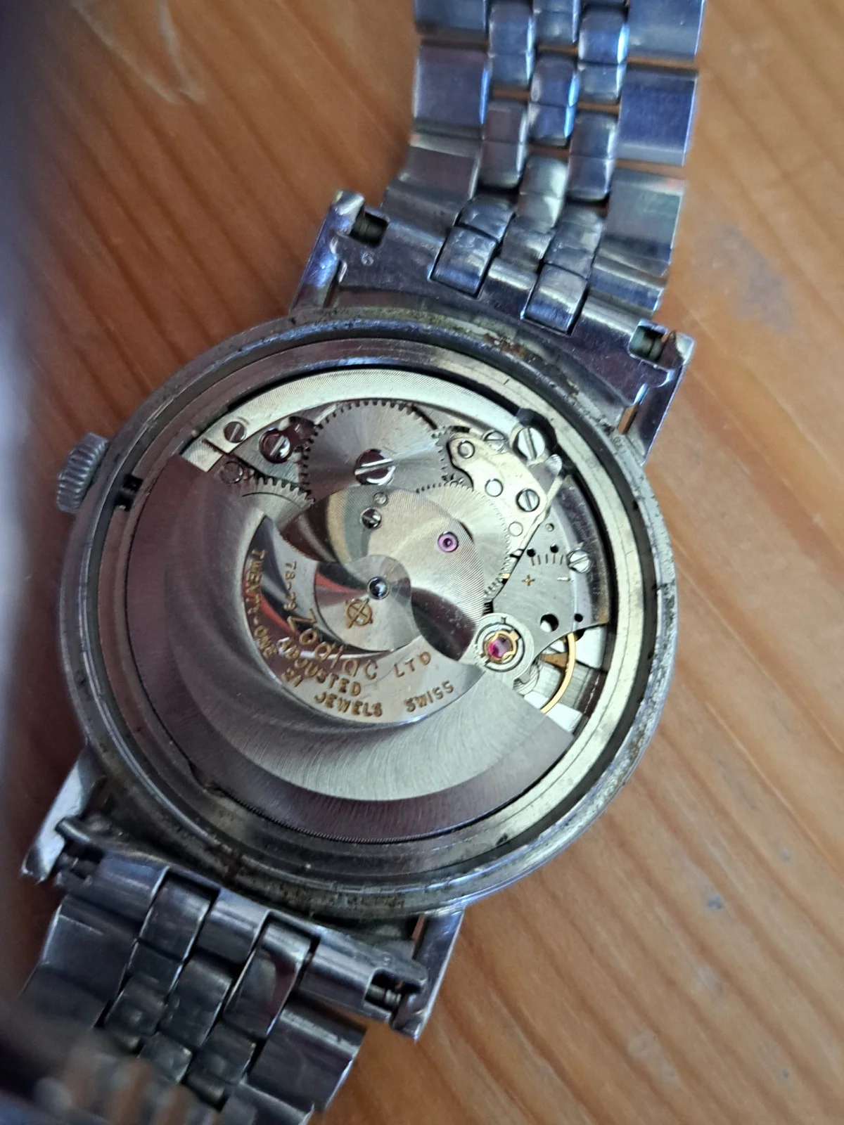

The Ranfft database had the following info on the Zodiac 78 movement:
The family is based on the manual wind calibre AS 1687/1688.
The automatic mechanism is a joint development of Doxa, Eberhard, Favre-Leuba, Girard-Perregaux, and Zodiac.
(source: https://ranfft.org/caliber/10962-Zodiac-78)
So that would make this movement part of the "first family" of mass market high-beat (36.000 bph) movements, predating the Longines Ultra-Chron 430 family, and the Seiko 61 family of movements (even if not by much). That's interesting to me, by itself - I love the early high-beat movements.
The video you linked above should be interesting, I have watched several of the Chronoglide videos and found them to be very informative.
Your watch has the advantage of having an original bracelet; the dial looks good; the lume has deteriorated; the case is pretty worn, with spots of corrosion. Overall, I think you paid an okay price for it, not cheap, but okay. I don't think it will be in high demand, but it is an interesting watch that should wear well - watching a 36.000 bph seconds hand sweeping serenely across the dial is a pleasure by itself.

Thank you so much for your detailed information; you added a lot to my knowledge about the watch. I was surprised that this model not in demand for Zodiac, some of of other zodiac models has lower movement quality than this one, and though they are sought after for premium price, I saw few of these online and found one that sells for $1900 like this one.
https://www.ebay.com/itm/3163767738...CJ+dML8kdGSVpyQ==|tkp:Bk9SR5q5-ZXgZQ&LH_All=1
My other concern was about the parts and service, as I understand not any watchmaker can work on this or parts are a pain. Any feedback or recommendations on those?
BTW, the guy in this video is a legend, I love watching his channel, and stories and how he appreciate the watch for craftsmanship not for the brand name and I highly respect that
384
3,037
The price in that advert is pure fiction. I am almost 100% sure (would bet money on it) that the seller is one of those individuals who find a listing inside Japan, copies all the info and then lists the item on eBay with a massive markup. Most Japanese sellers don't use eBay (they use Yahoo auctions in Japan). In the best case, if some unsuspecting foreigner buys the watch on eBay, the eBay-"seller" will buy the watch from the Japanese seller, and then ship it to the foreigner and pocket the difference.
Just try and put it on your watch list. I wouldn't be surprised if you get an offer for 50% savings (!! think of the savings !!), so ridiculous is the current price. And yes, that would still be way too much.
Always check "sold listings" on eBay. Only these provide any real information.
