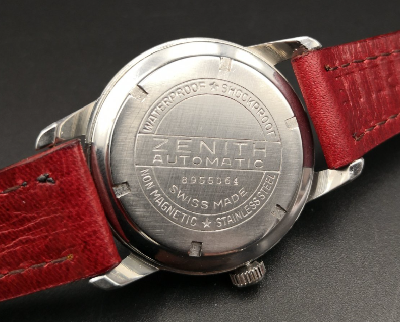

Nice watch.

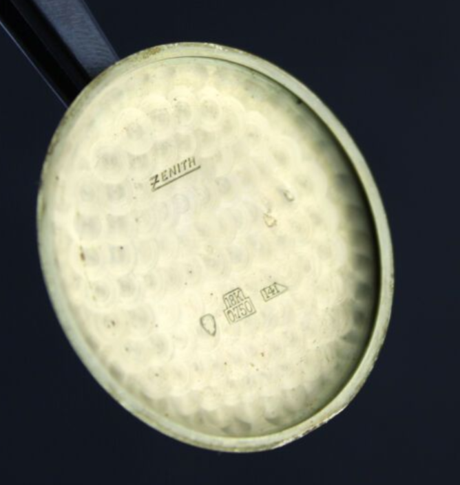

Why do you think the case has been replaced?
I don't see anything wrong with the watch except for the replacement crown.
2,829
4,945

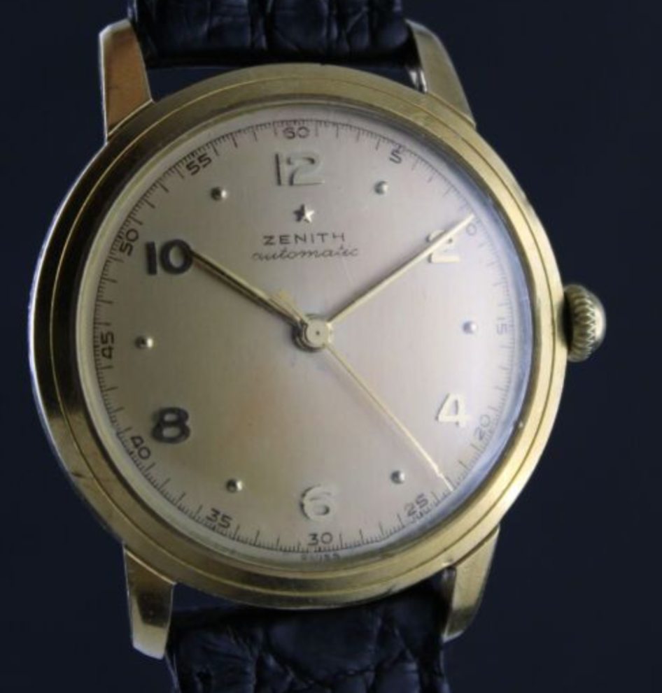

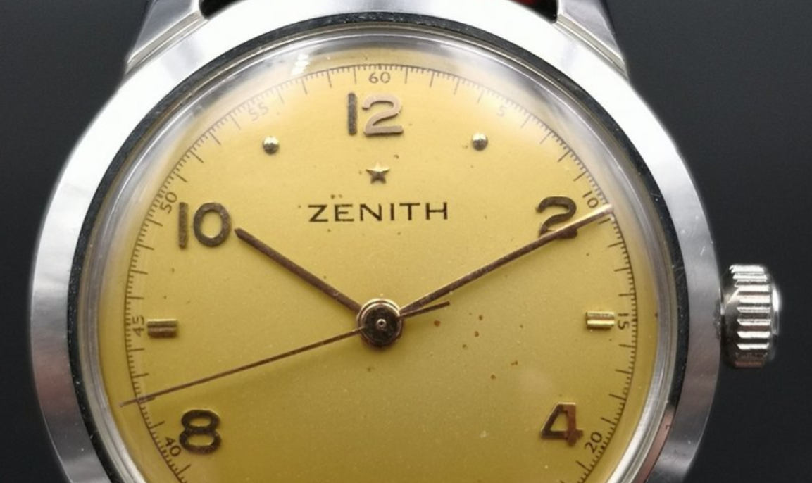

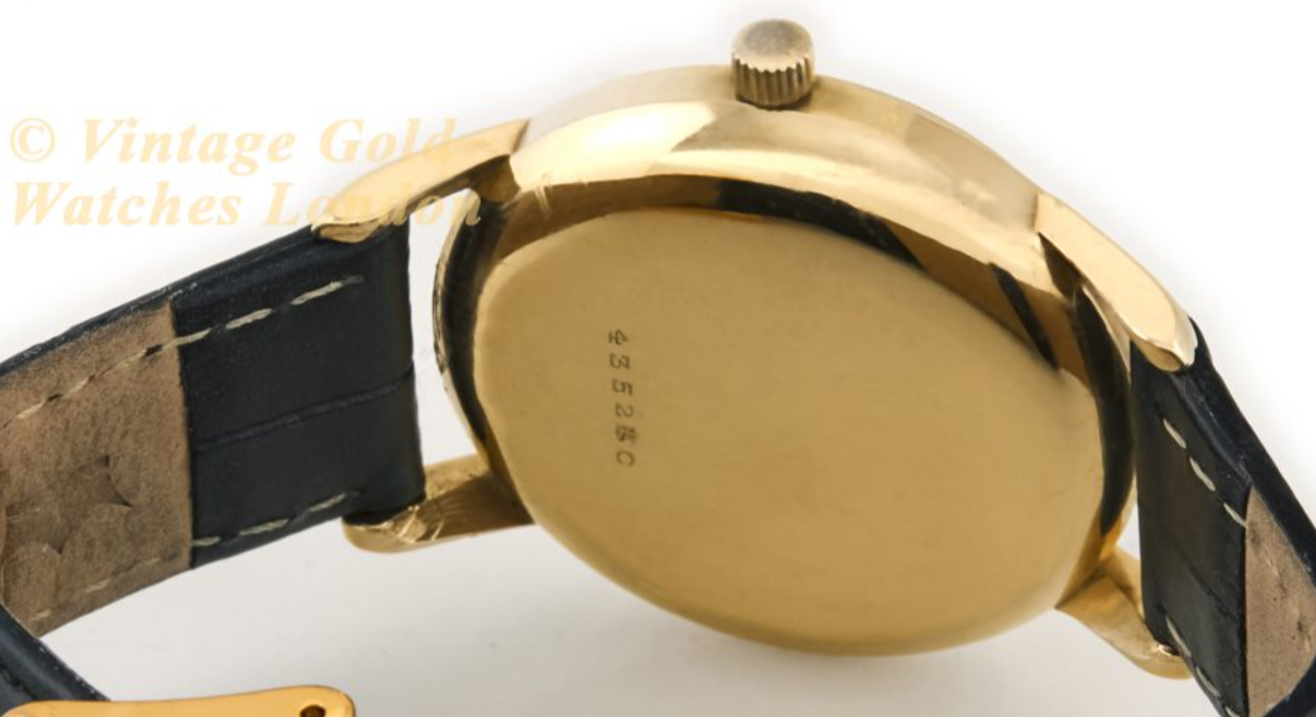

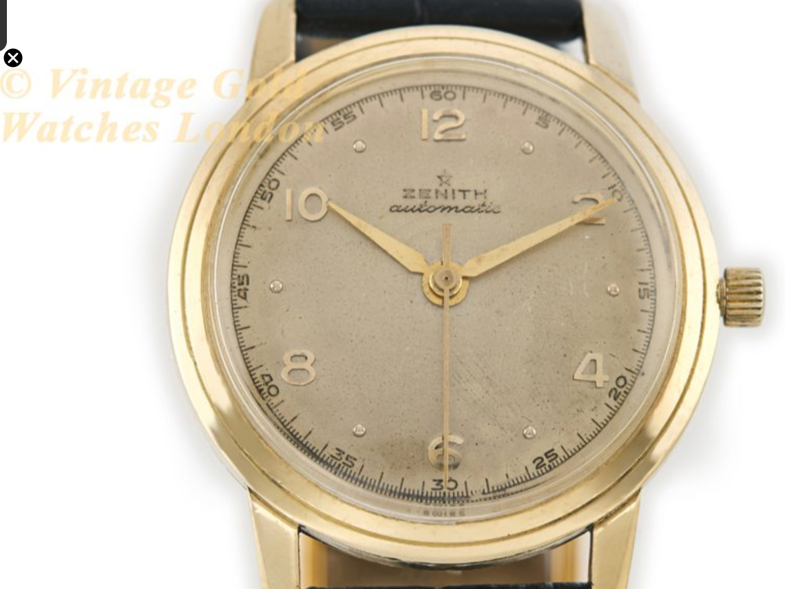

Below are photos of the watch for posterity. I am not well-versed in Zenith, but the font of the outer scale strikes me as odd. Also, is the signature too large? I posted two examples that look comparable further below. The font of the outer scales looks familiar, to me, from dials that were used by other brands from the period.
Source: https://www.alexandrelandre.com/en/...8k-yellow-gold-bracelet-case-round-case-press
Source: https://www.vintagegoldwatches.com/product/zenith-automatic-cal-133-8-9ct-c1954/
453
1,305
I think you're right, the dial does look a bit off. The signature is very big, and I would also expect it to be printed with "automatic".
1,993
3,575
Nice watch.

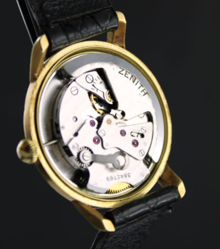

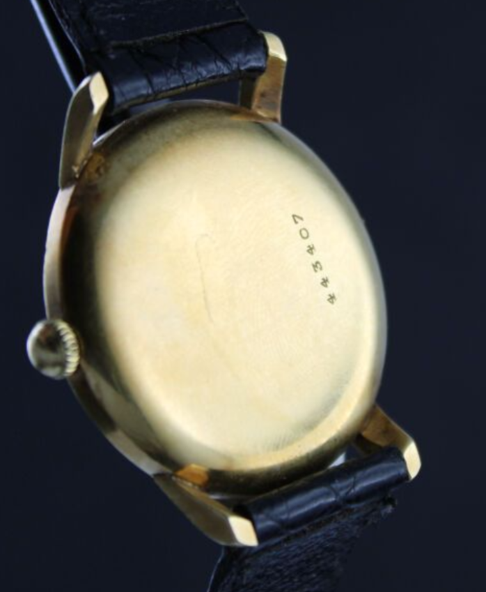

I have an extensive list of the bumpers with serial numbers and case movements. In my records, this was previously in an 18K case
1,993
3,575
Yes the dial looks off too. Didn’t notice the no AUTOMATIC. Also, the dial style looks more like the early 133s and 133.8 but the serial is very late in the production run
8,246
29,135
No way that an original dial would lack "automatic" on the dial. Keep in mind that during that time period, automatic watches were still a relative novelty, and no manufacturer would have chosen to hide the feature!
632
2,137

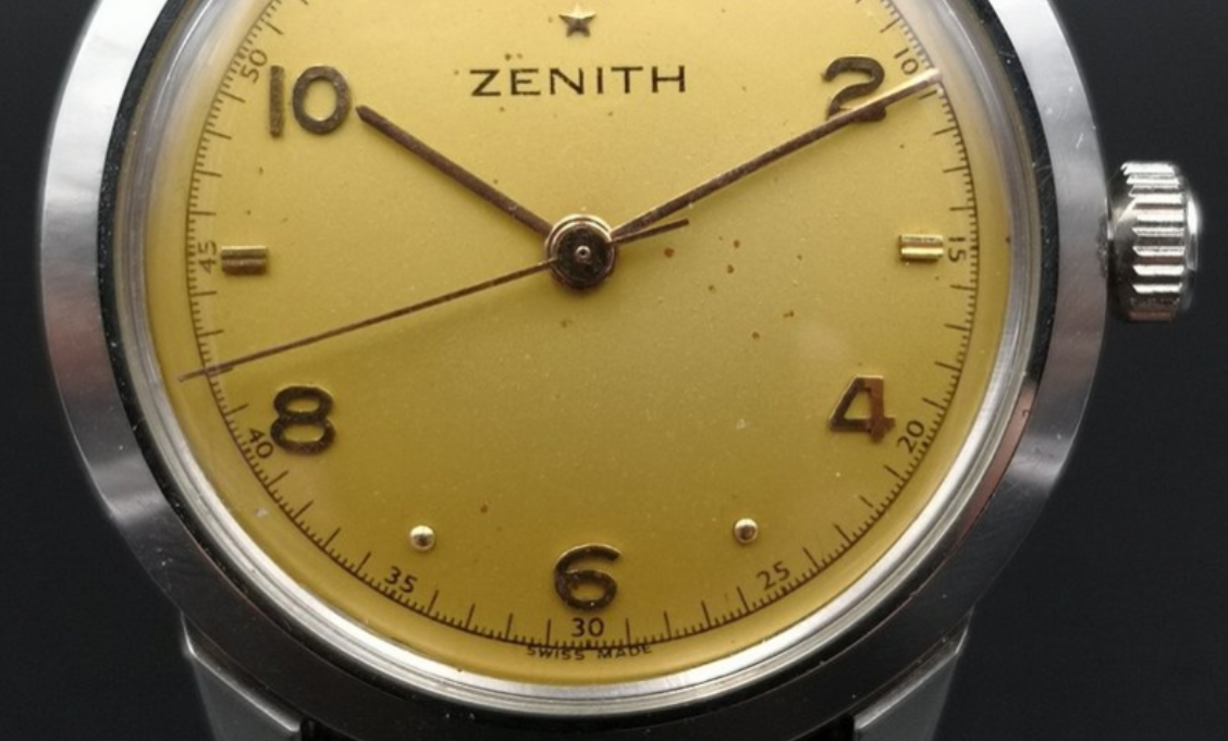

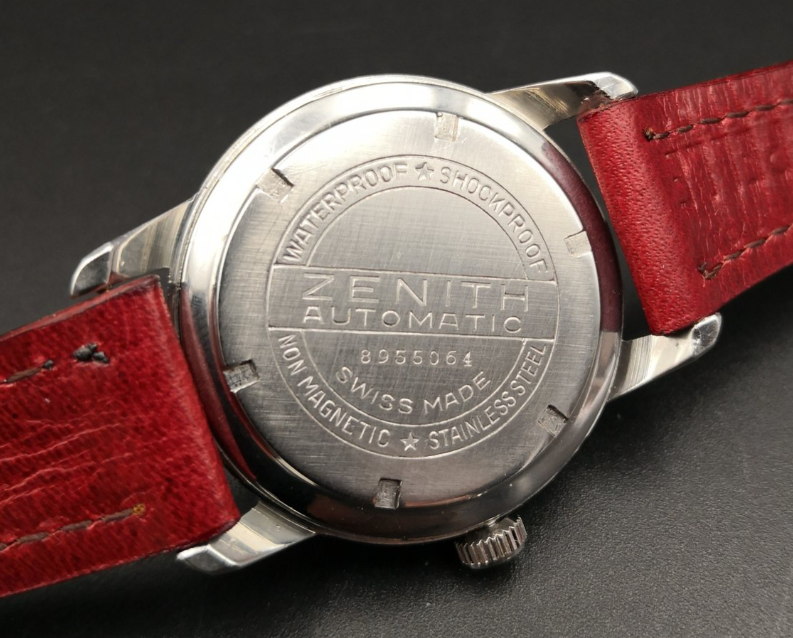

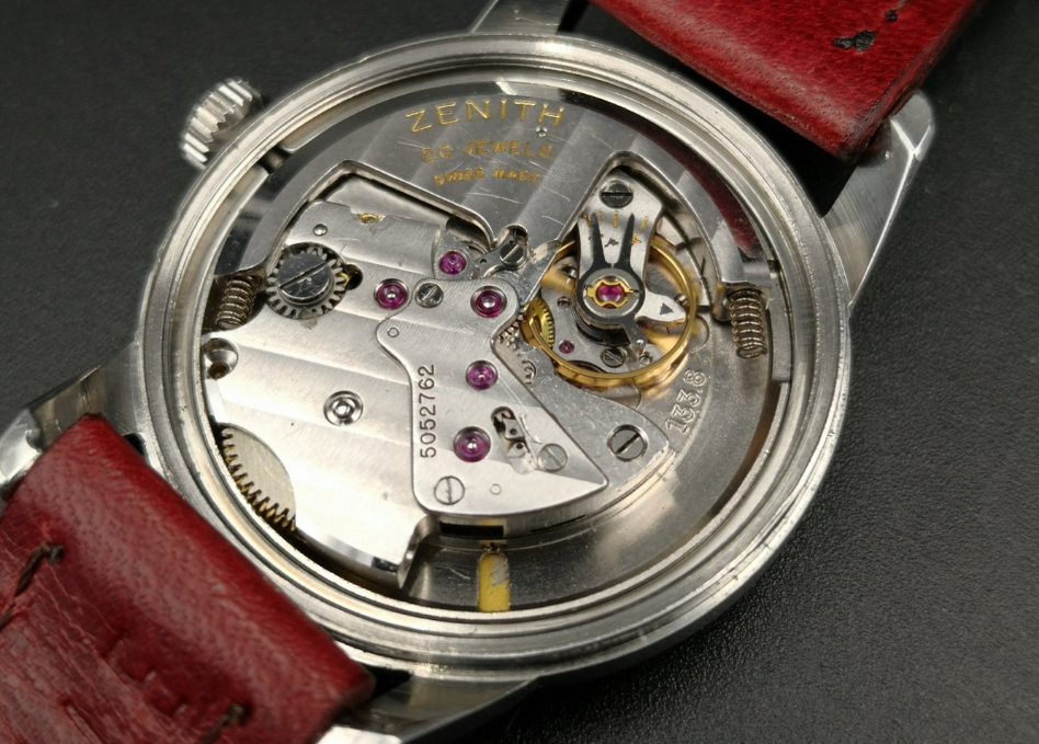

No rule without exception. In have a Tissot PR 516, new old stock, mint, and clearly original all the way. But the dial does not say "Automatic", although a cal. 784 (automatic) is fitted. There are, however, identical dials and cases, but with the "Automatic" inscription, just from another production run.
So the missing "Automatic" on the instant dial seems to be strong evidence, but imo alone is no absolute proof.
Best, Bernhard
8,246
29,135
Your Tissot is not analogous, as it was manufactured at the earliest in the '60s, when the novelty of automatic movements had largely passed. Can you provide a single, compelling example of an automatic manufactured in the '40s through late '50s without the dial designation?
632
2,137
Nothing easier than that. Look at the Harwoods, I do not know a single example WITH the dial designation "automatic" ... 😎😉
8,246
29,135
Good point! 👍
Any examples from major brands?
632
2,137
Not instantly. Aside the fact, that any specific example might be argued as a redial. 😁
1,993
3,575
Best, Bernhard
I have never seen a Zenith bumper without the word automatic. The watch is not legitimate since the case has been swapped out and the case number and serial don’t line up
8,246
29,135
Here's one: Patek Philippe ref. 2526.
Good example, and explicable, as PP typically employed understated dial designs, and did not require overt marketing for their relatively small, exclusive client base.
2,829
4,945
Agreed. I am struggling to come up with other examples. Even V&C adorned their dials with "Automatic" when applicable.
1,993
3,575

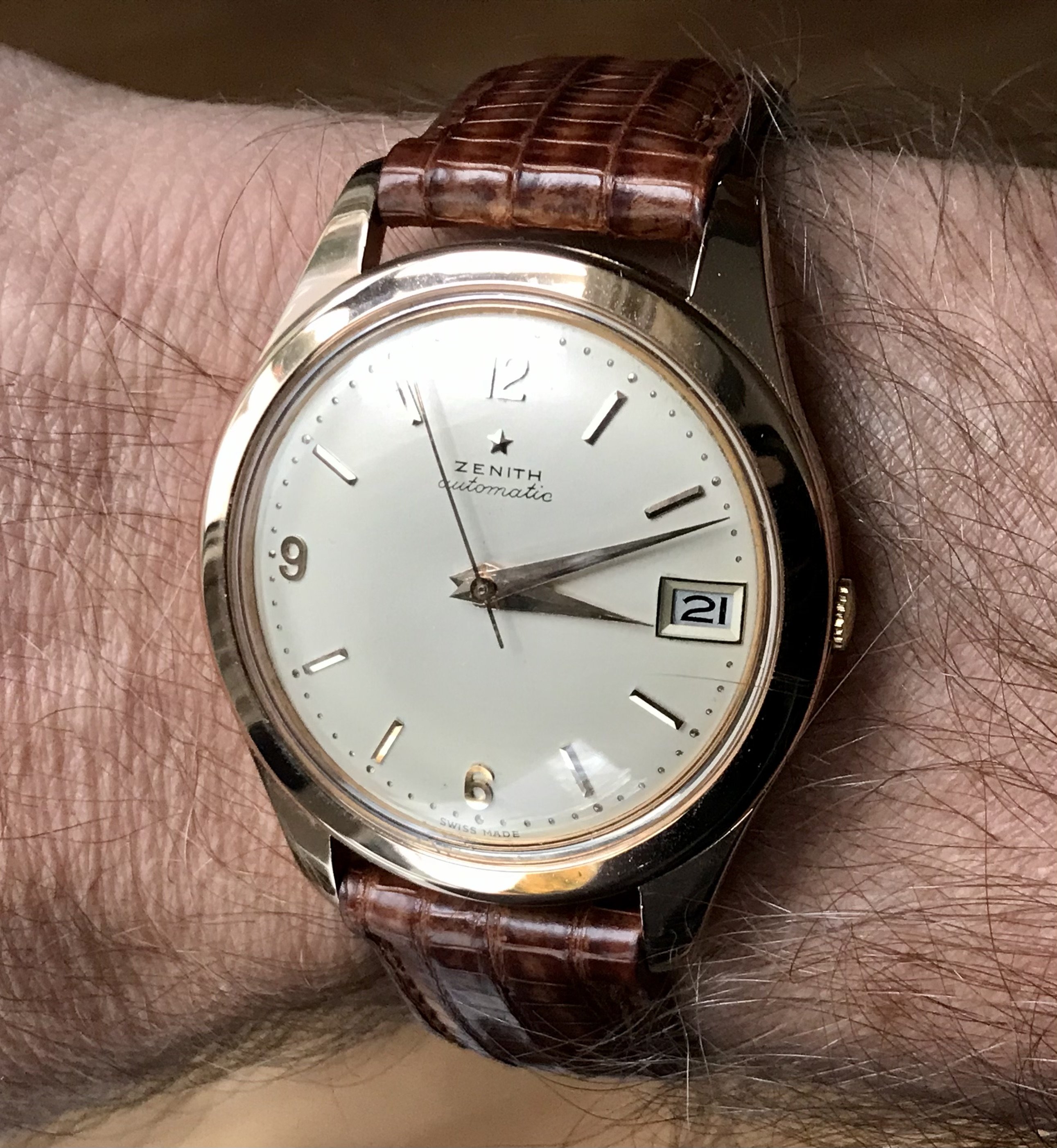

Zenith, I believe, was the first bumper automatic with central seconds. The first cal 133 always had automatic on the dial, same with the 133.8. I’ve not seen enough examples of the cal 71 to say that definitively but I think Zenith wouldn’t put out some pieces without that on the dial. This was a company who had won the Neufchâtel Observatory award 5 years straight and was very proud of their achievements. I’ll post a pic of what I believe the dial should look like with a serial number that high
204
352
Interesting topic and I appreciate all of the insights. My cal. 71 dial has the automatic inscription on it. I too have not seen any without it when looking at these great Zeniths from the 40s and 50s. However, I am no expert.
