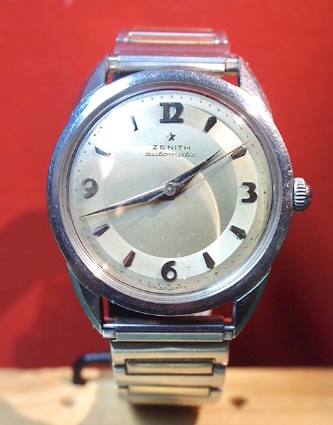

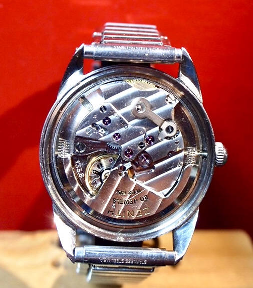

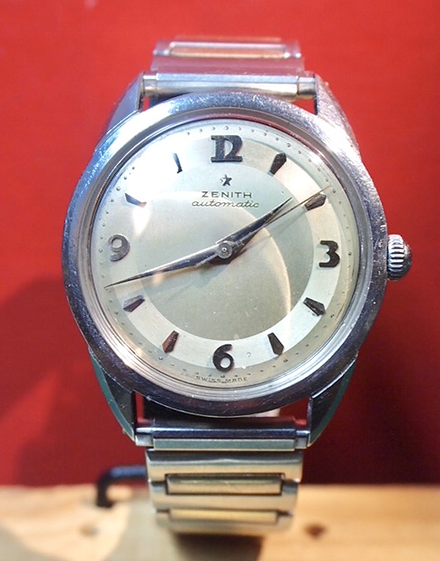

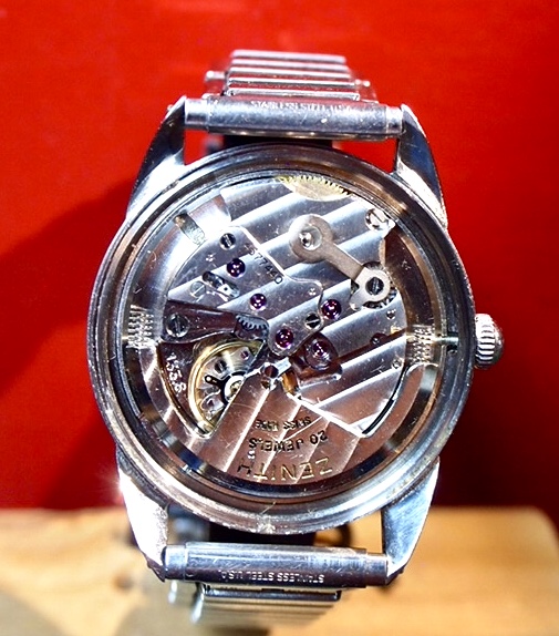

In another thread on the MB, I mentioned I was working on a Zenith bumper automatic wrist watch for a friend. There was a reply to the post requesting a picture. At that point, I was waiting for parts. It is finally done (mind you, I have thought that, previously! This is one of those watches you hope you never see again!) I have no idea what the designer of this movement was smoking when it was designed! But it is an odd design. Almost makes you believe the designer missed the movement design classes that every other movement designer went to!
- Make, Zenith
- Calibre133.8
- S# 4577440
- Jewels 20
- Bumper automatic wind.
- Era, circa 1956
- Case, stainless steel

That's a nice-looking watch. Worth the effort IMO. 👍
With respect, that is quite an extraordinary assertion! The movement, and its predecessor (cal. 133), were designed by Ephrem Jobin, who also designed the cal. 135, which is widely considered to be one of the finest manual-wind movements ever produced!
Zenith also won many Observatory competitions and awards on the basis of Jobin designed calibers. I would also add that the 133.8 was, in my (lay/collector) experience, the best finished high-production bumper movement that was produced by any manufacturer.
So, what, exactly, are your objections to the 133.8 design?

Put it this way. First, it is an unusual deign, and obsolete. I had to find a part for it which my supplier was unable to supply. I found a part from a supplier in Australia. It took a month to get here! Now, time to put it back together, but it’s unusual design slowed that process down as it had been in pieces for a month. This is a 65 year old watch with a lot of miles on it. I finished it several weeks ago, and it ran for three days, and quit! Dam roller jewel fell out, and I was unable to find it. It was a very tiny jewel, but I found another, and shellacked it in place. Somehow (and I have no idea how), in the process of removing the roller table and putting it back on, the top pivot of the balance staff was broken. More delay! Finally, today, it runs again. The auto wind system on this thing operates only in one direction…..like most bumper automatics. Right now, it runs because I hand wound it. I have to let it run down, then try it on the watch winder to test the auto wind. Old watches are often an especial challenge. This one in particular. If I were ever confronted by another one (unlikely), it may not seem so strange to me. But this is the first of these I have encountered.

Make parts? I have made parts for watches, but not a jewelled lever (pallets), and that is not something pretty well every watchmaker would not be able to make! Balance staff? My supplier was able to supply. This calibre has a very tiny balance staff. I’ve made balance staffs, but nothing that small! Were you under a delusion that any “watchmaker” should be able to make ANY part of any watch, if he has difficulty finding the part he needs? Give your head a shake!

The dial reminds me of the 1st Gen Nivada Antarctic from 1958.
