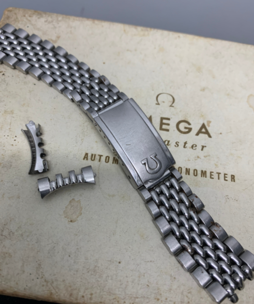

this is the BOR

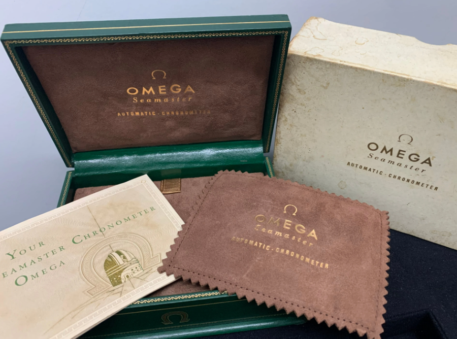

and box

The watch looks fine, and the original Seamaster Chronometer inner and outer boxes and BOR bracelet have significant value individually. Negotiate by all means, but I think you should buy it anyway.

The box and bracelet are way too early for a 29,7xx cal564 (1969-ish?) watch.
However, they are really nice and are definitely worth having.
A complete, early, green, Seamaster chronometer box like this, with tray, cloth and (somewhat foxed) outer, must be worth $200 on its own nowadays - likewise the 5-row BOR. .

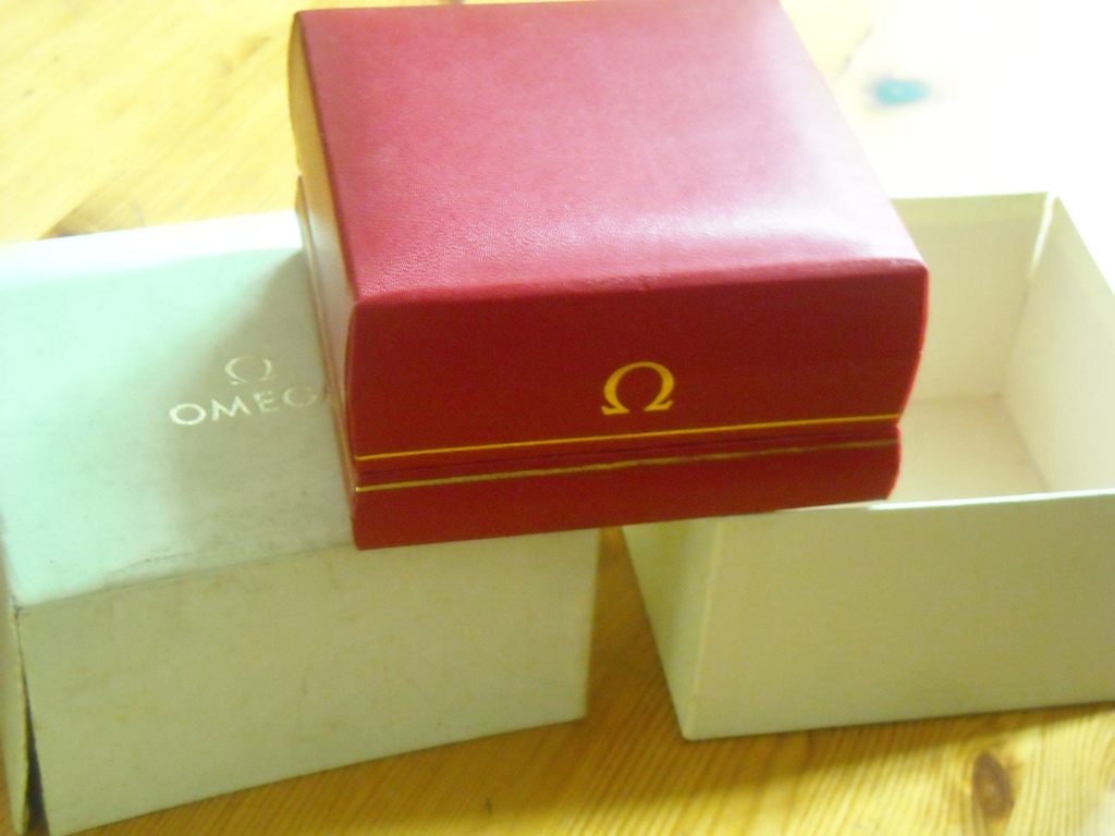

An alternative would be the standard Omega box shown second below (courtesy of @omegastar )

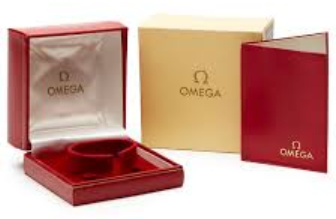

Yes. I saw one with original box and papers. It came in the red box like the one above or something like this. Forgot which one
