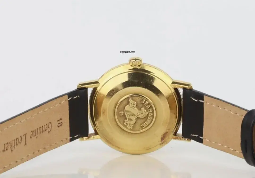

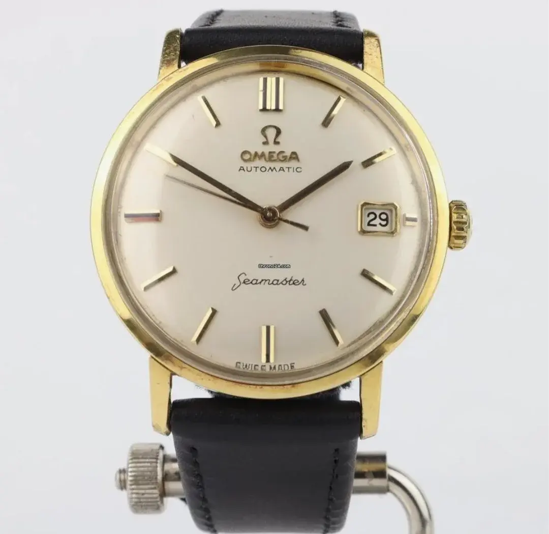

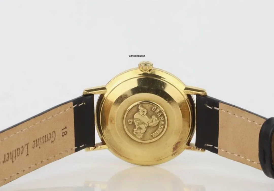

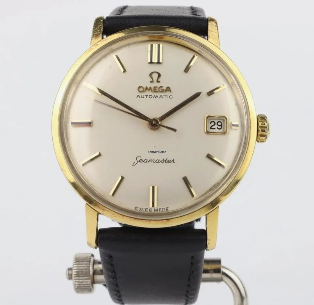

Here are the photos of the front and back, I have contacted the vendor to ask for a shot of the movement too.

Well, of course I may be wrong but I suspect that the dial is repainted and the minimal mention of the dial (the seller says it’s 'white') makes me suspicious.
Again, I think that the watch is overpriced and for that price I’d expect photos of the movement and details of a service history.
So, I’d say eye-candy and keep looking

Dial looks ok to me. I doubt you’ll get a movement photo.
If I recall correctly, some of these were in gold filled cases, so you should make sure you get a photo of the markings indicating that it is solid gold, because that’s where a lot of the value is

The back of the top and bottom lugs, on the left side, look pretty chewed up to me. There appears to be metal missing. Being worn for years on one those old flexo straps can cause that.

I wonder if the dial has been cleaned, removing the minute markers but retaining the text?
The case does appear to be a solid gold version as the back is slightly different to that of steel and gold fill

No ticks is a problem & chewed up lugs make it a no go.

The Swiss Made font looks a bit odd, you might want to cross-reference with similar watches.
It's because it's distorted by the crystal edge. But the lack of minute markers is not looking right.
I'd pass.
