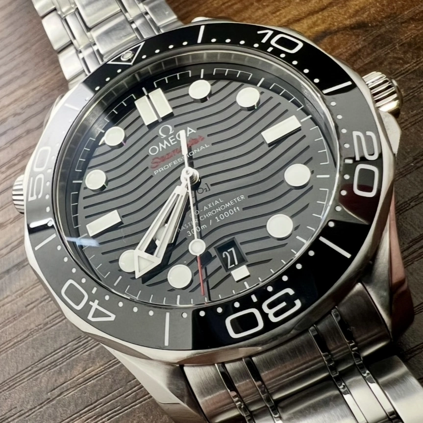

Omega agreed to replace my dial (and hands) due to the scratches the last technician left behind. Here's the new look:
However, the saga unfortunately continues...

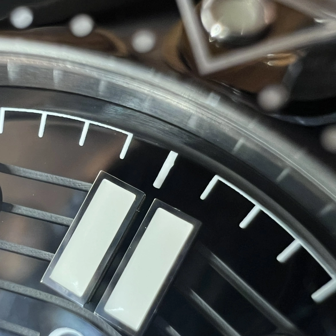

Dust on the new dial:

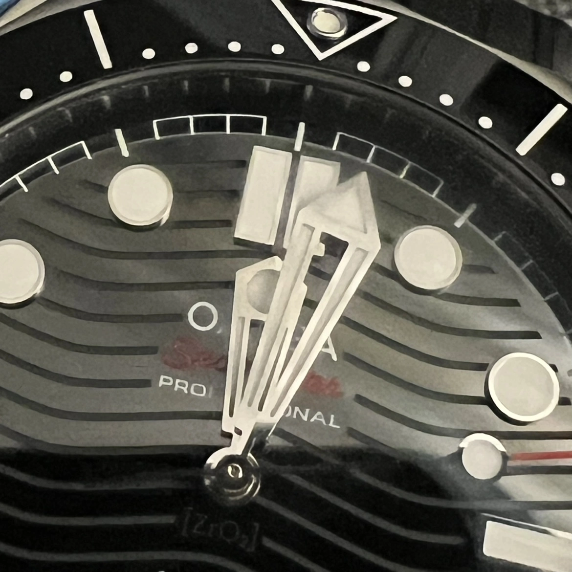

Hour hand misalignment (2 minutes):

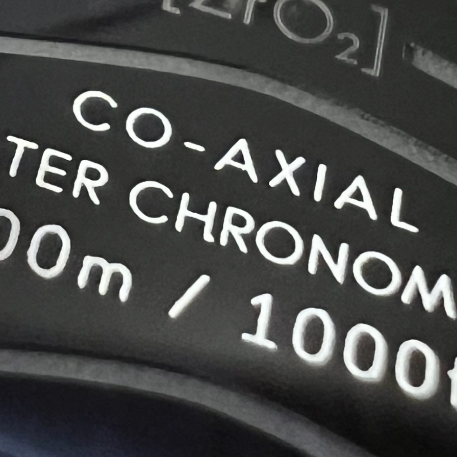

Also noticed the printing looks less sharp than my old dial (e.g. letter "H" here), however, I'm not too bothered by this:

The dust under the crystal is unacceptable. I'm sure the hands are within tolerance though.
This hour hand doesn't look misaligned to me. Pretty clear it's 12:02.

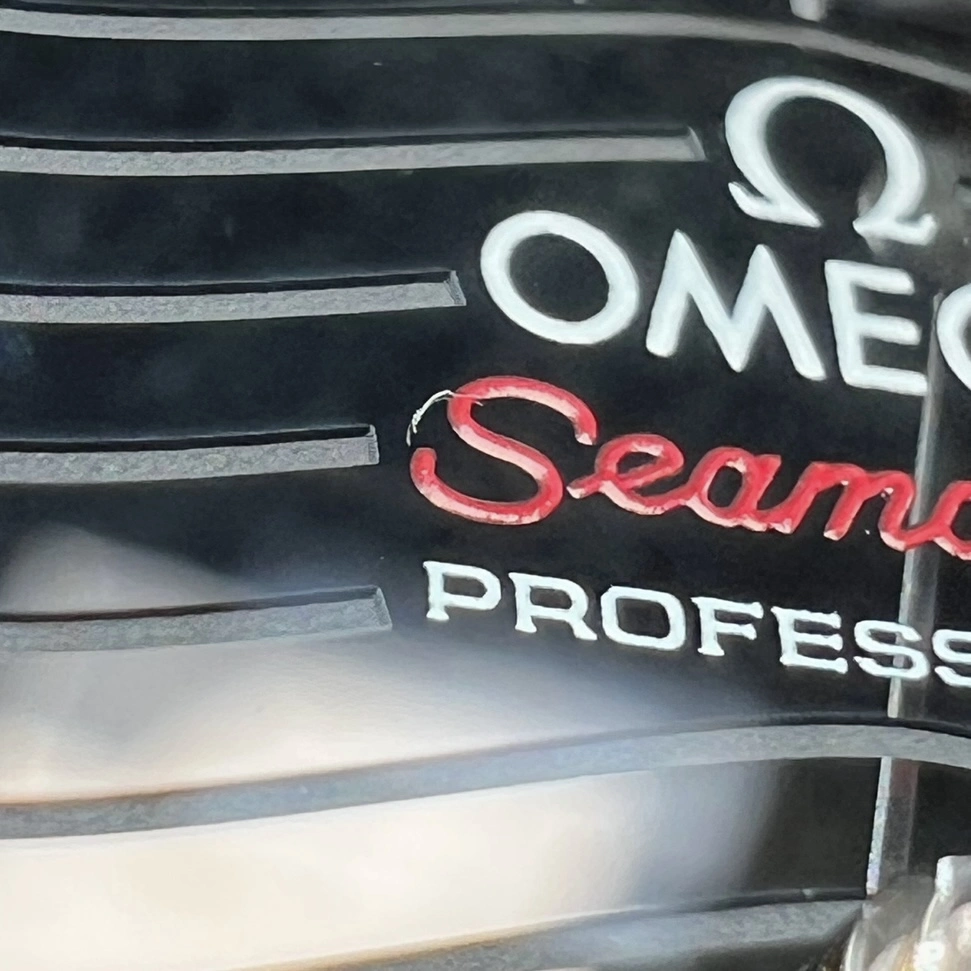

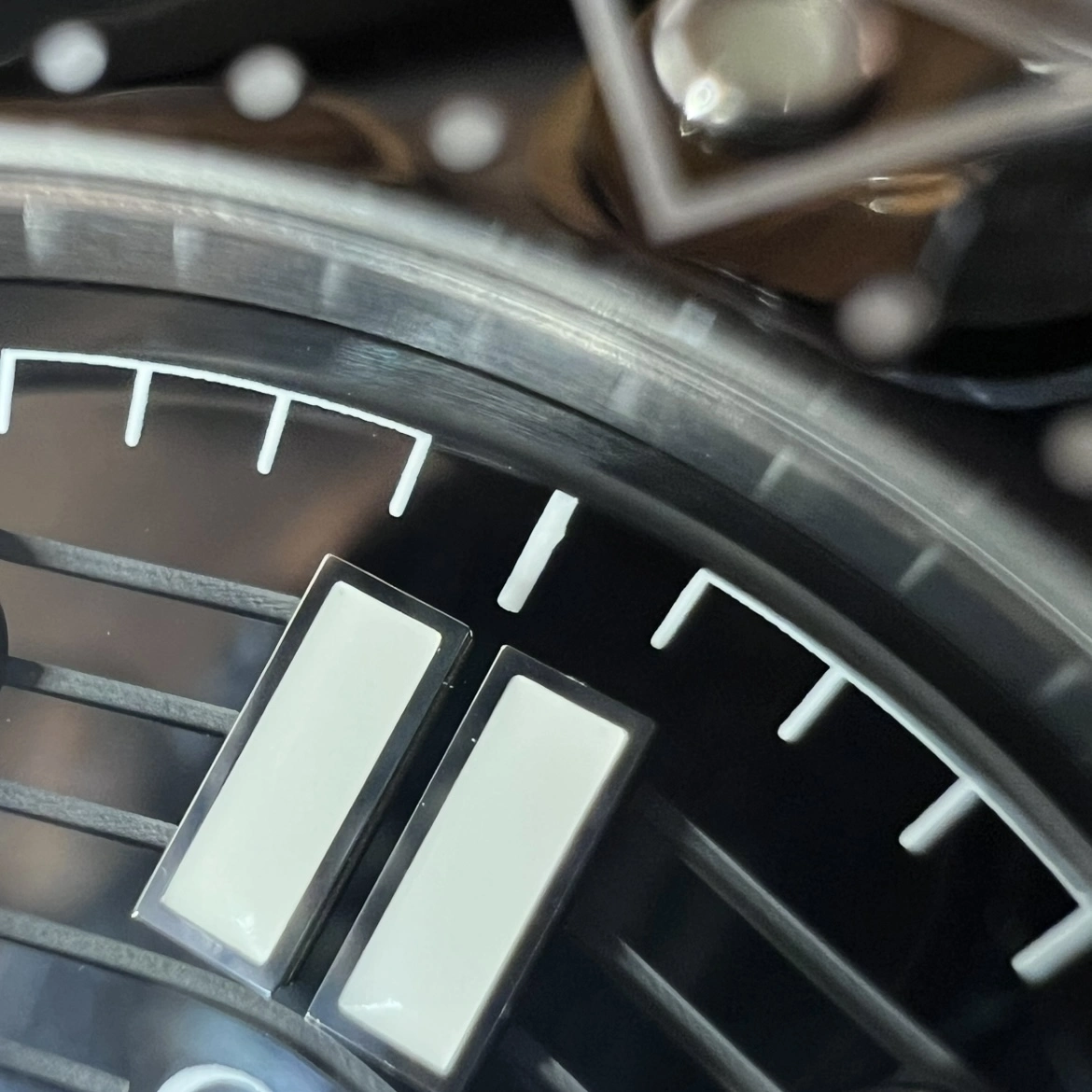

Regarding the “H”, the printing on this new dial is just more crude. It just looks less sharp than the original 2022 dial in the watch. For example, the over-inking on top the 12 index:
I realize the white ink is probably stamped on to the dial so over-inking like this could happen. I’m honestly not too bothered by this.
As to the hour hand misalignment, it’s definitely misaligned by exactly two minutes. In the picture above, the hour hand is perfectly centered at the index, and the minute hand reads 2. When the minute hand is centered at the index, the hour hand lags just slightly—indicating a misalignment.

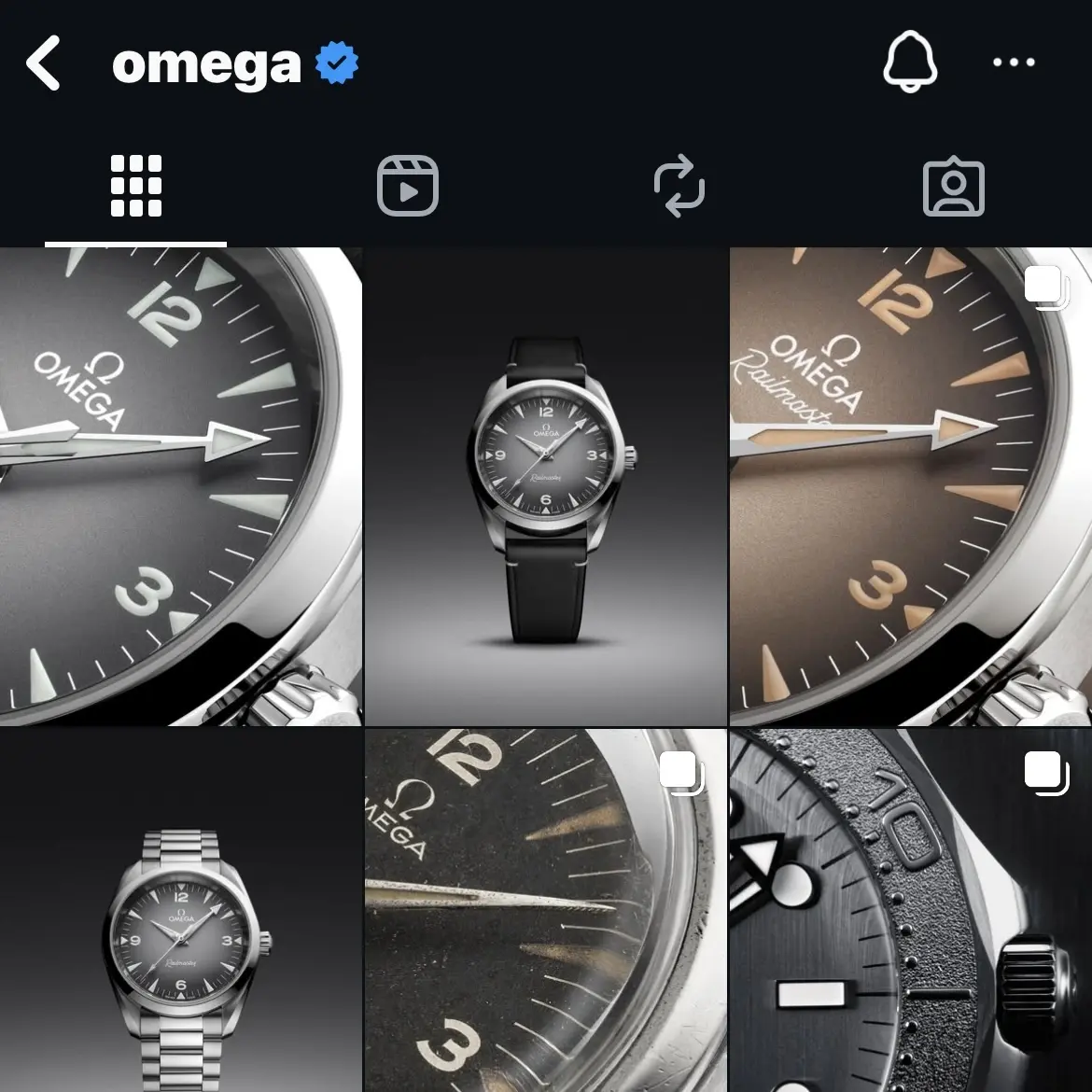

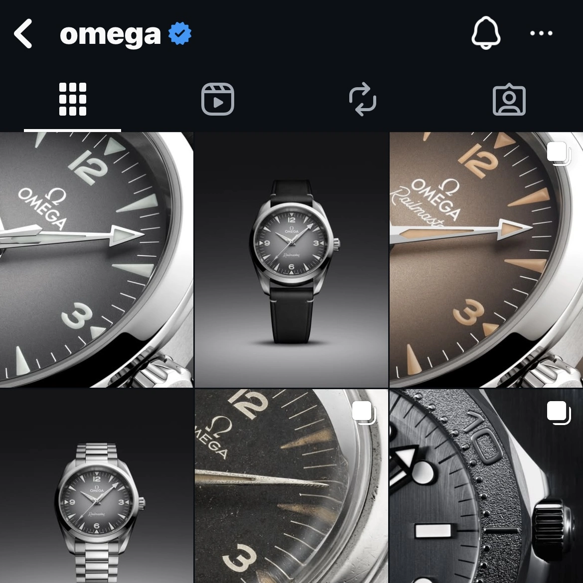

Macro shots are fun. The brands sure love doing it:
Speedmasters used to come with loupes too. This is a now discontinued practice, I’ve been told.
