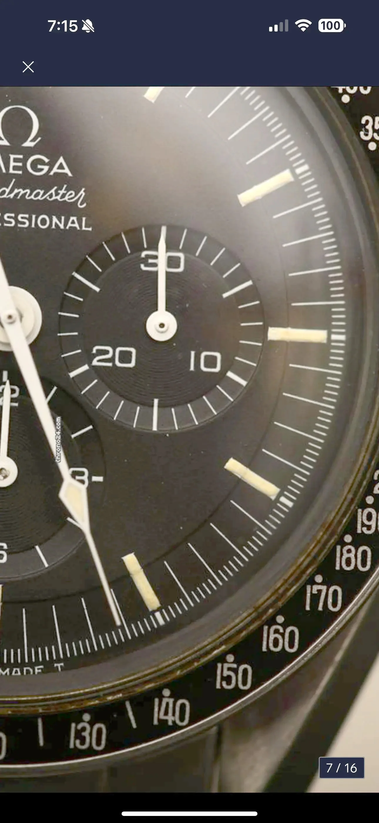

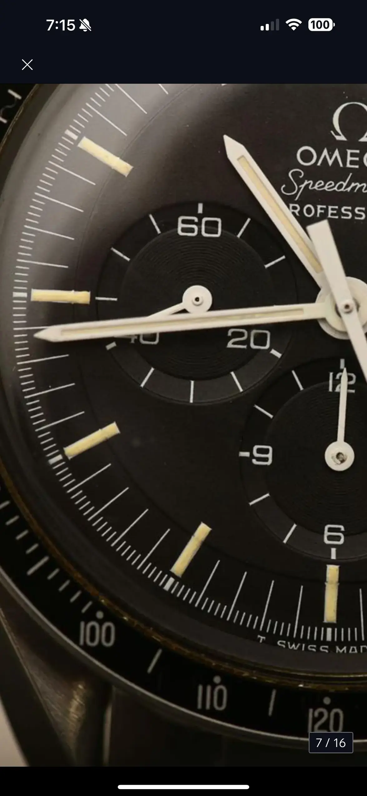

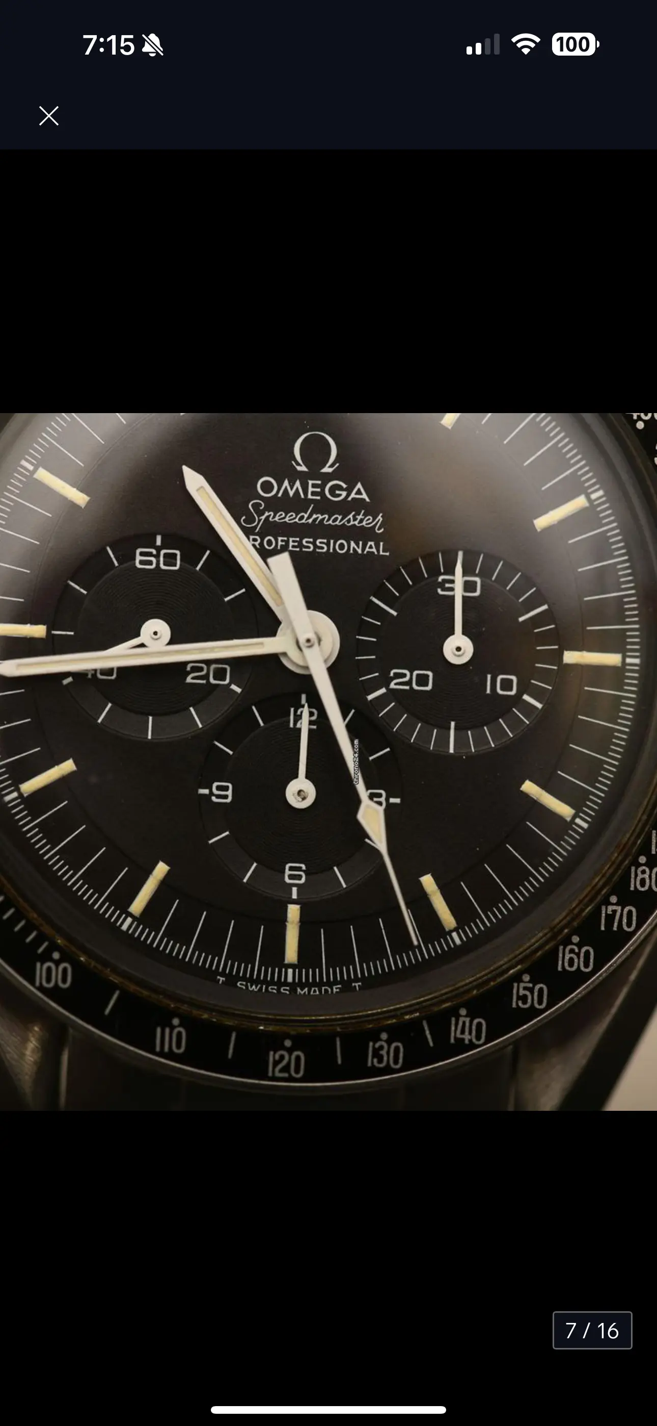

The gunk peeking out between the crystal and bezel. Dirt or possibly corrosion?
2,477
3,867
It's common on the Speedmaster since the bezel is friction fit and the gap ends up being a mini gutter for debris, as opposed to a diver with a bezel that allows water & debris to flow through it. It's unlikely to be corrosion. Easy to remove the bezel, clean, then reinstall.

Good to know. In that case can it ever be a positive sign on a vintage speedy? Implying that the watch hasn’t been pulled apart / mucked about with too much if the grease trap is looking relatively untouched?

Well, I'd probably look at that nice beige aged tritium handset and hour markers as opposed to possible poop stains in the bezel to determine condition......

Yes indeed. I’ve been learning up on vintage speedys but haven’t focused as much study on bezels so just beginning to crack the codes on bezel / case interplay. The dial and hands are quite nice IMO.

It’s a reason to look further. Sometimes it’s just gunk, sometimes it’s surface corrosion due to gunk and moisture being trapped between the bezel and case.

If the case has a lot of gunk on it it's more likely it's dirt and not corrosion.
I would not worry about it.
Dial looks great.
Focus on the right details, it's easy to obsess about small details on these... speaking from experience.

There's no need to remove the bezel to get most if not all of that out. I use peg wood, but if you have a toothpick that might work also - use a knife to create a thin wedge shape on the end of the wood, stick that between the case and crystal, and then sweep it around the crystal. It will dig the dirt out very effectively in my experience.

You can use a Post-It note which has adhesive on one edge, that will often pick up dust, dirt and whatever has decided to fall into the gap.

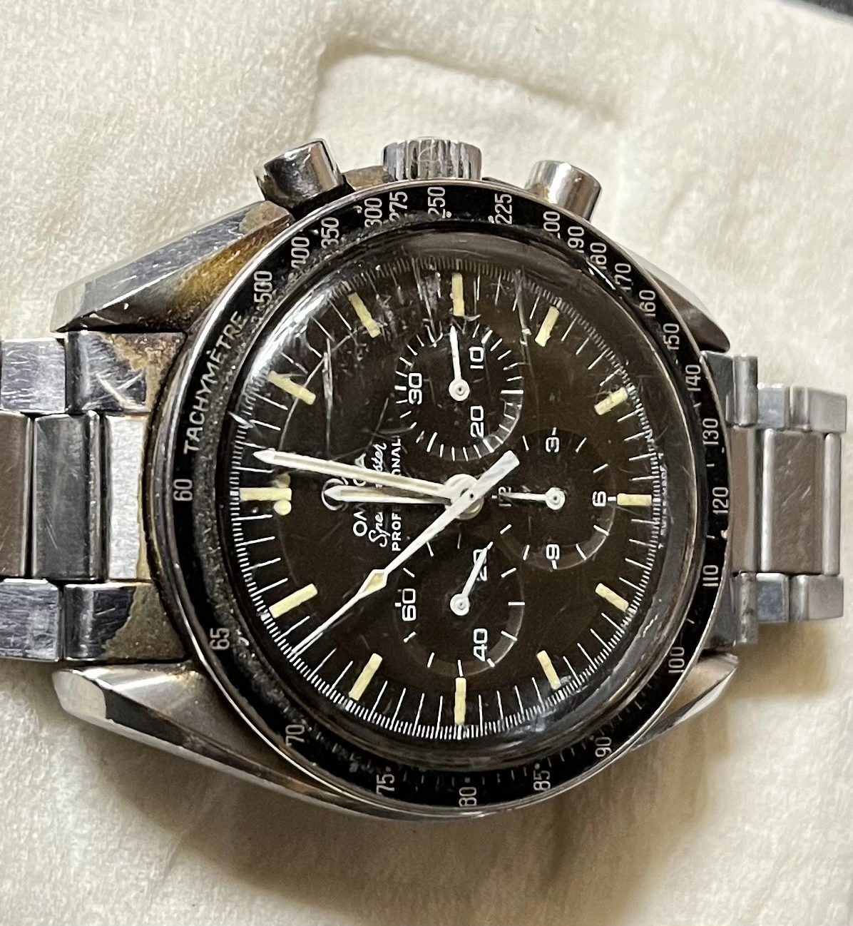

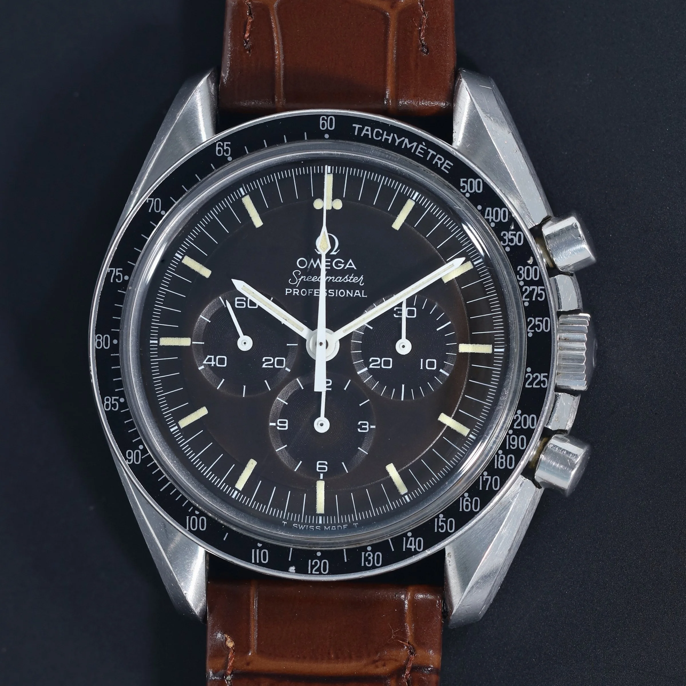

It’s definitely called wrist cheese and mine came with extra cheese. It does clean up! 😎
This definitely scratches the brain itch. Like a phoenix rising from the ashes.

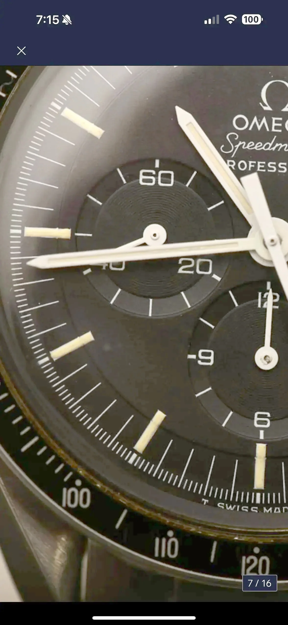

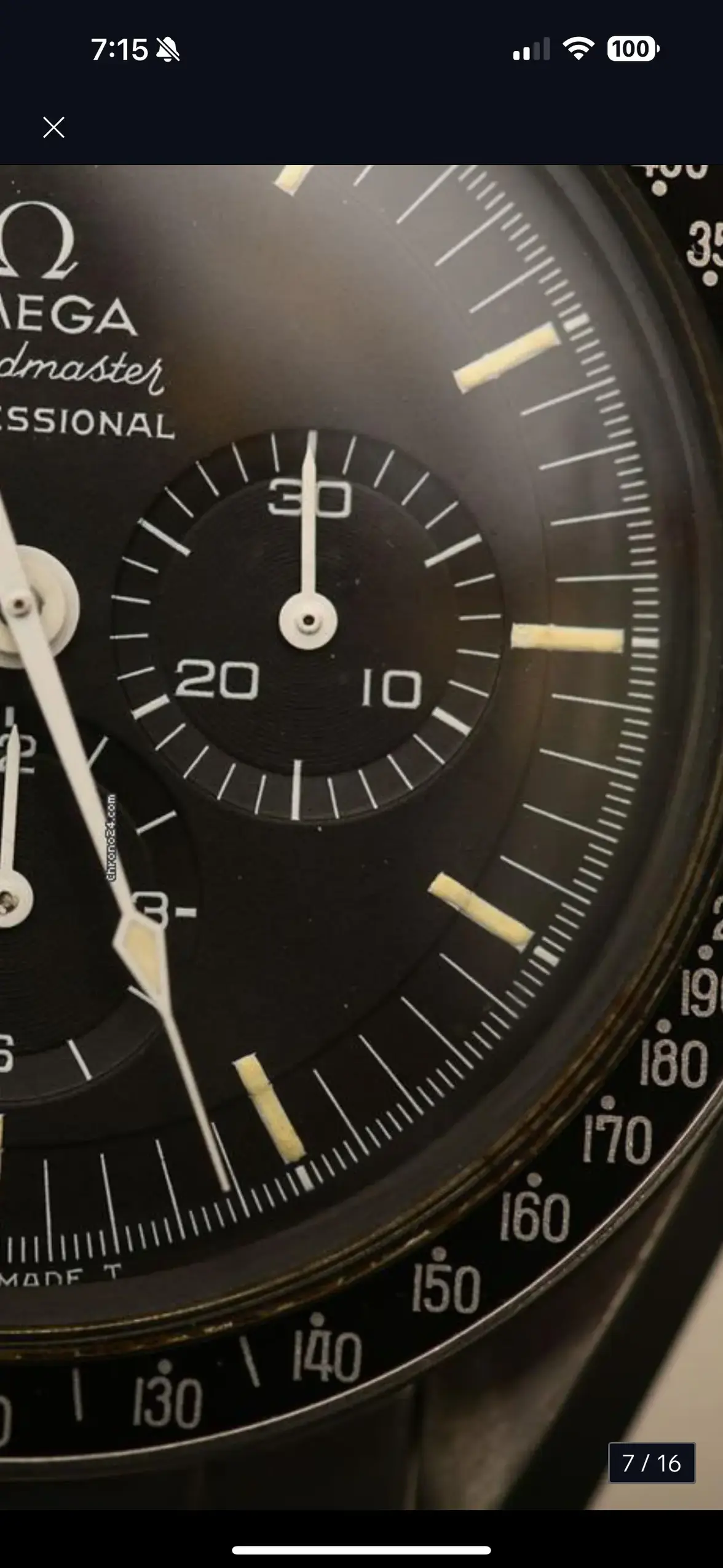

It is difficult to tell by these photos where the area in question is so poorly lit.
I have photoshopped the brightness and now it looks like this
Most likely it is debris but I am unable to exclude corrosion in the lower right area in the second photo - could be both...

The fact is, dirt/gunk/debris can lead to corrosion. Anywhere you have a build up of gunk, it can hold moisture which caused corrosion. This is particularly a risk in areas where the gunk can’t escape and ends up sitting there for decades.
In many cases, gunk is just dirt and can be cleaned up nicely, with the metal underneath being fine. But it’s not uncommon, particularly under bezels and between the lugs if endlinks are chock full or dirt, to find surface pitting/corrosion has taken hold under the grime.
The only way to know is to check.
