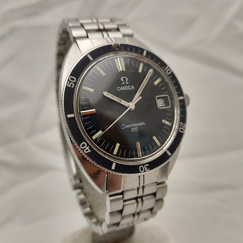

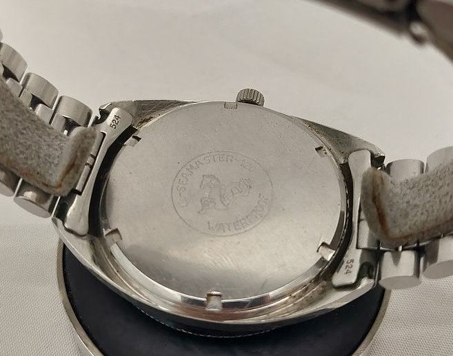

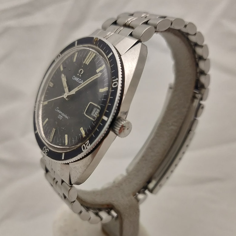

Hello friends, sorry for the bother with another vetting thread, but I recognize that I'm totally out of my zone when it comes to these models. I took some time reviewing past threads (especially this great mini guide LINK) and this watch seems to pass an initial vibe check. Unfortunately, I don't have any movement photos, but will try and request some depending on your thoughts.
It is clearly missing the lume pip and generally seems worn. Does everything check out and does this look like an "honest" original? How hard are the lume pips to replace? Lastly, what would you say this is worth? I had some trouble finding similar comps. A few years ago, these seemed rather easy to find sub $1k but the prices seem to keep climbing. I'd rather not miss the boat and get one while I can, but I definitely want to avoid overpaying and buying a fake/franken. I appreciate any advice or insight you can provide! Thanks!

Looks good. Crown replacement. If it would have the lume pip and correct crown it would easily fetch 2k euro. This one between 1,3 and 1,8k. Although better pictures are required to make a really good judgement of the condition. Especially of the dial.

Agreed on price, but add another $300 for the bracelet- these are not easy to come by with factory bracelet.

And +1 on better pics of the dial. The flat lighting makes it hard to determine if we are seeing crystal marks or dial damage. I would want a few shot in raking sunlight to really reveal what the surface of the dial looks like.

I think if you would place a lume pip you could go to 1,8-2k. Bezel is in good condition compared to other bezels. If the dial is in good condition you have a winner.

The wear to that bezel would probably be a deal-breaker for me TBH. Scraped all the way around at the outer edge. These aren't so uncommon, so you might as well get a good one.
