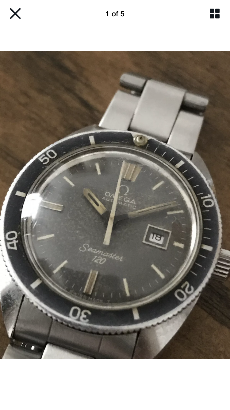

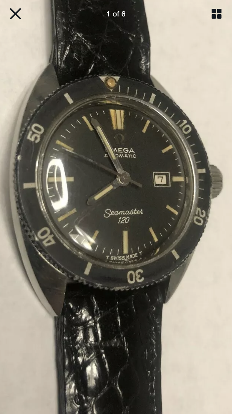

66
11
Wondering about these two. Seem slightly different although same model.
