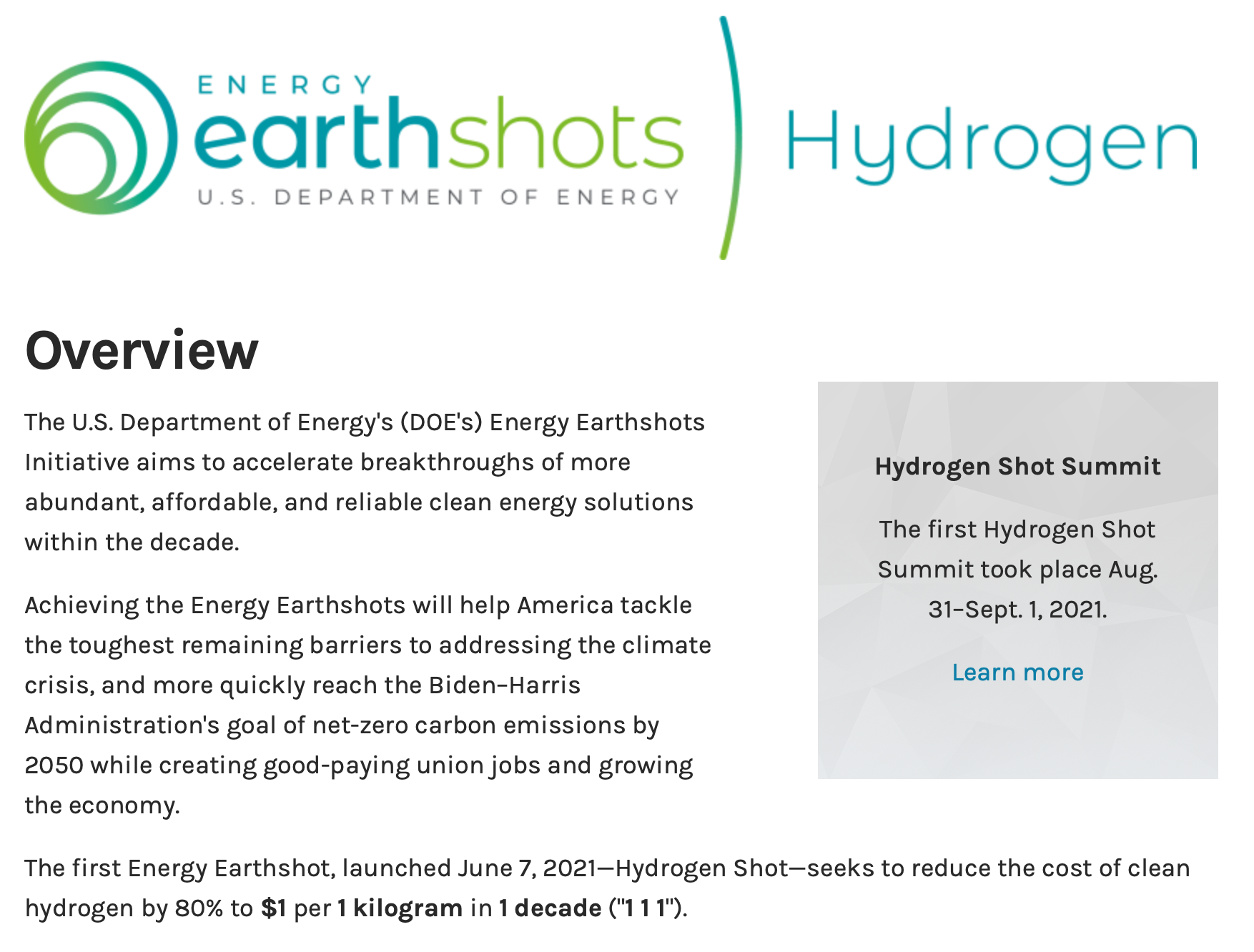

We have taken a break from a focus on hydrogen, but it's likely to have a huge role in future energy storage. In fact, the first DOE "Earthshot" involves hydrogen.
https://www.energy.gov/eere/fuelcells/hydrogen-shot

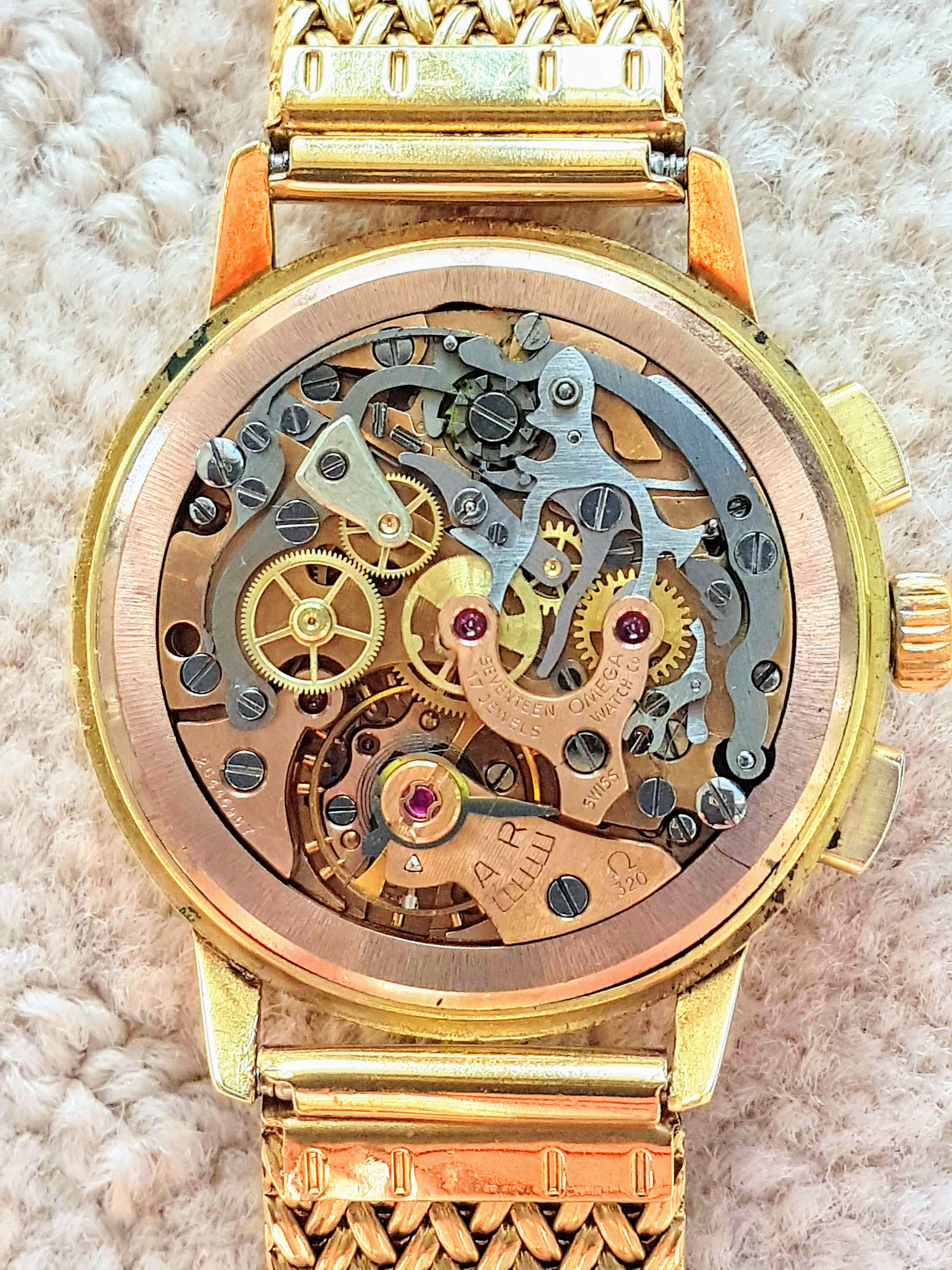

I found and purchased an Omega De Ville chrono with a 320 movement , it came from Italy ( beware).
On arrival If the chrono was running it would stop after a few mins.

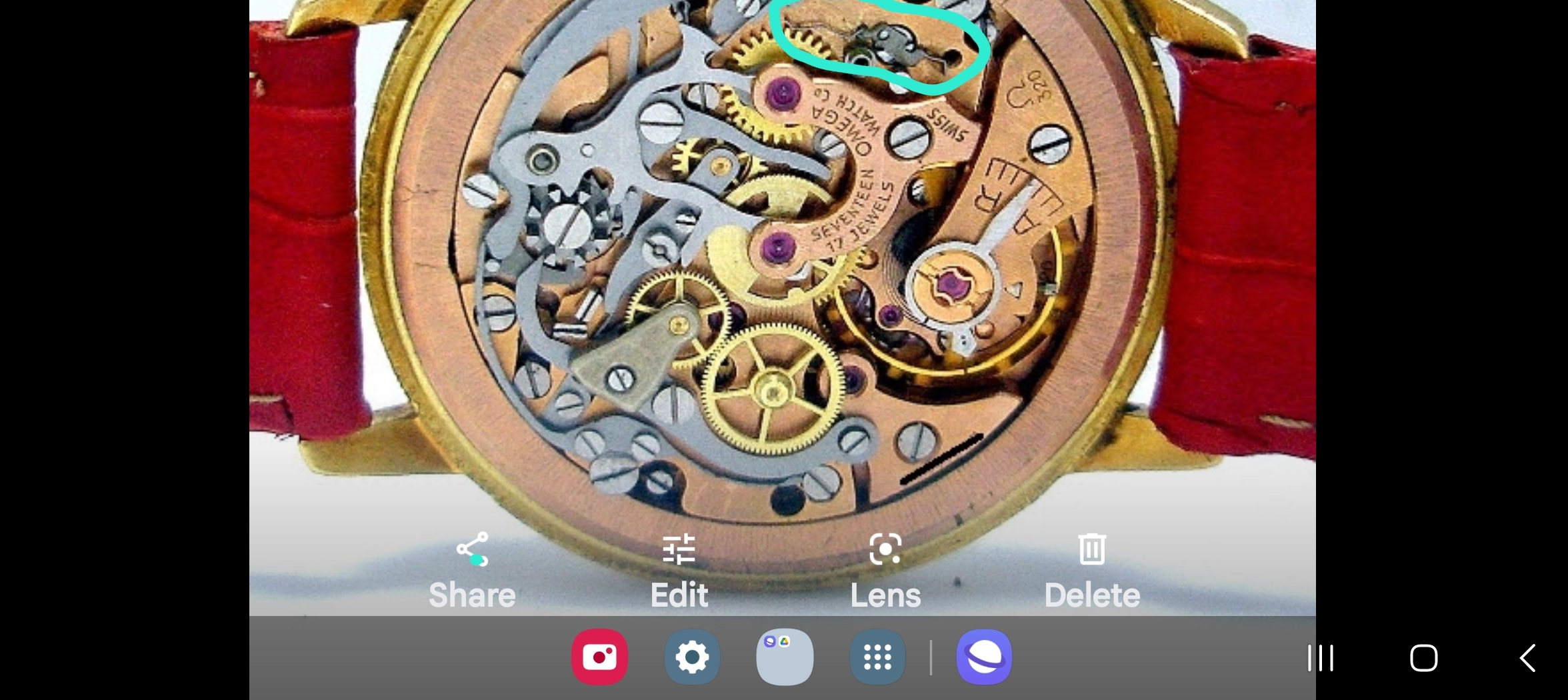

Off to Lewis Watch Co in Perth Australia. Adam spotted the problem Immediately, the minute pawl was incorrect ( high lighted in blue ). A spring had been glued on to the locating pin to do the job of the minute pawl !
The second pic shows the correct minute pawl installed. A full service later and the watch worked flawlessly and is now owned by another OF member.
