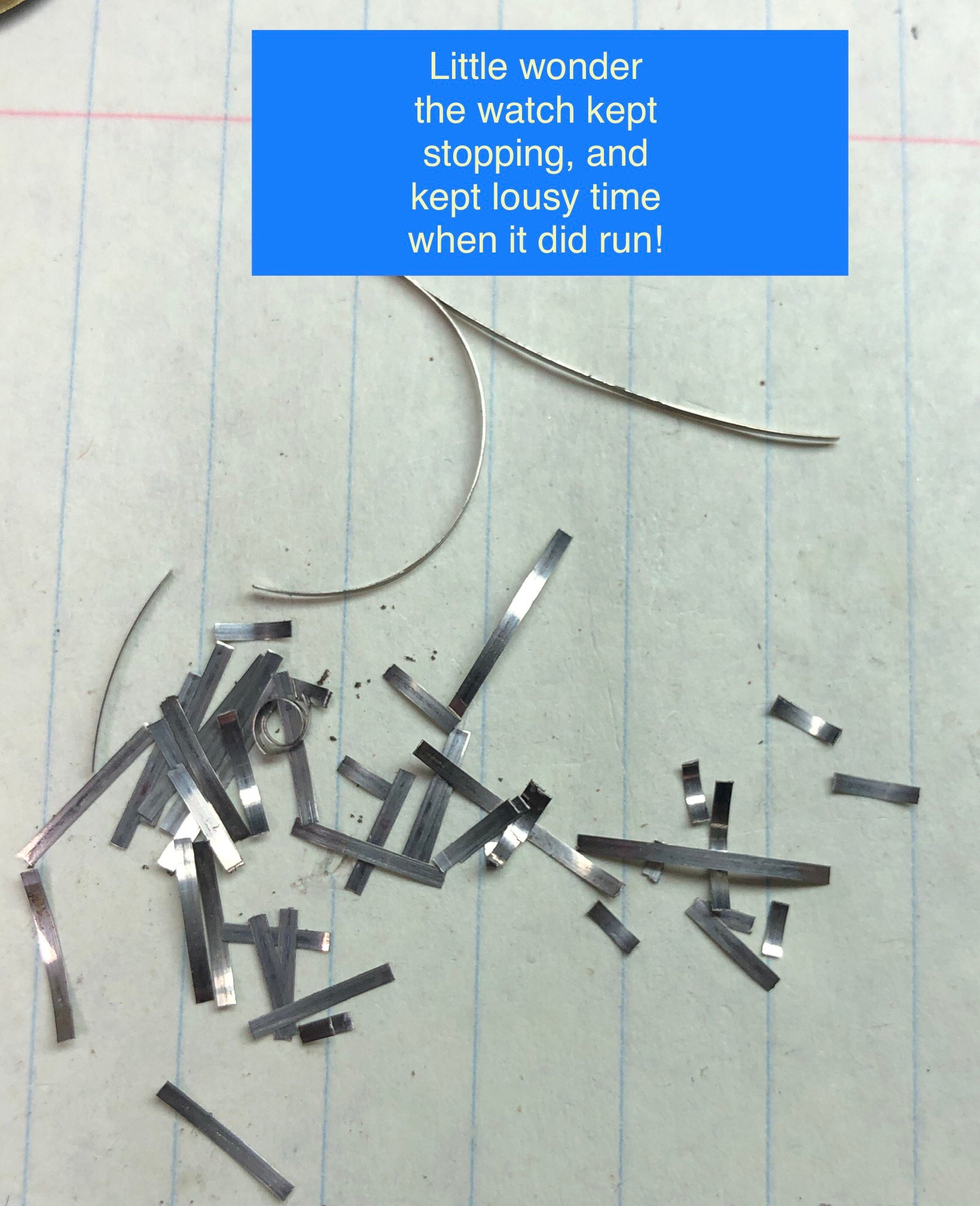

This was not the result of watchmaker slip-up. But it was a discovery that startled me. The owner told me the watch was erratic, and had no power reserve. I suspected a broken mainspring, but THIS!
The materials engineer in me has gotten really curious about this one, a long shot i know but you dont happen to randomly have a fragment of that mainspring kicking around still? (I know I hoard a lot of stuff even when its still broken "just in case I can find a use for it later") I think a look at the fracture surface might be most enlightening.
Regrettably, no. I don’t have any of that mainspring, any longer. The watch was about 20 years old at the time. These alloy springs have occasionally cratered at about that time in their lives. But never before have I had one disintegrate the way this one did!

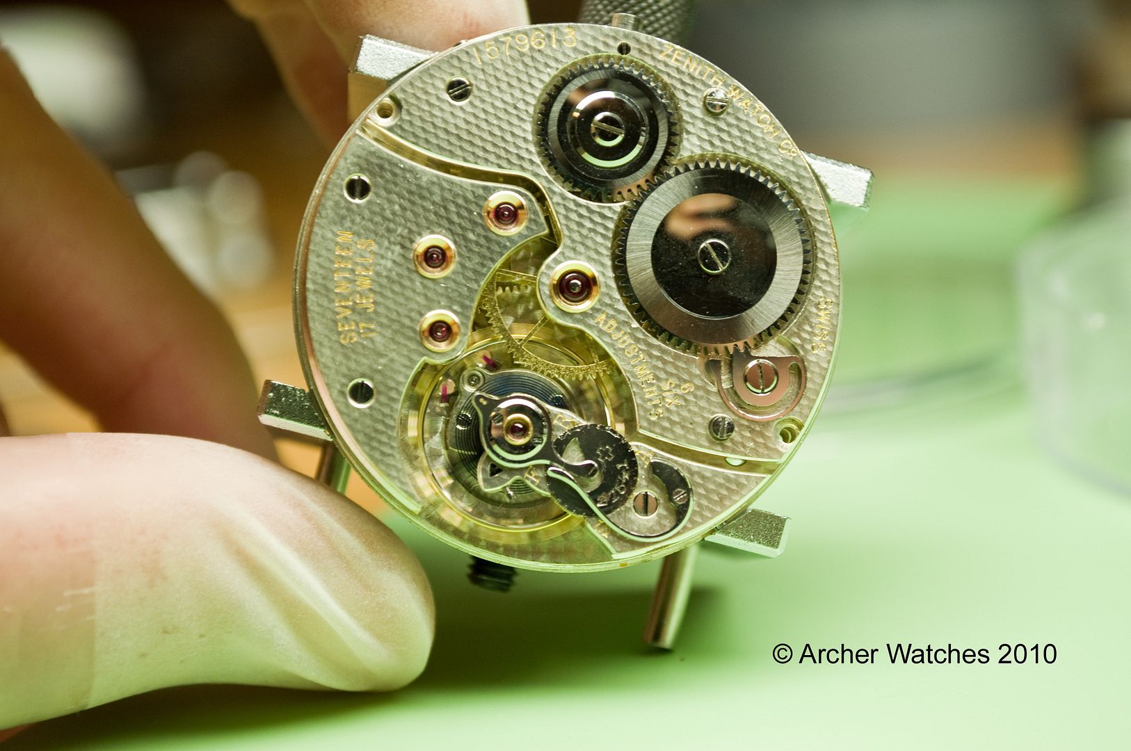

Where do I even start...picking the worst would be very difficult, so I'll list a few contenders for bad work, or just plain dumb work...

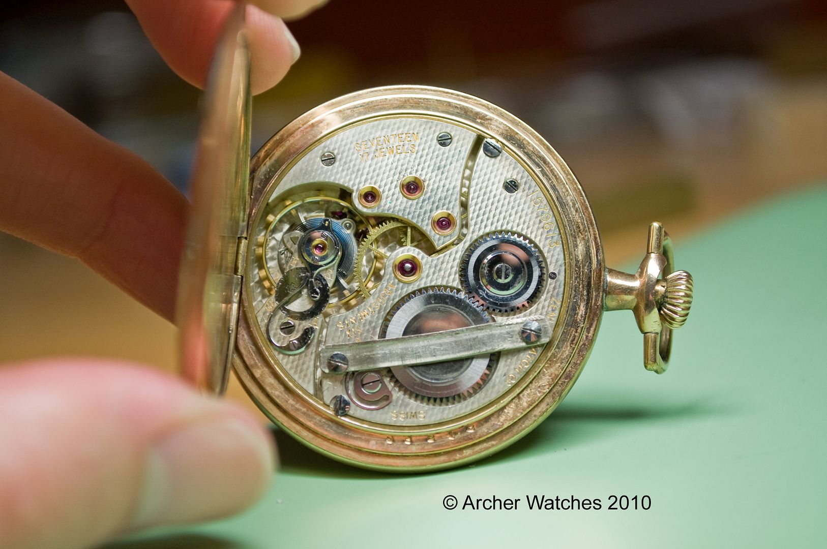

Start with this nice Zenith pocket watch...

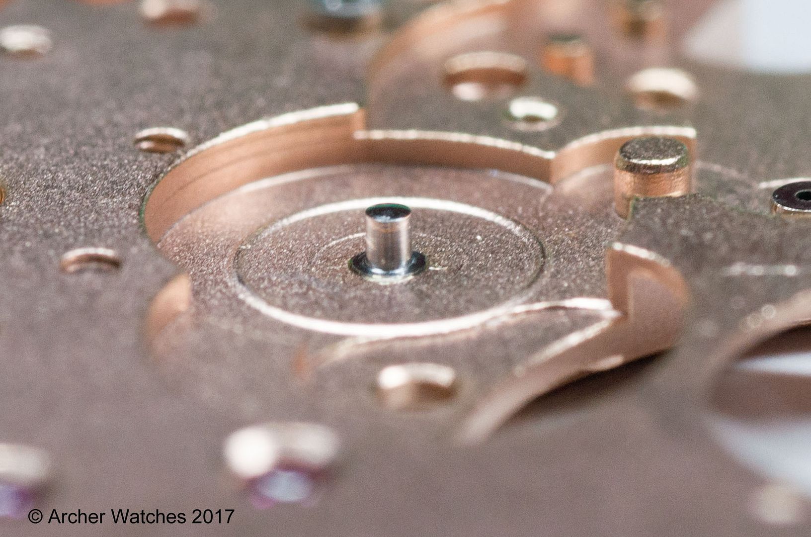

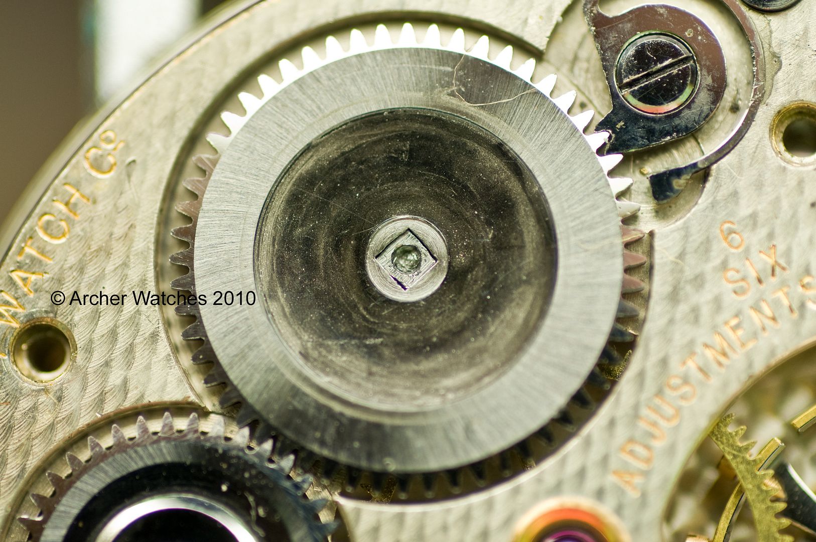

How to keep the ratchet wheel in place when the screw is busted off in the barrel arbor...
New barrel arbor and ratchet wheel screw were made for this repair...

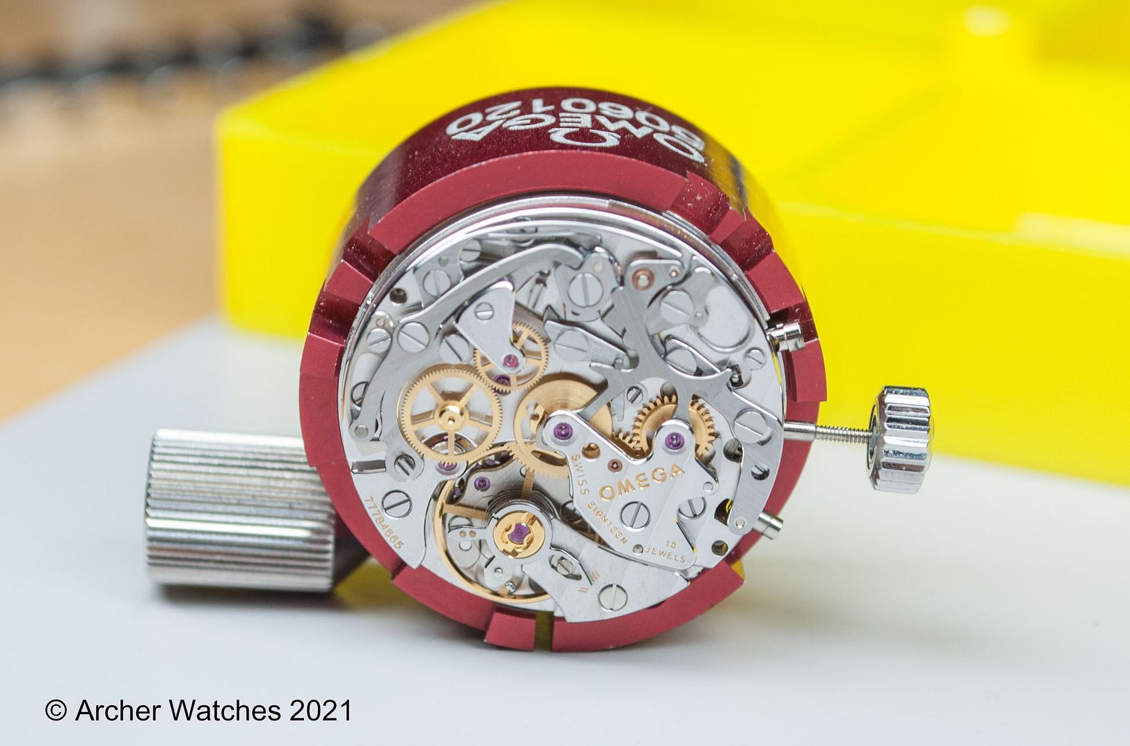

Someone was using something other than the correct tool to remove the chronograph drive wheel on this Speedmaster movement...

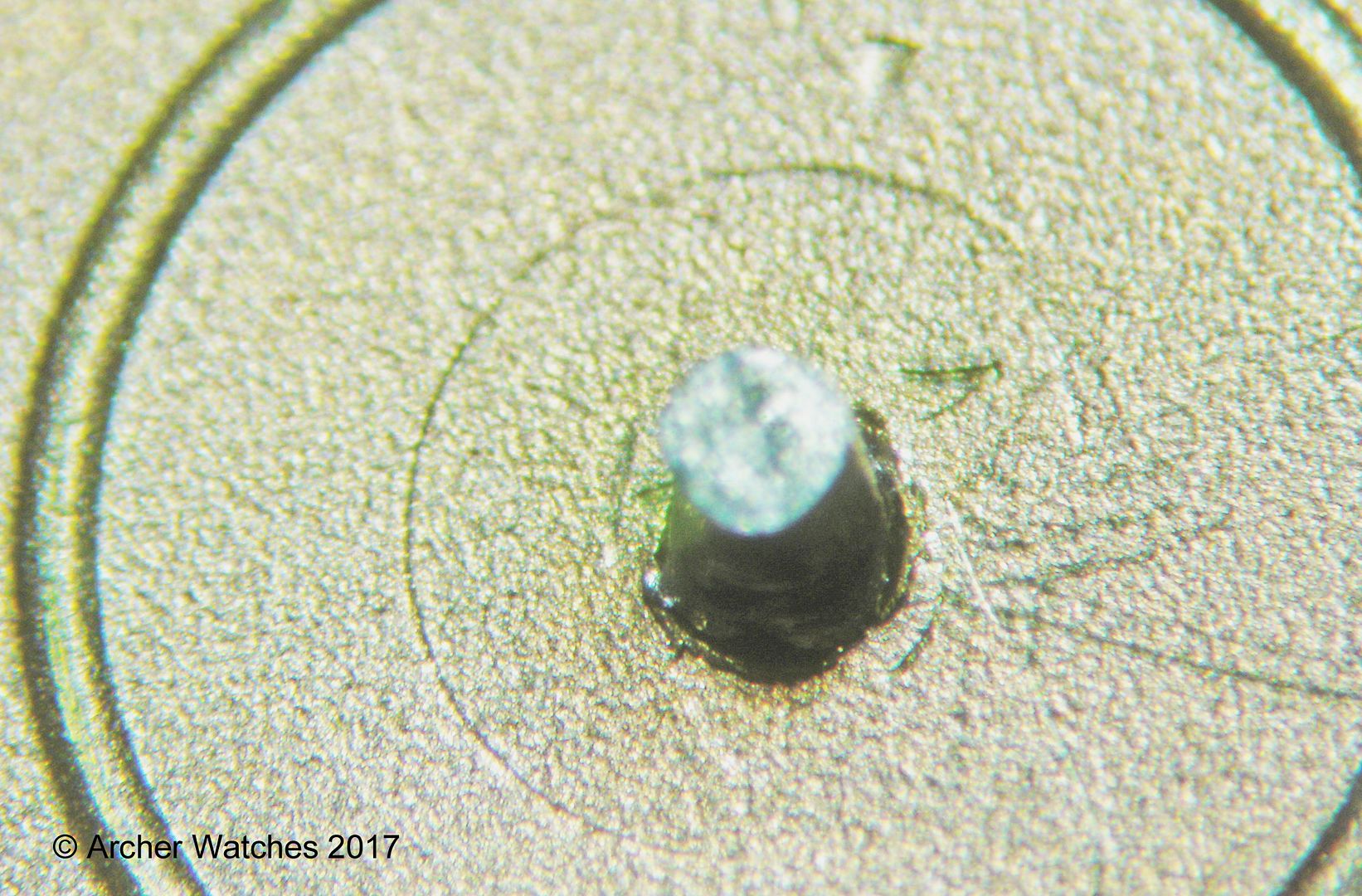

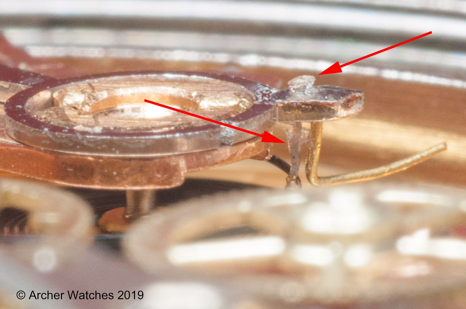

When the regulating pin on the Cal. 321 Speedmaster (sold by a well-known dealer) broke, the solution to repair it involved copious volumes of glue...

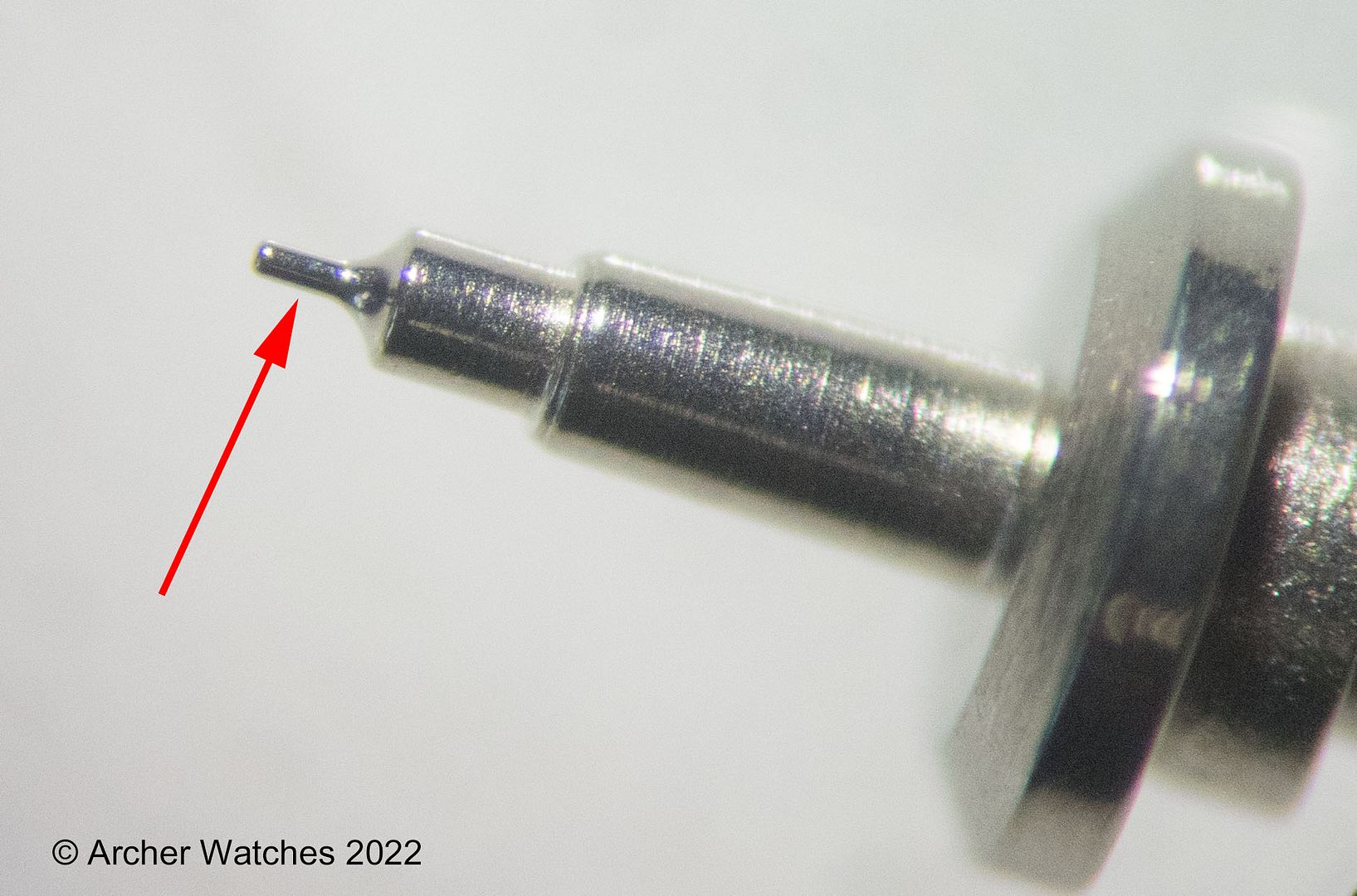

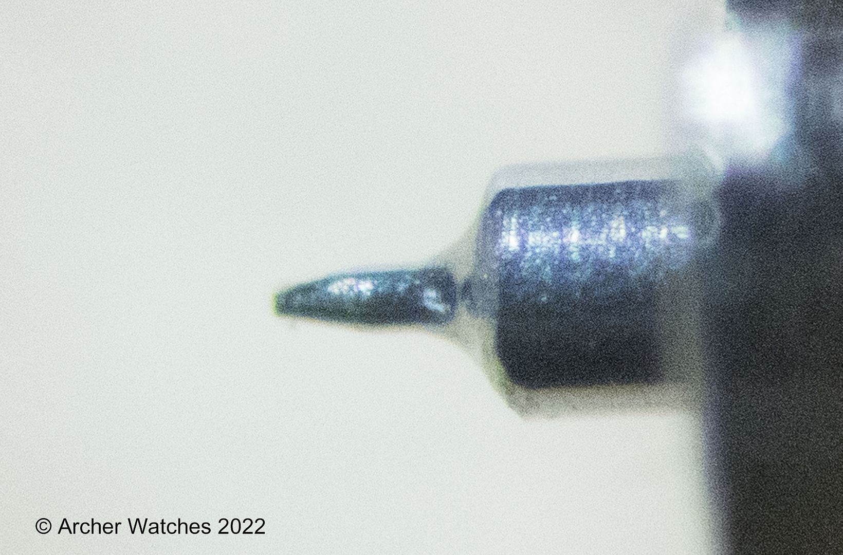

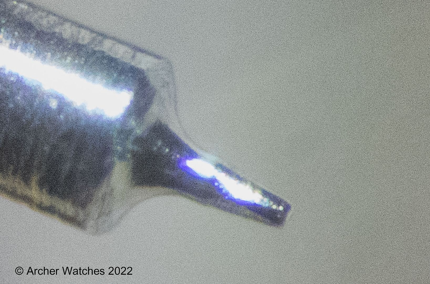

How about the Cal. 321 balance staff that someone decided to...for lack of a better word, sharpen?
Other end:
For reference, this is what the staff pivots should actually look like:
The balance amplitudes with this staff were excellent, but positional variation was crap - new staff required.

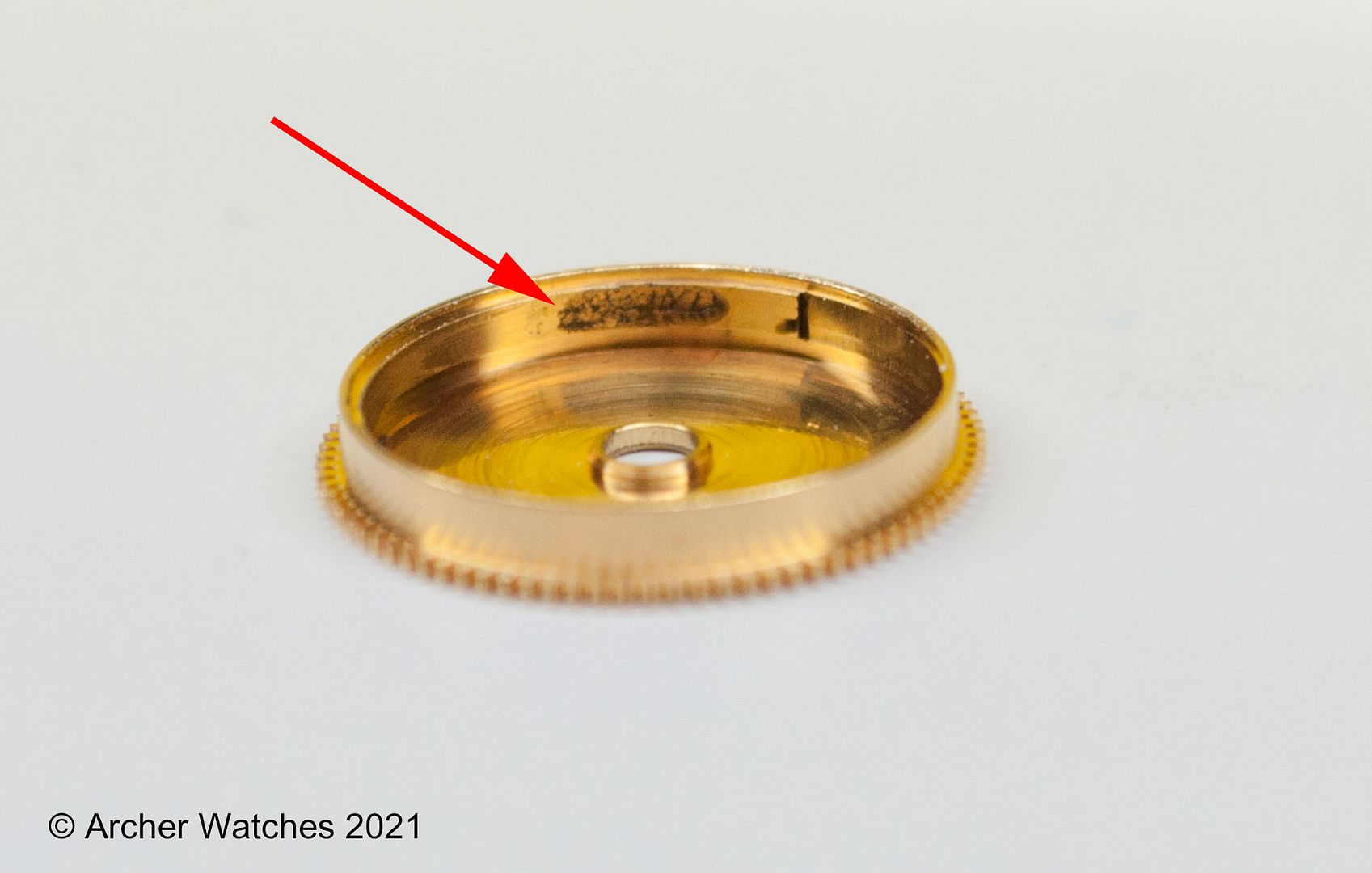

Braking grease inside the barrel...
Of a manual winding Speedmaster...
And this was after a factory service no less...🤦

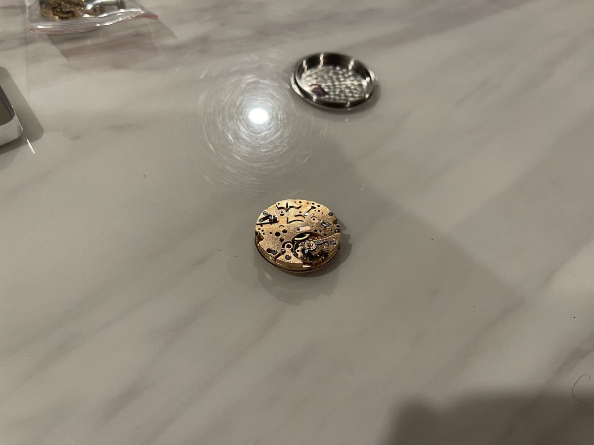

I bought a fairly trashed 321 Speedmaster that had been partially eaten / chewed on by an infant. I don’t know why anyone would give a 321 Speedmaster to a teething child but someone did that shit. So it was apparently still running and keeping time, which was a good sign. When I got it, I open it up and go… where’s my chronograph? All the time only pieces were there, so it actually ran very well as a 3 hand watch but all the chronograph components were removed. I have so many questions with this watch, thankfully its parted out and gone now.

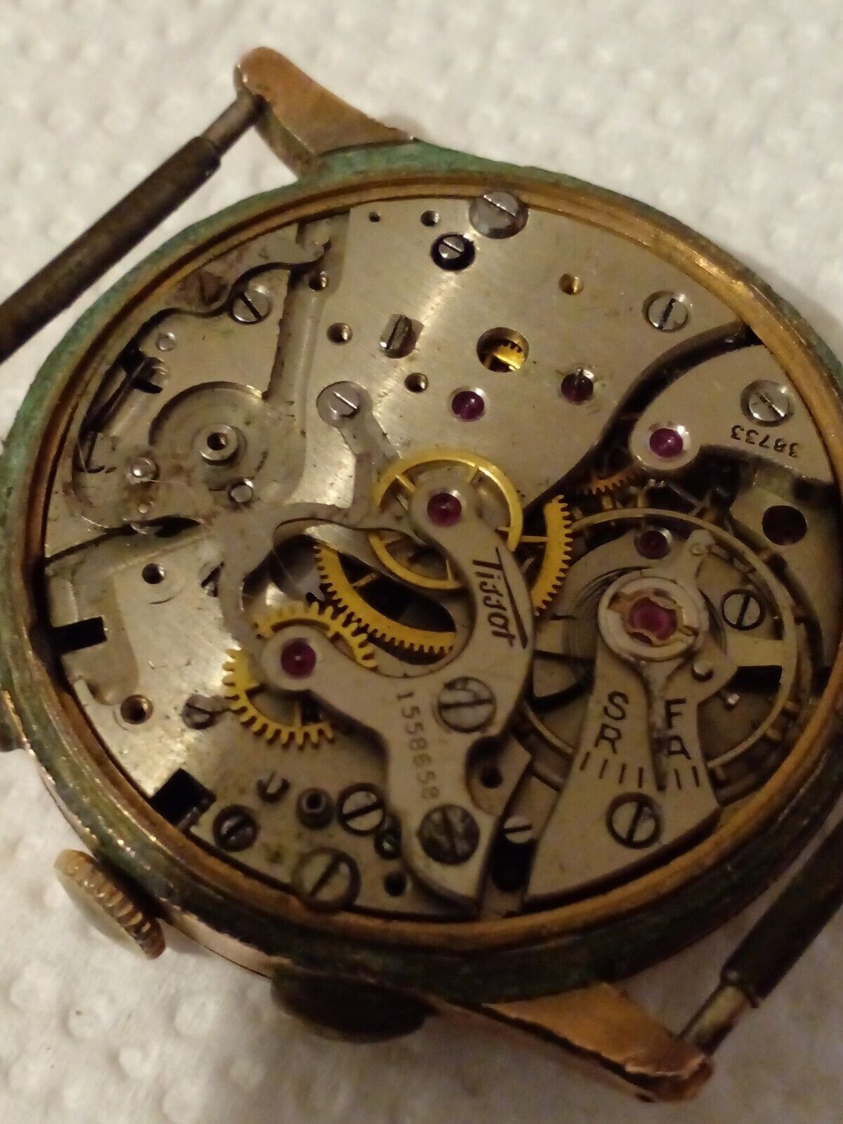

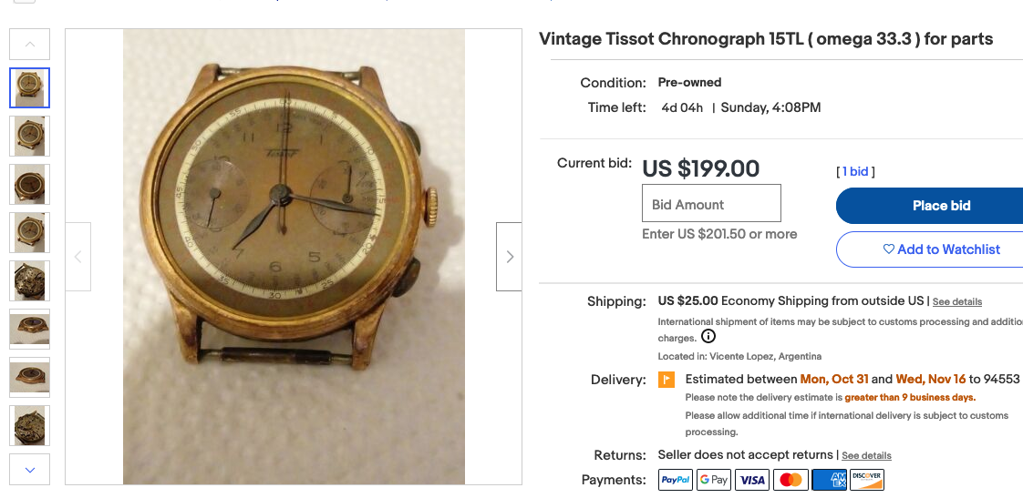

I thought I was asleep and dreaming of stripped nekkid chronographs, then remembered it was this listing.
Which shows this
With visions of chrono parts dancing in one's head.
Nice dial, though and I am sure someone will get it for that alone, outside my budget, although now have a micro grail wanting that Tissot logo on a dial. Must remember I already have 25 or more chronographs in various states of repair and I need tools like a broken screw extractor and a timegrapher ...
How in the world did it run at all? That's just bananas.
