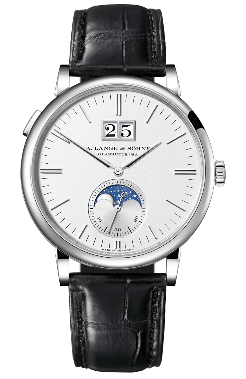

Sadly I’ve long since got rid of mine, which some day I will regret bitterly. But I struggled to read the date in that small register. That’s not the reason I got rid of it - the JLC MUT Moon I still have has the same issue!
one day the JLC will be upgraded to this and my eyesight will be spared.
