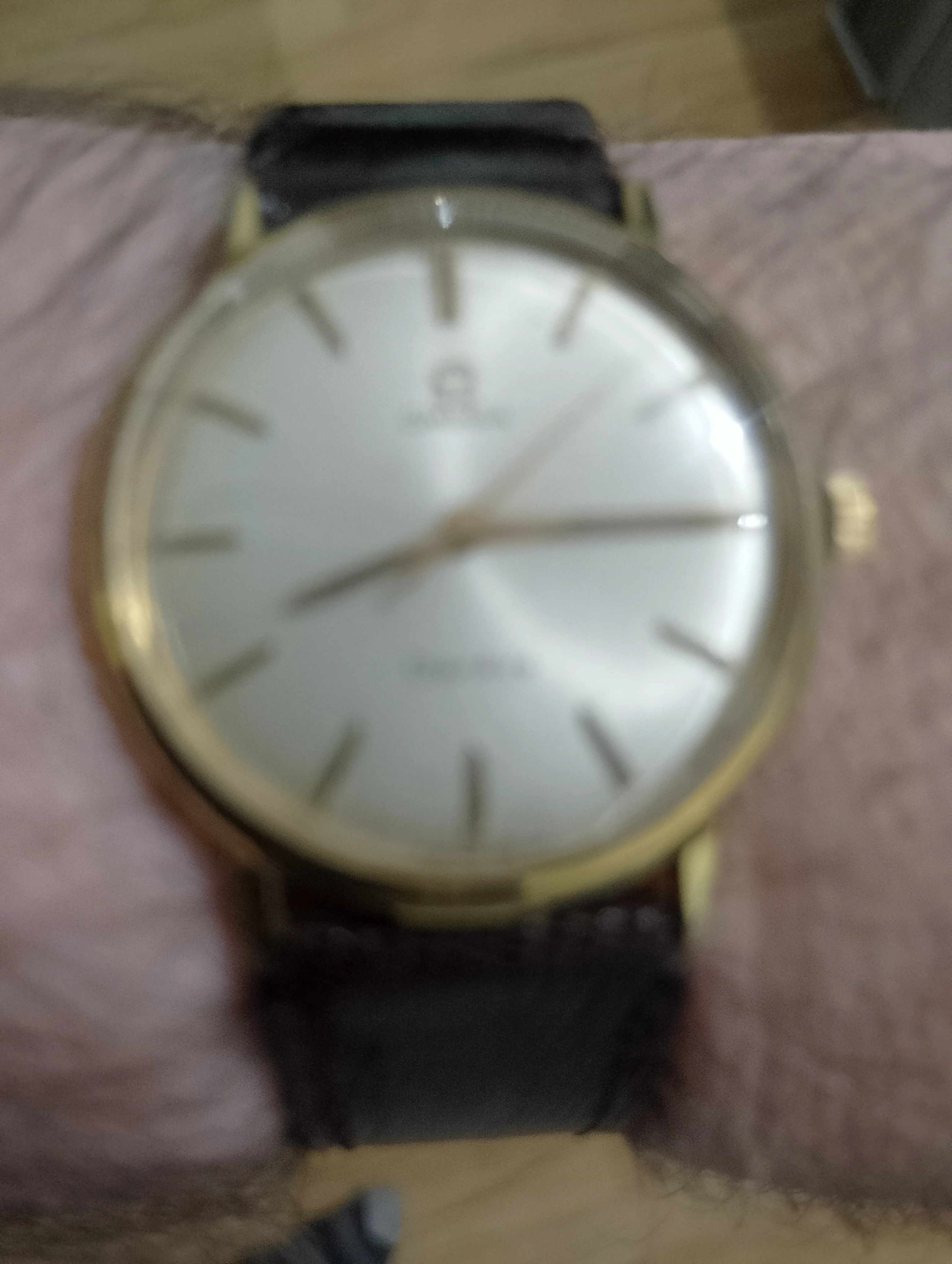

GAZAMUNDO - my timepiece is a 9 c t GOLD VINTAGE CALIBRE 601 OMEGA GENEVE and I love it because it makes me an OMEGA gentleman
And I am learning more about how to be a true gentleman 😀
It looks authentic with the champagne dial
