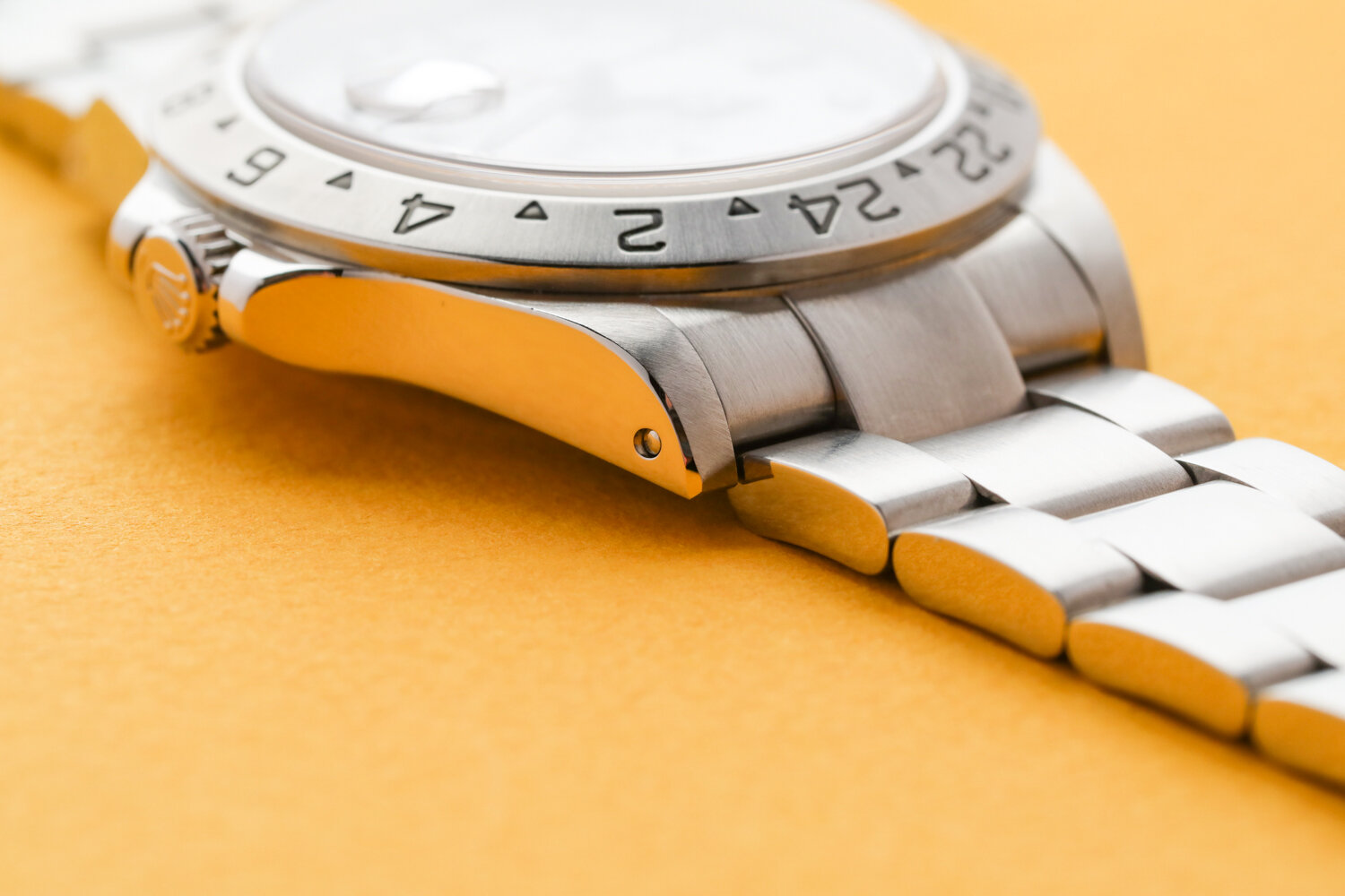

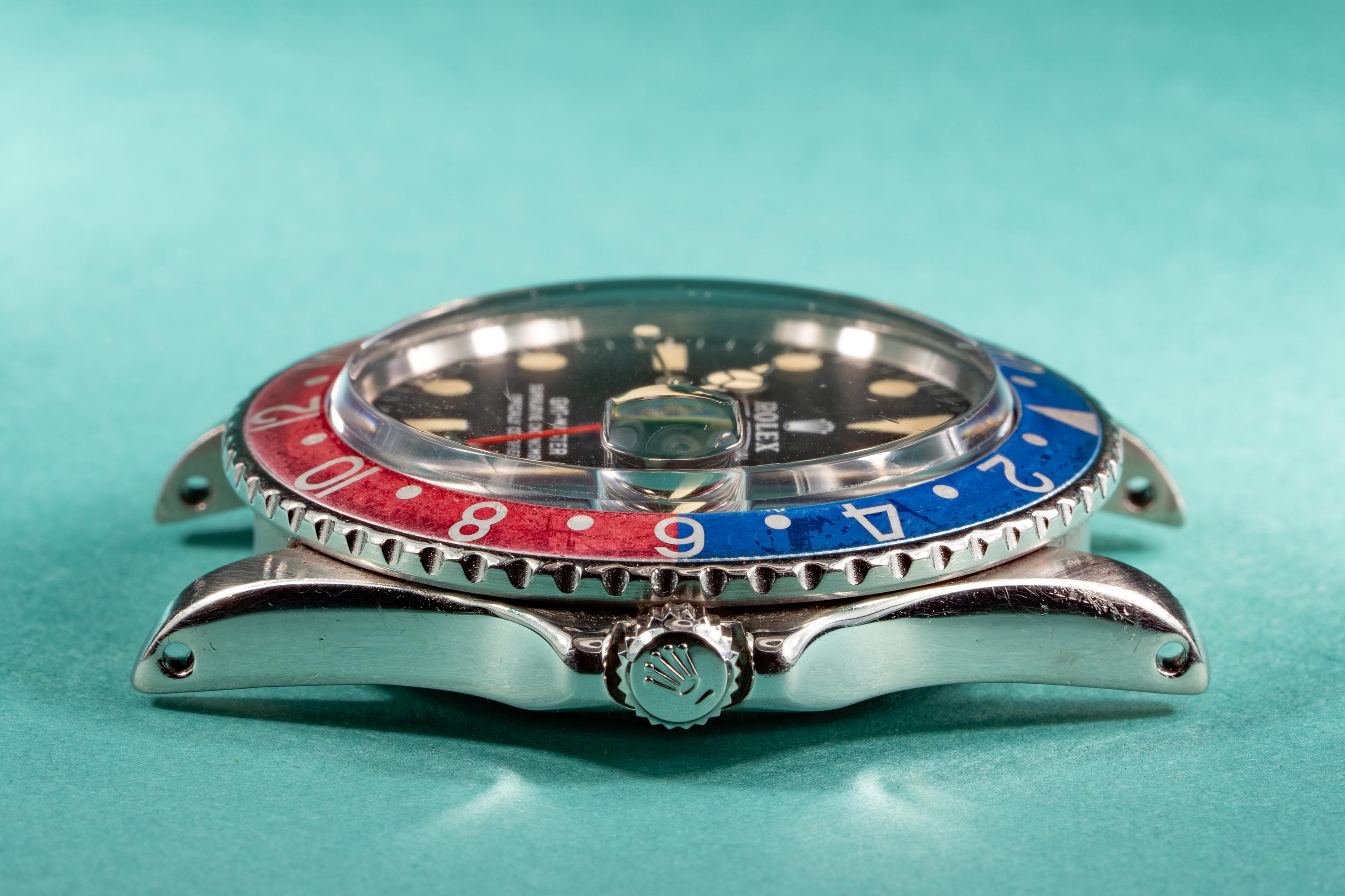

Here's another with lug holes dangerously close to the end of the lug...

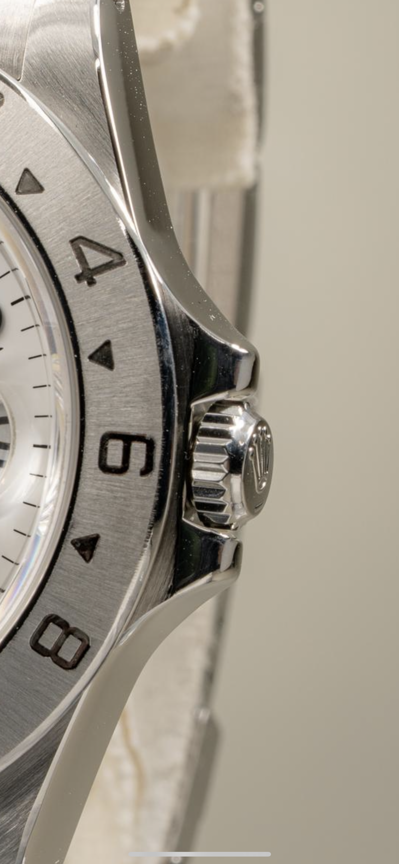

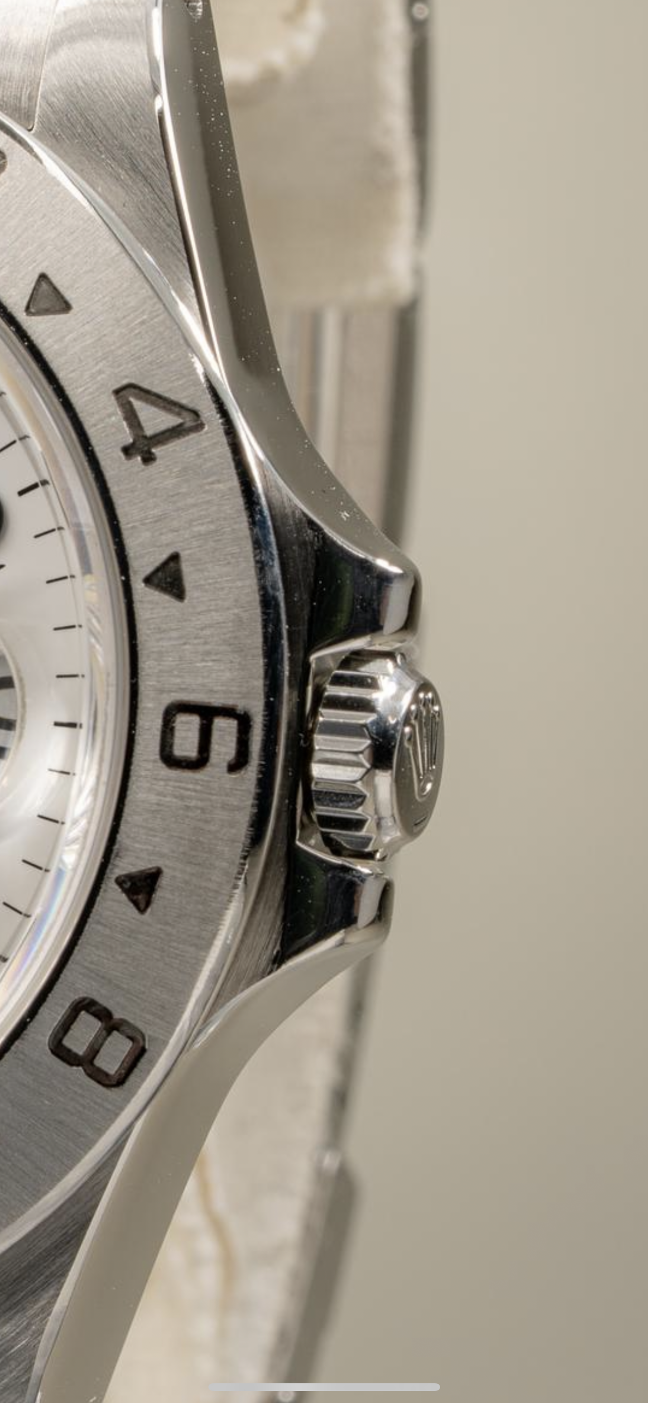

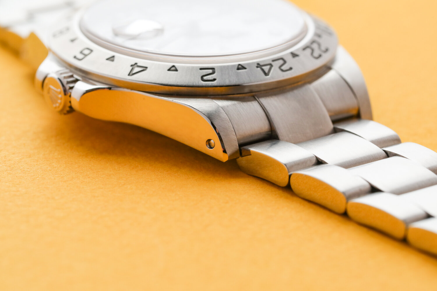

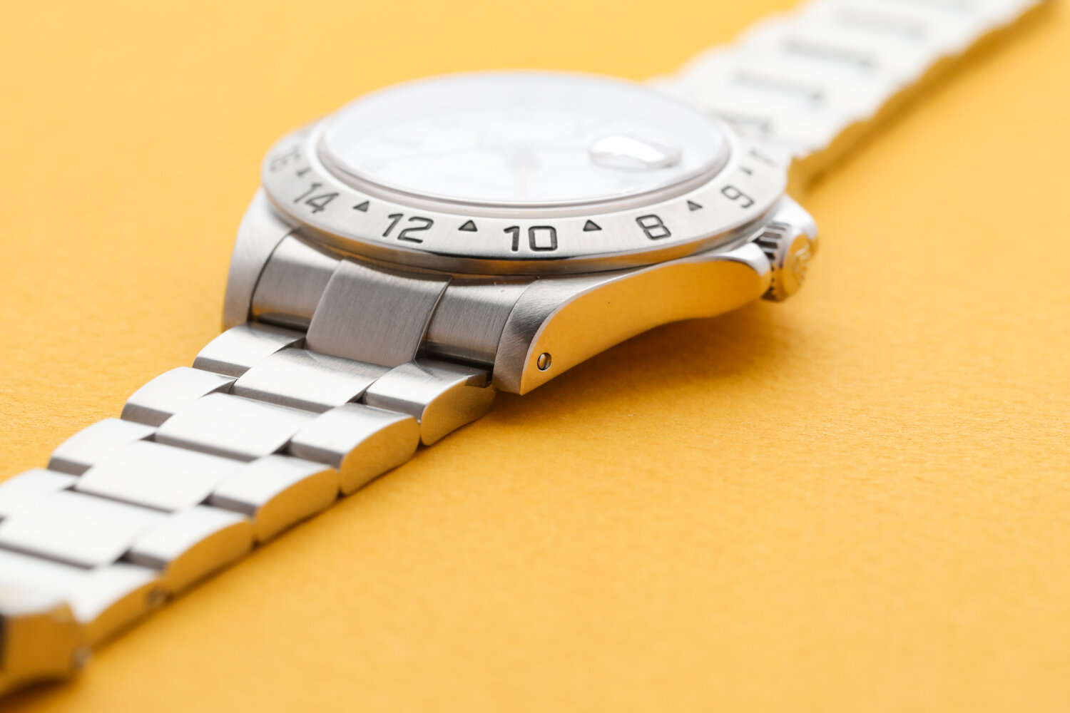

I’m no crown guard expert - are these on an Explorer II a bit worn down?
2,442
4,232

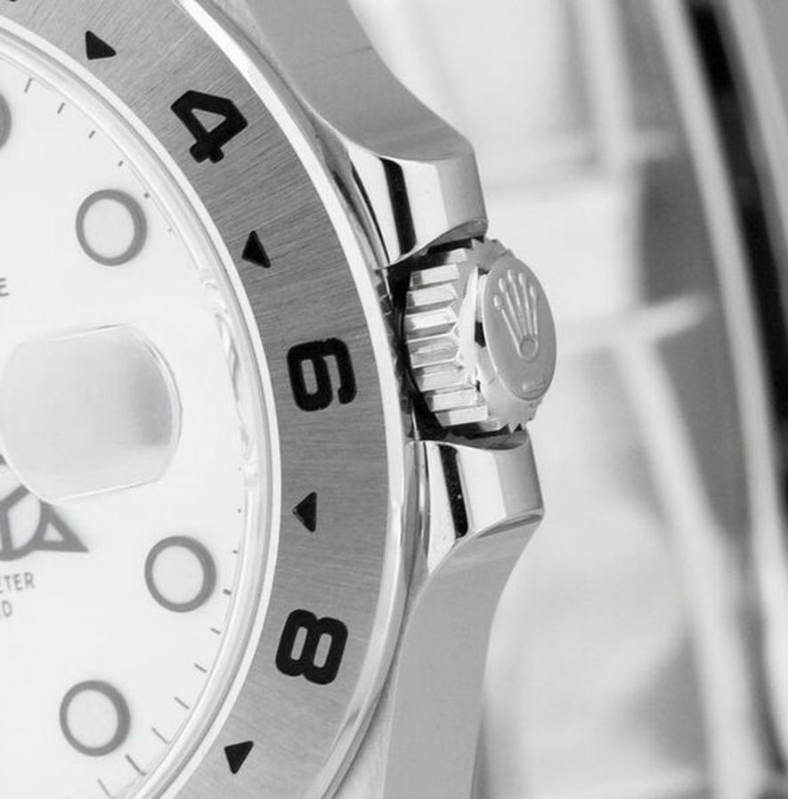

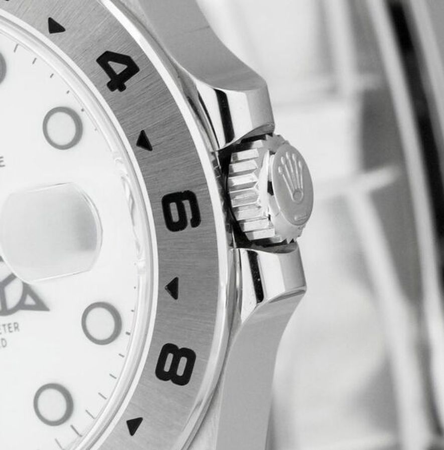

Those are not horribly worn down, but they've certainly been polished and might be called "soft." Here's an unpolished Explorer II for comparison:

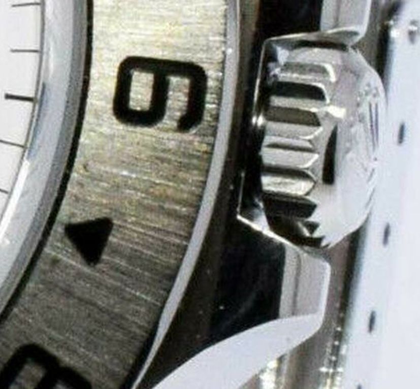

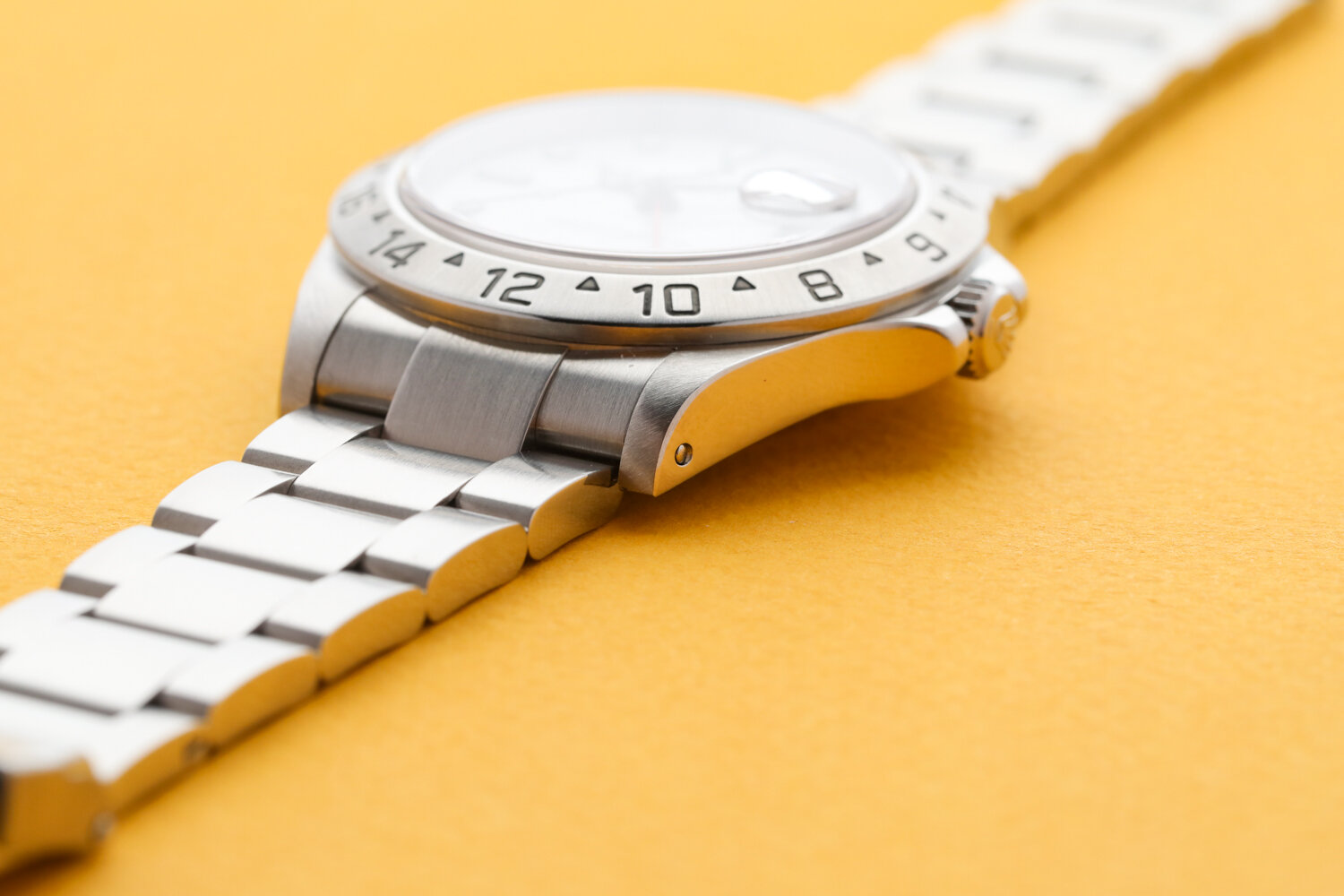

You've got me on the lookout for these now. The case condition on the below is described as "outstanding". Could be the angle a bit, but...
2,442
4,232
Somebody spent a few minutes outstanding in front of a buffing wheel on that one.

The Explorer II’s mentioned above are different serials. You cannot compare the crown guards between those two.
On the 16570 they look okay. I’d like to see a different angle, though - as I can’t see the curved line on the crown guard, with it being in the shade.
532
2,317
This is true - there are wild variations on the ExpII crowns and there is not enough info here for a proper comparison.

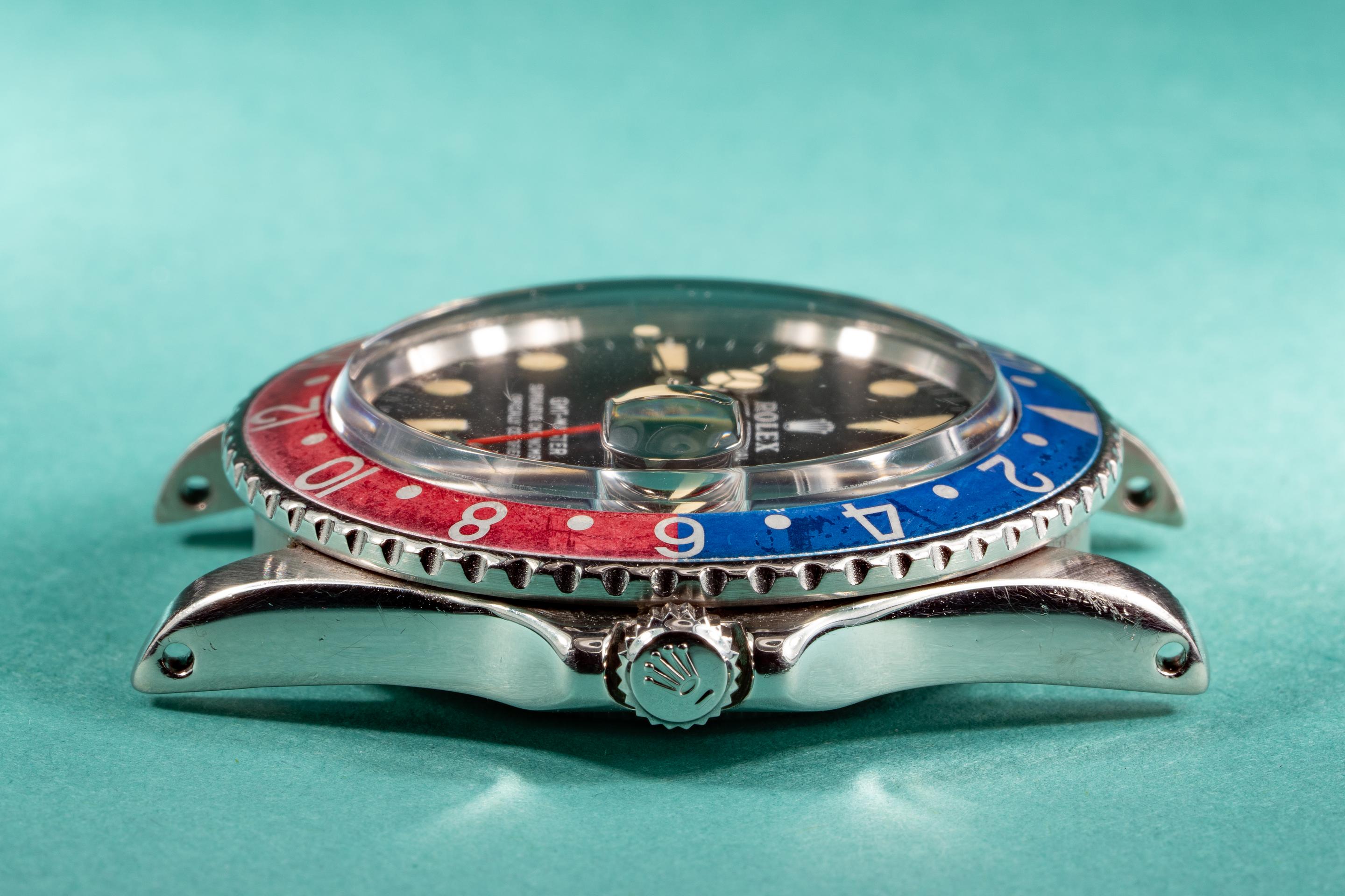

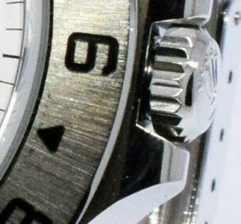

Here's an unpolished crown guard on a used 16750, same model as the OP photo above (I believe). I think it's easy to see the difference between these. Rolex Daytonas come from the factory with slightly soft crown guards. Subs, GMTs and Explorers have always had crown guards with crisply defined edges.

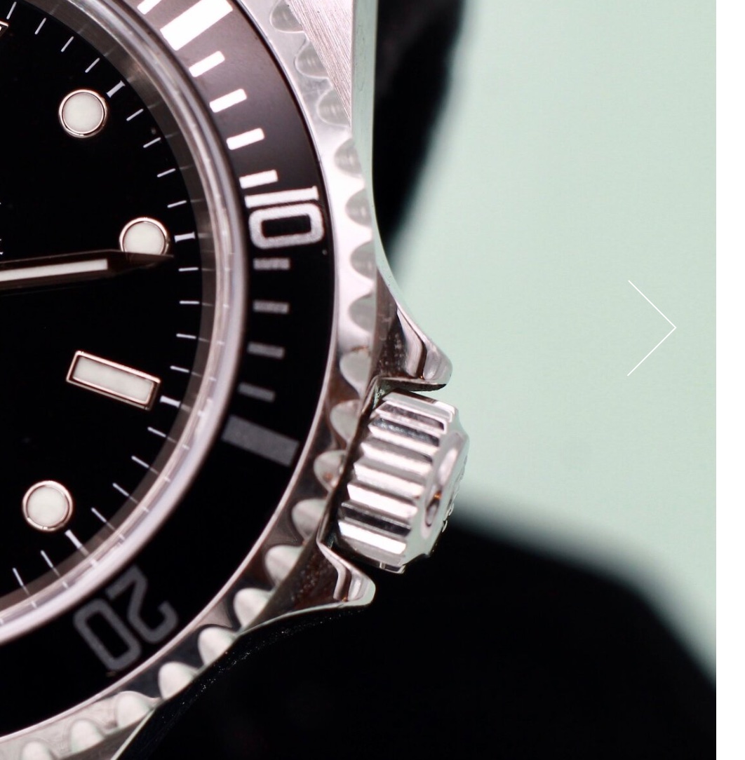

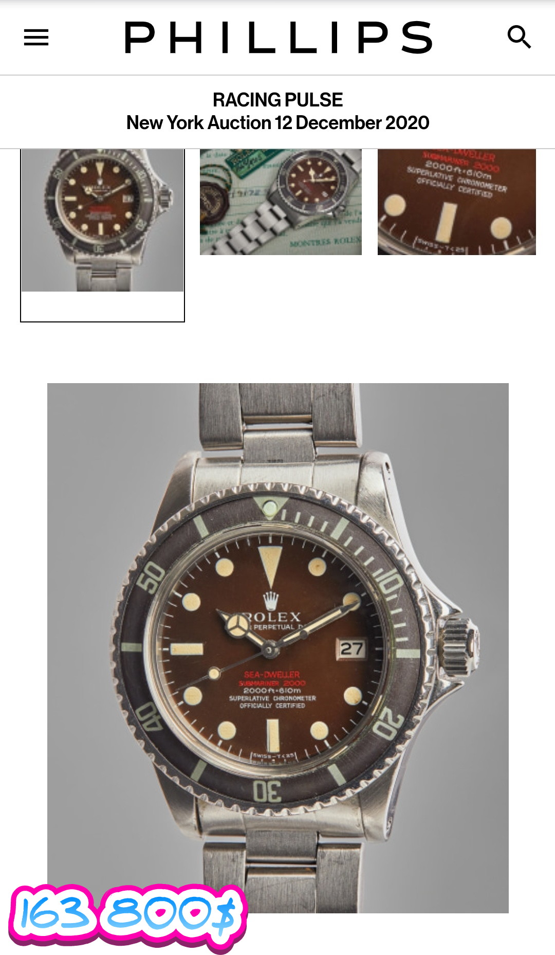

Did the DRSD's have thinner and pointier crown guards or are these just worn down? To my untrained eye they look very soft and unattractive.
Price to me seems astronomical but to the winner this was probably just another swipe of a black/centurion Amex.
That case is tragic; those are the most over-polished crown guards I've ever seen. And the price is absurd. Perhaps Jeff Bezos has started collecting Rolexes.

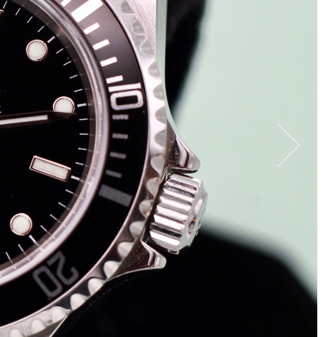

Is this for real? It looks like the lug holes have been drilled larger.

Tricky at those angles. I'd say polished but not horribly.
