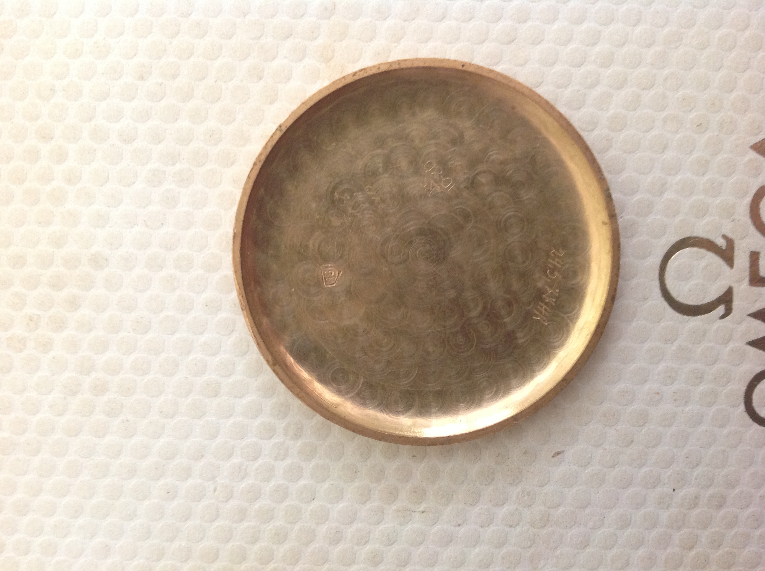

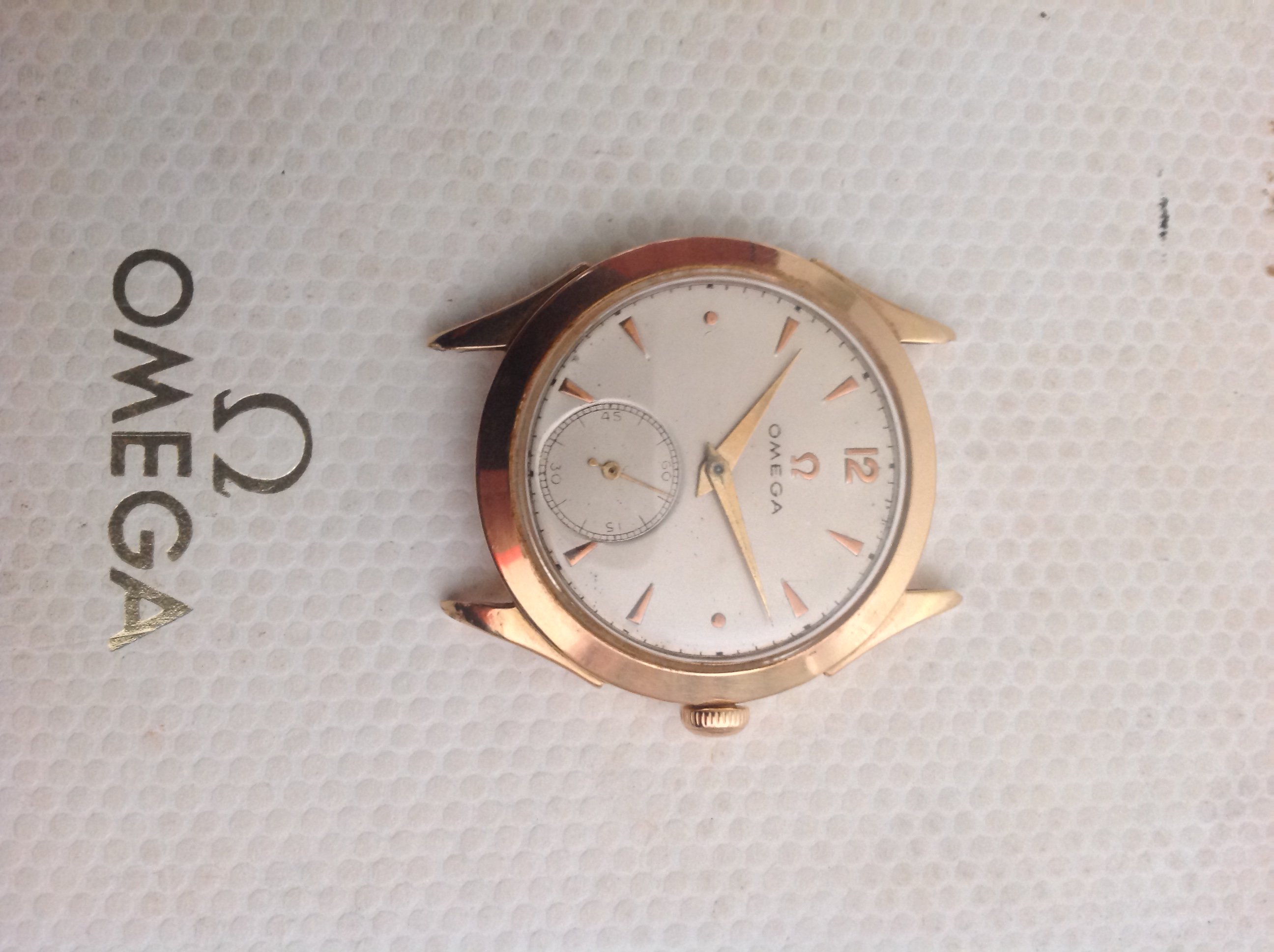

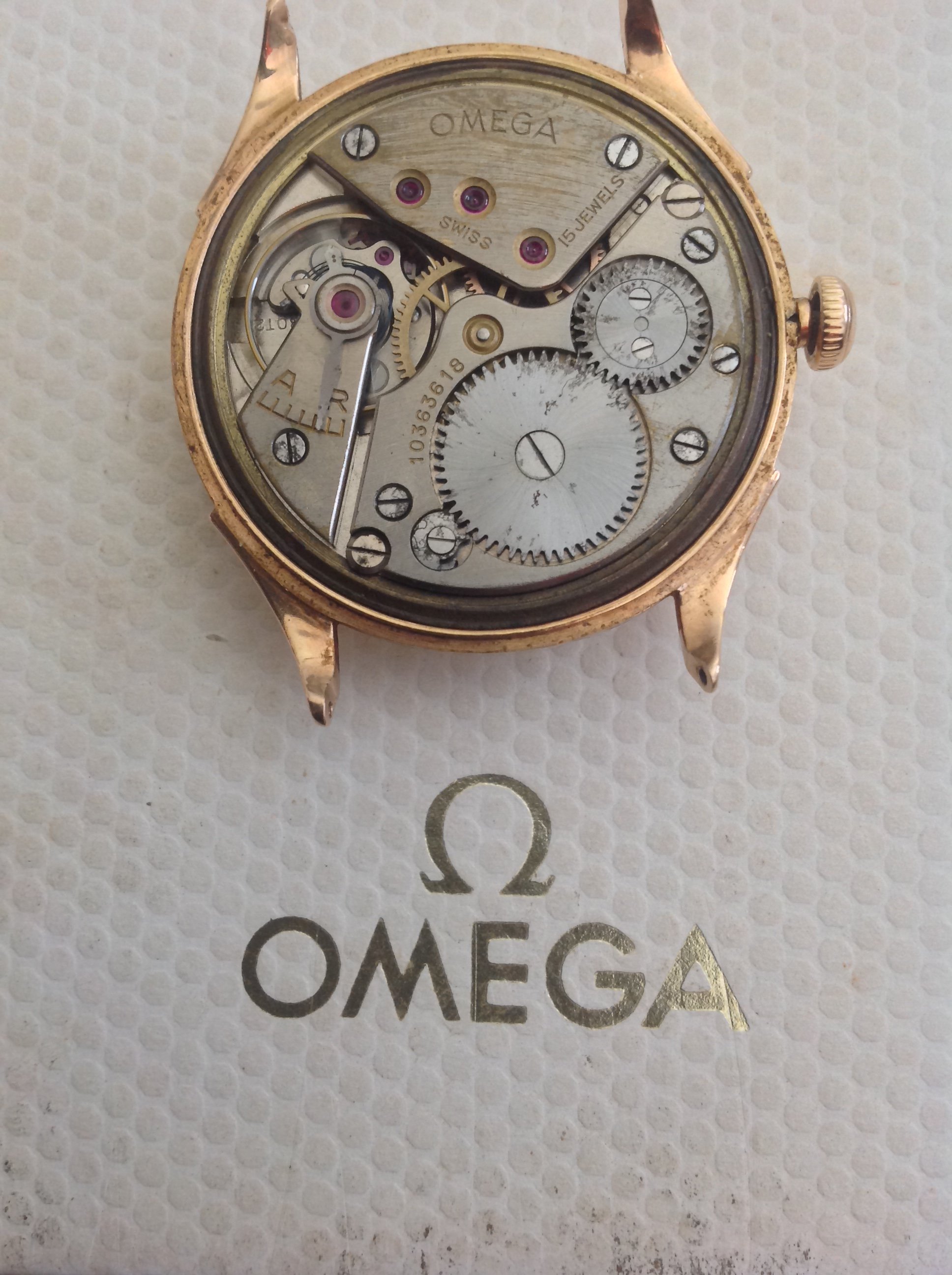

Help to ID this 30T2. Please pay attention to gold case and unusual lugs. Tks in advance
  1. Sbrotherhood Nov 16, 2016
    6
    Help to ID this 30T2. Please pay attention to gold case and unusual lugs. Tks in advance.
  2. MSNWatch Vintage Omega Aficionado Staff Member Nov 16, 2016
    6,533
    10,832
    Dial is refinished.
    Case is likely a south american production - not a swiss omega case. And many times these are not solid gold no matter what markings are placed on the case.
    Sbrotherhood likes this.
  3. Sbrotherhood Nov 16, 2016
    6
    About the hands, any thoughts?
  4. Syrte MWR Tech Support Dept Nov 16, 2016
    7,422
    20,891
    I'd also wonder if the movement and dial / case are from the same period.
    I seem to recall the steel colored finish on the 30T2 was only in use for part of the 1940s, and that Omega switched to the copper-tone finish during that decade. Since the dial, case and handset are clearly late 40s or early 50s in style, it might mean that the movement did not initially belong with that dial /case and handset. (the hands and dial are actually early 50s, the case looks either late 40s or early 50s).
  5. MSNWatch Vintage Omega Aficionado Staff Member Nov 16, 2016
    6,533
    10,832
    I have doubts the hands are even original omega hands.
  6. Sbrotherhood Nov 16, 2016
    6
    The watch is in Brazil. It explains the unusual case shape. About hands I agree. Problably not original. But the dial, for me it was not refinish. May be serviced, but not redial.
  7. BlackTalon This Space for Rent Nov 16, 2016
    5,181
    8,388
    Did you look closely at the seconds track on the subdial? The lines are all over the place.
  8. Sbrotherhood Nov 16, 2016
    6
    Over!? Could You explain, please?
  9. Syrte MWR Tech Support Dept Nov 16, 2016
    7,422
    20,891
    Most definitely a redial. The blunt edges of the subdial, and the bad quality of Omega logo and subdial print are all indicators.
  10. BlackTalon This Space for Rent Nov 16, 2016
    5,181
    8,388
    The 'tick' lines do not appear to be very straight. Makes me wonder if they were redrawn, or if they got smeared a bit by a bad dial cleaning attempt.
  11. Sbrotherhood Nov 16, 2016
    6
    Thank You all guys!
