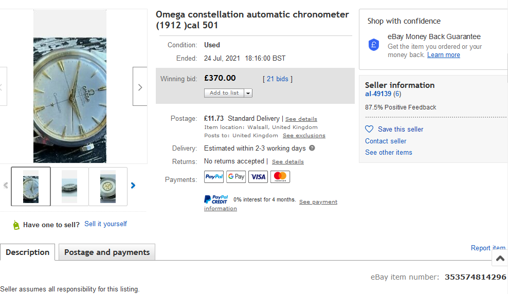

Why did this 2846 Constellation end so low?
3,133
5,569
Here's the link. Did I miss something? I can't see anything wrong with the dial or anything else but the final price was absurdly low. The seller's mistake about the date shouldn't have made any difference.
https://www.ebay.co.uk/itm/Omega-co...=true&nordt=true&rt=nc&_trksid=p2047675.l2557
3,133
5,569
Hmmm....something weird is definitely going on as this is the second time he's sold it, and now he's listed it again.

I鈥檝e tended to stay away when photos are cropped like that and the seller doesn鈥檛 seem well established.

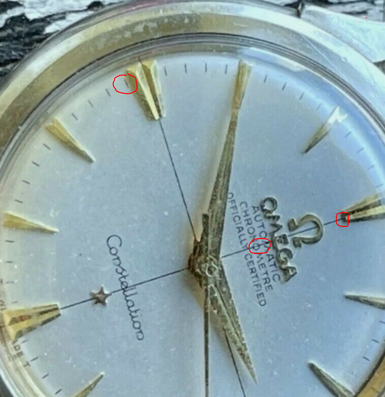

That's a redial. Biggest tell is the 'T' on what is a 14 million watch. Probably actually a 2852. The seller also states that it is a 2846 which is a Seamaster ref. Plus UK only auction and a vague receipt for what work exactly?
All in all a bit of a messy listing for a redialed mislabeled Constellation won't add up to a top price
96
117
The funny thing is that the seller appeared to pay 拢35 for a valuation that dated the watch as 1912! People sometimes complain here when they get slightly impatient answers to their questions, but the advice here is (a) free and (b) expert.
