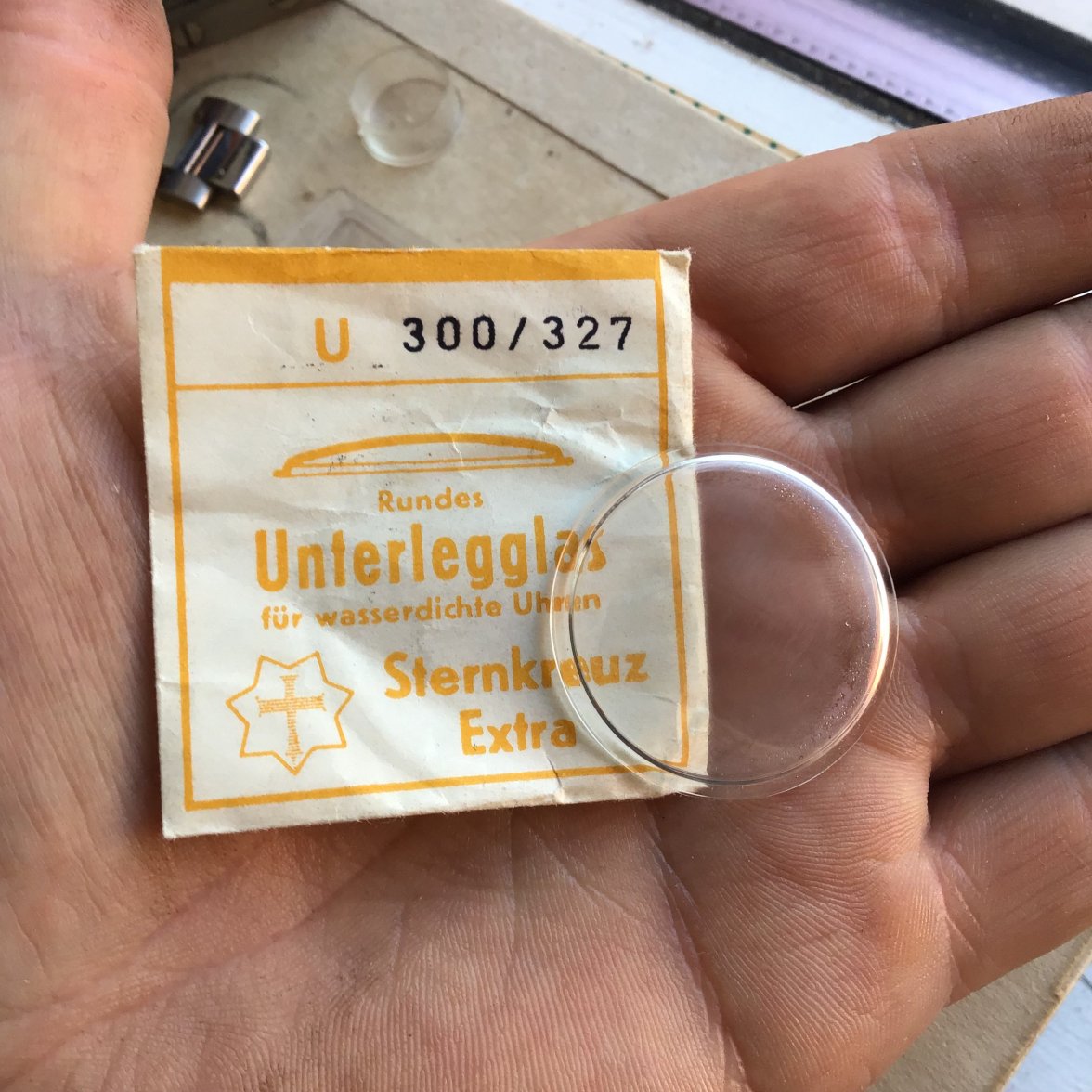

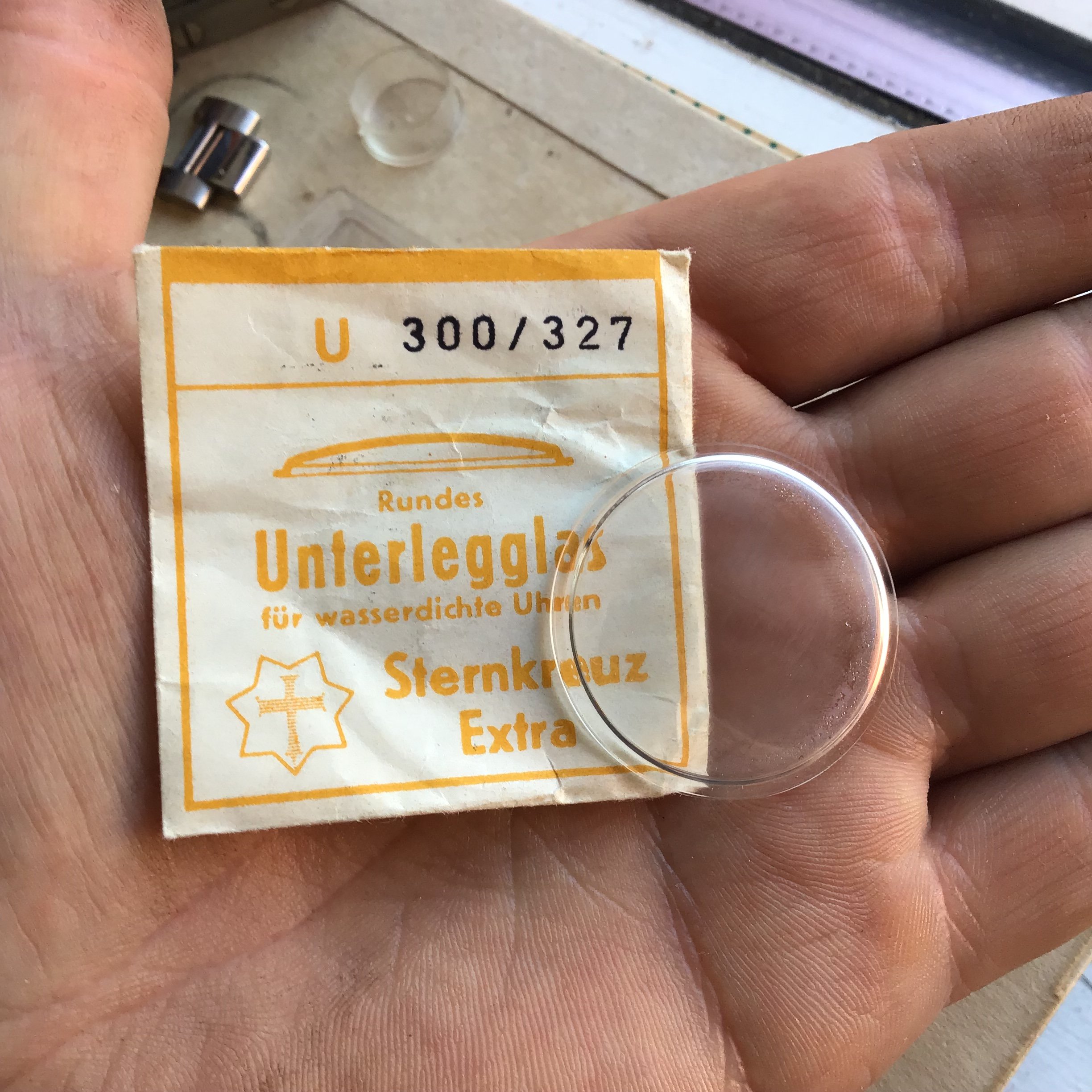

Cool, what`s the difference between this and a ordinary underlayed plexiglass?
Uncommon size maybe.....
422
884
Yes, just the size.
