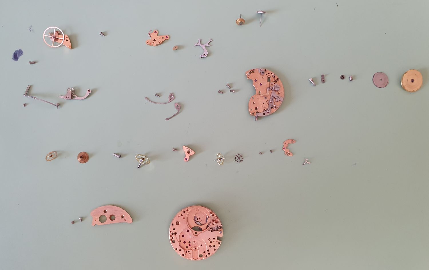

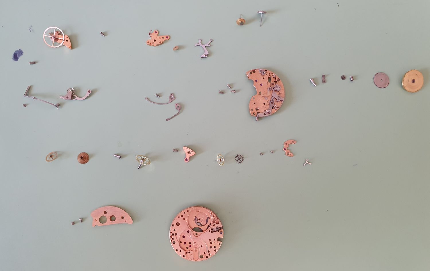

Todays project, spare 861 馃榿
This morning....

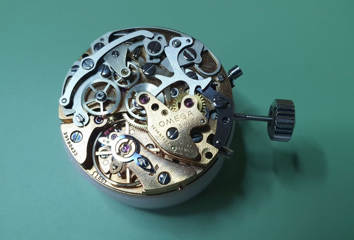

After cleaning, oiling, fitting new main spring and replacing a bent 4th wheel, its back together.

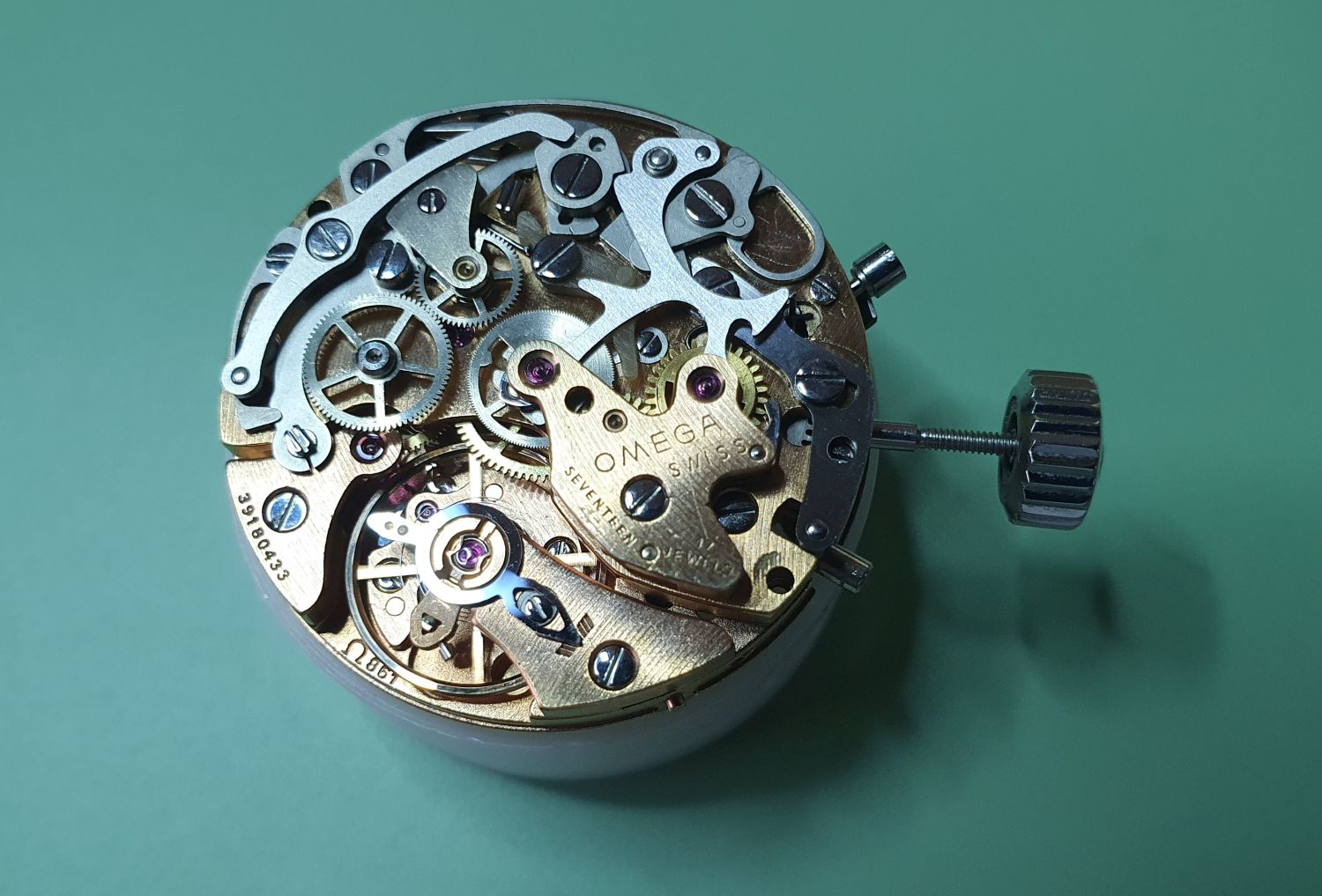

Did you fully disassemble it before cleaning? If not, the is certainly recommended.
Cheers, Al
Cheers, Al
Disassembled a fair bit more than in the photo but I'm always nervous to work on a movement like the 861, so I try to work on a section at a time so I dont get lost, my skills are not that great 馃榿 .The coupling yoke and chronograph parts also removed and cleaned.
Found that the chronograph runner has some minor damage as does the hammer so they will need to be replaced at some point, and the pusher stem seems to be sticking when resetting the chronograph, the pusher stem in the final photo is a from a 321 I think which works ok, so I'll need to see whats going on there.
Anyway a bit of fun more than anything but it will be for a project Speedmaster at some point
You are far more daring than I would ever be with a watch like that. Perhaps I should start with something like this

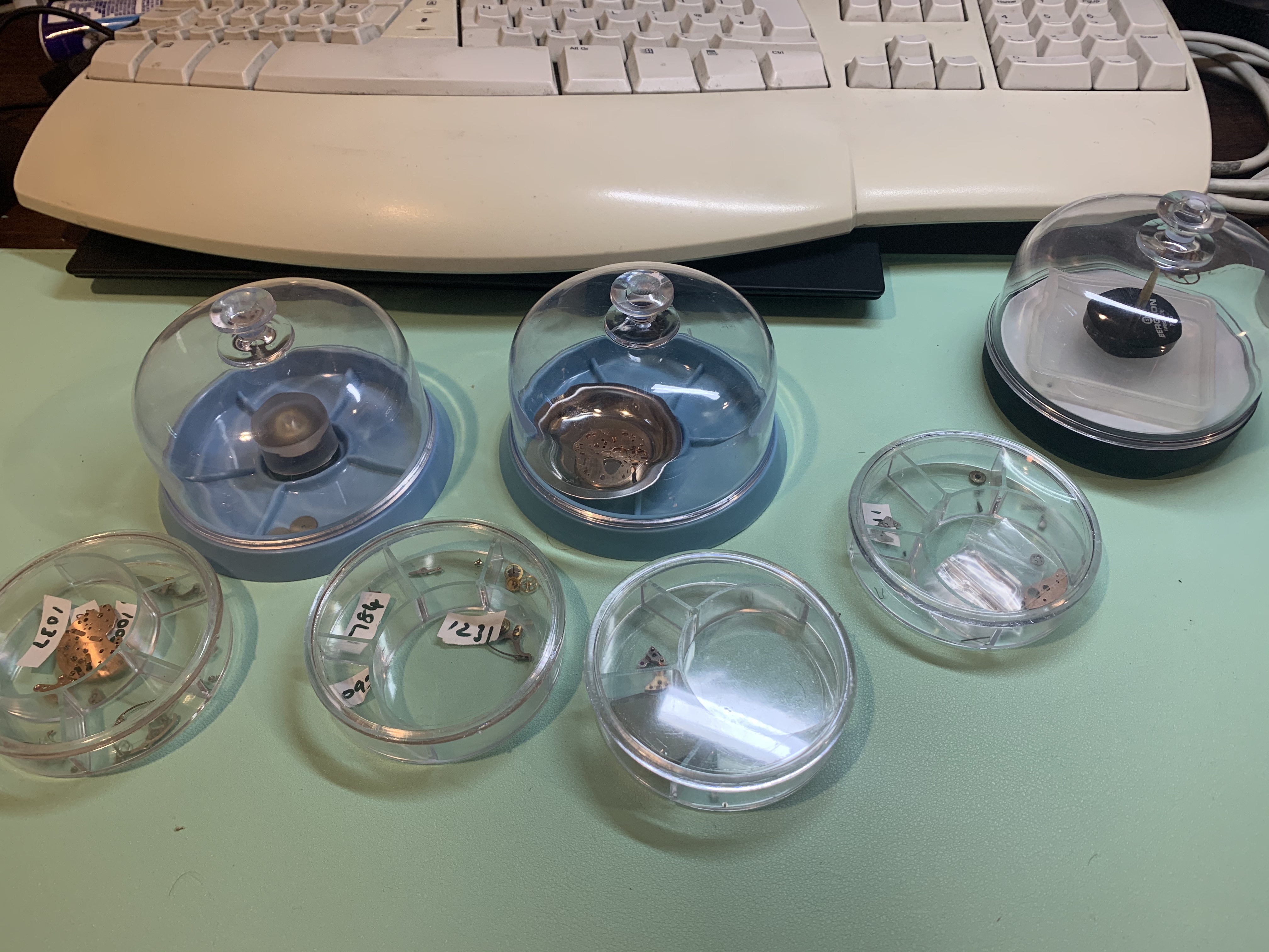

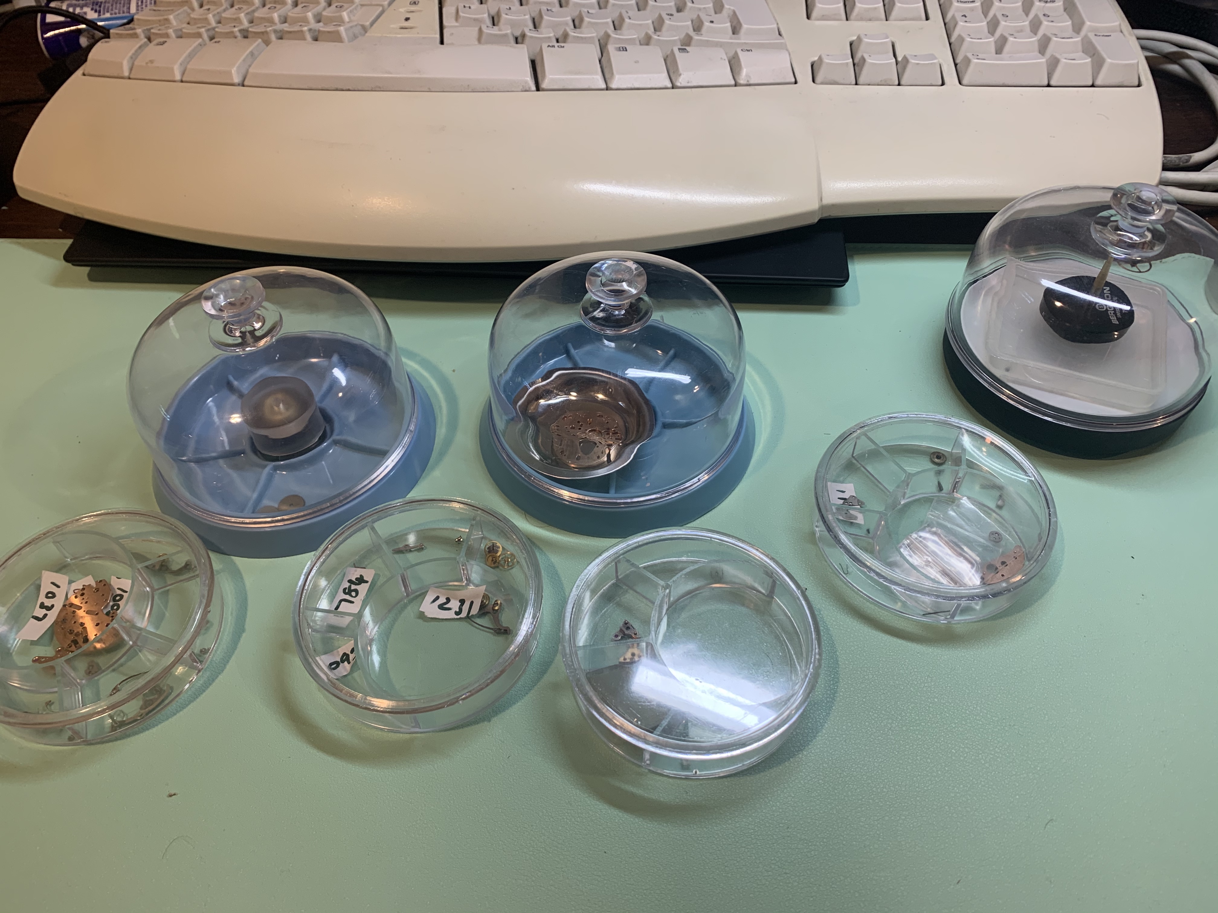

Im hoping to do the exact same. Parts separated by order of installation from what I can figure out from the service manual. Mainspring replaced and installed - need to oil the arbor and the new friction spring when it arrives. Slow going - but a lot of fun.
