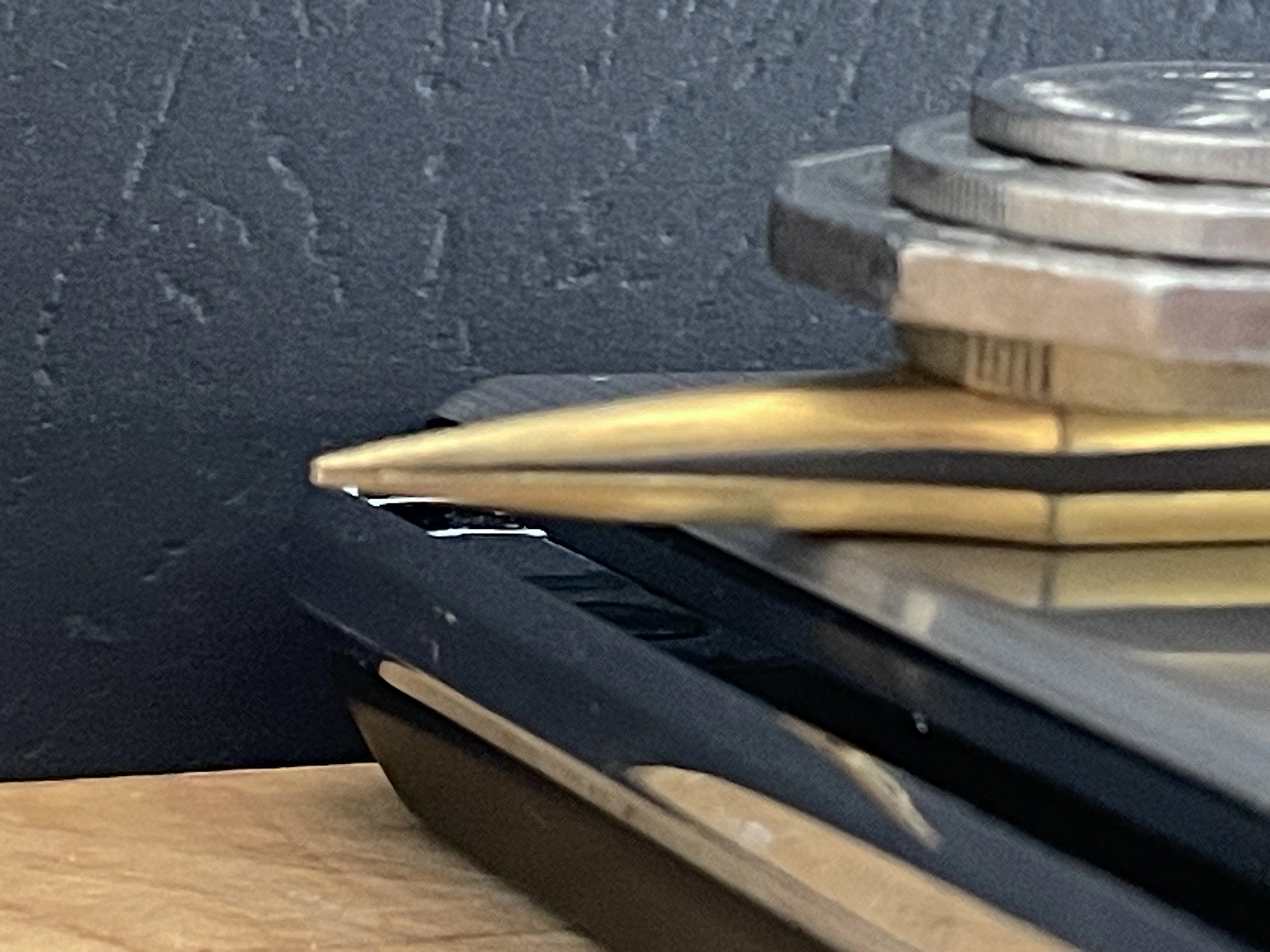

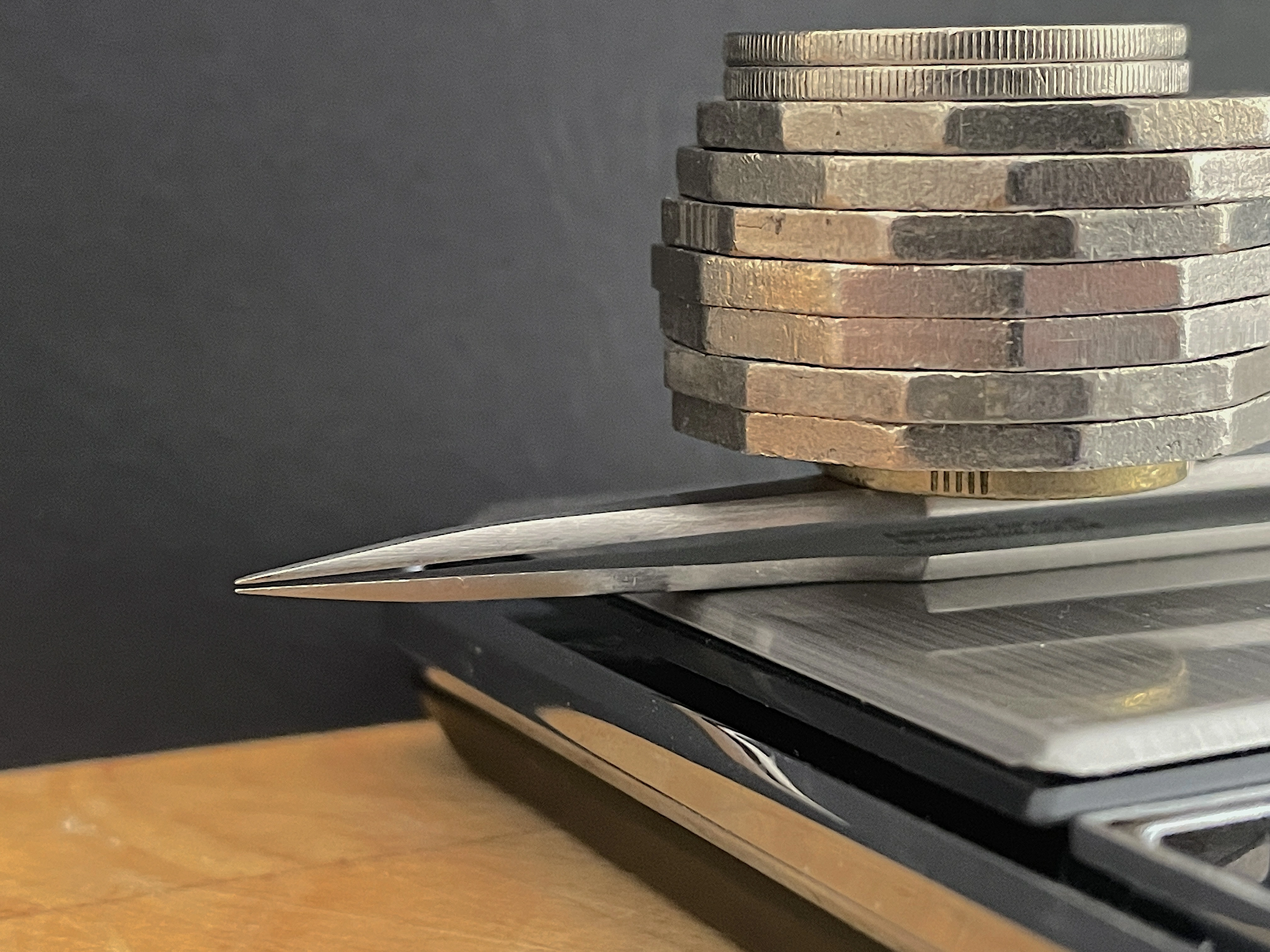

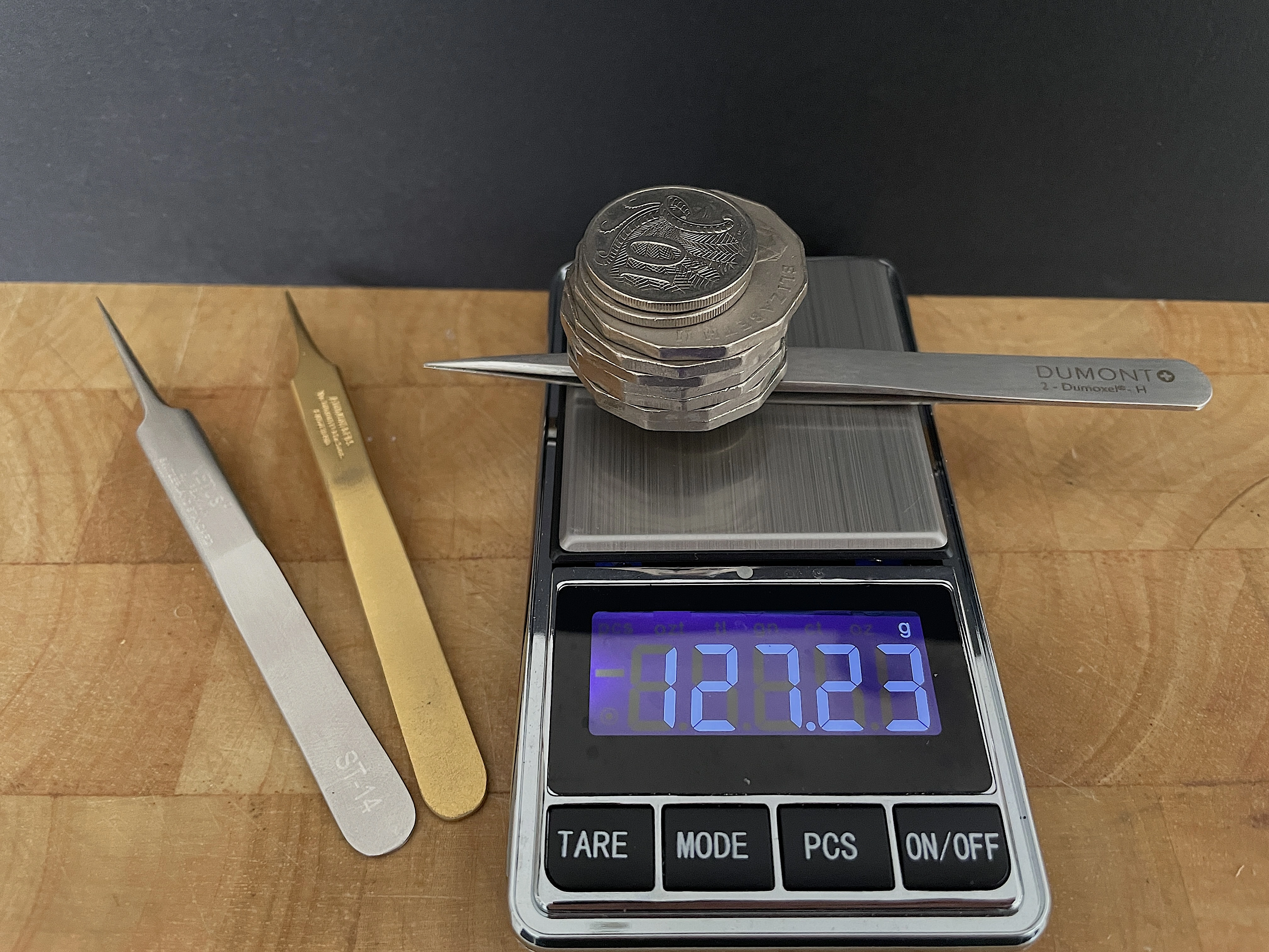

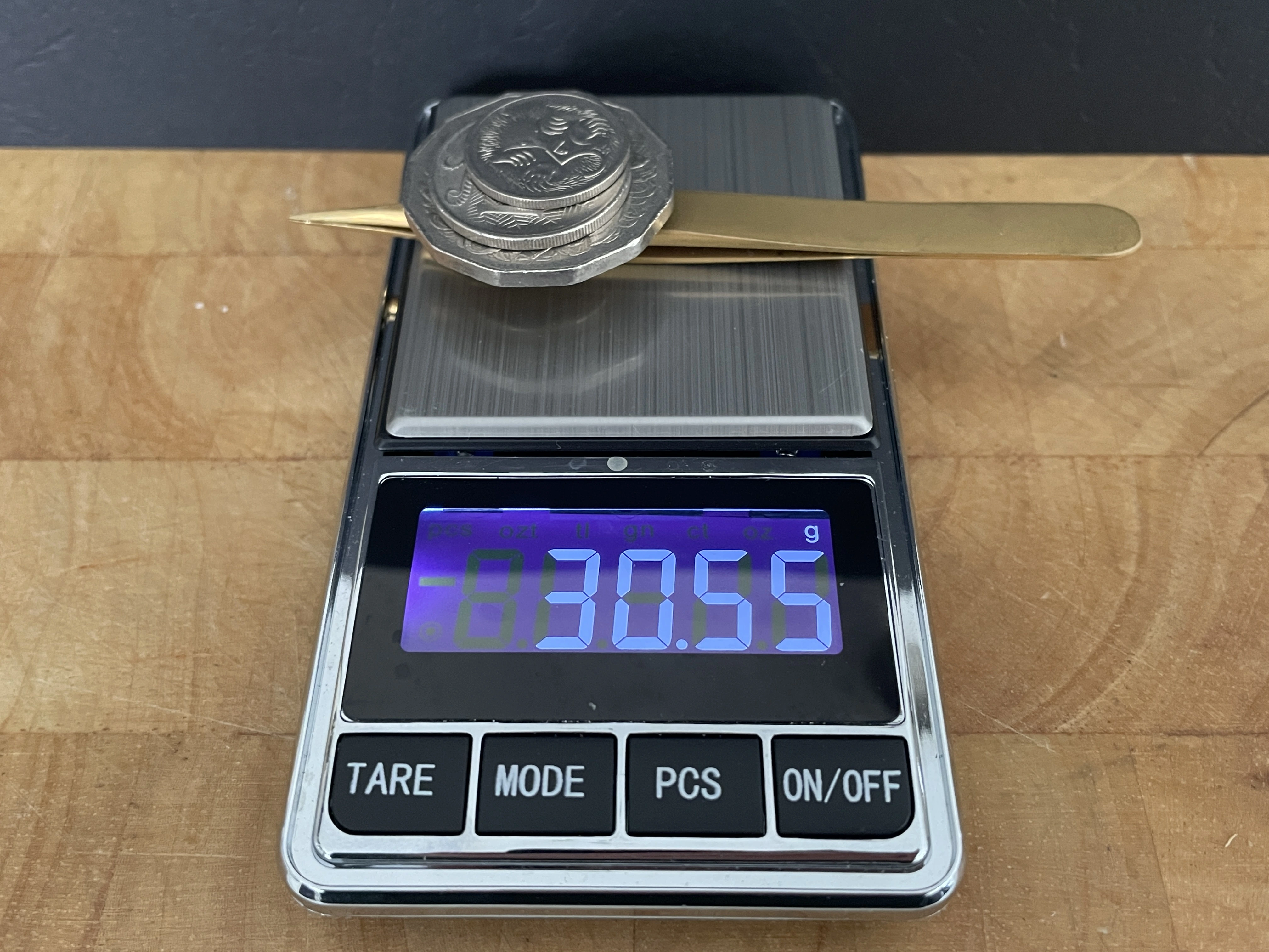

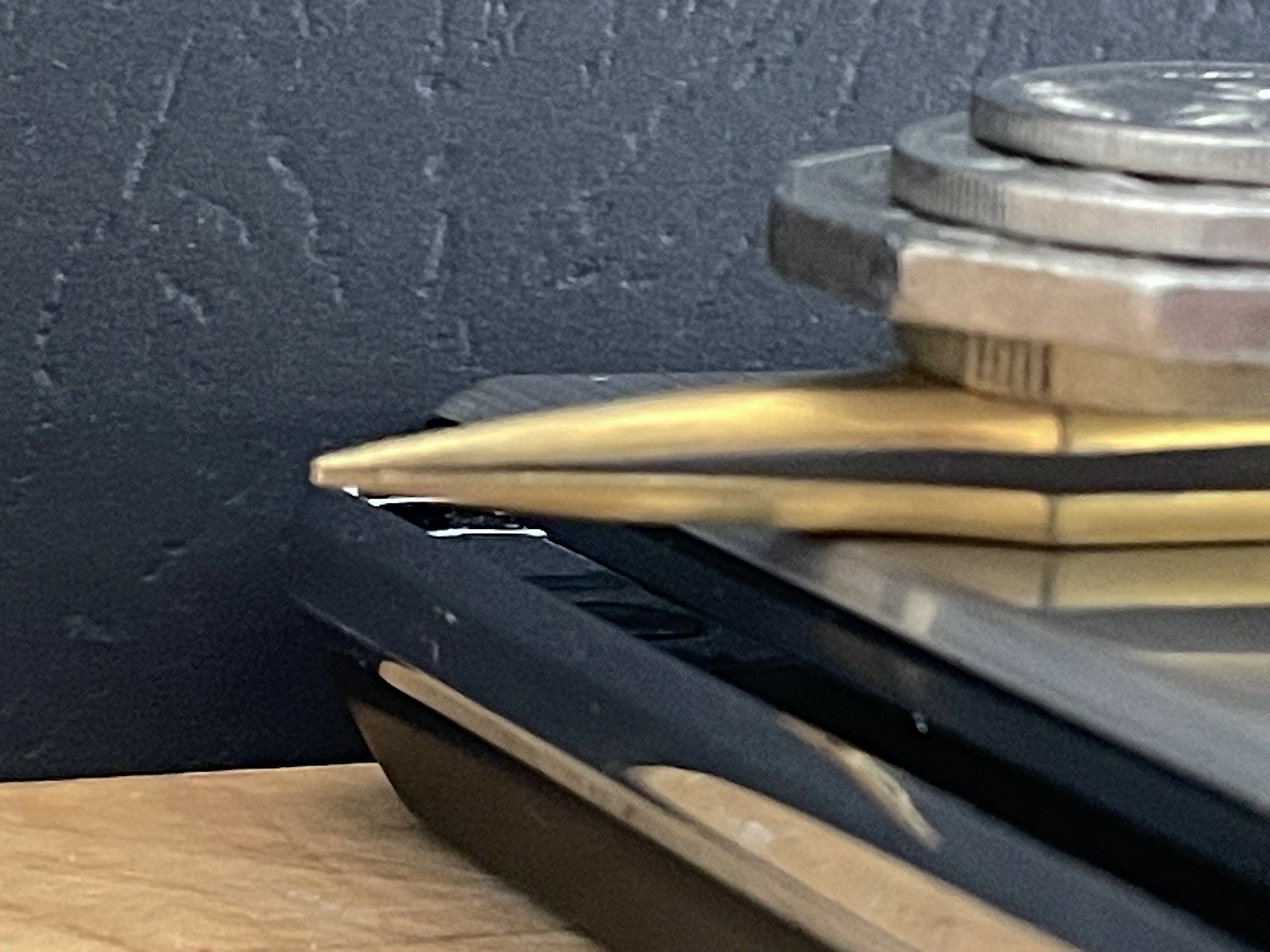

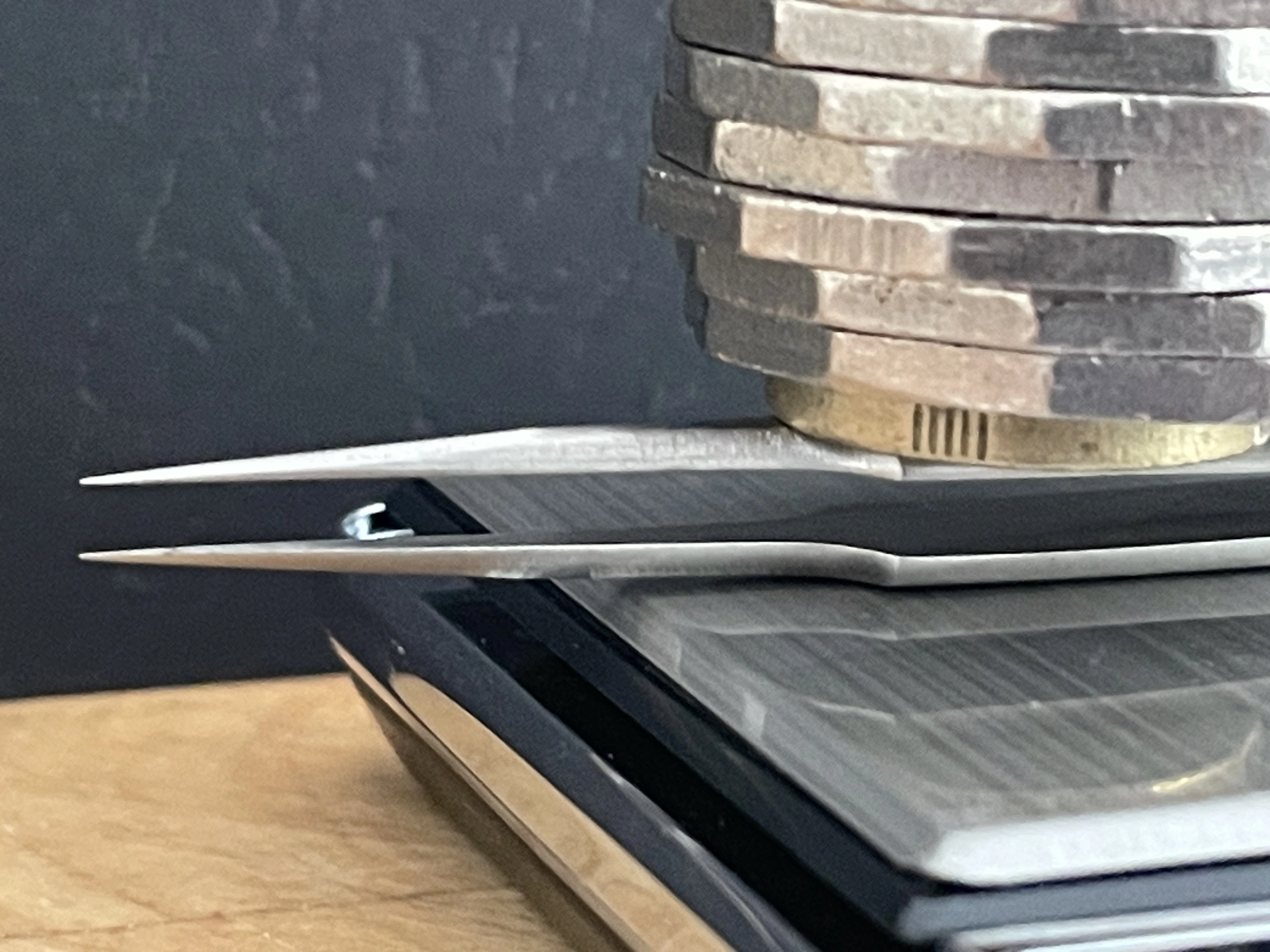

To give you an idea of the force required to used them. I selected my standard Dumont No4 Bronze, a set of Dumont Dumoxel No2 and a set of Vetus ST-14 Stainless tweezers to compare.
Not having a scientific force gauge, I used my jewelers scales and Australian coins to provide weight. The first coin was a $2 placed at the point where your fingers would normally press, the remainder of the coins were then stacked until the tips were just closed.
First test with my favourites.
Just closed.
and only 30.55 grammes required.

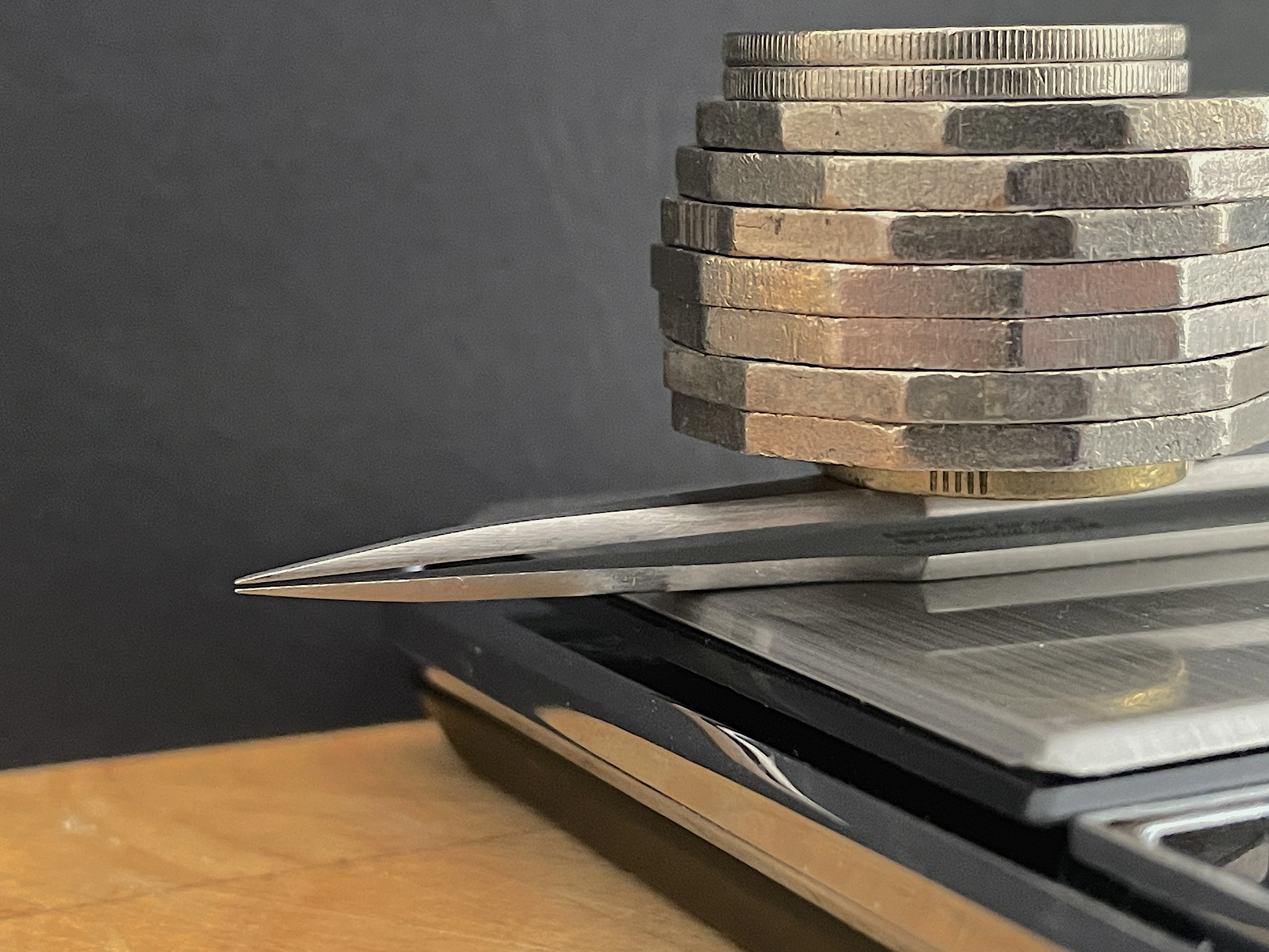

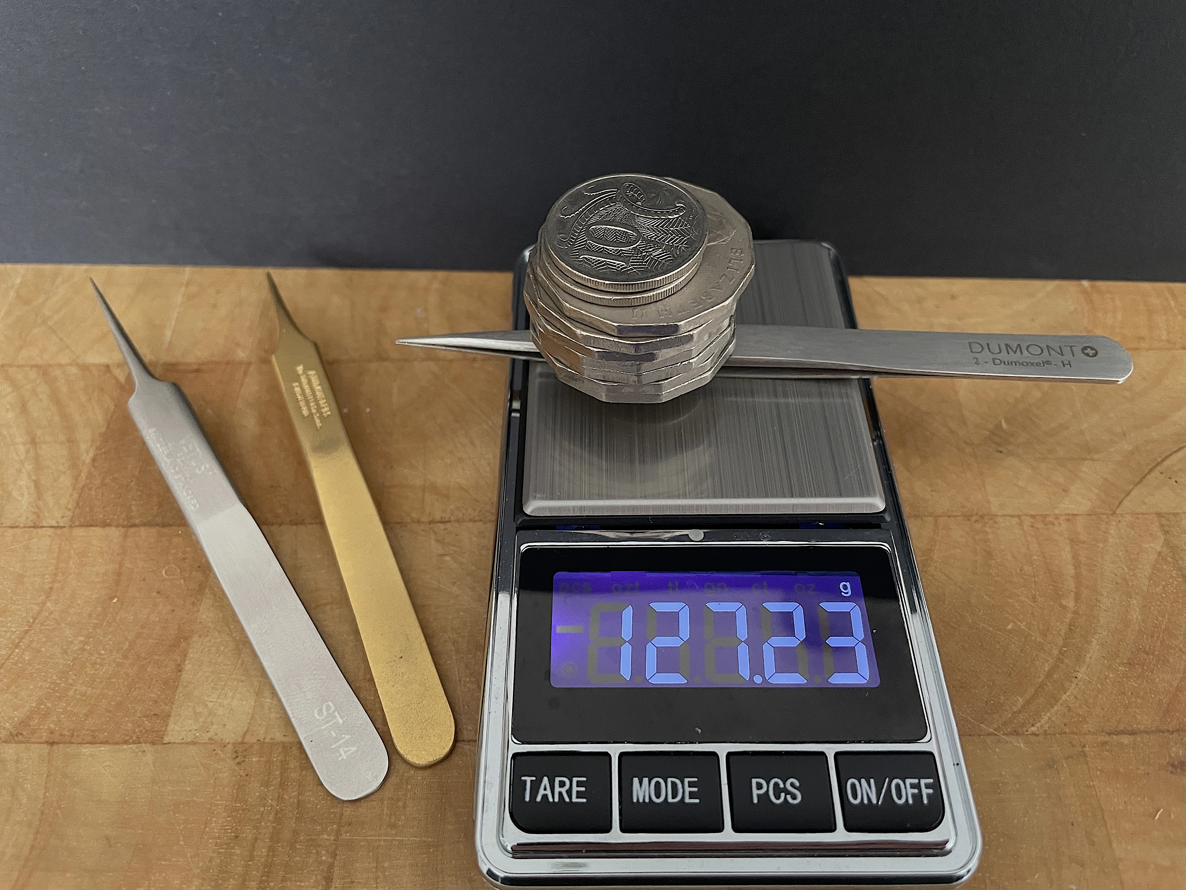

Next the Dumont No2.
they required 127+ grammes.

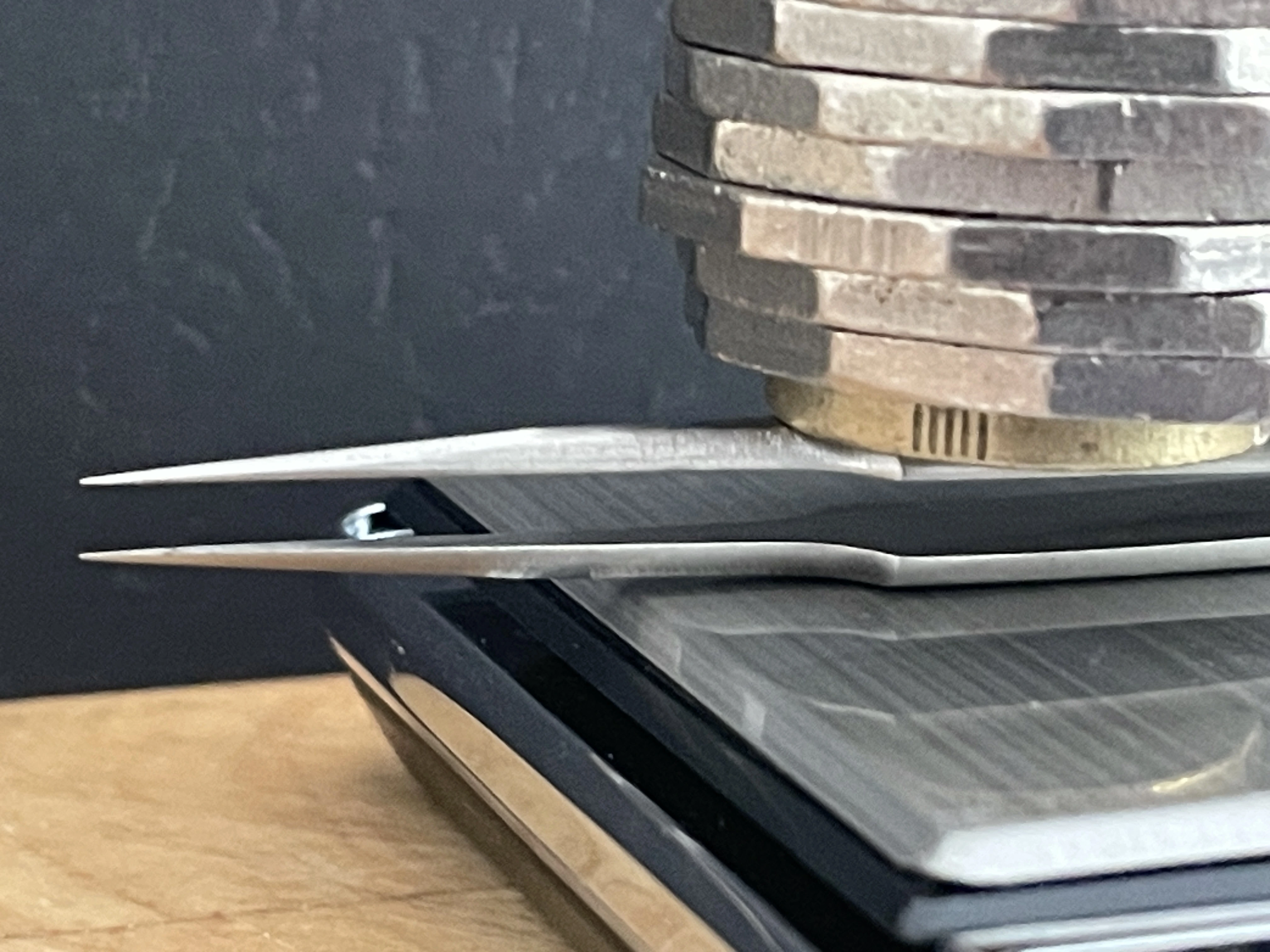

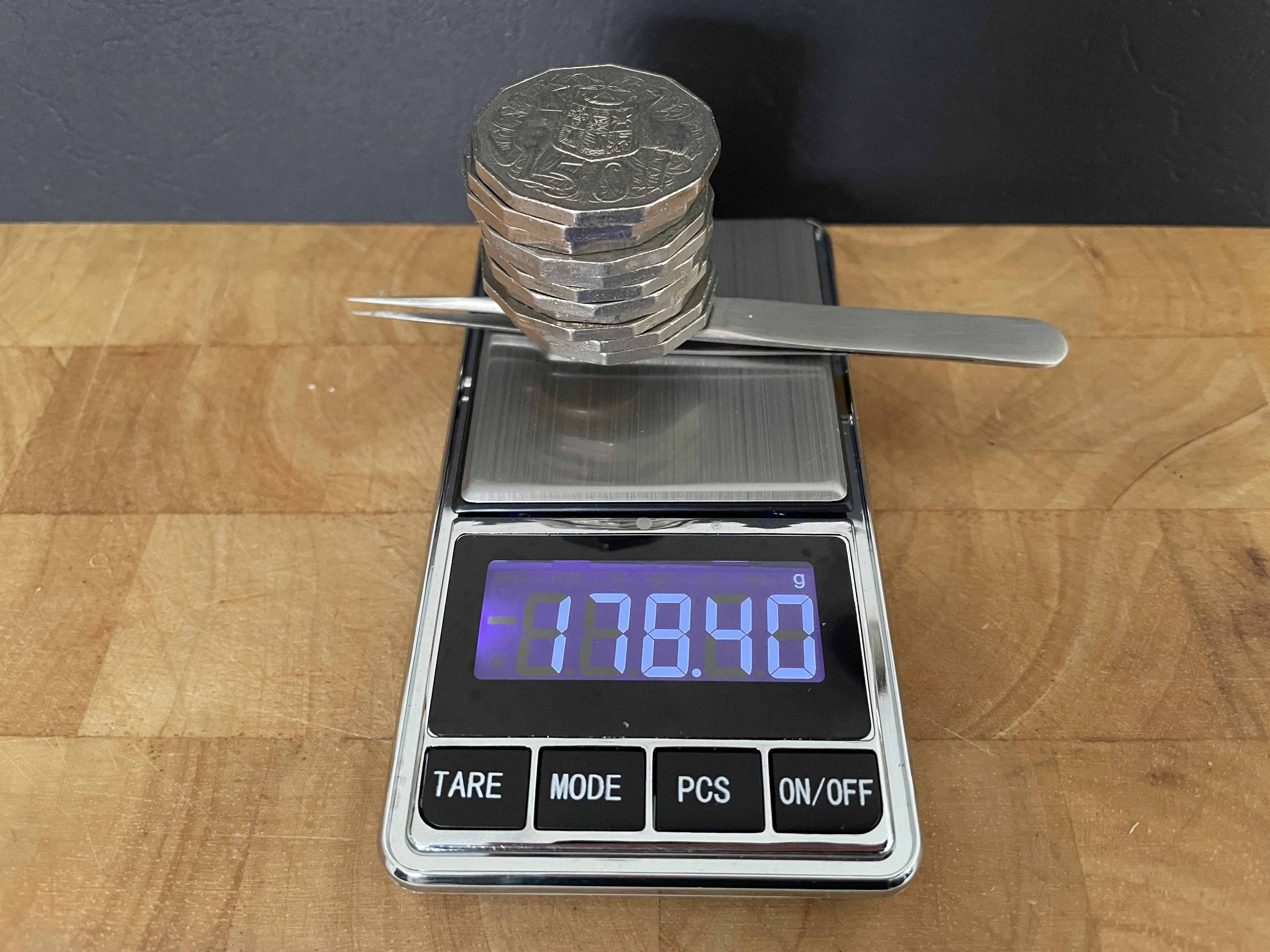

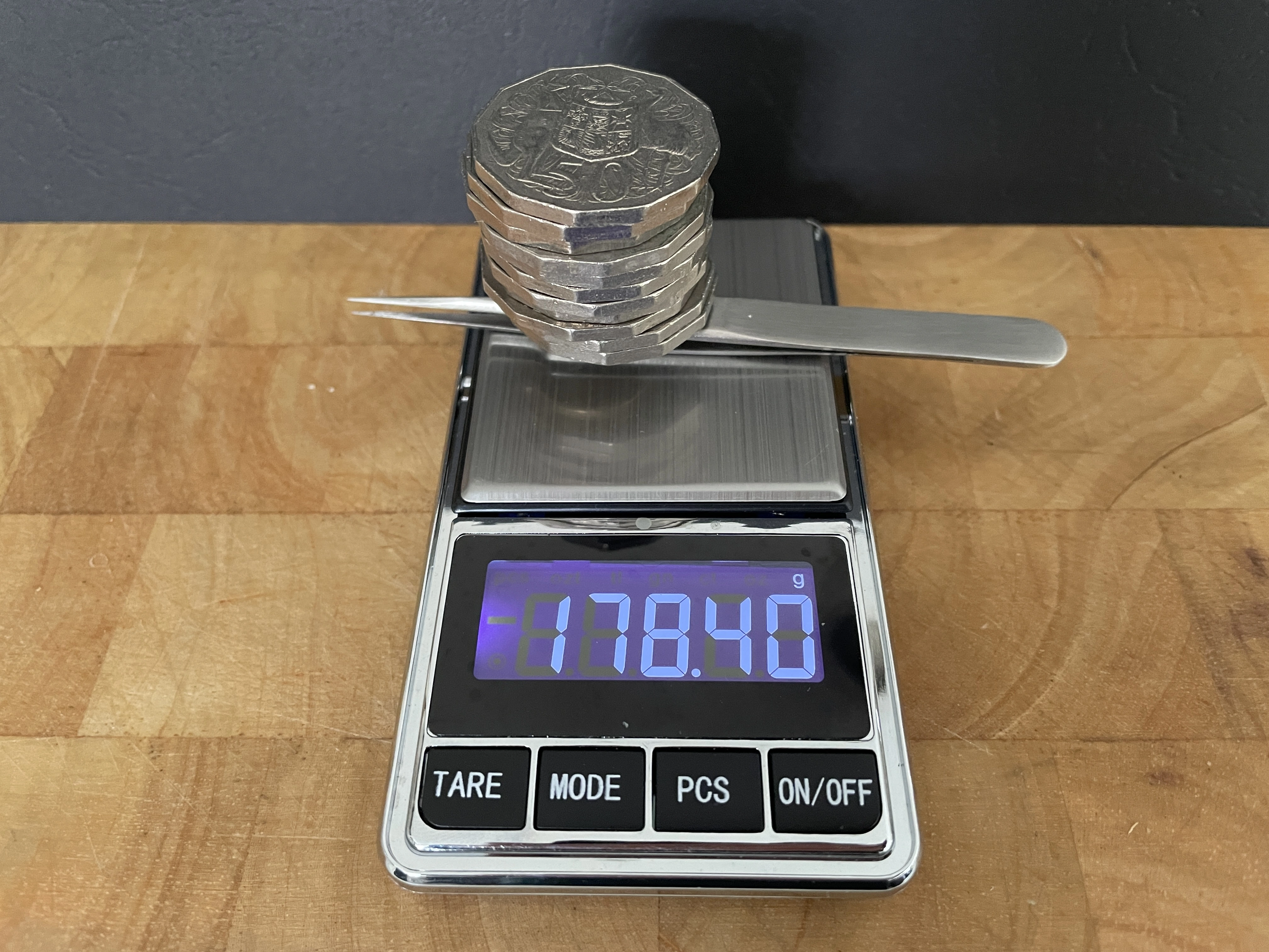

Lastly, the Vetus. I got sick of stacking coins so the force required is significantly more than desirable.
even close to 180 grammes wasn't enough.

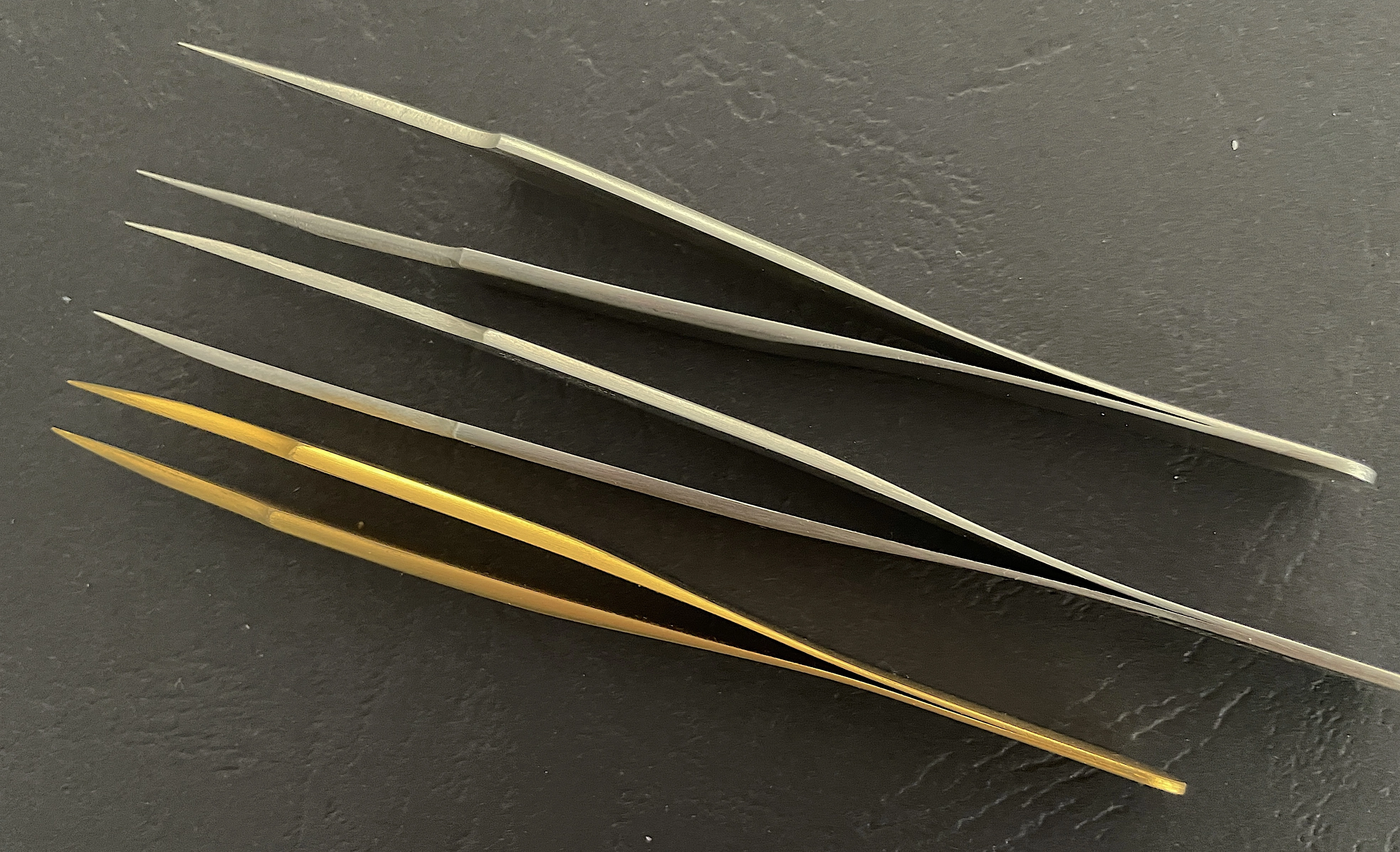

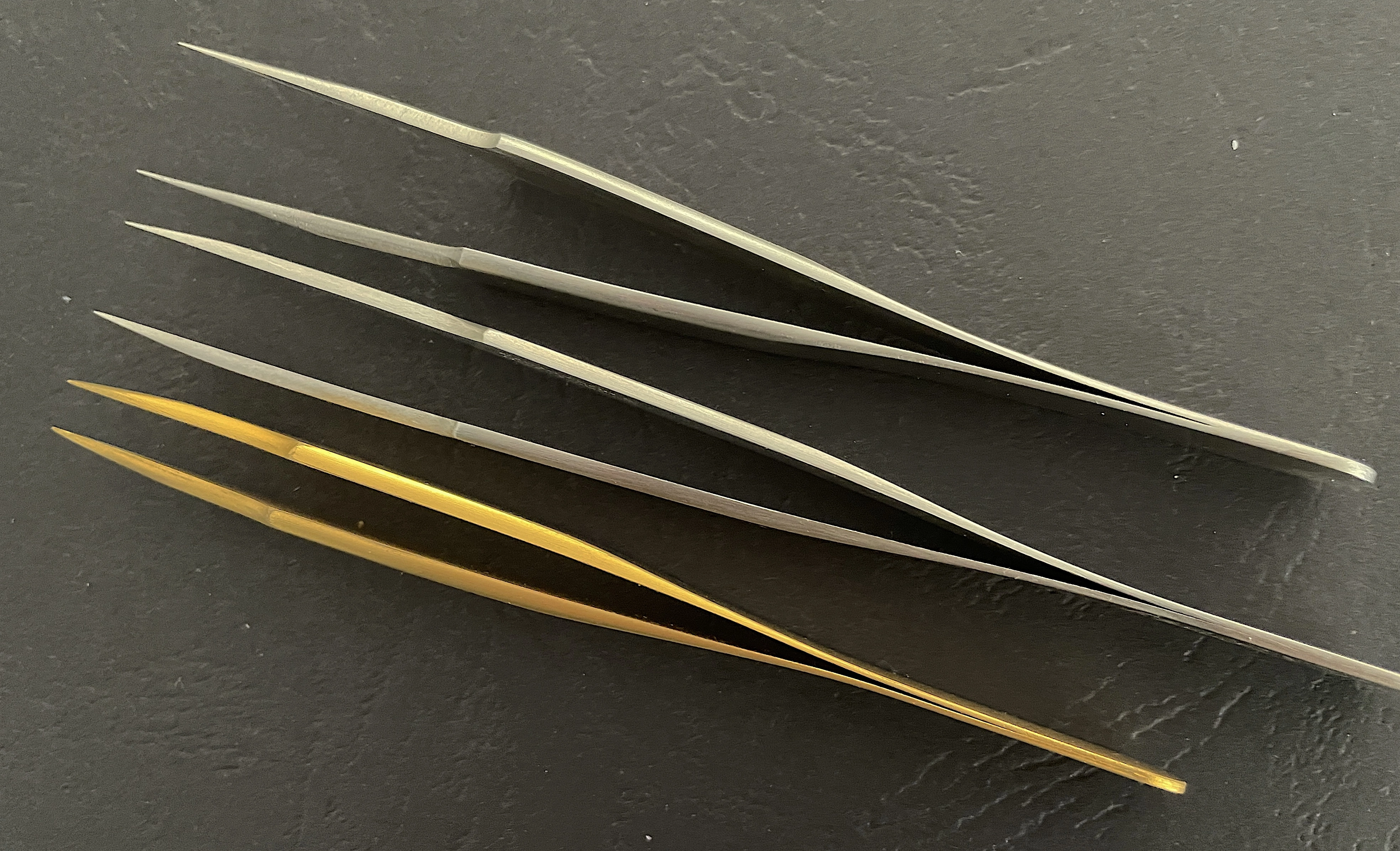

Finally a shot of all three showing the tip distances. As you can see, the bronze Dumonts have perfectly adequate clearance for all of the screws and parts I come across, even bridges and plates.
