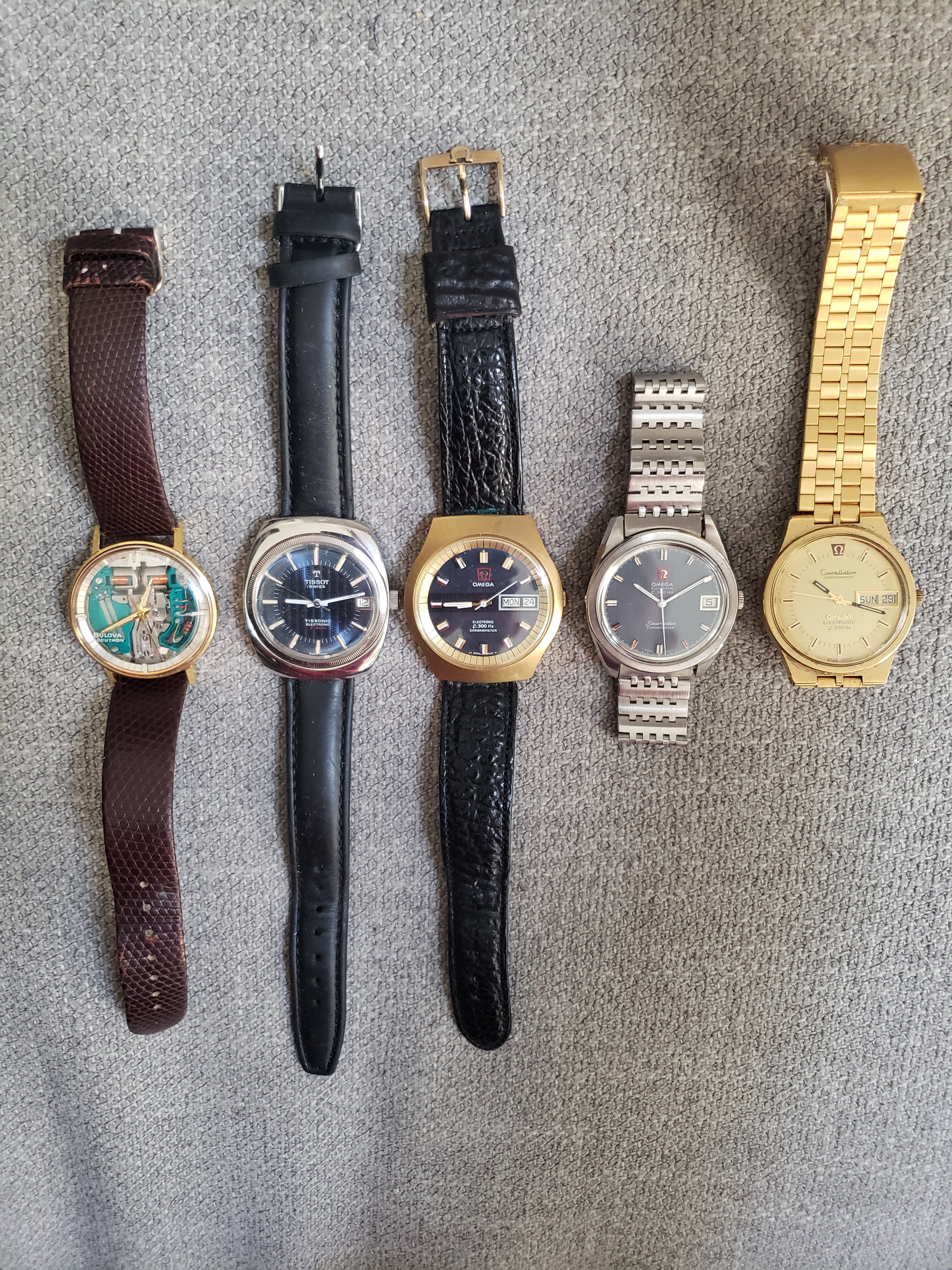

Guilty! In no particular order I have:
* A Spaceview.
* Two Omega F300s (one 9162 one 9164).
* An Omega Electroquartz Constellation.
* An Omega Seamaster mariner (1310).
* A Hamilton Sealectric.
Glad to know it's not just me.

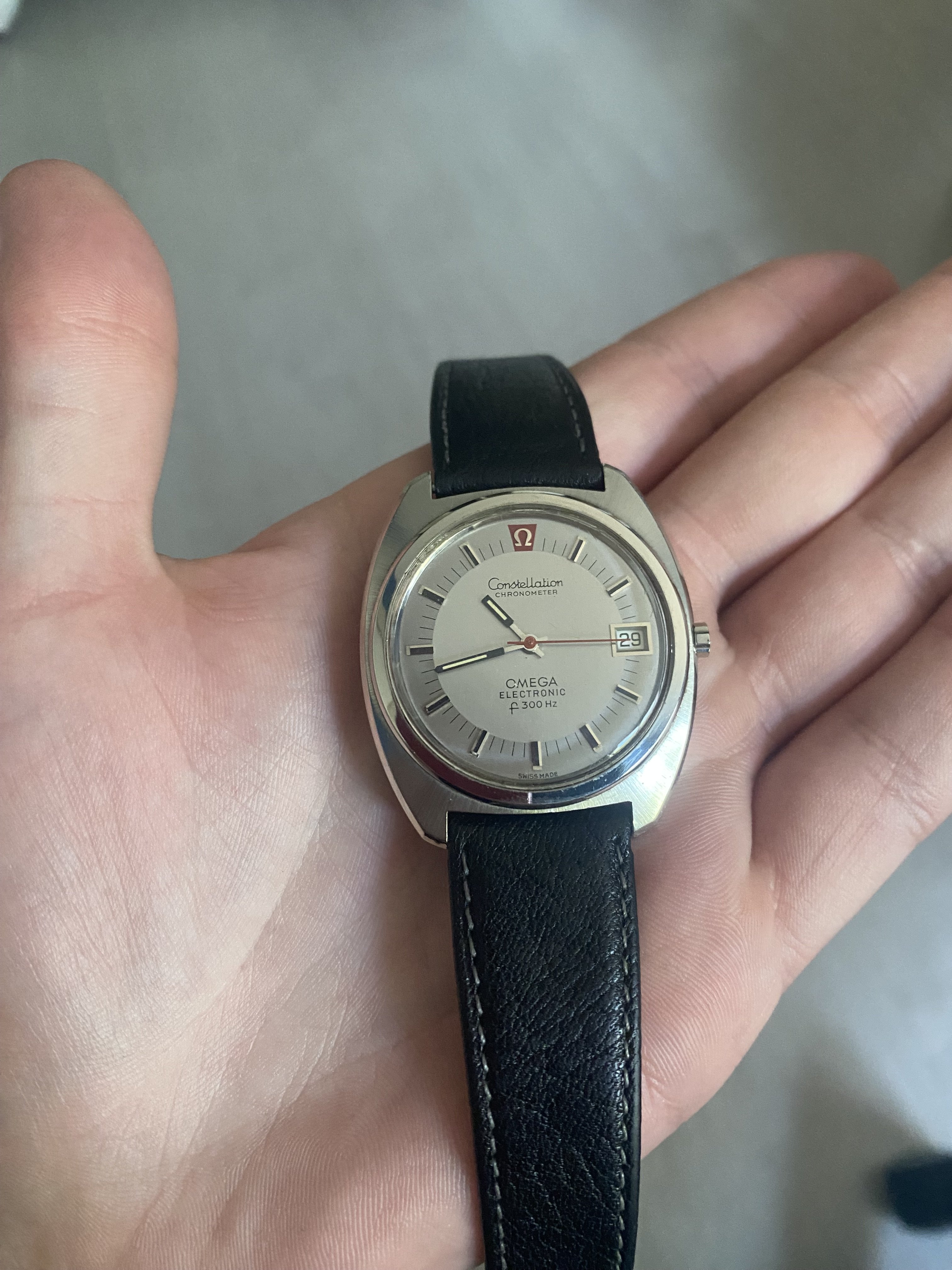

Beautiful watch, Ive been eyeing up a silver variant of this, not much information online about this watch, is it low maintenance? because I’m trying to get a nice vintage watch where I can daily without the concern of it breaking. Thanks

I’ve learnt how to change the battery and, occasionally, it sometimes needs re-siting. I’ve also bought (with the help of @Kwijibo) new gaskets from Cousins and all of that is easy.
I’ve also discovered that it’s best not to reset the date function in the hours before or after 12 midnight or midday.
I made a mess of the settings making that mistake and had to get the blue one serviced.
The gold one is not so easy for everyday in this day and age, particularly since I no longer wear a suit regularly but, having said all of the above, they’re great and, given the 37mm diameter, they wear a little more contemporary.
But, there are bargains out there and if you buy one buy a working one.
PS, the sweep second moves like a mechanical watch not a quartz jerk

As nice as these vintage watches are from a technology standpoint, it's at the point of finding watchmakers to work on them are sparce (6 month wait times if you find someone to work it) The parts are hard to come by, etc.
Would stick to mechanical vintage watches if you're looking for a low maintenance everyday watch.
There are some threads if you do a search and a few Google searches will give you plenty of rabbit holes to go down with Accutron, Omega, etc. but a couple of good starting places is this link:
https://electric-watches.co.uk/makers/omega/omega-f300-tuning-fork/

That's interesting for me because I was specifically looking for battery powered omegas due to the reputation that quartz have now of just throwing it on without thinking but it never crossed my mind that these 1250 cal movements aren't a very easy to work on, I was actually thinking that it would be way more hassle to be wearing a mechanical watch worrying about shock to the movement and all that stuff. So thank you for that i'll look more into it.
It's been a while since I've done a deep dive, but from memory in simple terms, the battery powers the transistors which keep the tuning fork humming which powers the watch. It's a genius design which kept amazingly accurate time within a second a month during the time period when watches were considered good being within seconds a day.
My dad had one for 30 years and just needed a battery replaced once a year. Every watchmaker he took it to was like a kid at Christmas since it was something they read about but rarely see one in the wild. Own quite a few and the hum with the sweeping second hand is mesmerizing when they work.
But once they stop working it costs more in time and labor to have one serviced than to buy a new one. It's a shame really as they have great dials and a neat history.

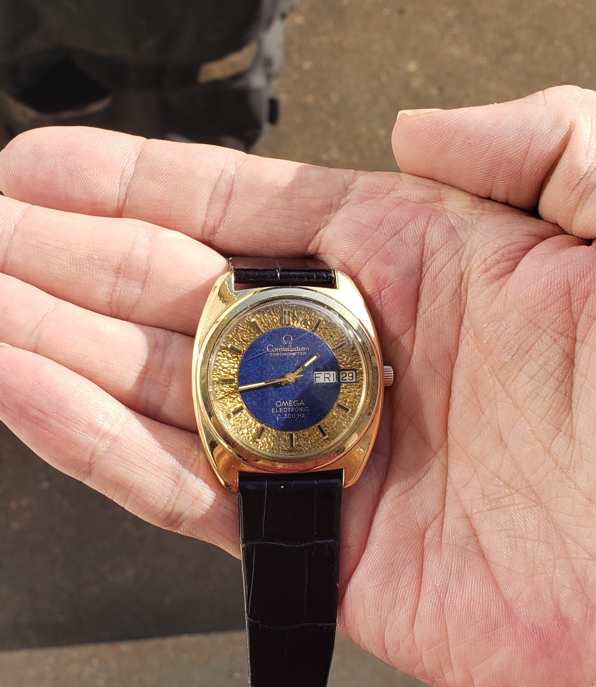

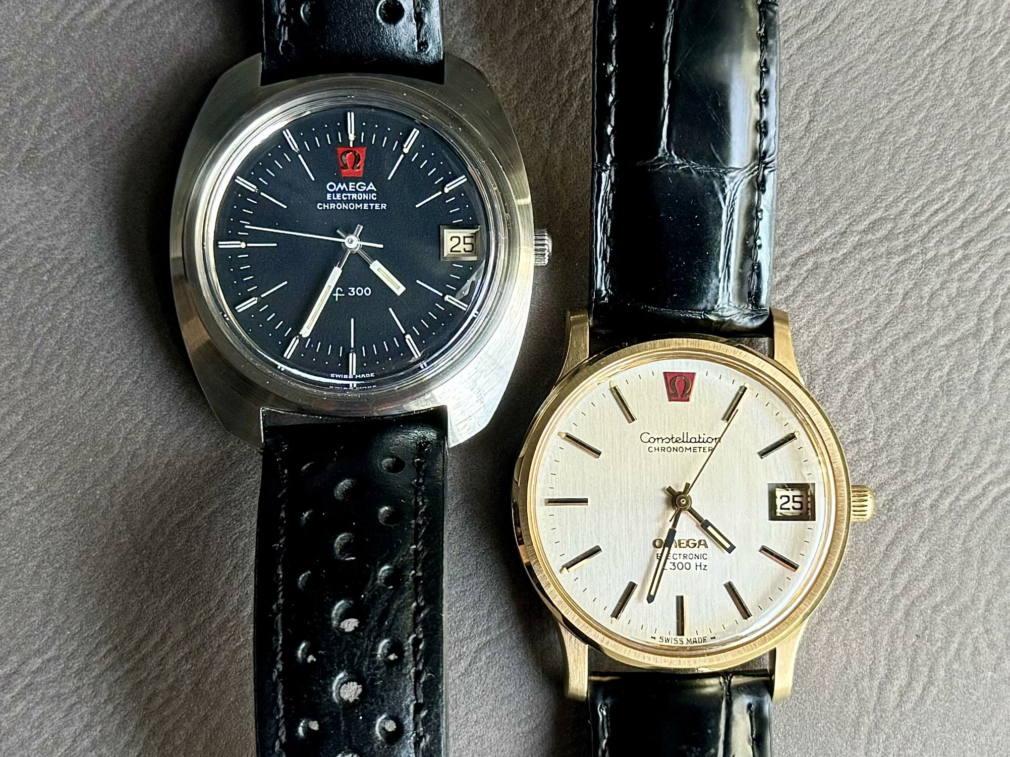

I agree with the trouble finding many parts (coils, index wheel, date disk...) for these movements and the scarcity of watchmakers who work on them. However, I think this issue is reflected on the price to a certain extent. You can find these in good condition for less than $500. If they break one day, they are still worth at least $200 for parts. It's possible to make even more by selling certain parts separately.
Below are the two that I have that are in working condition (too bad they are not synced for the photo). I purchased the black one from another OF member during the last year and serviced it. I bought the gold plated one on eBay as non-working, serviced it and had the case replated. It wasn’t the best economic decision, but I don’t mind spending an extra couple hundred dollars to save a nice looking, not working Omega that could get trashed otherwise, as long as I know that I will wear it occasionally. I have two more ongoing f300 projects that I will update this thread with once they are finished.
I agree on having them serviced but tough to find places to do it. Forgot to grab one of my favorites with the lapis dial which need to be fixed and have a donor watch to swap movements, still end up with the same problem of service. Probably need to bite the bullet and get on the list for service, just send them in. Where are you located?

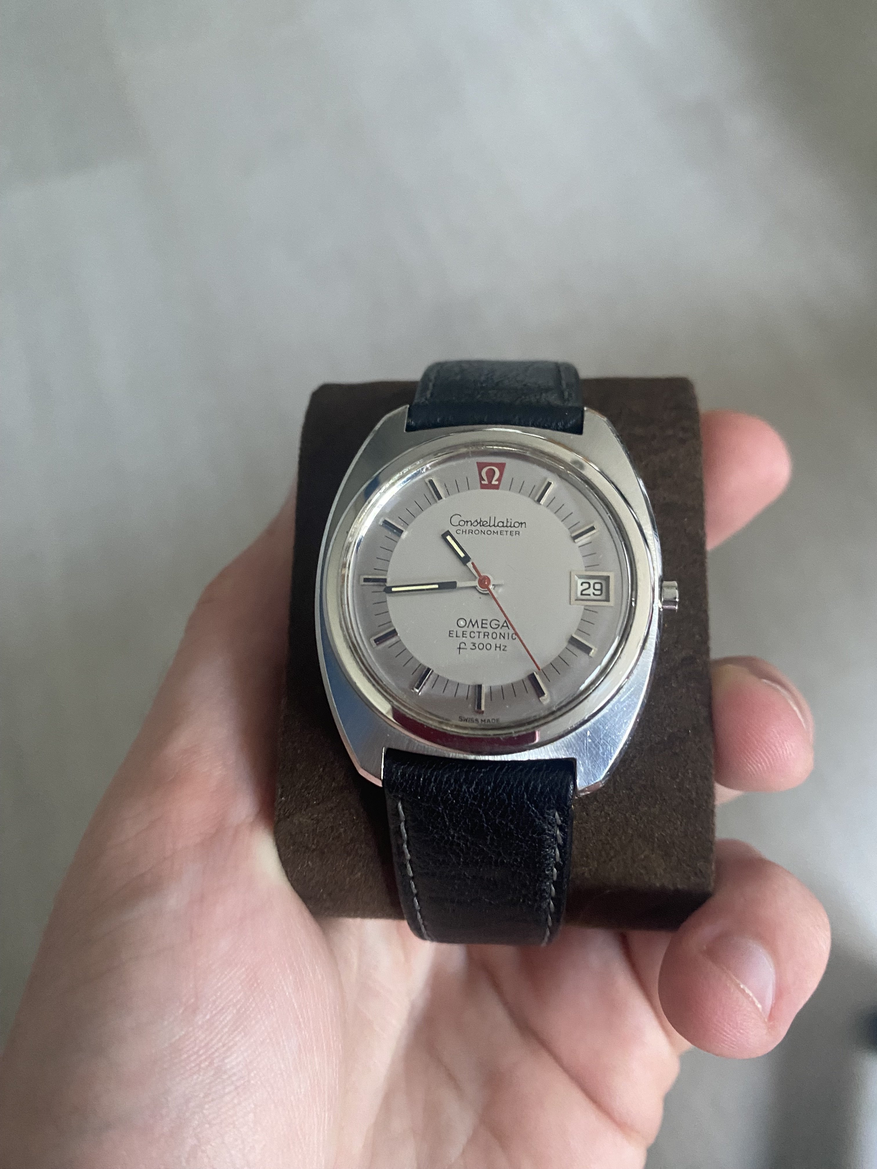

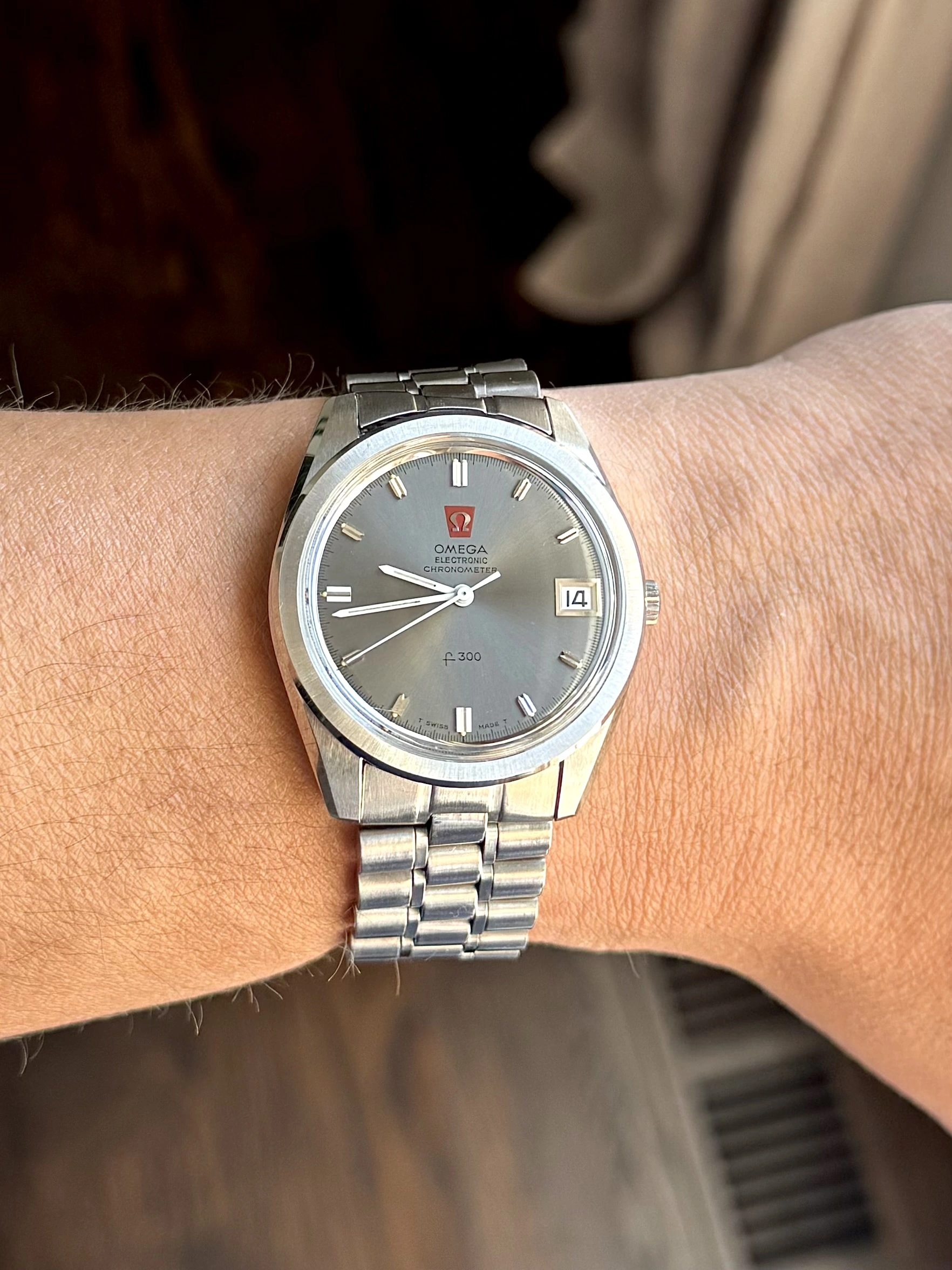

What do we think about this?
229
1,769
Looks pretty good to me. Not that common these days. Enjoy it!
14
18
Thank you, just realised it has the original crystal aswell with the small omega logo etched in, small bonus.

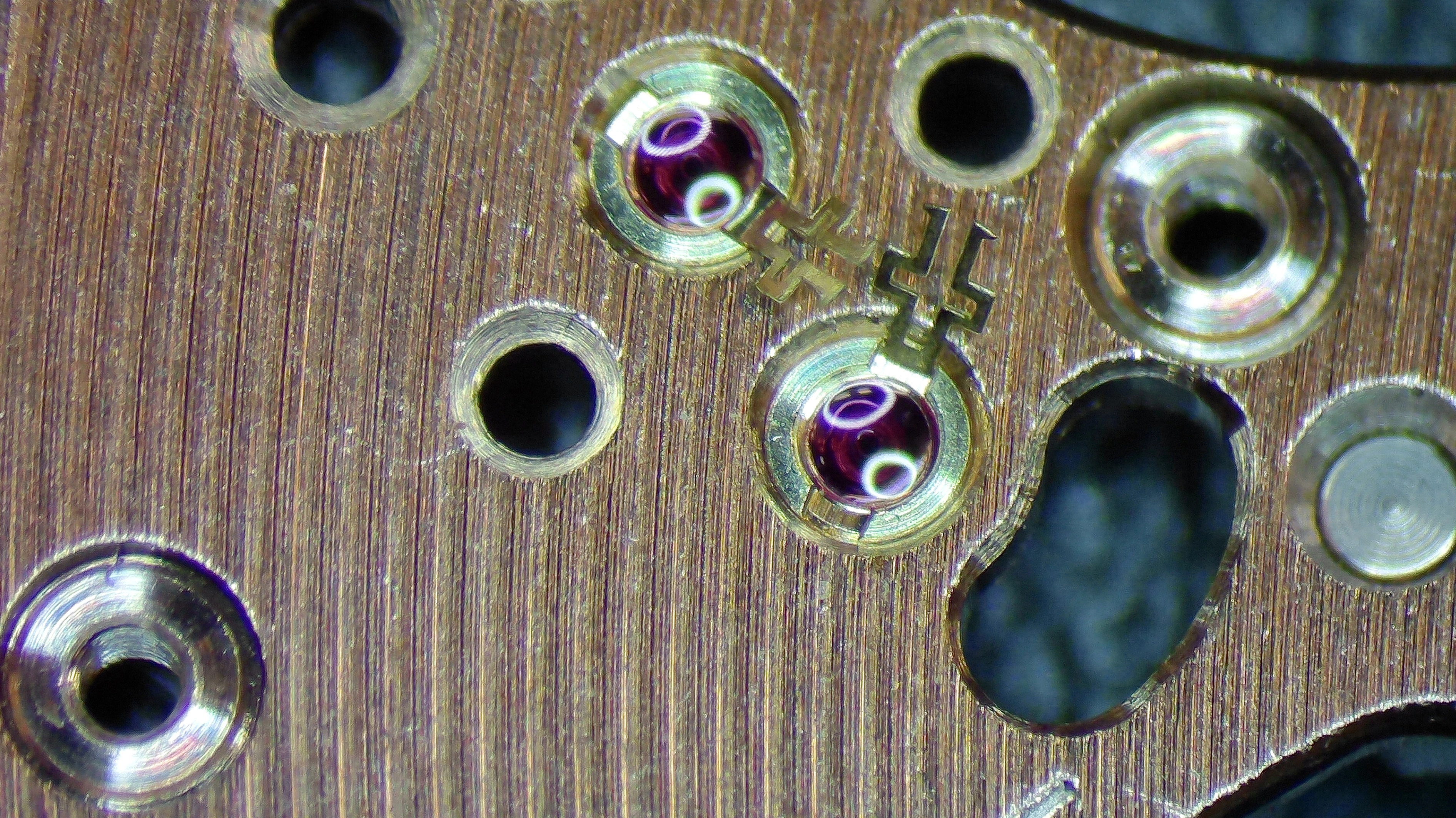

Restored another one that I also posted in the WRUW thread, a 198.0001 with a dark gray sunburst dial and white hands. The added bonus with this one was a NOS 1098/540 bracelet. The watch seemed NOS as well, but it has scratches on the crystal and the movement. The battery had leaked at some point and caused the pivot of the sweep second hand to rust and seize. Someone unsuccessfully tried to fix the battery leak by scratching the corrosion on the main plate with a screwdriver. A full service including polishing the pivots of the sweep second hand brought it back to life.
This was the first time that I saw this type of shock spring. Please reply if you know what it's called.
