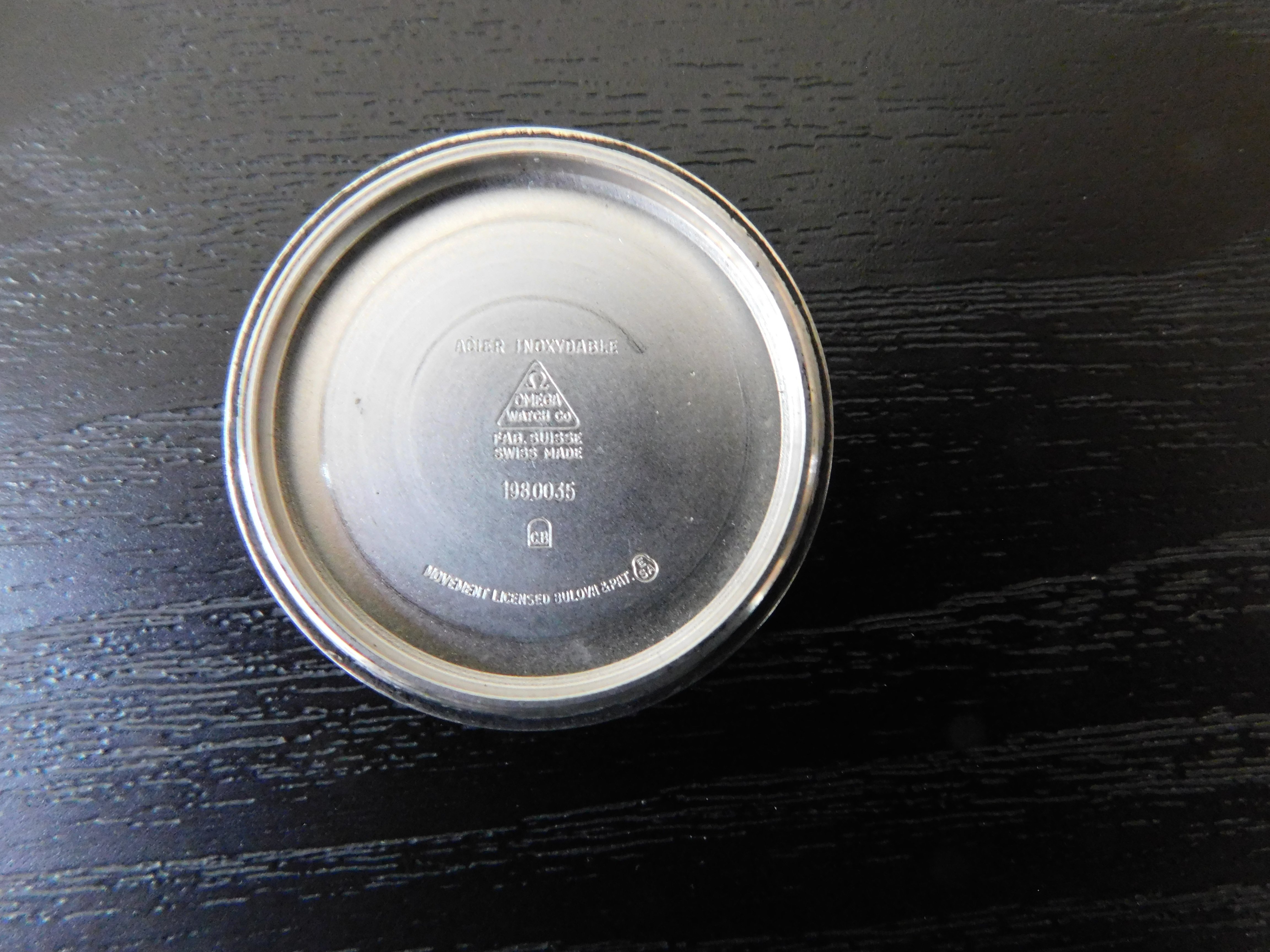

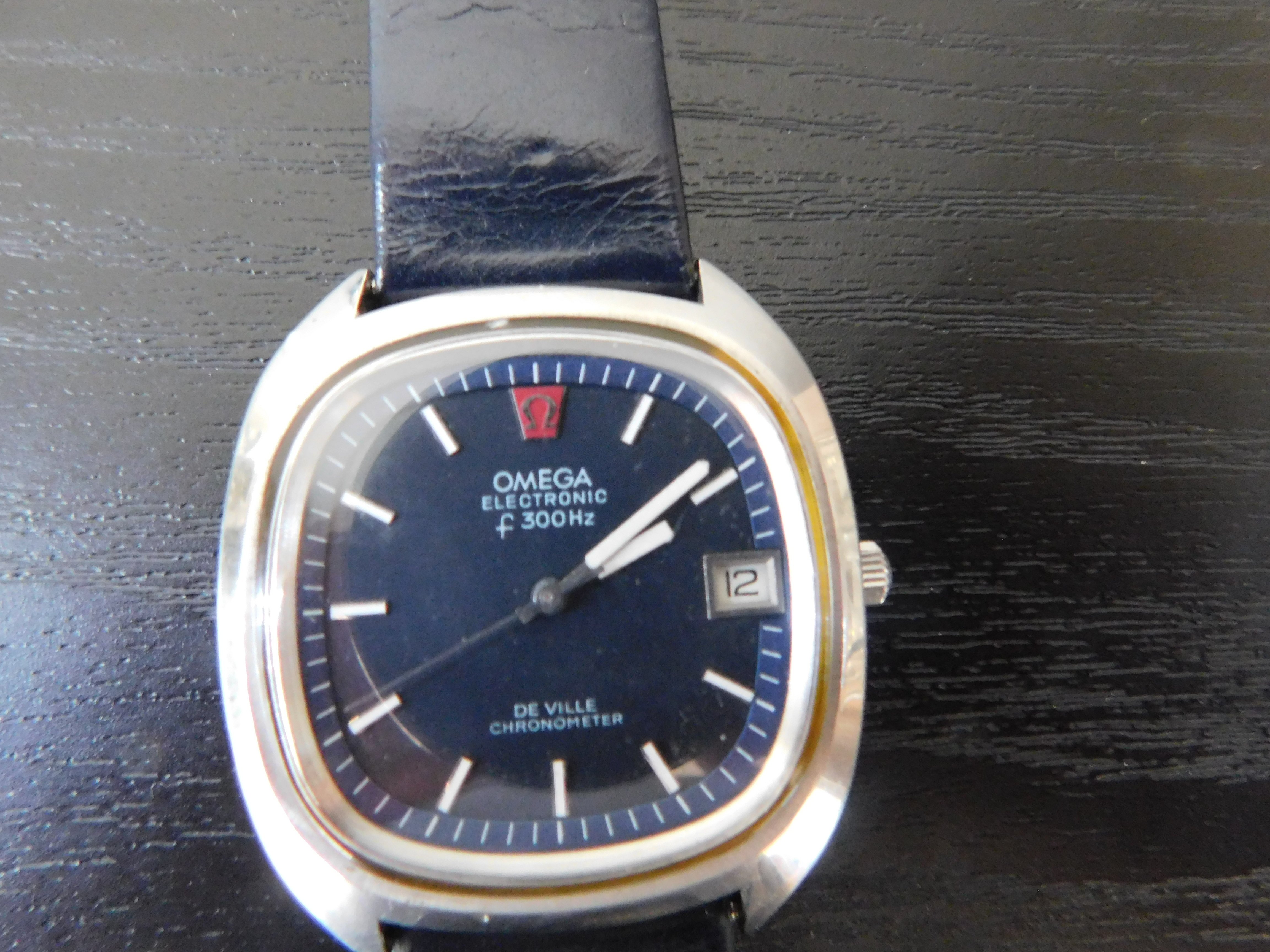

I have several Constellation and Geneve projects nearing completion. I picked up a very nice looking Omega Deville with the electronic movement supplies by ESA ( 9162 ). The watch is all original including the dial, leather band, buckle and crown. Unpolished, so no work has been done to it. I installed a new battery, the watch does run, it hums even.
The only issue is that it runs slow and needs to be regulated. I have researched all of the pitfalls of what can go wrong with these and the most common failures.
Does anyone in this forum still know how to service/repair these? Watch is about 50 years old. Reference is 198.0035
Let me know your thoughts.

When you suggest that it runs too slow. How MUCH too slow? You suggest it needs to be regulated. If the watch is slow a few seconds per day, it may be possible to regulate it. But there is a limit to the effect on the regulators (there are two). If the watch is out minutes in a day, it needs a thorough service, and possible parts.
