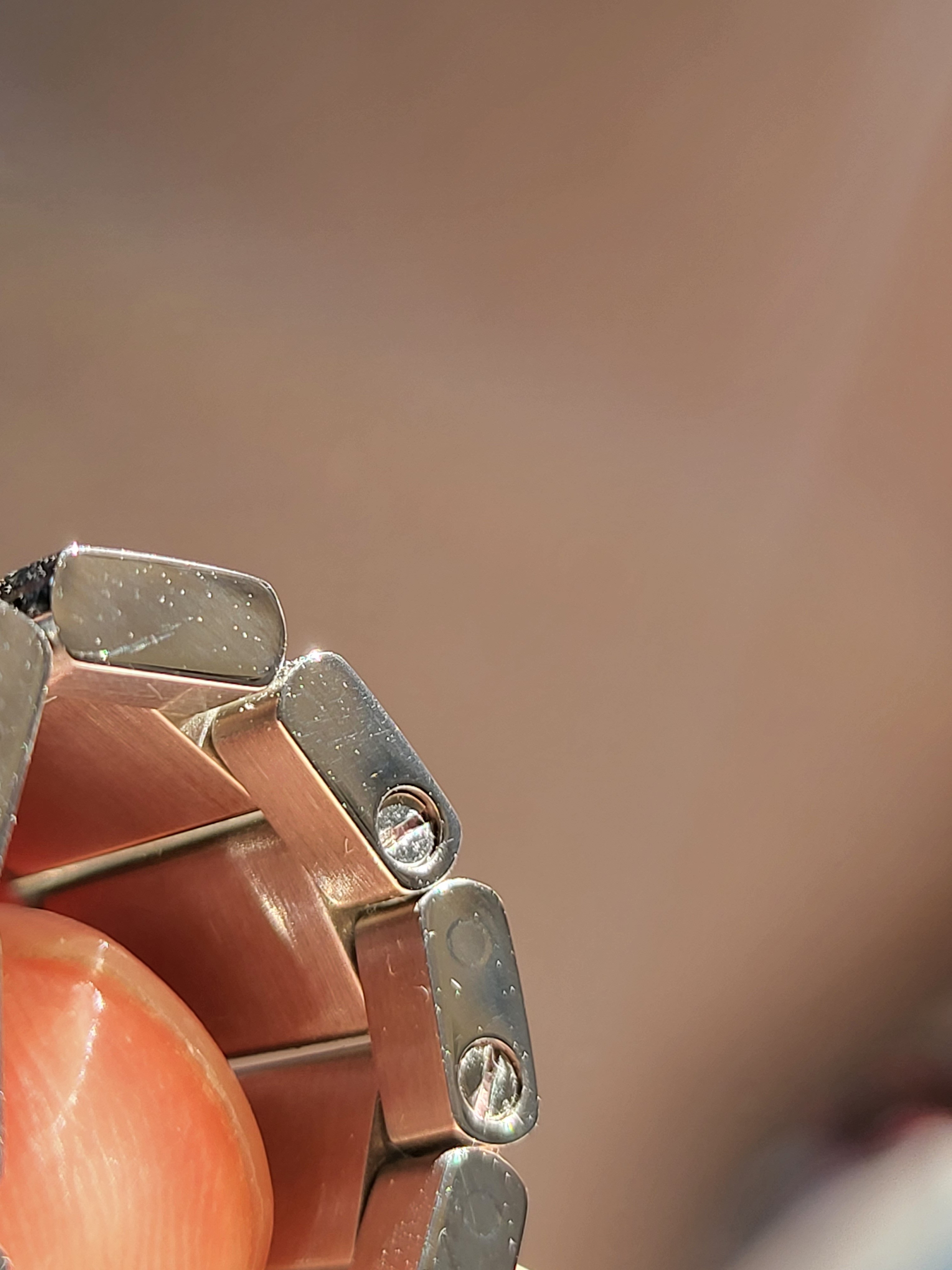

My first omega. Like it, but dang who thought poppyseed sized screws on both sides makes sense.

Wear in good health. What is wrong with the screws?

They are tiny, smaller than a poppy seed. already lost one. Just doesn't seem like a very good design. Only other bracelet that I hated resizing more was my Seiko ridley

I would spend top dollar for a great screwdriver and wear optics so I don't mess everything up like in the photo above.

I used horotecs screwdrivers...that's loctite and lint from my t-shirt, but thanks for the helpful comment

Sorry, I couldn't tell from the photo. A lot of people just grab whatever is in the toolbox and go to town. Don't get mad at this question but did you try heating the bracelet with a hair dryer or something better?

No worries, yes the photo it looks like I used a playskool screwdriver set. Normally if I'm trying to be super careful I'll heat it up, but I was being lazy. It wasn't screwing or unscrewing that was hard, it was physically holding the screw with my fingertips, probably should have used forceps. I don't always loctite screws either but these are so short and small I figured I'd need to and when they were so small it was hard to get a tiny tiny dab. That's why I posted, it was frustrating getting loctite everywhere, and I didn't think I lost any screws but when wrapping the links in plastic and putting them into a tiny ziplock one went missing. Only other watch I thought was worse was my Seiko Ripley reissue. Now that it's sized up I'm happy but it was harder than I thought it would be.
No matter what the quality of the screwdriver, you need to make sure it is properly fitted to the slot in order to prevent cam out. It should almost bottom out in the slot, and completely fill the slot.
This^^^
