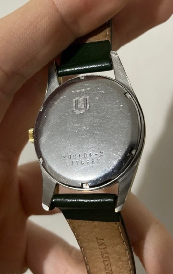

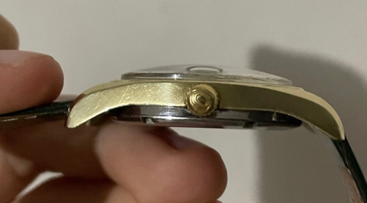

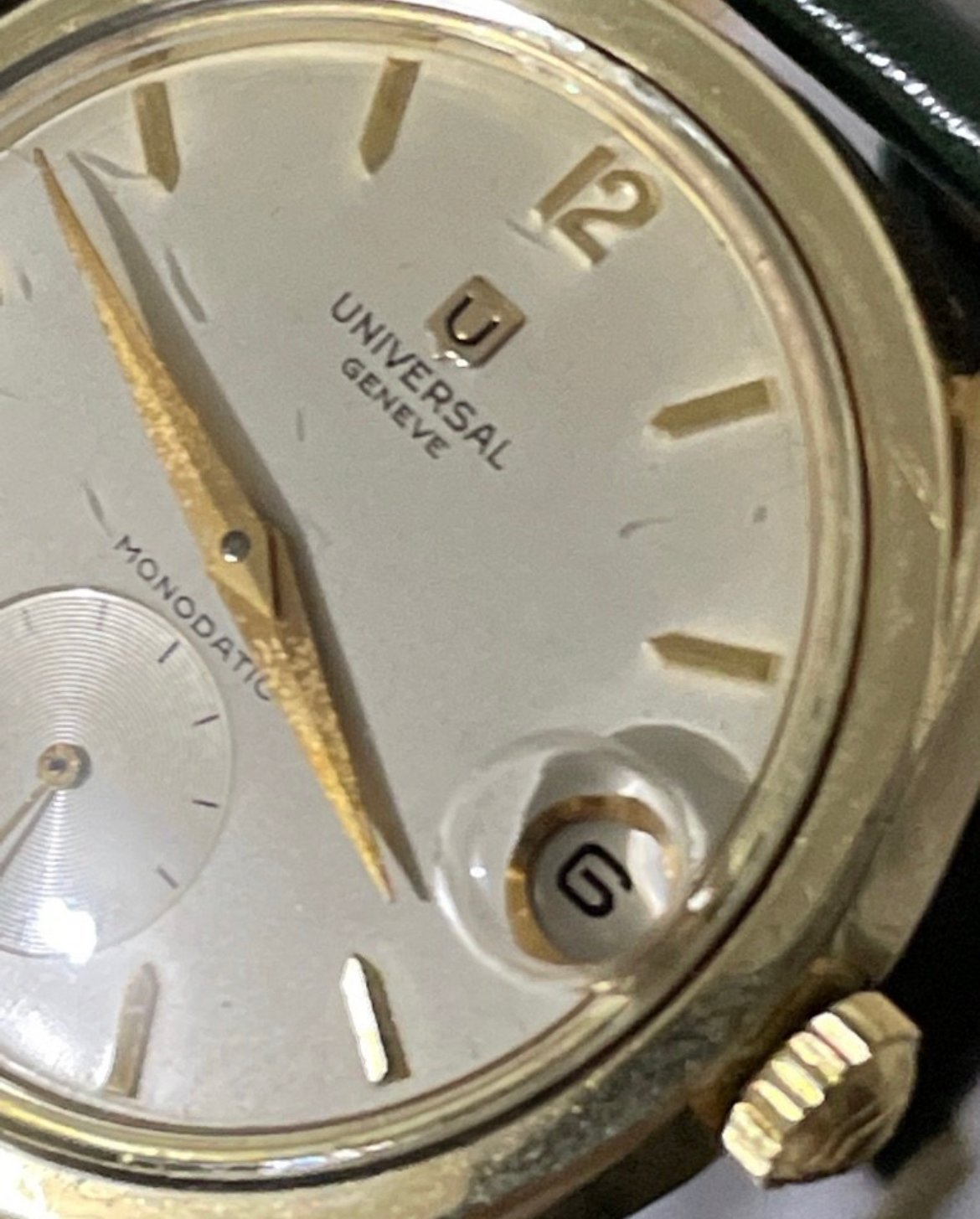

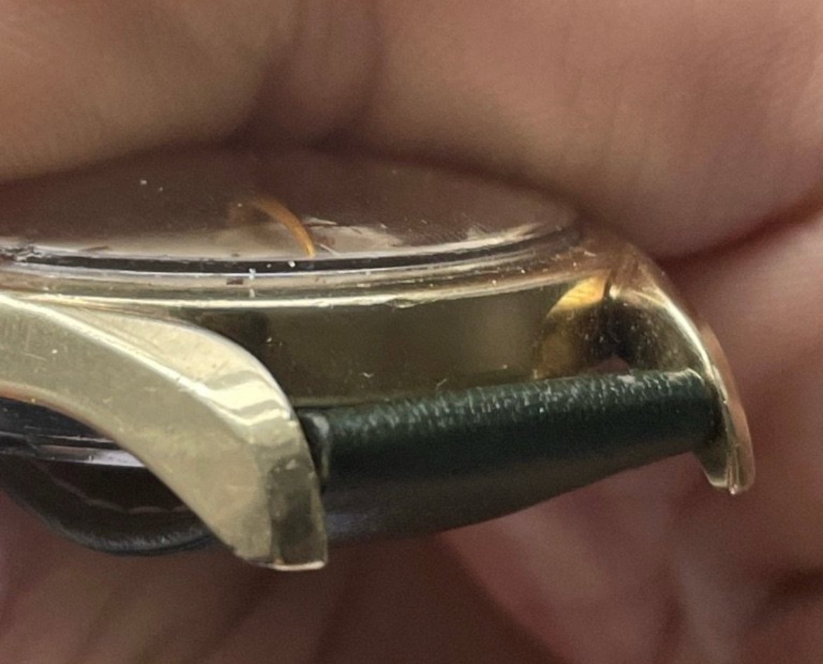

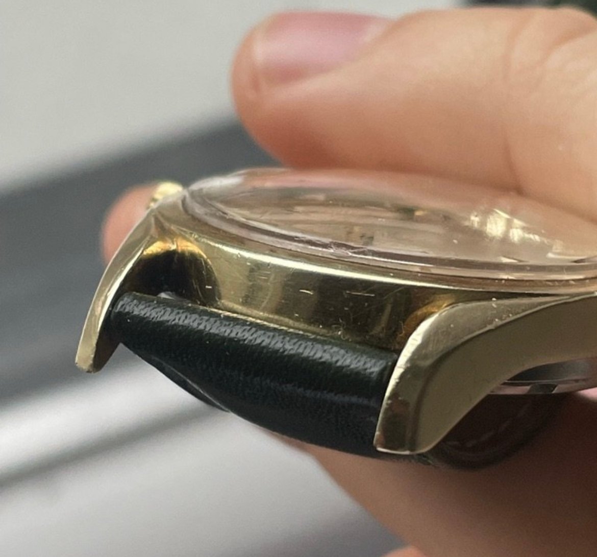

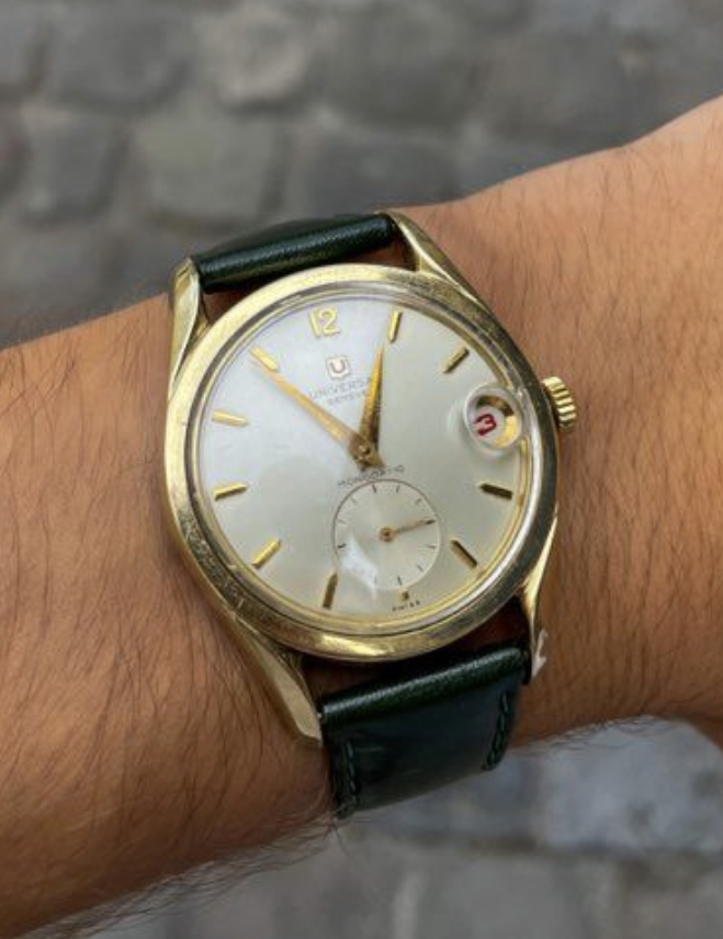

Hi all!
I’ve come across this nice little UG and I cannot seem to find much info about it to evaluate its condition and value. From what I can see, it’s gold capped, from the mid 50s, apparently 36mm wide.
The seller says it’s completely original (date wheel, crown, crystal, etc.)
Do it seem like it? Does it look like it has been polished much? The case doesn’t seem that sharp but I’m not used to gold capped cases…
Thanks!

shouldn't the reference start with a 4 for a plated/cap case? (and a 2 for a SS case?)
756
1,068
Hmm…So that would mean the caseback was swapped? That’s a pretty big deal breaker :/
1,209
3,069
No, fairly sure that reference is correct. If you just do an internet search for "Monodatic 200104" you'll see a few different examples with the same reference and different but very similar serial numbers.
I think the 2 at the start of the reference is used to denote steel or gold-capped.
I think will 4 will denote gold-plated, which explains the gold-plated example you provided above.
This same approach applies to the earlier Polerouters.

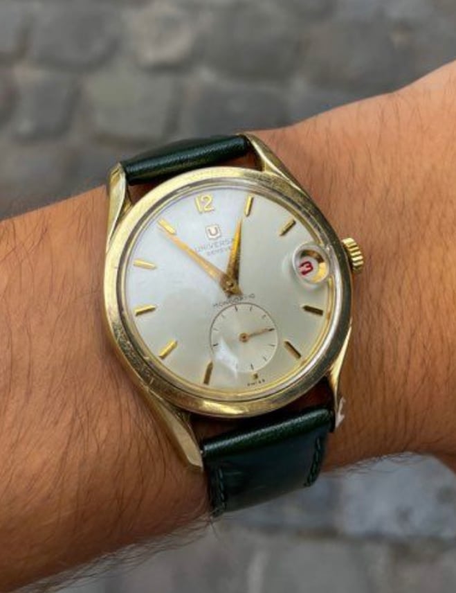

And what would you think of this particular example? 😀

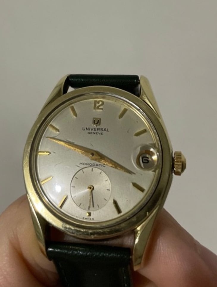

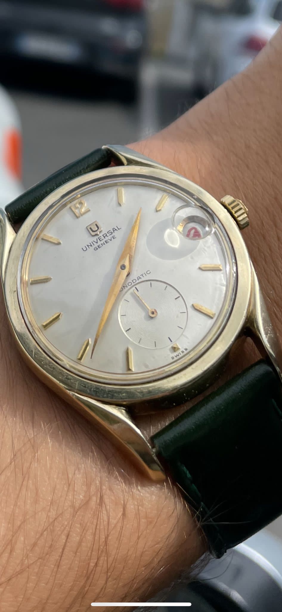

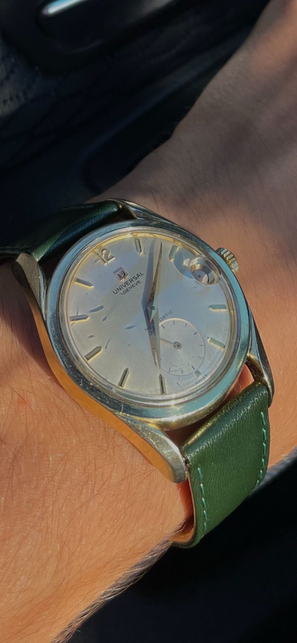

Got new pictures but none very sharp…I’m considering trying to go see it but it’s not that easy :/
Any idea what these go for in nice condition? Seller is asking 1150€ and I have no idea if it’s « worth »that kind of price, the only others similar I found for sale (all very close in serial) we’re listed between 1200 and 1500€, but not recently…
Thanks! 😀
121
475
Nice Monodatic. Appears to be all original, crystal and crown as they should be and note the roulette date wheel which is always a plus. Reference is correct as it’s gold-capped, not plated. Price is slightly high given somewhat “plain” dial but definitely not crazy given condition.
