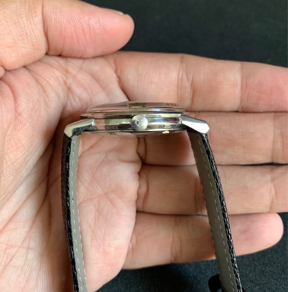

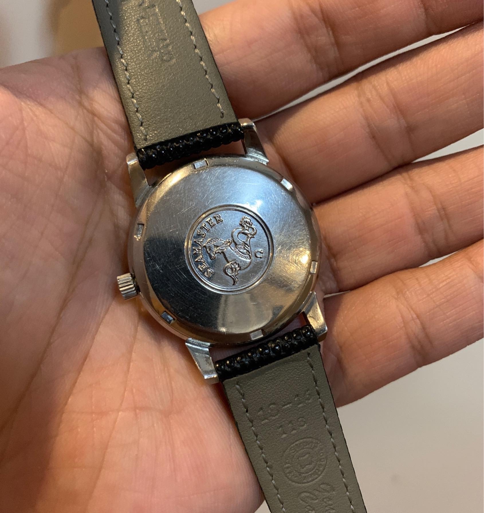

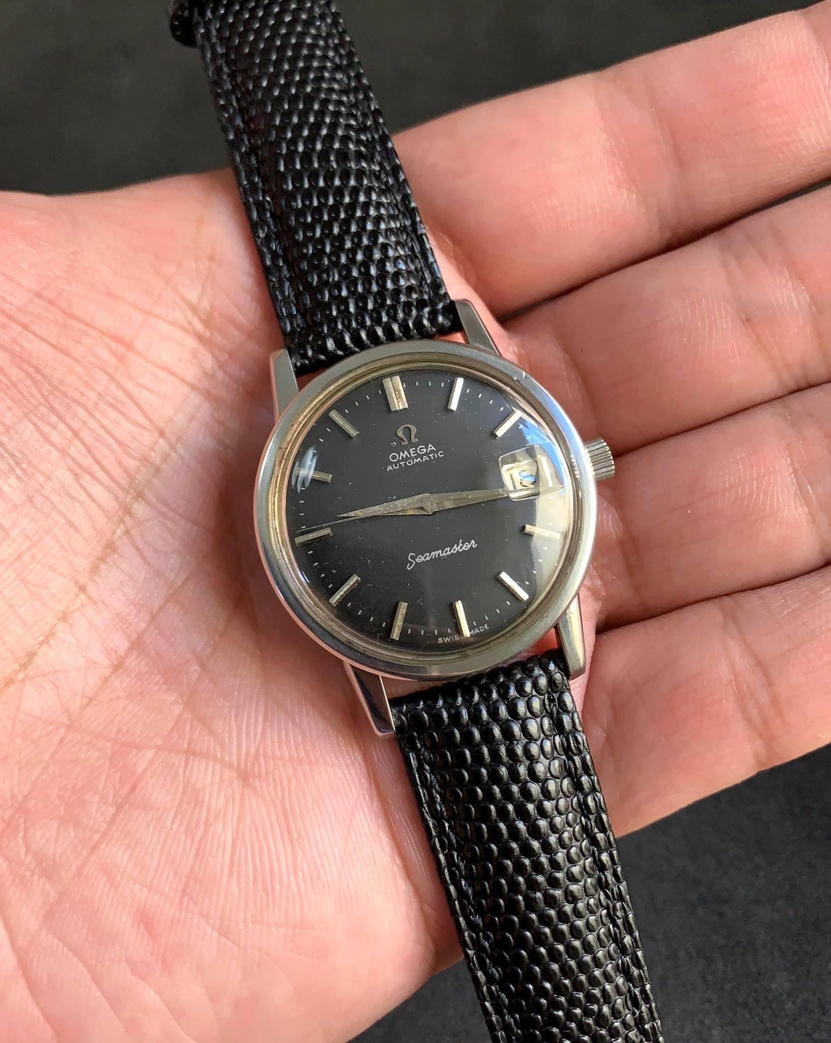

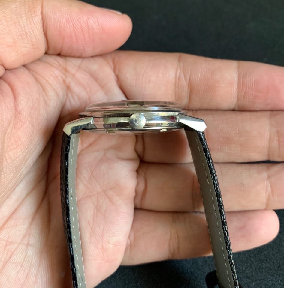

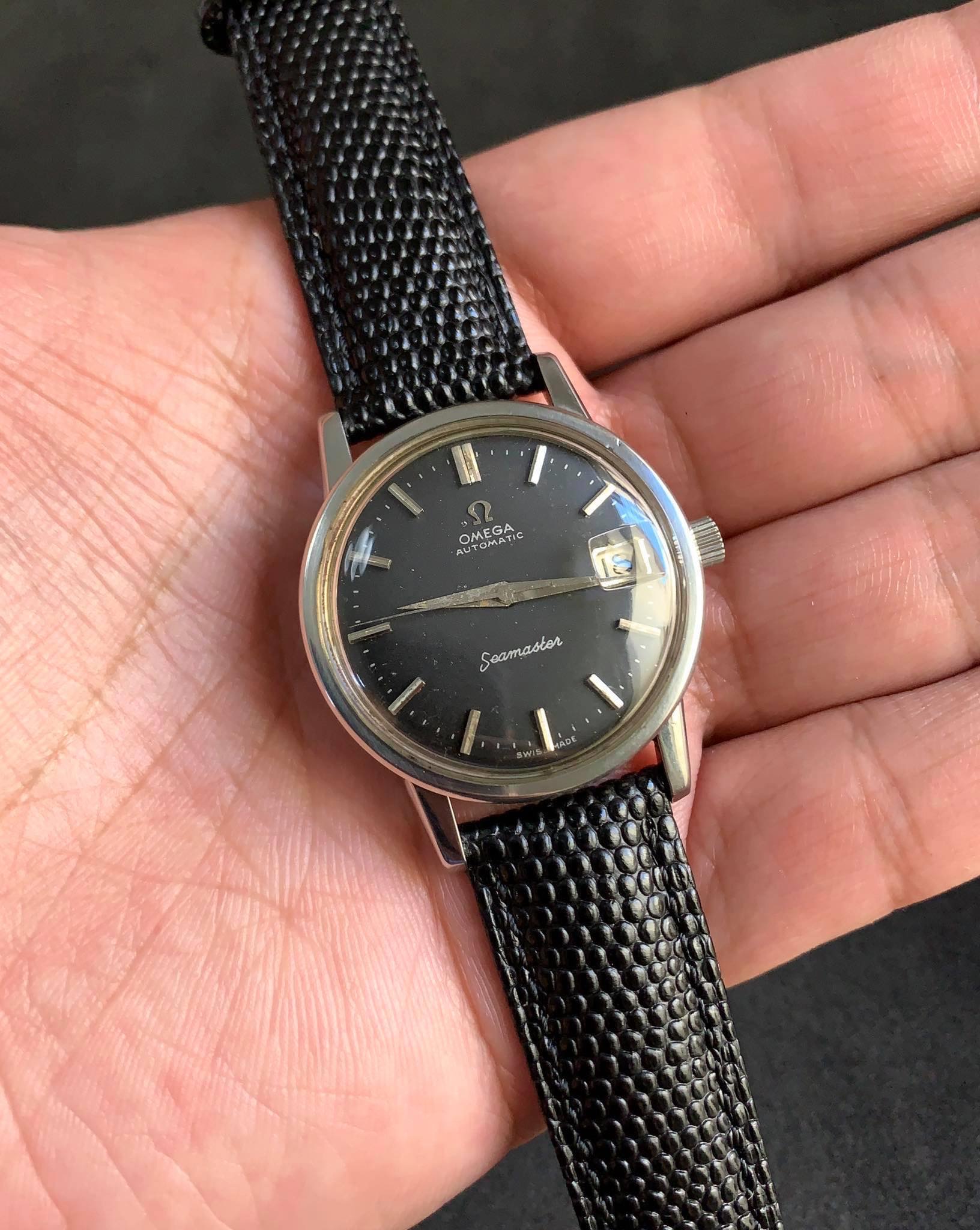

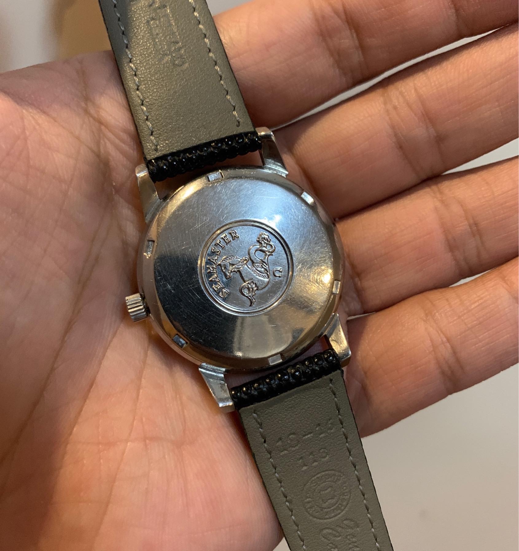

Hi guys,
Newbie here. Thank you for approving my request to join the group. I took a leap of faith a few days ago and bought my first vintage watch from a dealer [ in my country, Philippines ]. He said it was a caliber 562. Other than that plus the three pictures that you see here, thats all the info I got. Before I purchased it, I did some research on the internet and came across some articles that this is one of the Japan market models ( sorry I absolutely have no idea what that means ).
Except for the strap that he replaced, he vouched that the watch is all genuine. Can anyone tell me what's the model? I tried the vintage watch section of the Omega website but I couldn't find anything.
As soon as I get it, I'll have someone take a peek inside and take pics of the movement. Any info now would at least take some of the anxiety away.
Thanks!

There are many more OF members far more experienced than me but your watch photos show a similarity to my 165.003 case although, since your watch has a date window, my guess is that it could be a 166.003.

Not sure on the reference, but the dial has been re-painted. I assume the seller didn’t disclose that?

This may sound as a stupid questions.
What has made you realise that the dial has been repainted?
I am trying to learn, to be able to identify those dials.

Not to be a wise-guy, but @seekingseaquest can identify it as a repainted dial because he has looked at 10,000 correct dials, and knows the obvious and subtle differences. Unfortunately, there's no easy way to replicate his knowledge without putting in the work. Every repainted dial is different, so there's little point in explaining why every one is wrong. If he tells you that the paint finish is wrong or the printing is wrong, that doesn't really help you, since you still can't recognize it for yourself.

@Dan S is right, this isn’t an easy thing to teach. There are small things that can be pointed out, but there are always exceptions and different standards for different models and eras.
That said, I don’t expect matte finished 60s Omega dials. And when a dial is black, I expect gilt text, not white text. The Seamaster text on this one also seems a bit off. The Swiss Made text placement is definitely off. Hash marks typically don’t sit in the middle of the 5-minute markers too. As mentioned, there are exceptions to all of these rules..

Sir, yes the dealer did not disclose that the dial was repainted 🙁. This strips a lot of value from the watch, doesn't it? I paid US$360 for it; I am now hoping I have the right movement inside. I'll have it looked at as soon as it arrives. Thank you for your comments. It has helped me a lot.
