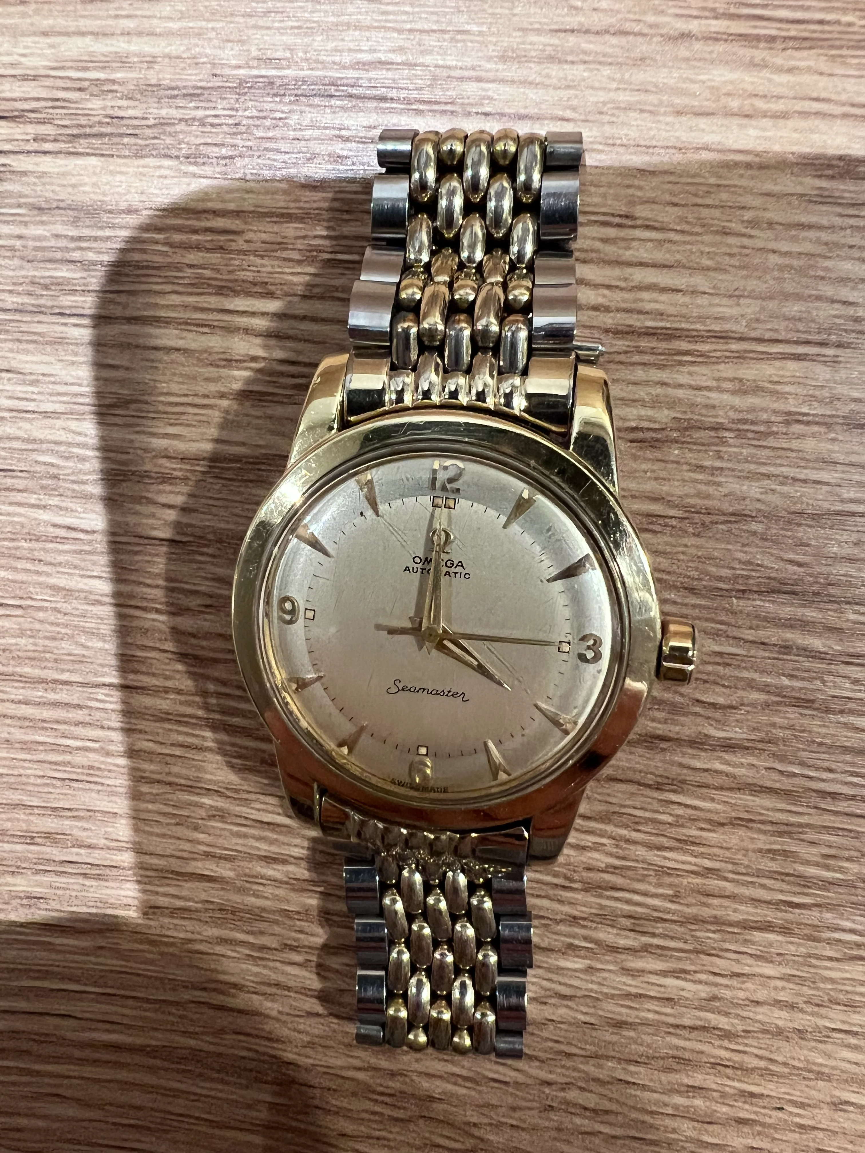

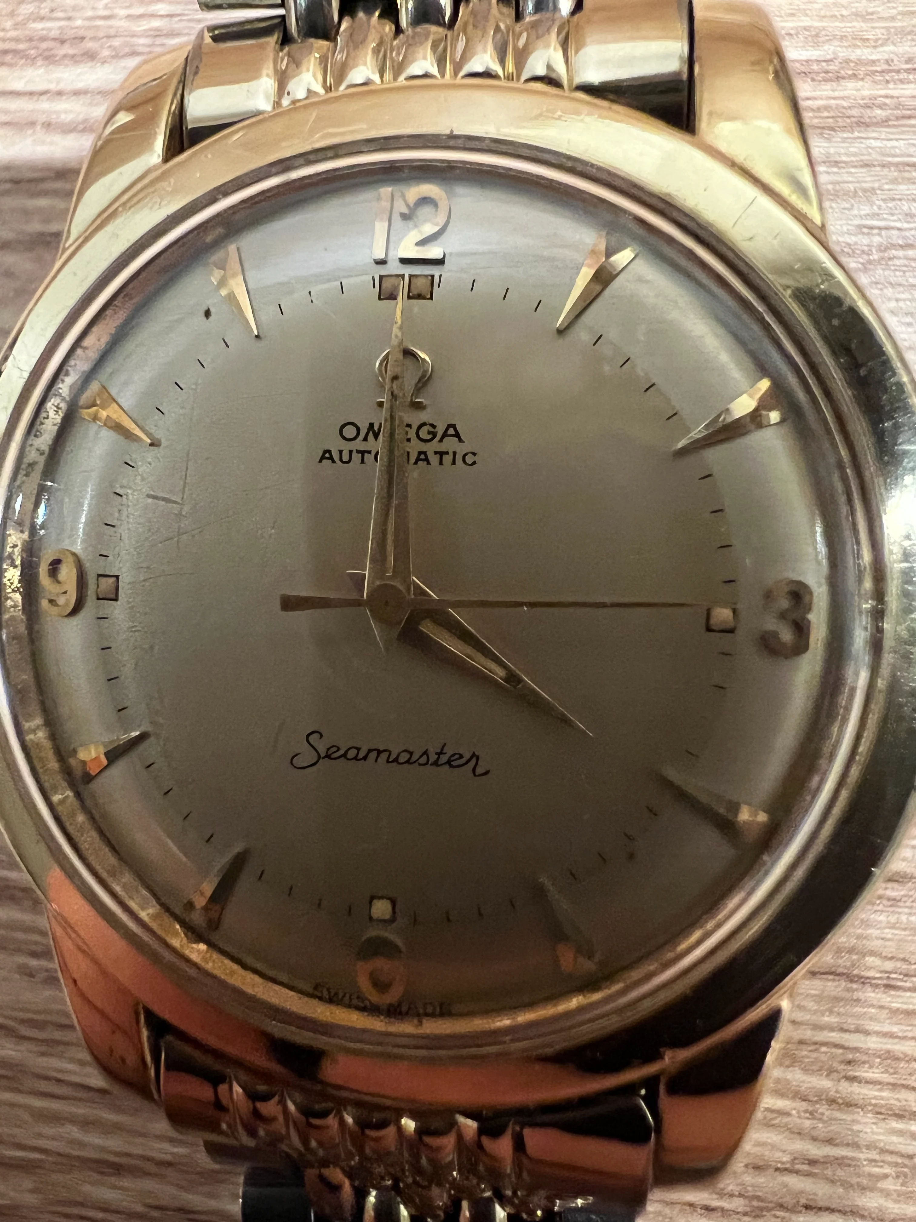

Hello everyone,
Recently I inherited an Omega Seamaster from a great uncle who passed away. I've been searching all over the internet to indentify the watch, I have seen some models that are ALMOST identical, but not 100%. A rare thing to find for me is the small squared next to the numbers on the dial, combined with the two tone dial with gold colour on the inner circle of the dial. The rice-bead bracelet says gold plated 20 micron, but there is no serial number inside the bracelet. My great uncle was always careful and I think it's visible that it was always handled with care.
Do you have any ideas? I'm really interested from what year it is and what model it is.
Let me know!

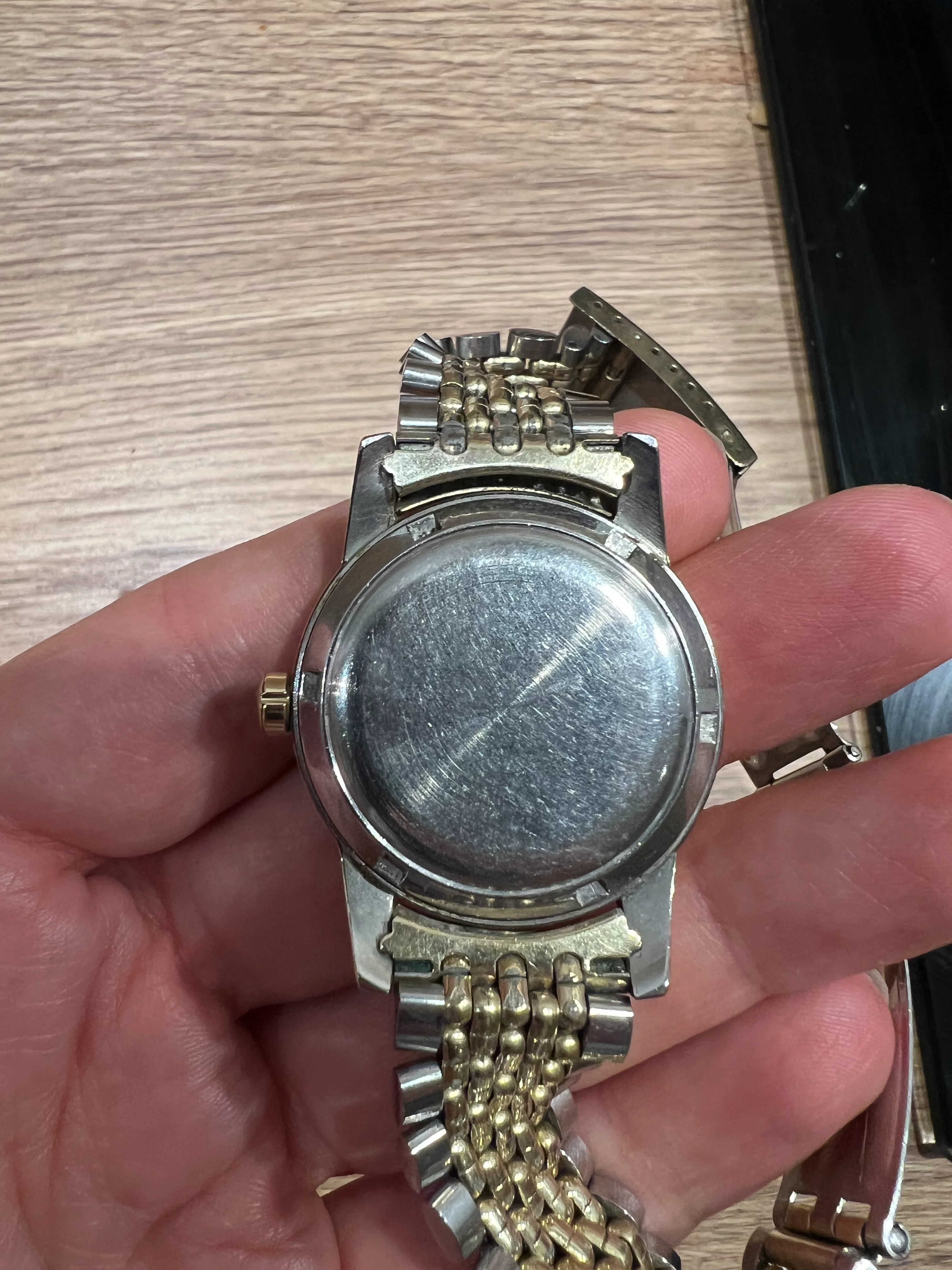

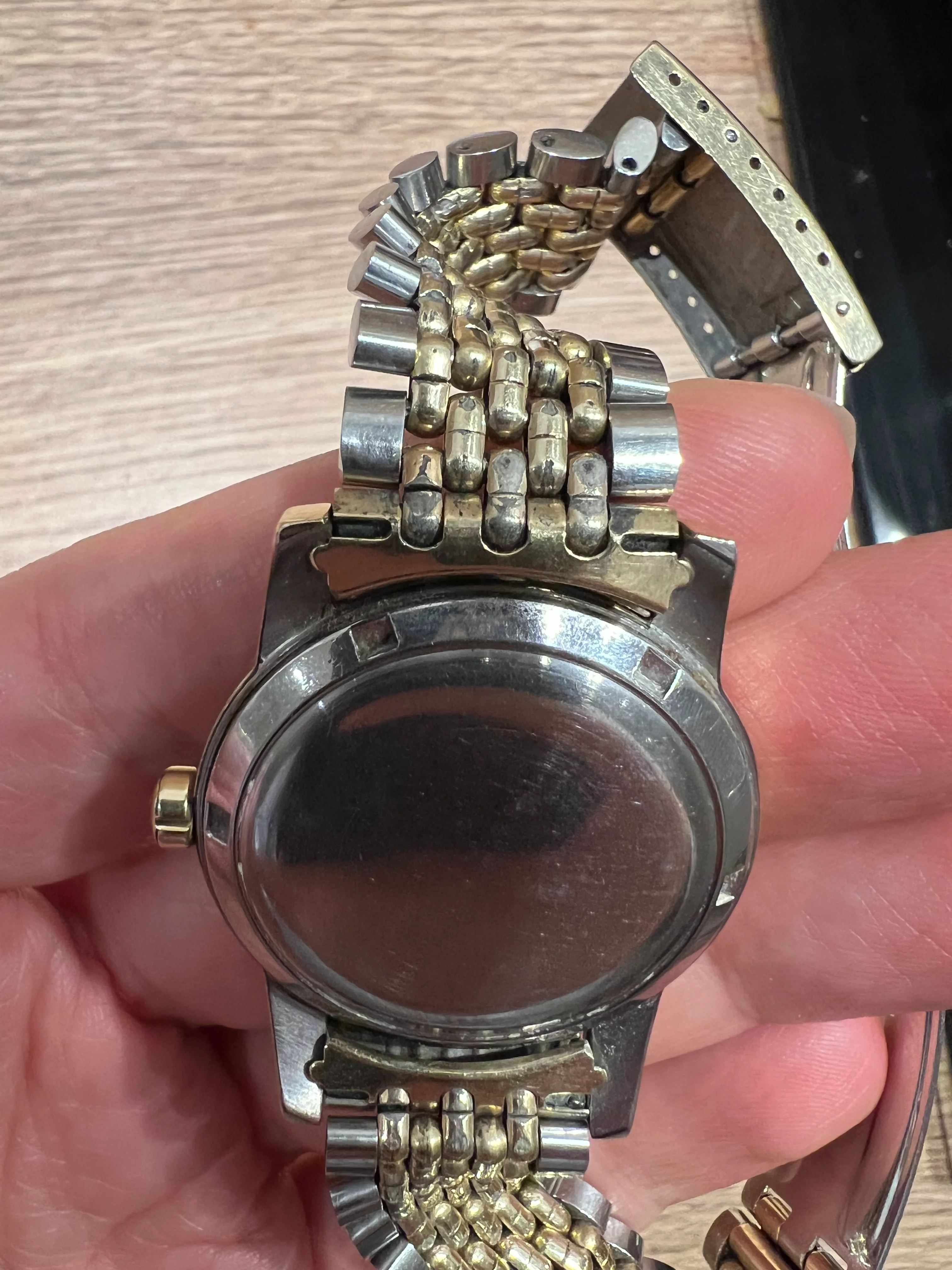

Here are some photos of the back of the watch.
13,505
31,839
Looks like a 2577.
24,847
55,283
Looks like a 2577.
I agree.

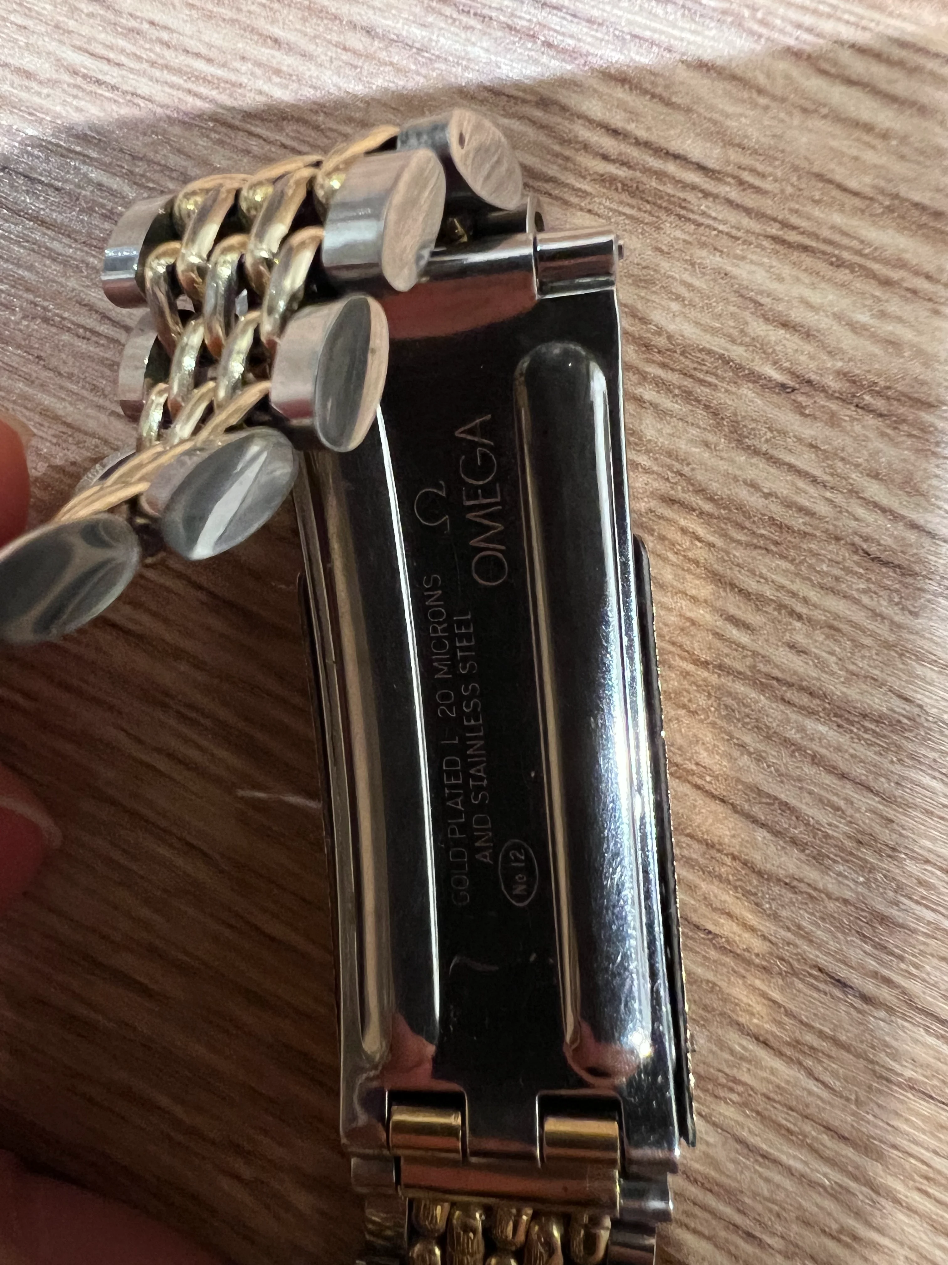

OP, this is known as a gold-capped case, with a shell of gold bonded to a stainless mid-case. You can see the stainless from the back of the lugs. The thick layer of gold holds up to wear and tear much better than a gold-plated/filled case.
The bracelet is, of course, gold-plated, and you can see the wear on the back side of the links. I honestly don't know if the bracelet is fully legit, since most Omega endlinks have a number engraved on the back. The clasp looks ok.
