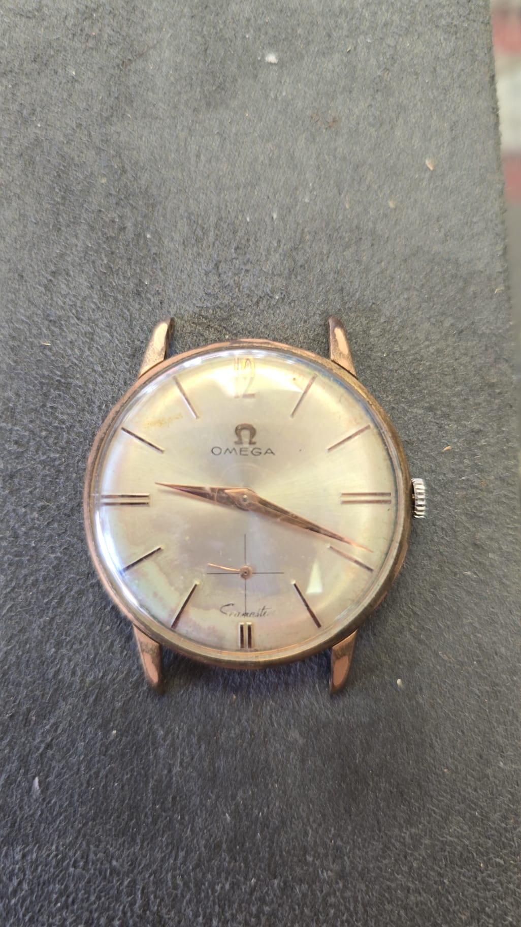

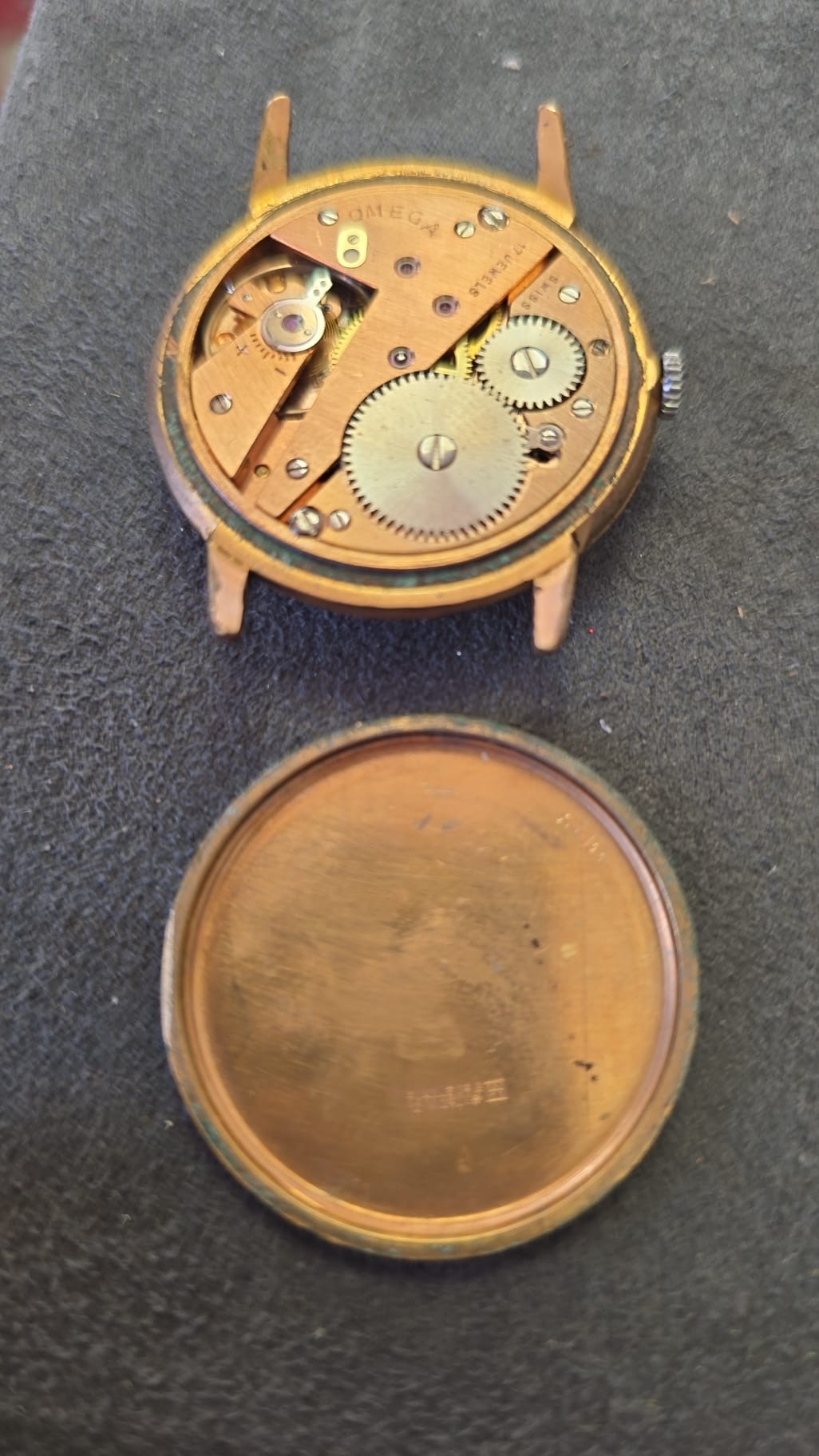

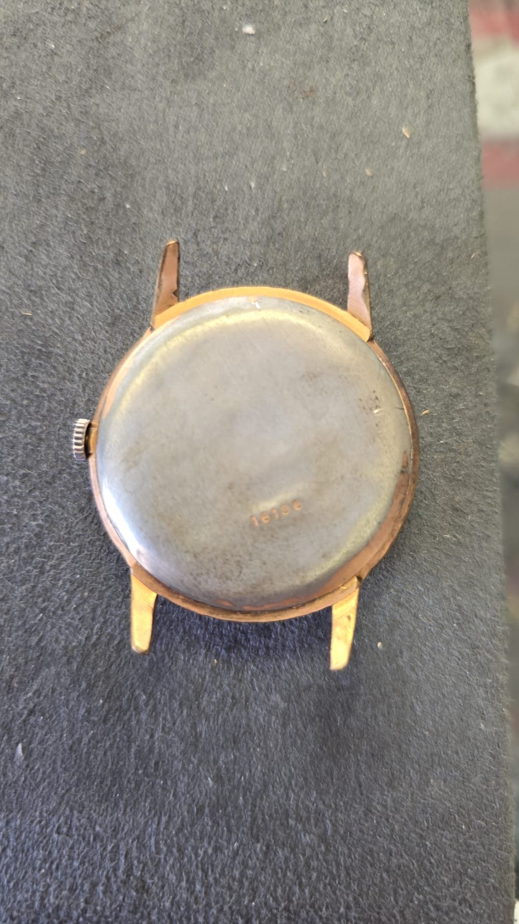

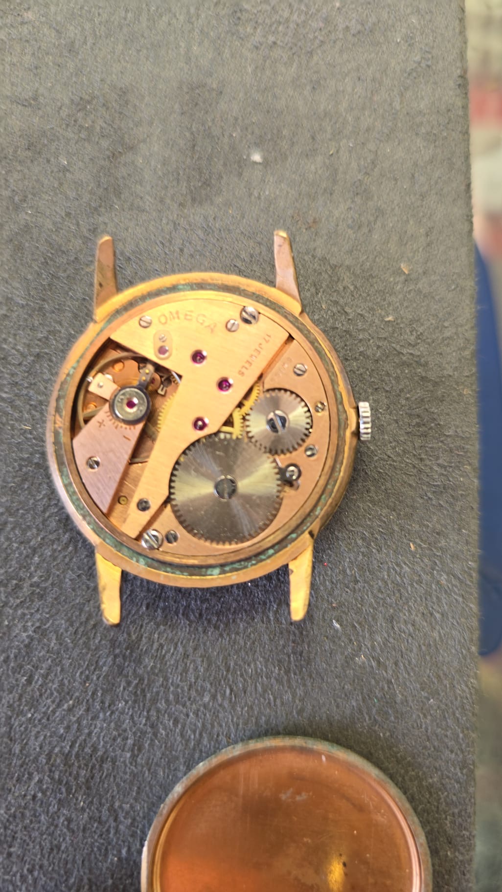

Hello, good morning. I am thinking of buying this Omega Seamaster watch from the 1950s. The number on the back of the case is 16186. Everything seems real and authentic to me, but the watch mechanism has no serial number, which I don't find very normal. Can anyone tell me if they have ever seen something similar or what they think of it?
3
Entirely fake.
Hey, thank you. Can you tell me where I can tell is fake? Just to learn for the future. 馃槉馃檶馃徎

Where would I even start.
Everything about it is completely wrong. Nothing to do with Omega. It鈥檚 not even slightly similar to an Omega in any way.

I don't know much about Omega watches but that's a AS 1130 (Adolf Schild) movement.
3,013
4,780
This is a pretty well known vintage fake. Usually they have the markings on the outside of the case back.

Thank you so much. I don鈥檛 know too much about Omega.
