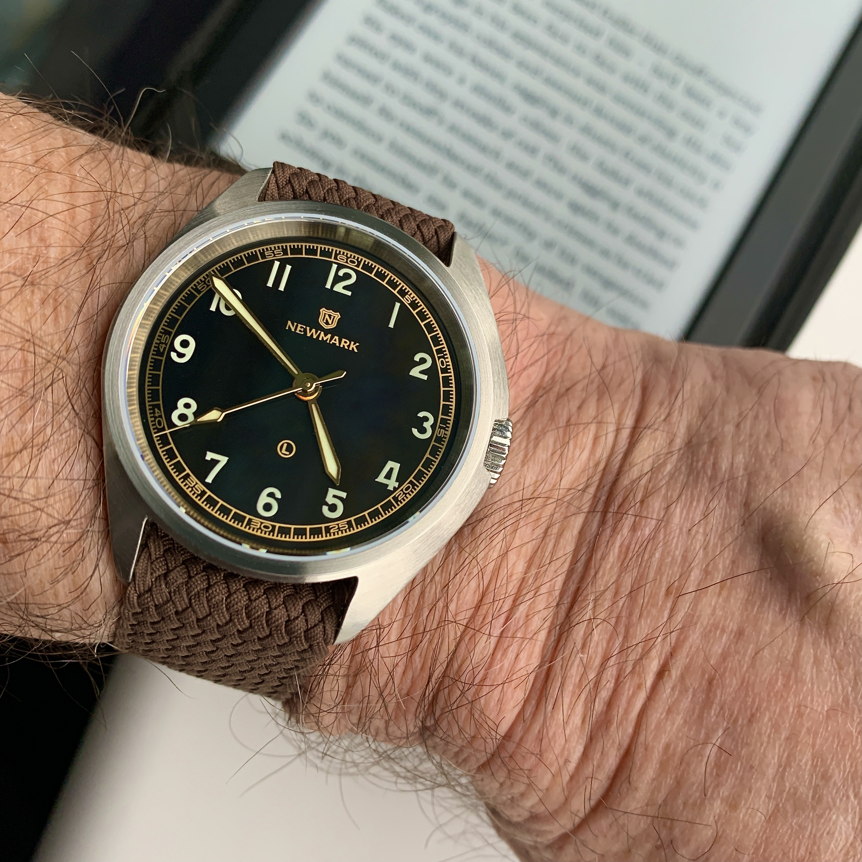

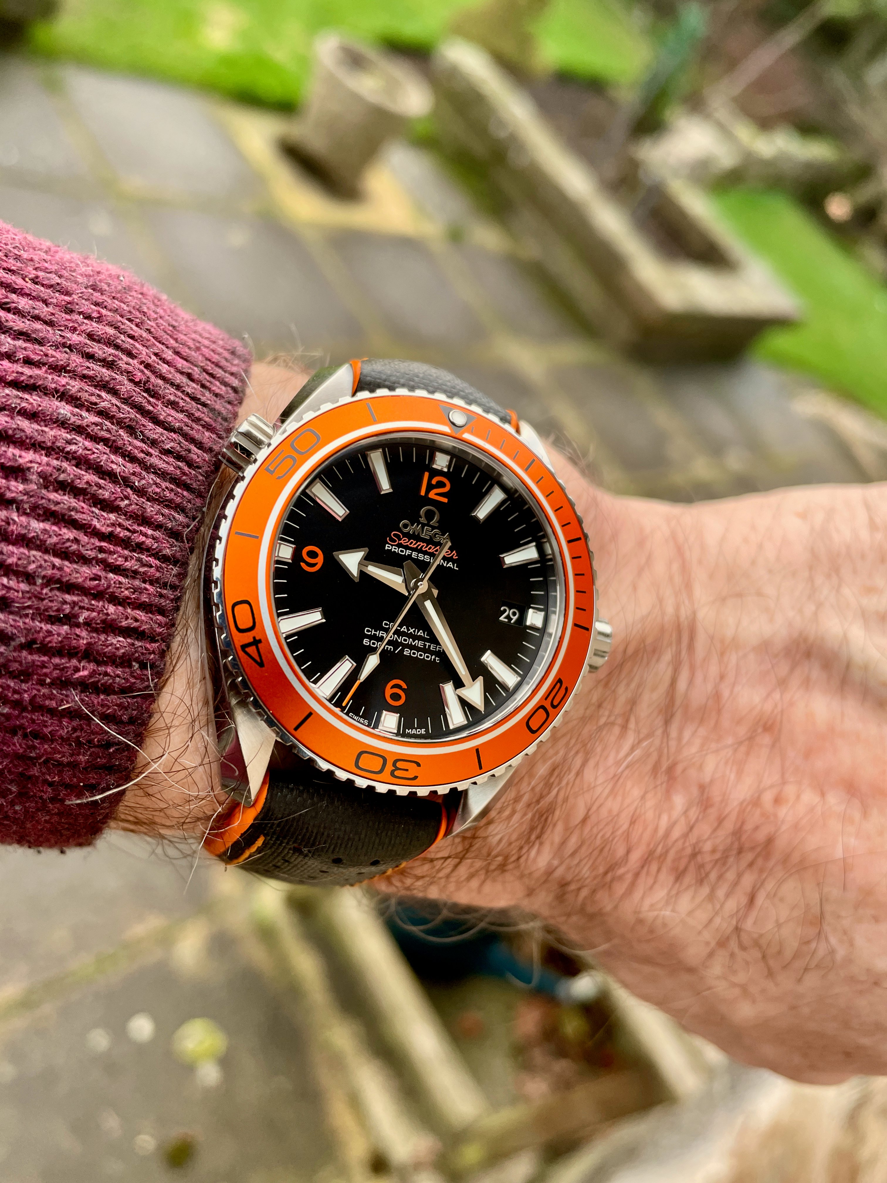

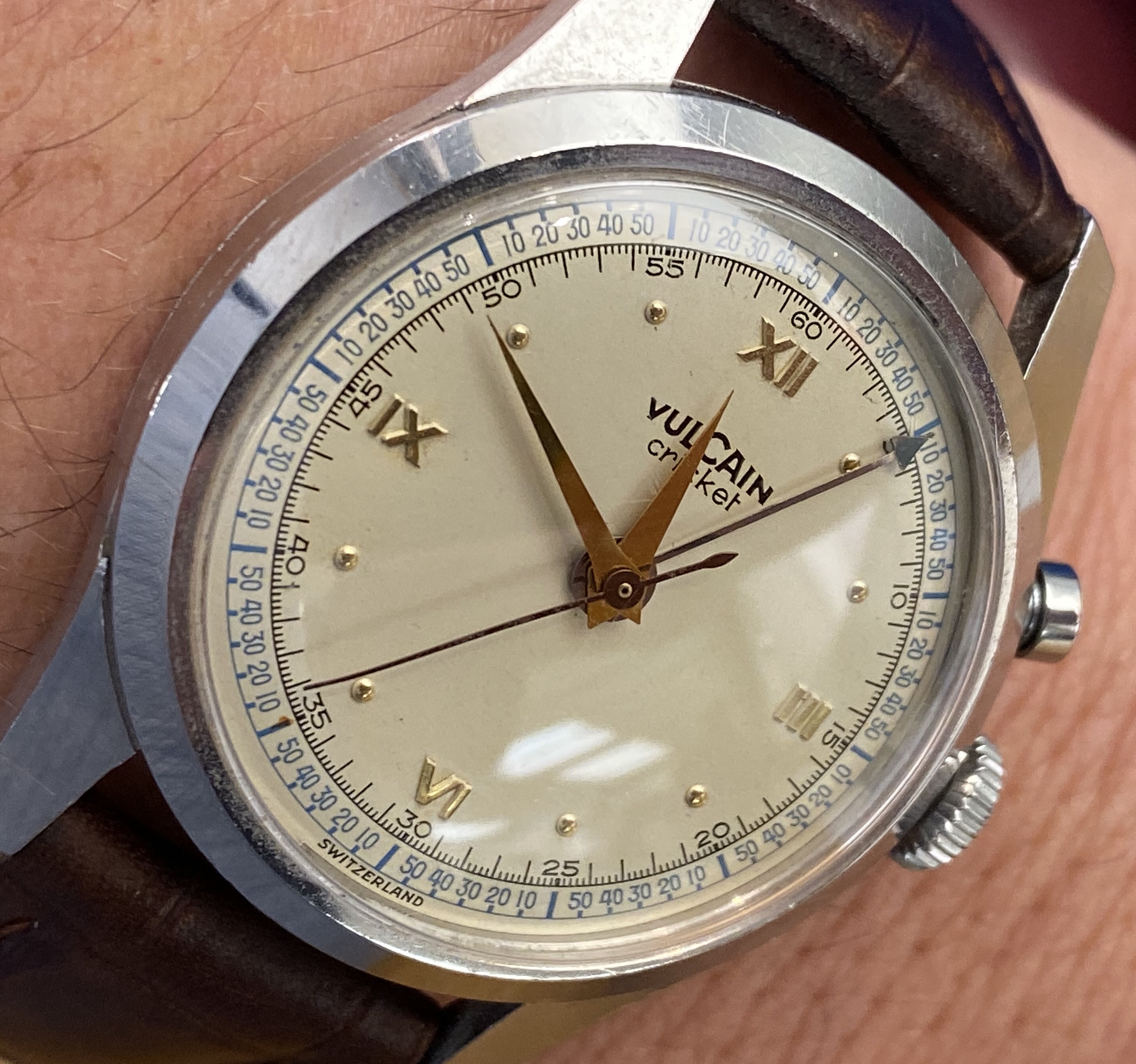

I took this picture of my Vulcain Cricket at the Apple store using the iPhone 11 (Pro?).
- Handheld
- Store lighting
- I have some tremor
- Straight shot (no image post-processing)
I was stunned by the quality of the picture.
Wow, maybe the most beautiful vulcain cricket ever seen! Congrats.

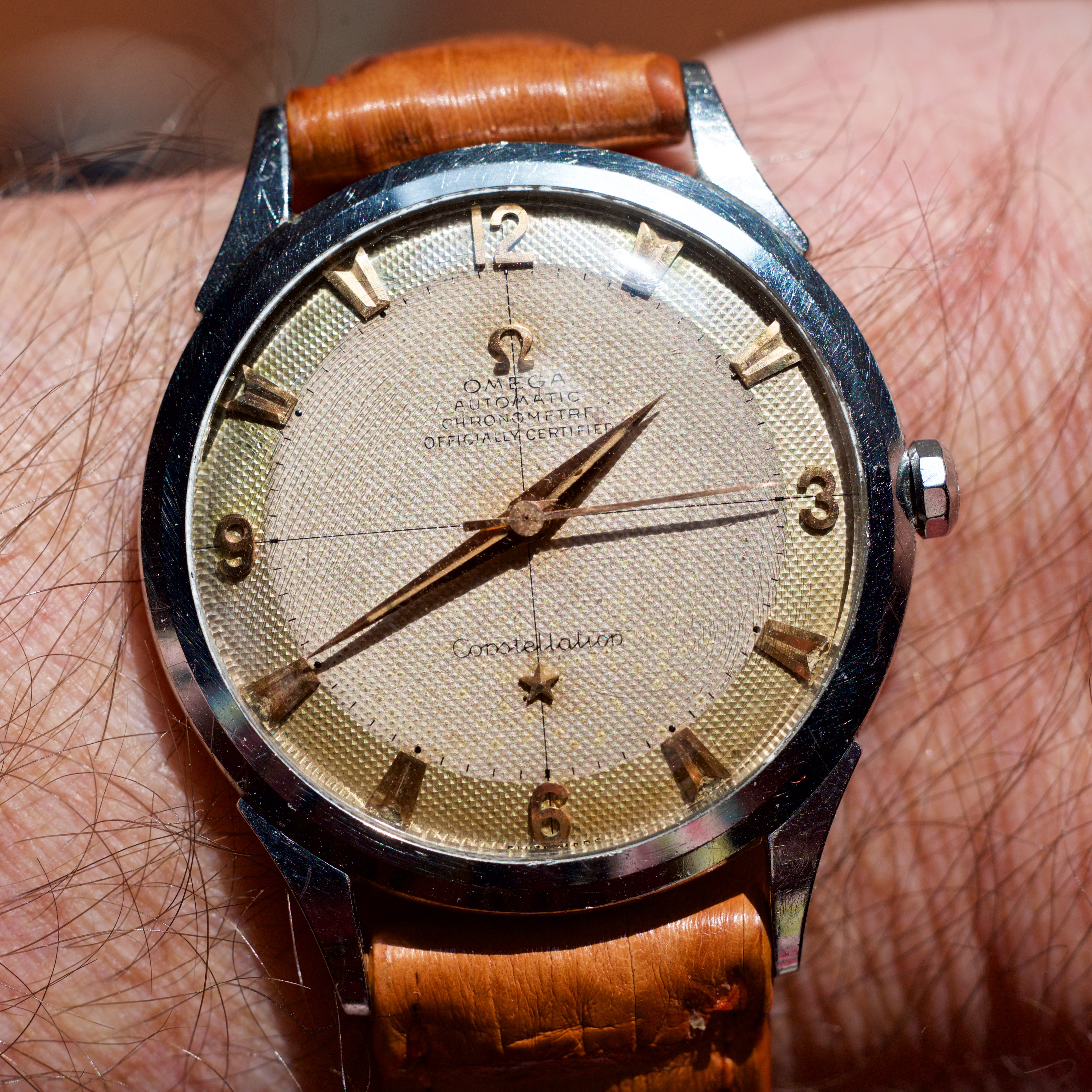

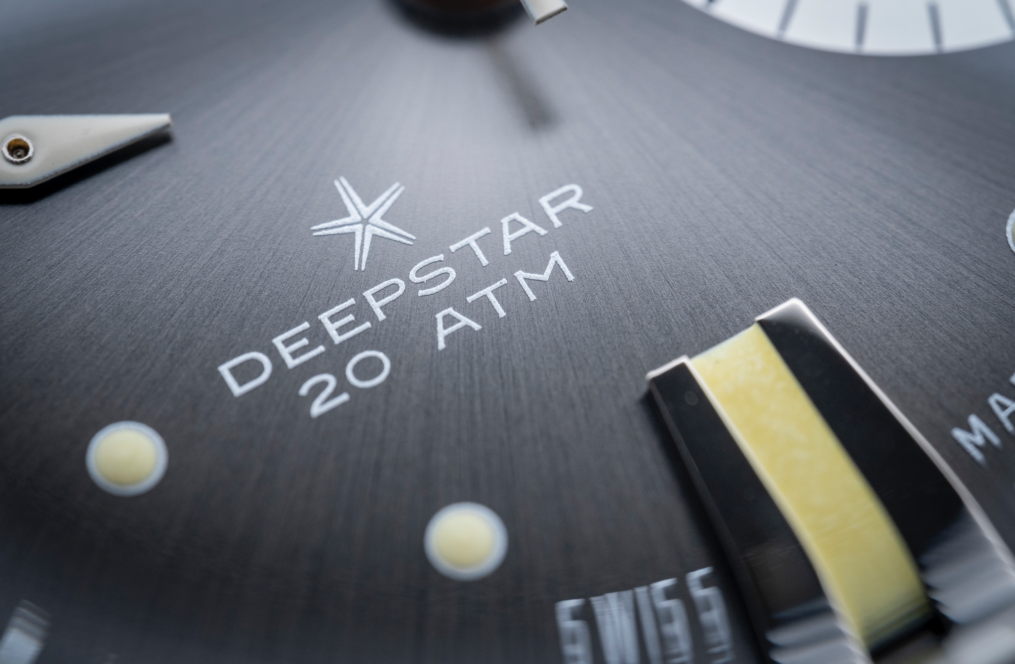

Just got Laowa 65mm f/2.8 2x macro lens. Manual. I use it with Fuji X-T4. One sample I took another day. It can focus very closely.

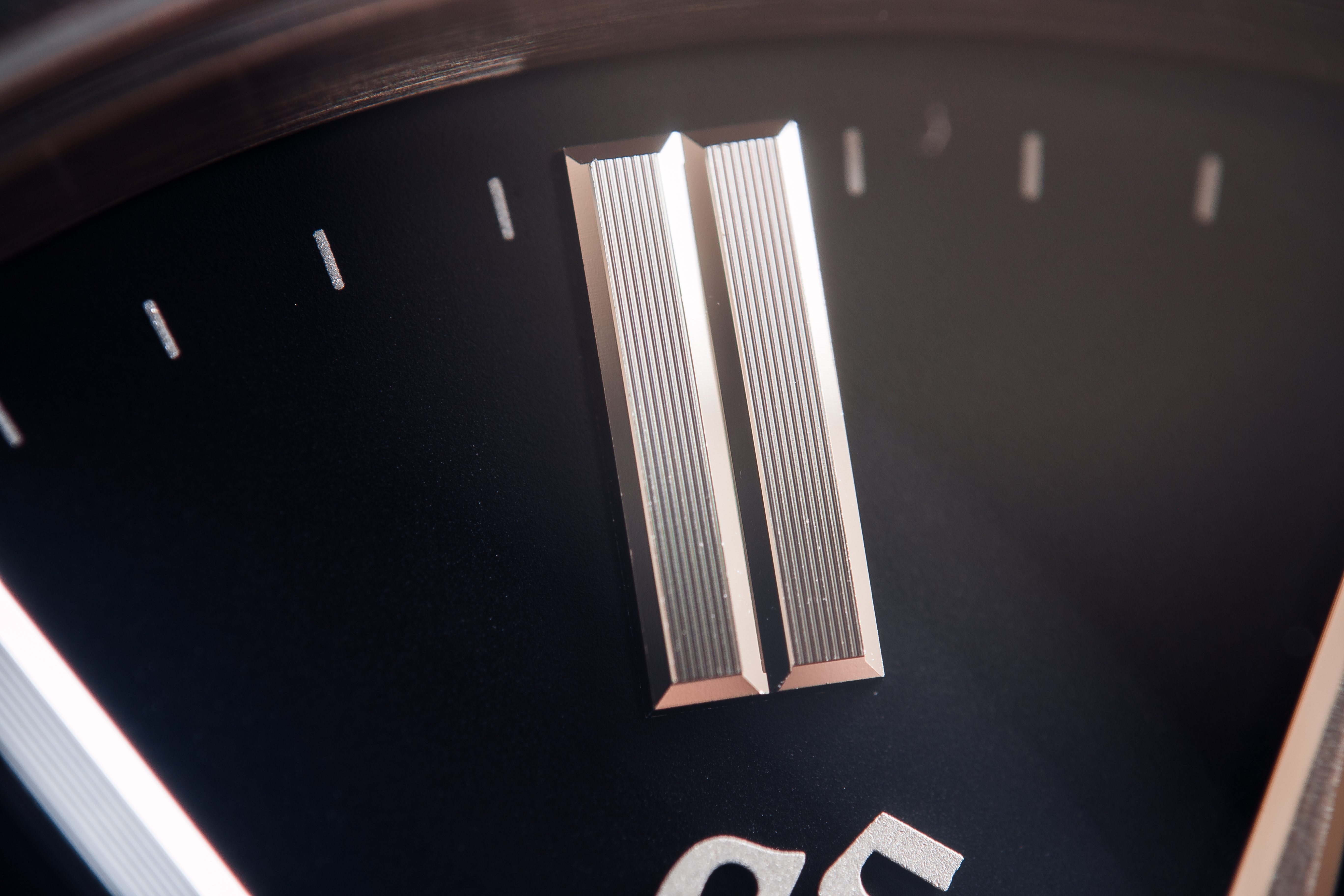

What I can't recommend enough are reverse rings, allowing to attach the lens the "wrong way around". Takes some practice, a good tripod and tons of light, so nothing to do at night or in a hurry.

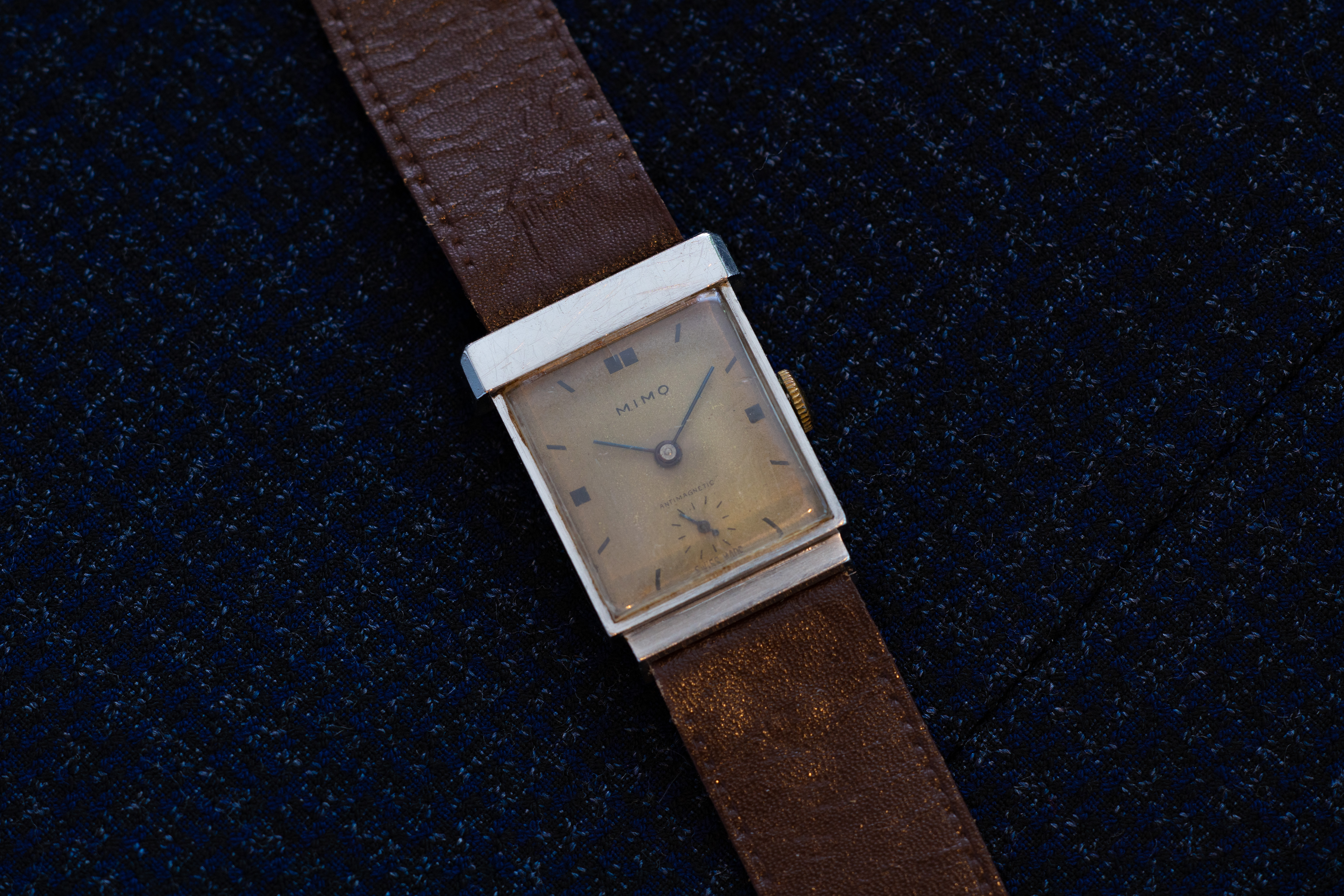

The photos were taken with a Canon 24mm 2.8 on either a 7D Mk. II or a 70D, can't quite recall.

What I can't recommend enough are reverse rings, allowing to attach the lens the "wrong way around". Takes some practice, a good tripod and tons of light, so nothing to do at night or in a hurry. (...)
I often use my 50/1.4 handheld and reverse-pointed as a high-resolution loupe. Very effective.
40
62
@felsby I also do own that exact lens and also shot freehand before I got the reverse mount. It really is great as a loupe. For me the 15 bucks for the reverse mount really were worth it, as there are less distortions and, if you also want to take pictures, you can use a tripod. By the way if you have a more wide angle lens, the magnification will be even greater, though the depth of field way more shallow. That's the point where you really can't go without f/22 and a tripod 😁

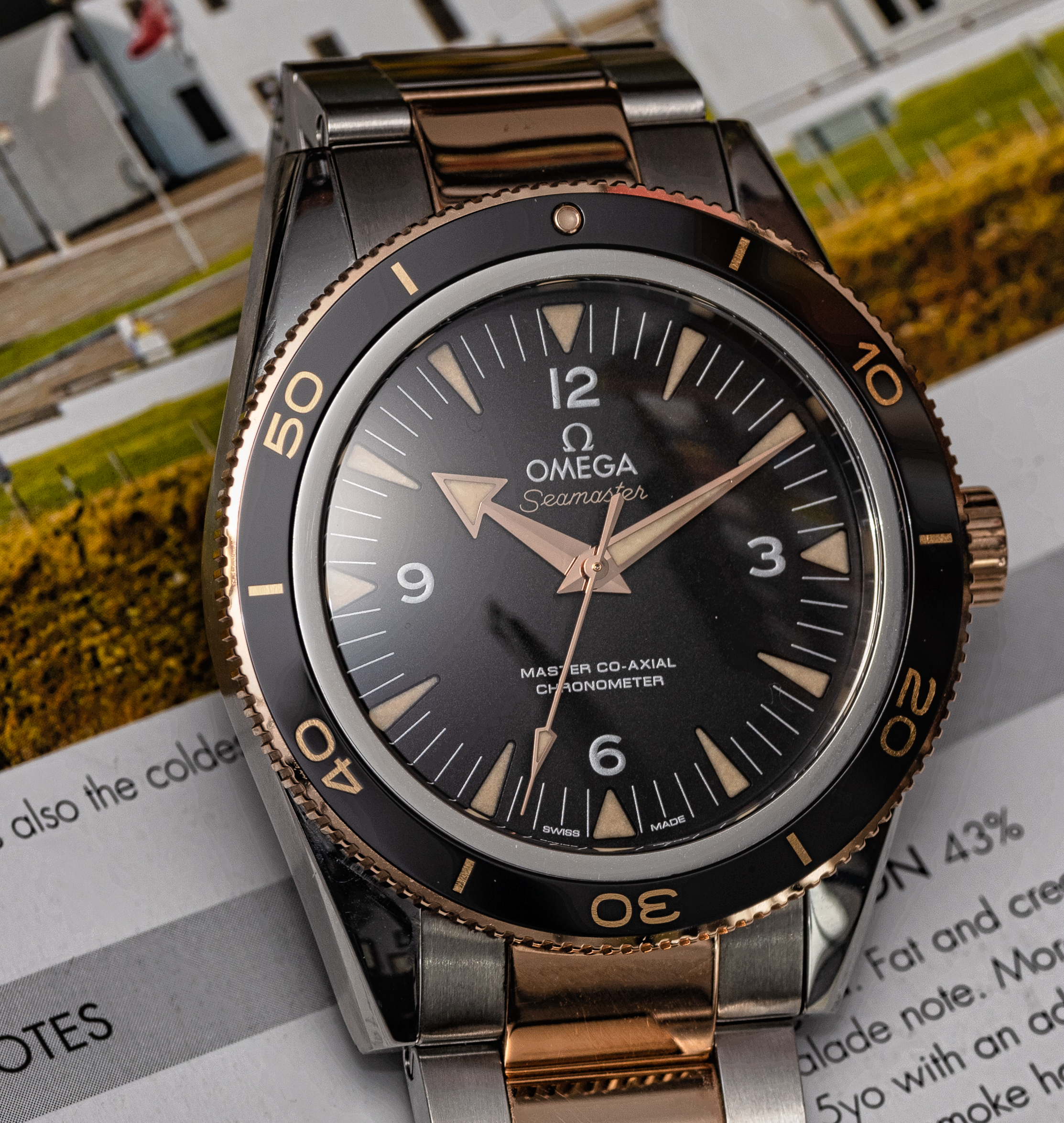

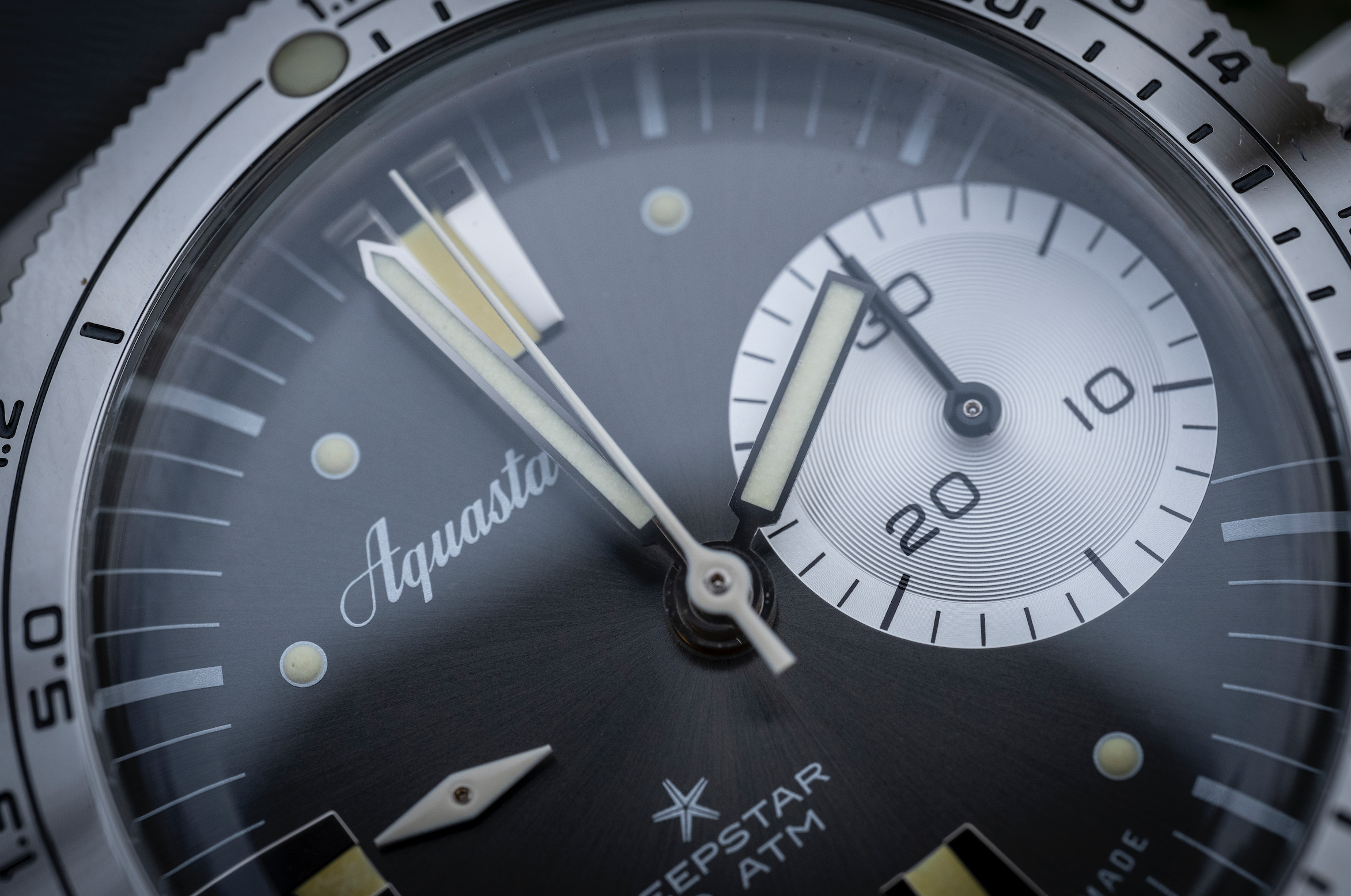

I use an Olympus M.Zuiko Digital 60/2,8 Macro with my Olympus E-M1 Mark III. A nice thing with that camera is that it has built-in functionality for automatic focus stacking (Olympus calls it "focus bracketing") of up to 15 pictures. This picture is unfortunately not a focus stacked one as you all can see:

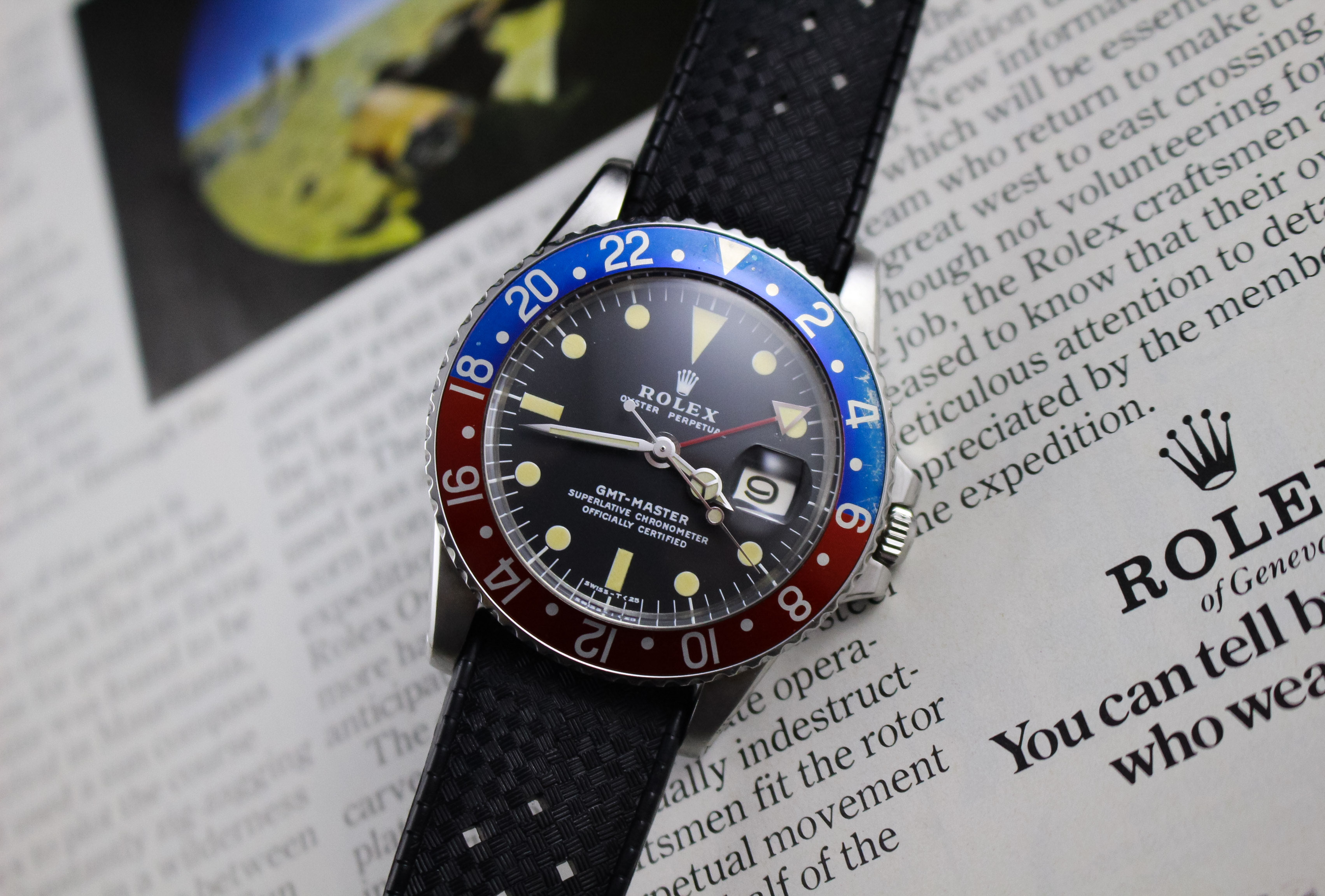

I took this with my samsung galaxy s20...
my canon 100mm macro takes a better photo but this is pretty decent for macro...

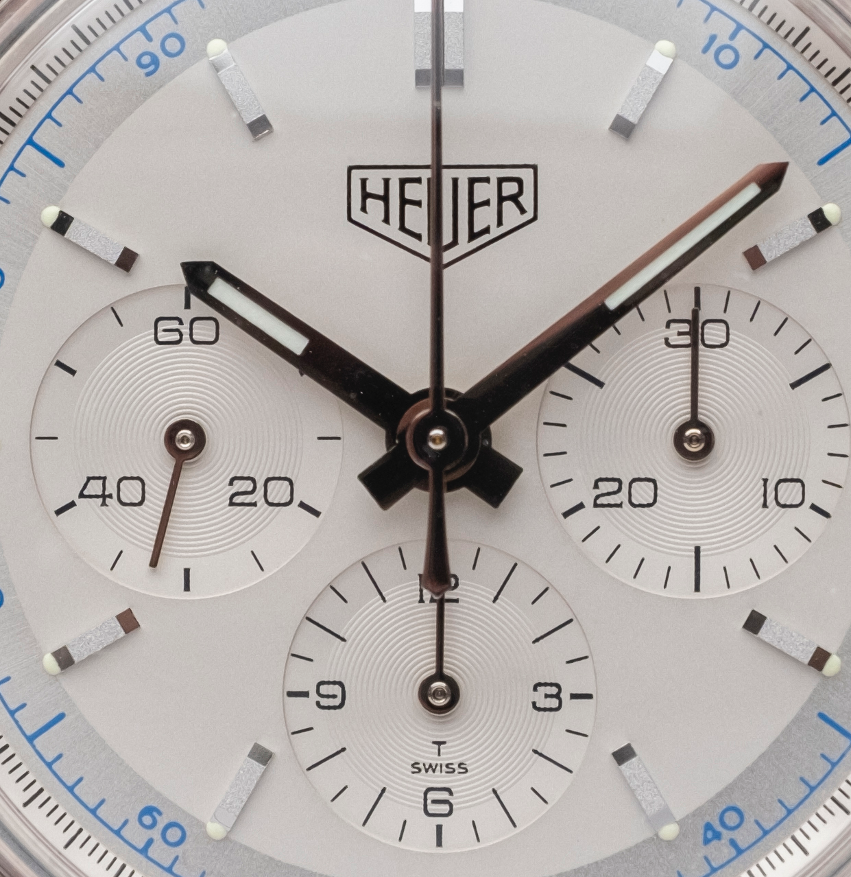

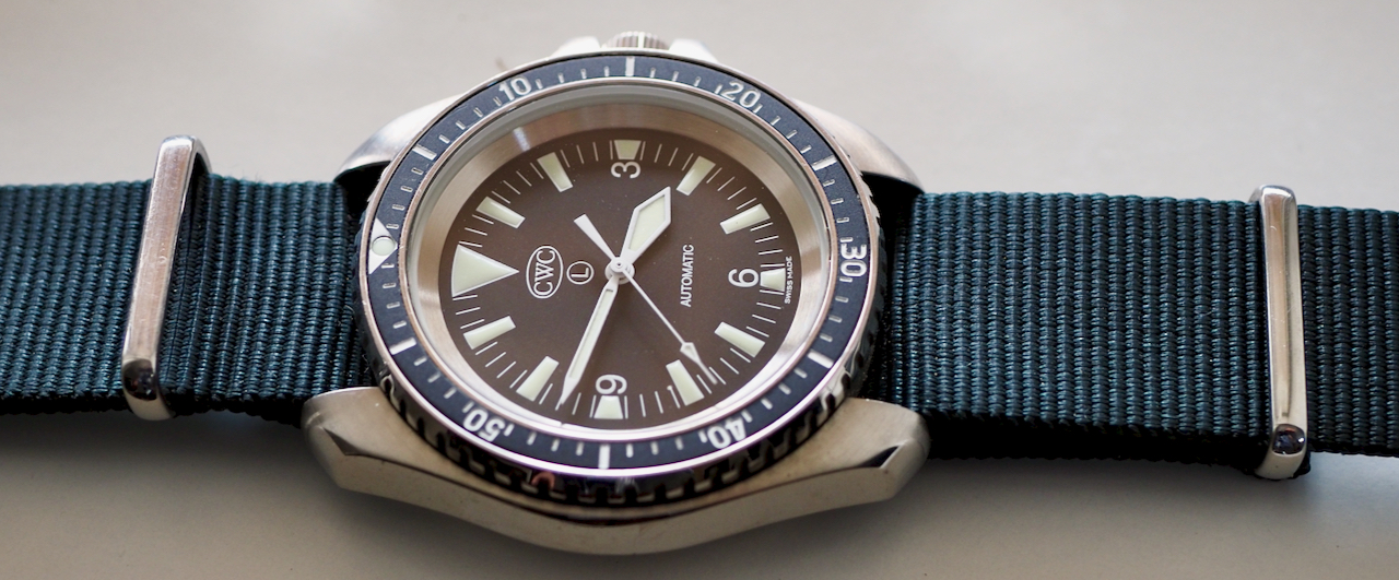

1970's Canon FD 100mm Macro on a SLR Sony body
dsc08138-jpg.1363350
17,419
164,725

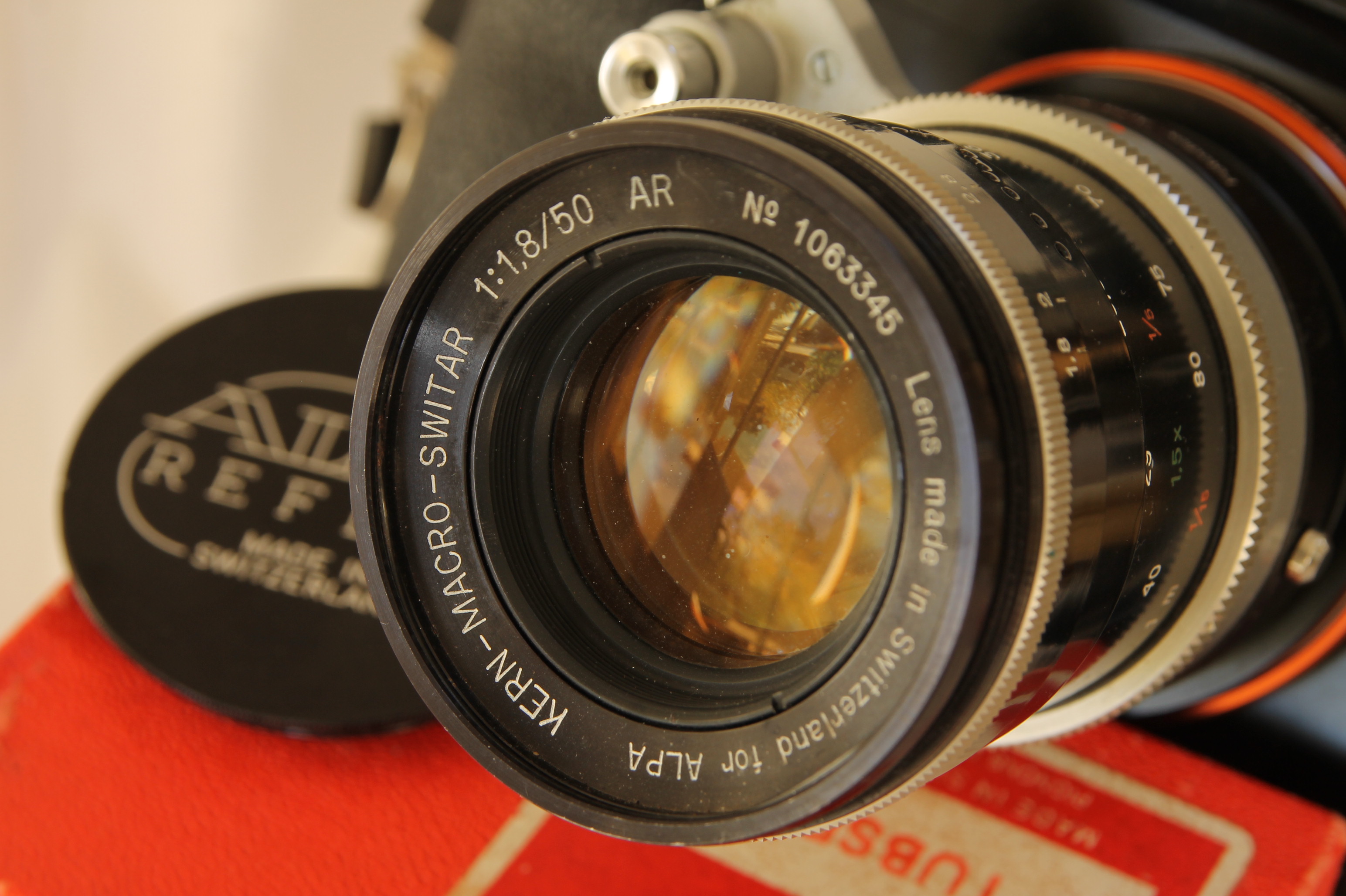

Probably the best lens that gives the vintage image is the Kern Macro Switar 50mm 1,9 or the 1,8 either one is fine. it's the fastest macro lens ever in 50mm. it was made for the Alpa cameras, and adapter rings are available to fit modern digital cameras

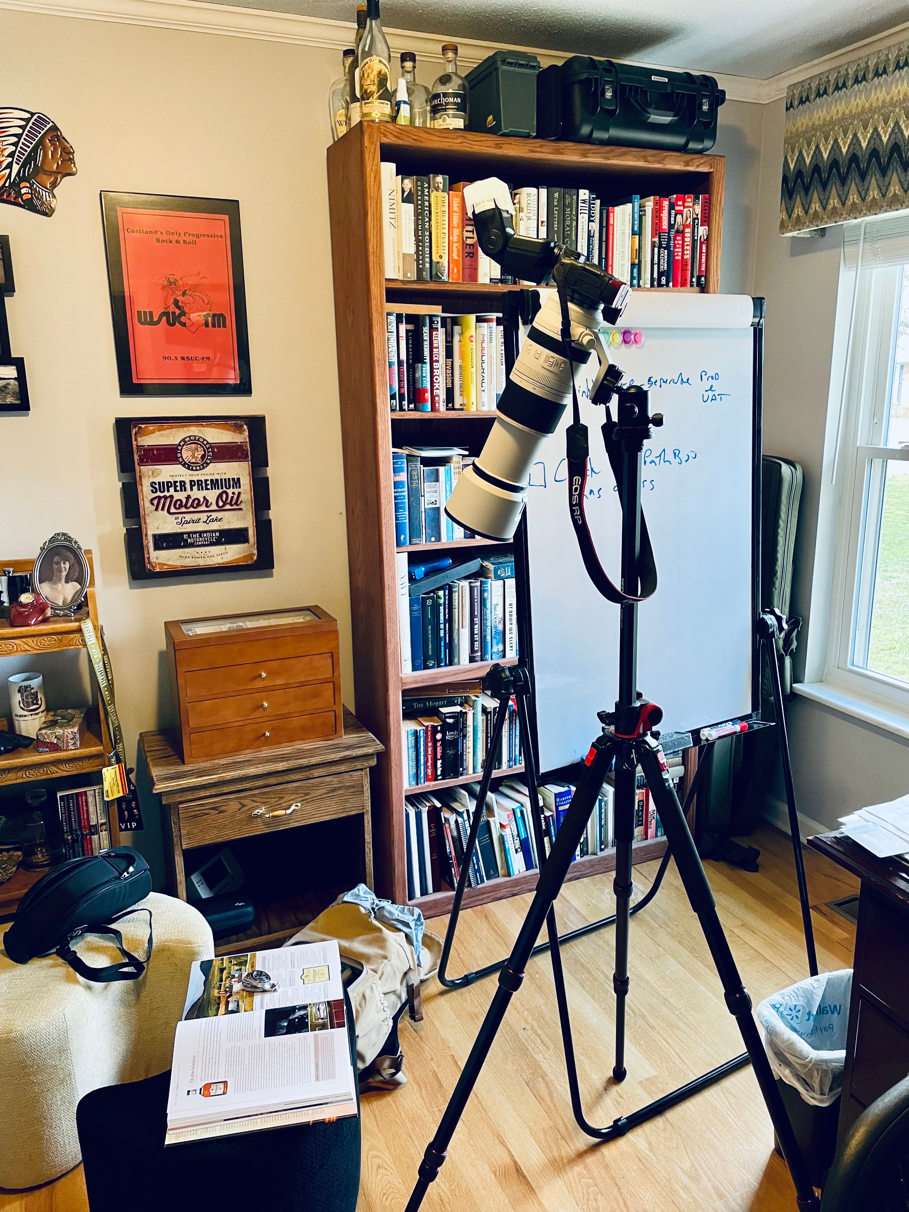

I have a 16mm f2.8 and a 50mm f1.2 (primes). But today I tried something different and shot macro with the Canon RF 100-500 L. Using a telephoto that focuses (relatively) closely yields interesting results.
