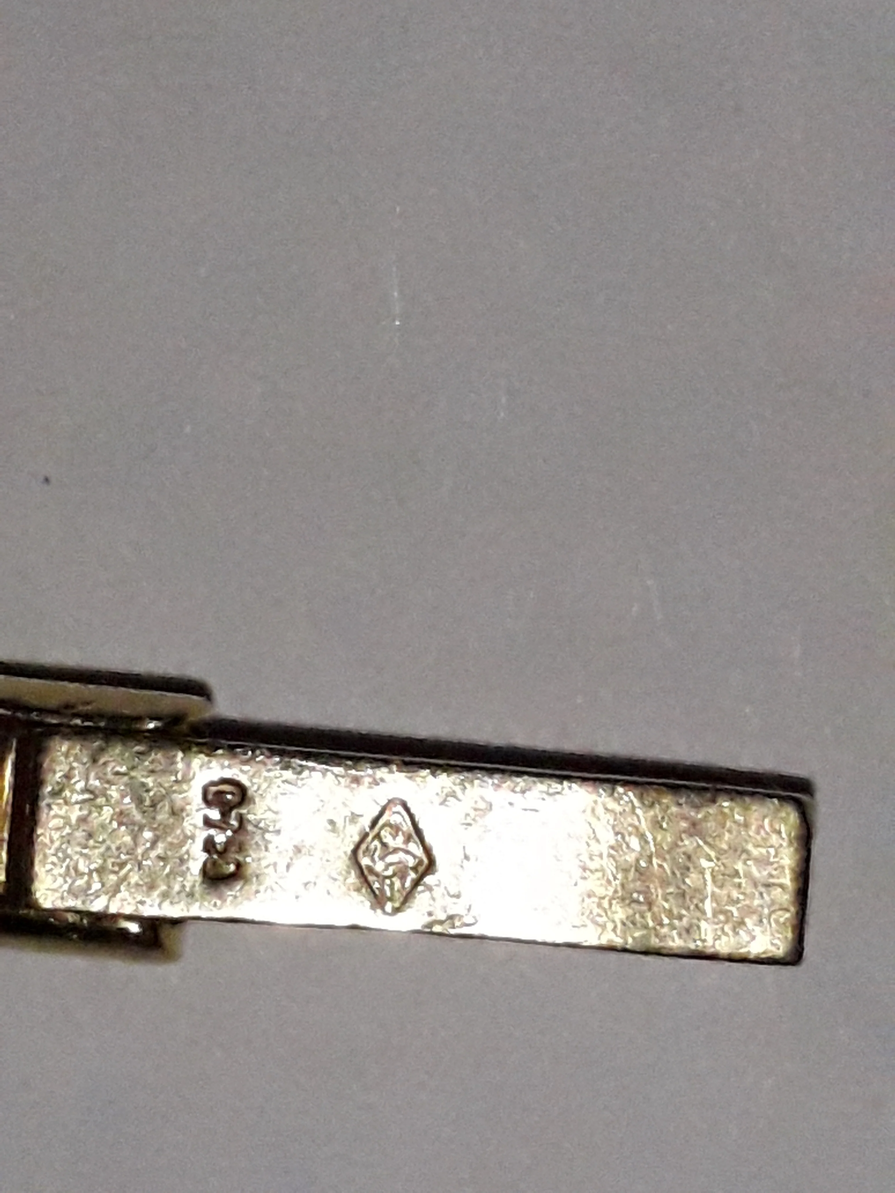

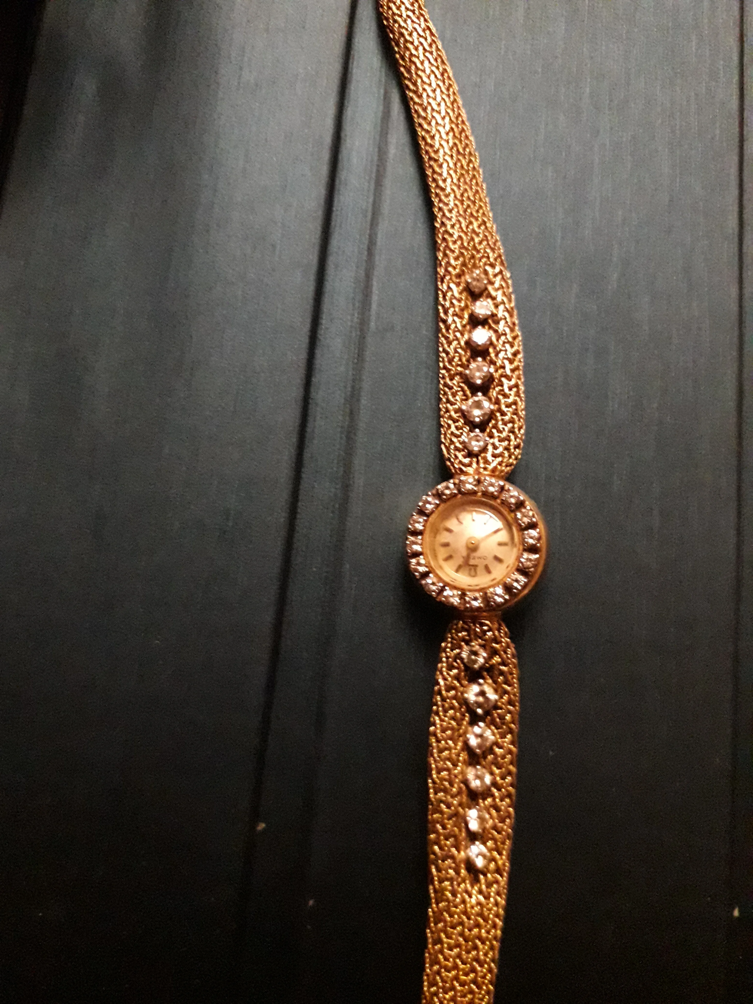

I received this watch from my grandmother il 90's but I can't find its model. Its serial number is 11392920. Here is its photo and that of the hallmark.

Your pictures are not a large help in giving you answers. But I can see the Omega symbol on the dial. This is a very tiny watch in the style of a “cocktail” watch. The stamping on the buckle is .750 which is 18 karat gold. Your picture of the watch is not a great help, but I have a suspicion the stones are diamonds. Notice the absence of a crown (winding button) on the case edge. This watch likely has an Omega calibre 640 movement in it. This calibre movement is of the “back-wind” type. That is, the winding crown (also used for setting the hands) is on the back of the case! The size of the crown should be such that the knurling on the crown is near the edge of the case back, to facilitate winding. That crown is pulled outward to engage the hand setting. If I am correct, don’t let anyone convince you that its only value is for the “melt” value. This was a very expensive watch in its day. Try to find someone in your family, or a friend, who would enjoy having it.

I’d love to see a pic of the back of this watch
18,836
39,173
I be satisfied with a focussed, close enough to identify type pitcher.
2,346
1,475
Nice cocktail watch for a dinner out or dressy evening event etc. not a work watch
Omega made a lot of ladies cocktail watches. You need a watchmaker to remove the back and get the reference number. Can then search with that. However. Unless someone posted that reference number and image. You won’t find it on line.
