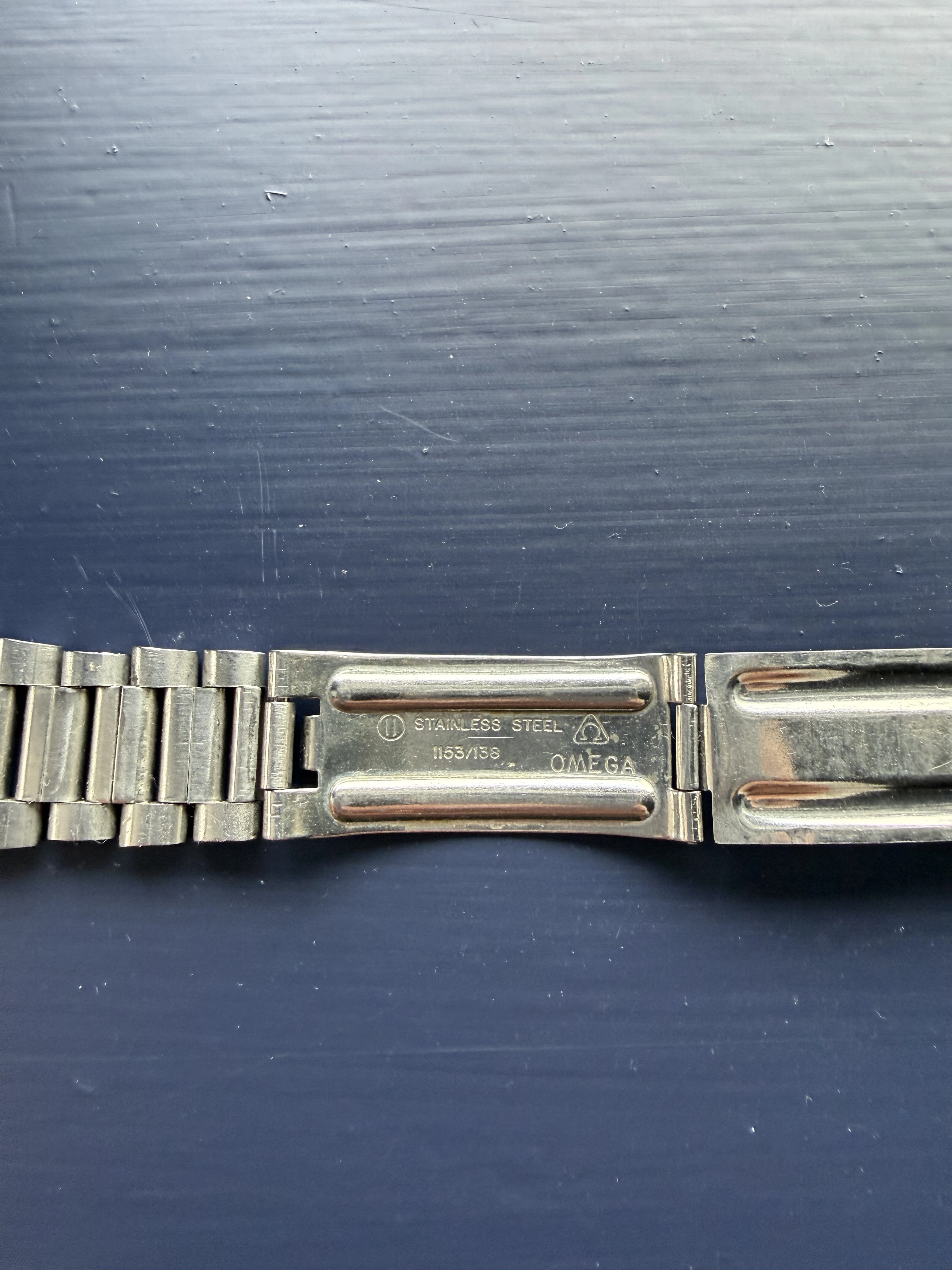

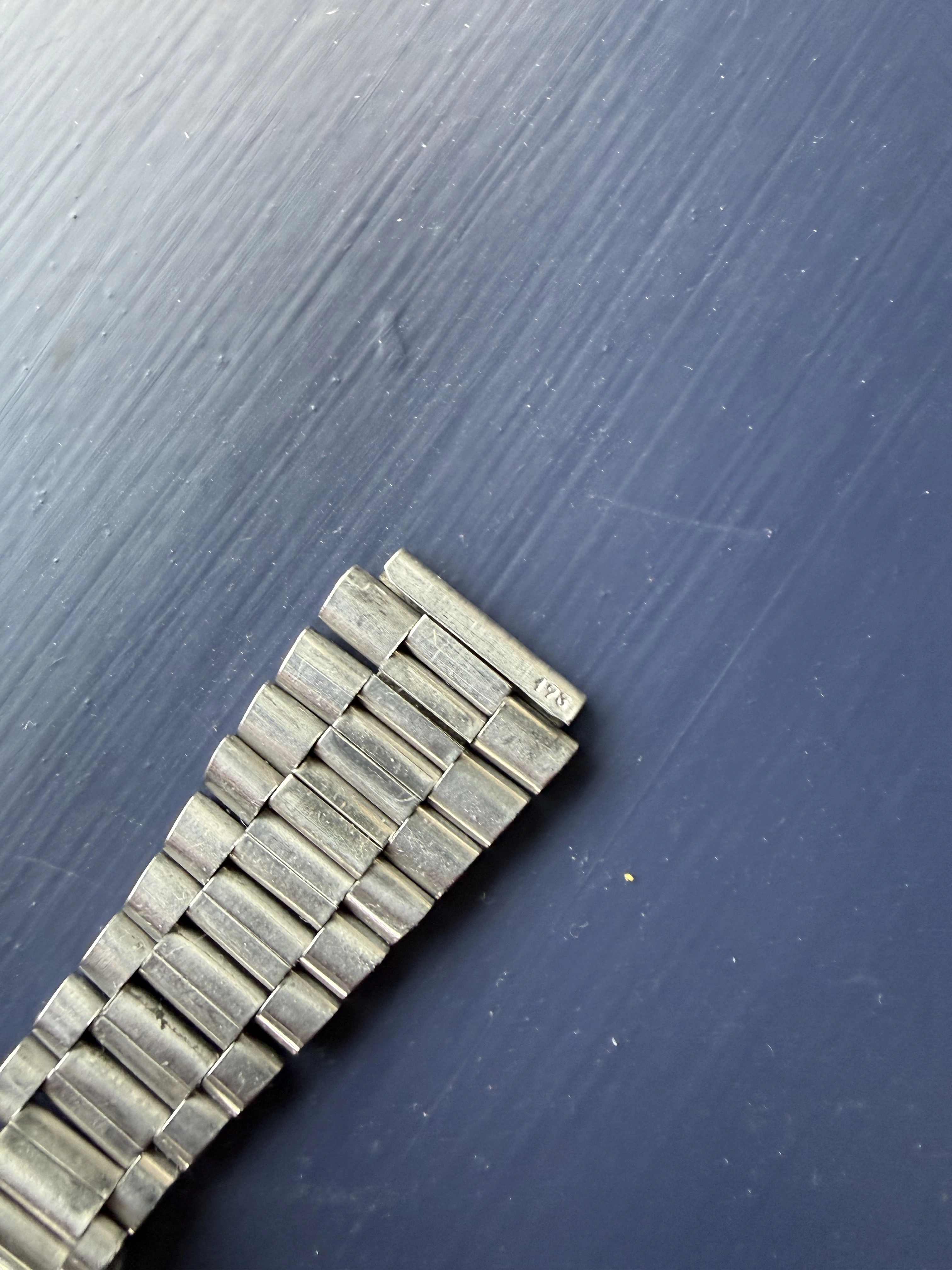

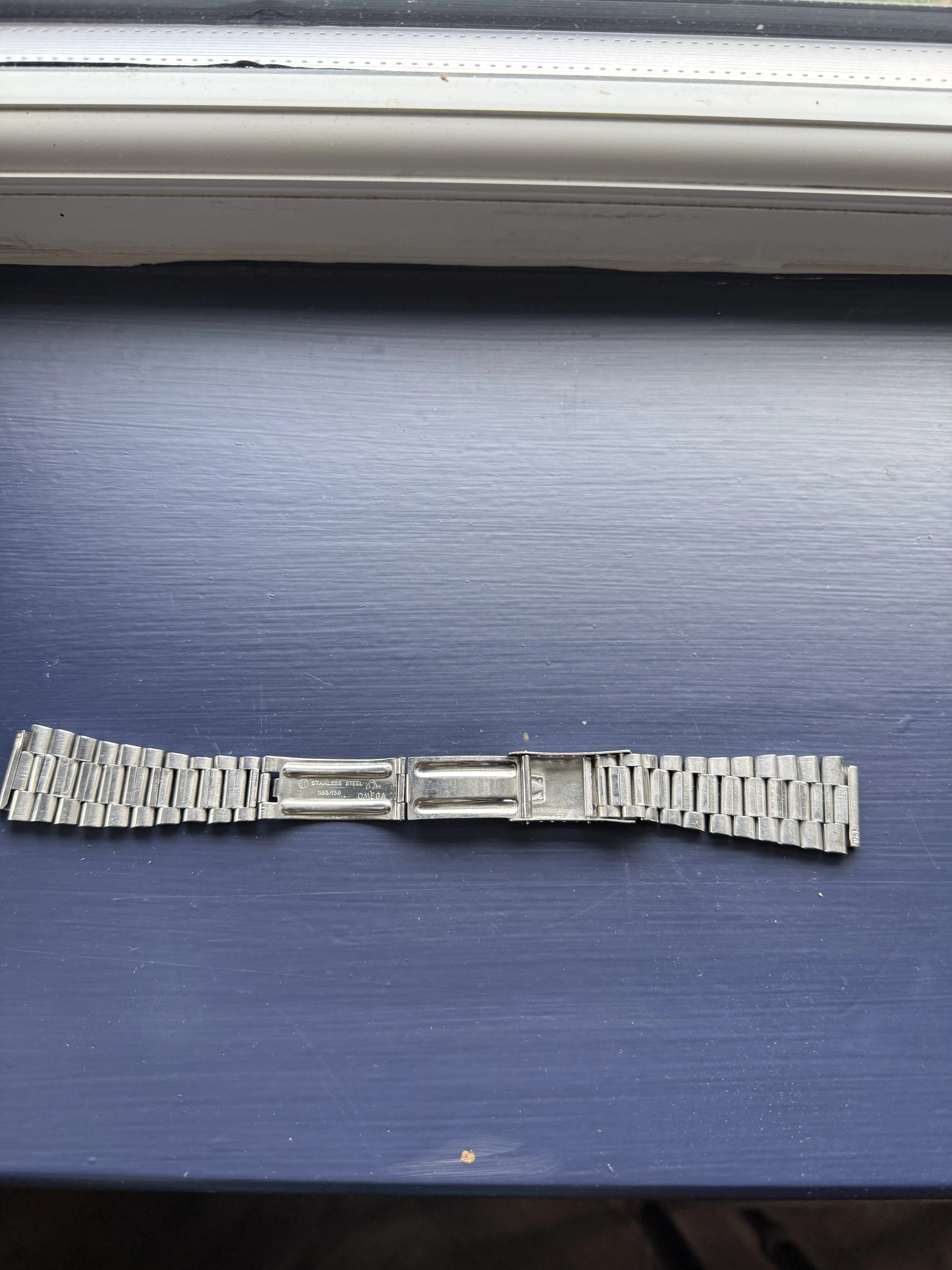

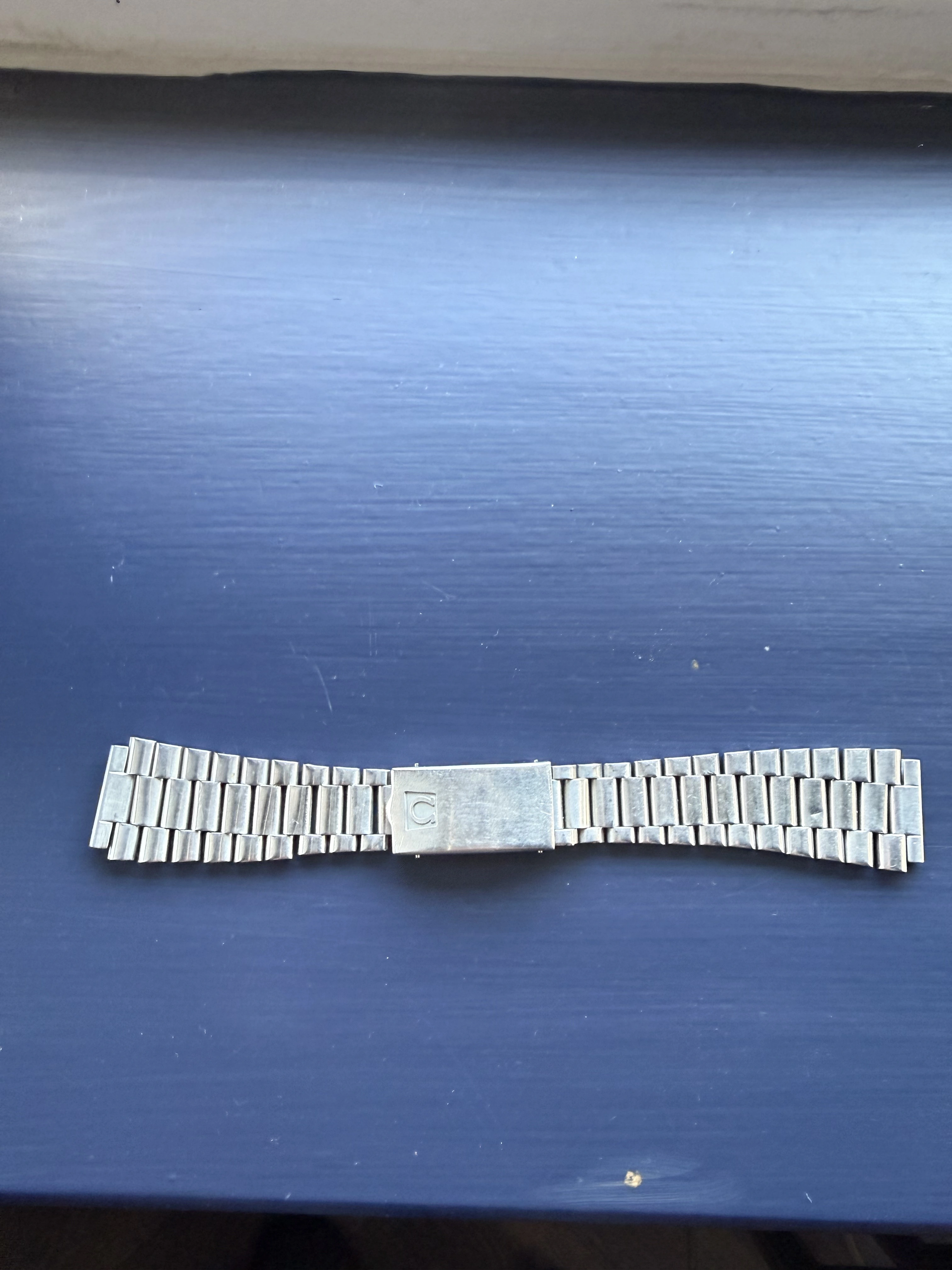

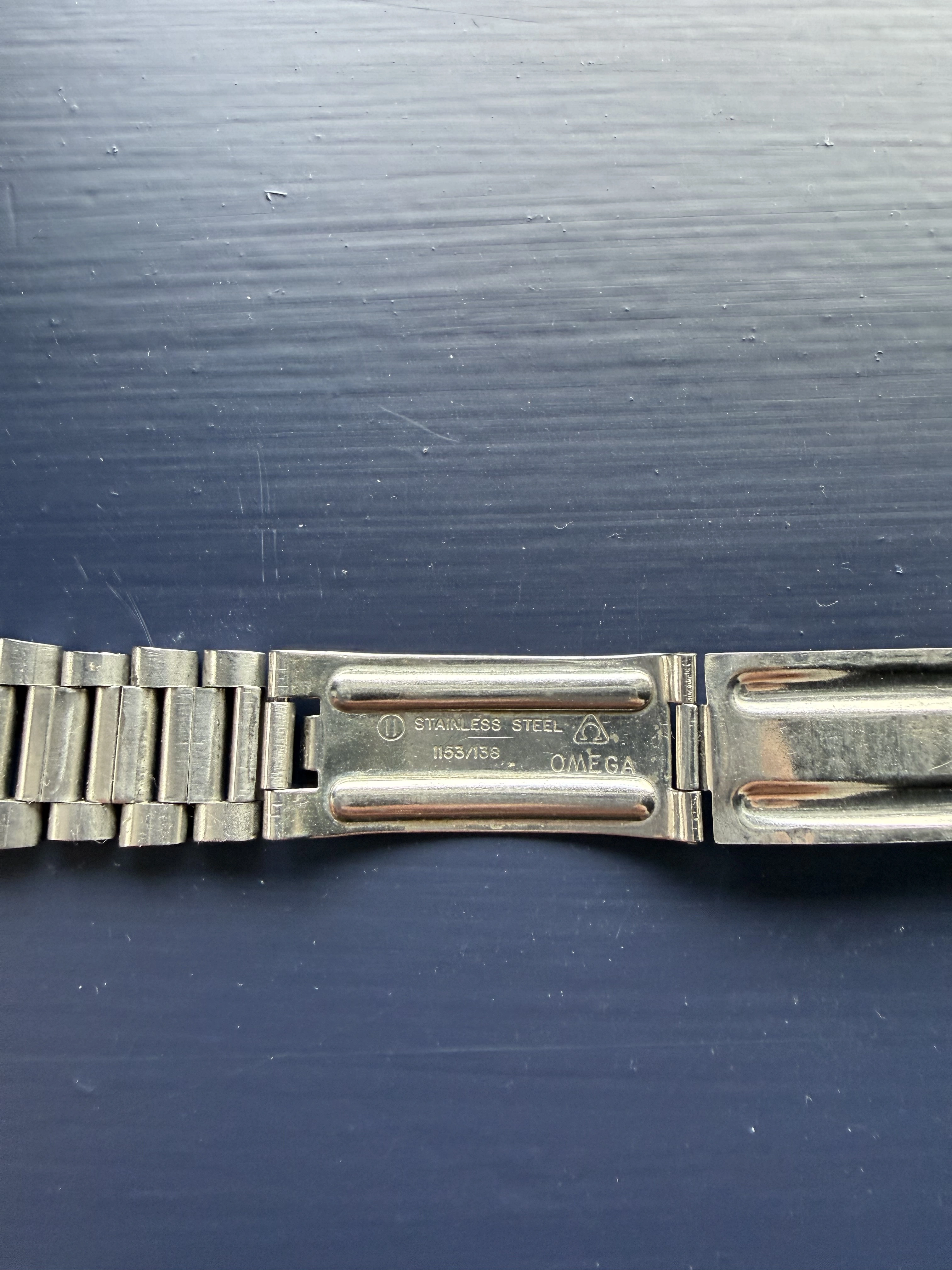

Posts 1,830 Likes 2,585 watchlovr ·Oct 9, 2025 Folks. Google is giving me different stories, could one of you give me a definitive answer. What watch is this bracelet for? 1153/138 (ammended) with 173 (20mm) ends Edited: Oct 9, 2025
Posts 875 Likes 3,684 rendo ·Oct 9, 2025·faux legend The number on the bracelet looks more like a 1153/138 to my eyes. From a quick search here, the 173 end-links fit the Speedmaster Mark II (145.014).
Posts 1,830 Likes 2,585 watchlovr ·Oct 9, 2025 rendo The number on the bracelet looks more like a 1153/138 to my eyes. From a quick search here, the 173 end-links fit the Speedmaster Mark II (145.014). You are correct, it is an 8 and that makes more sense. So a mk2 Speedie. Excellent, thank you.

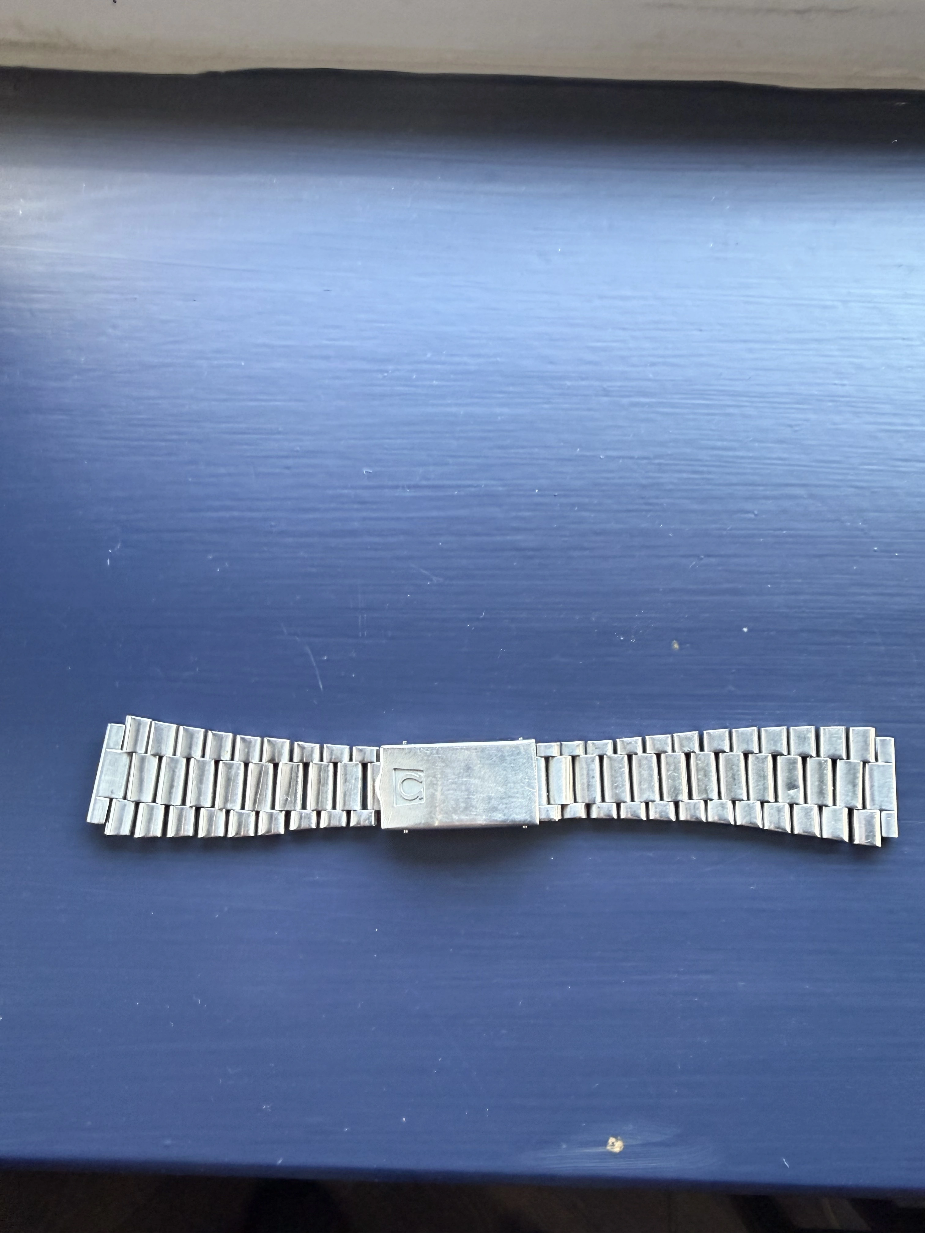

Posts 1,830 Likes 2,585 watchlovr ·Oct 9, 2025 flqt-9000 I have a correct spare clasp if you are interested Is the clasp not correct? It does look added.
Posts 1,104 Likes 1,706 flqt-9000 ·Oct 10, 2025 watchlovr Is the clasp not correct? It does look added. Based on my experience, the 1153/158 was a generic spare clasp
Posts 1,104 Likes 1,706 flqt-9000 ·Oct 10, 2025 watchlovr clasp I meant buckle, 1153/158 is a generic spare oke. The correct is the 1162
