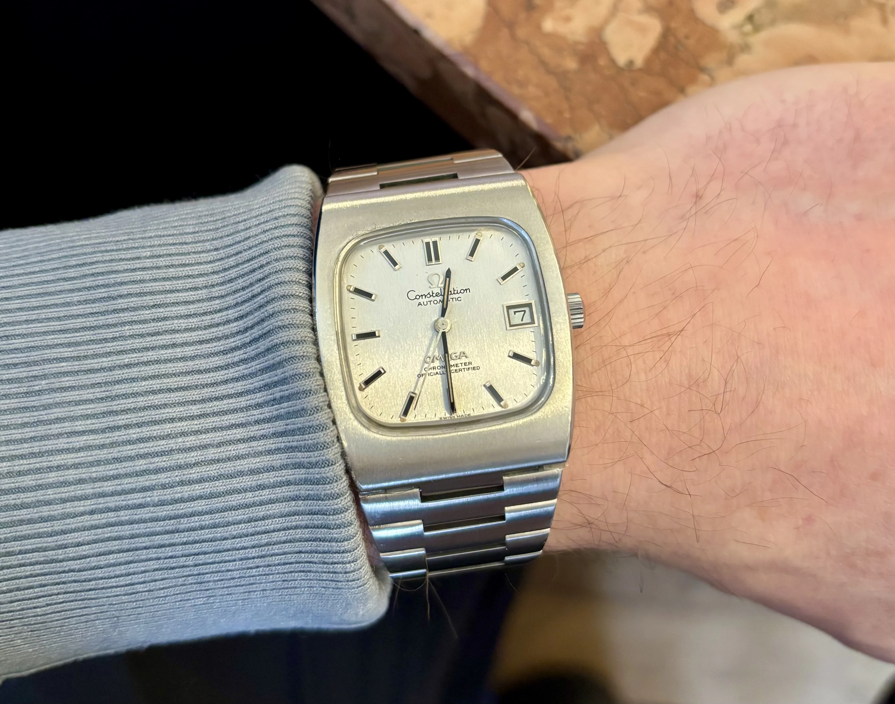

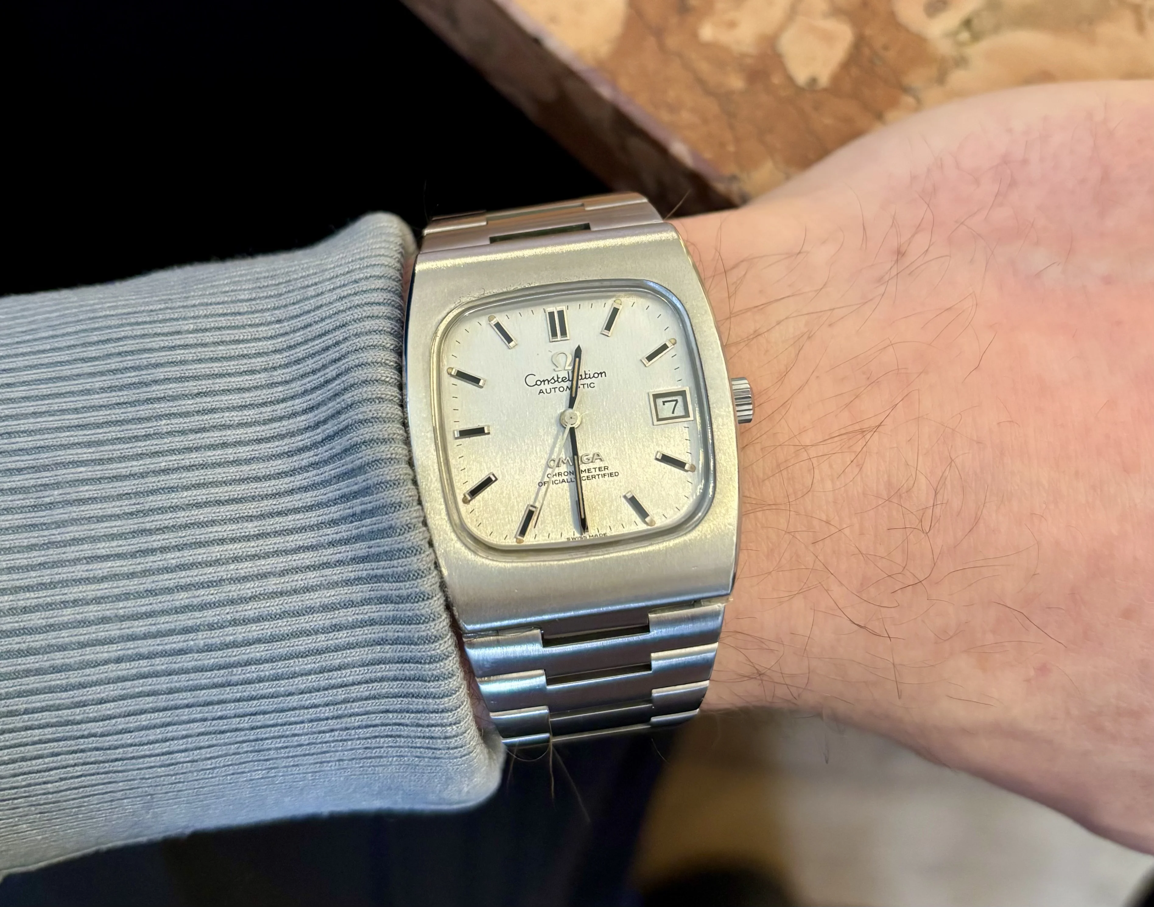

I own an Omega Constellation reference 168.0058 from 1972, which is an inherited piece.

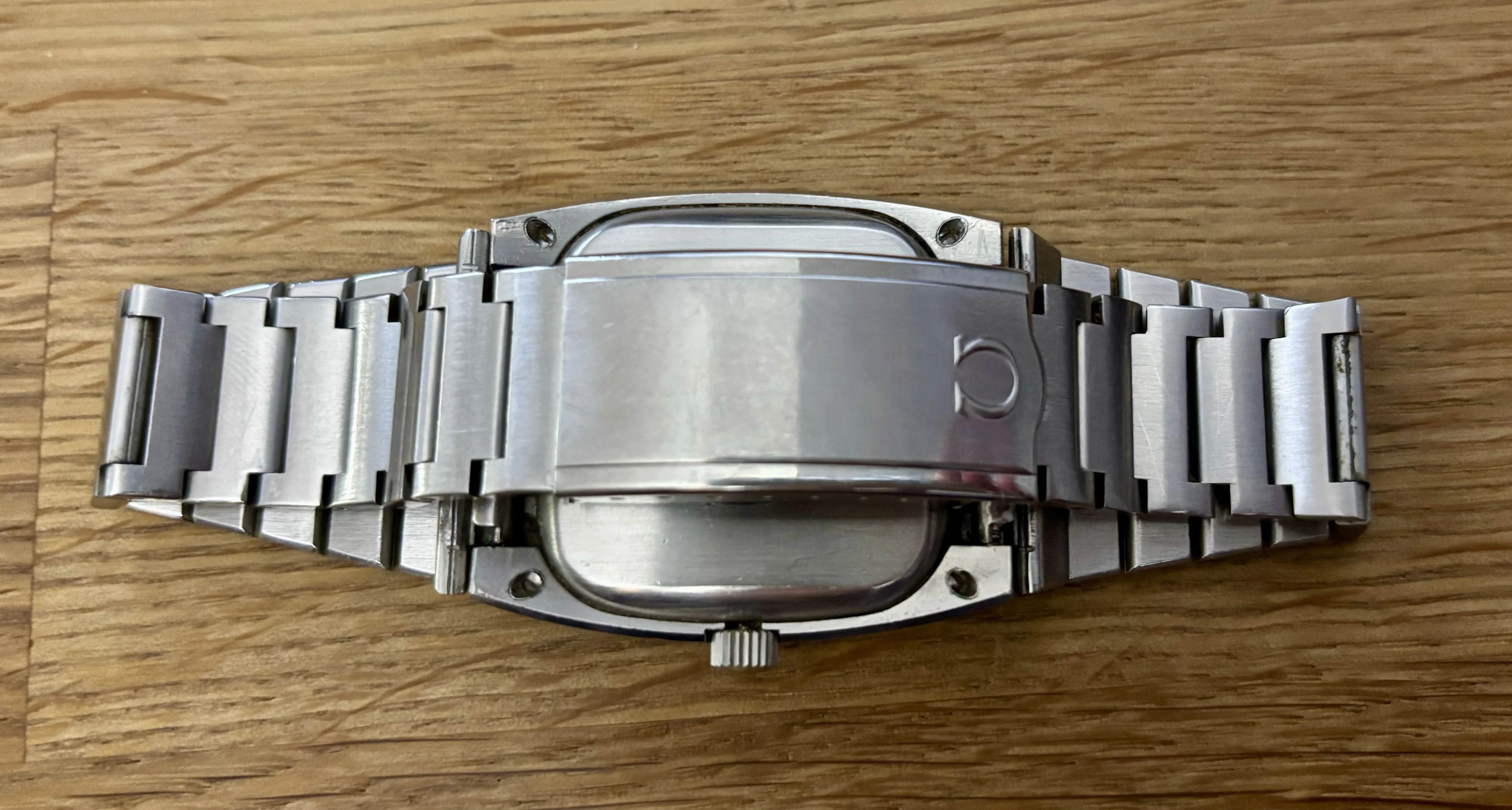

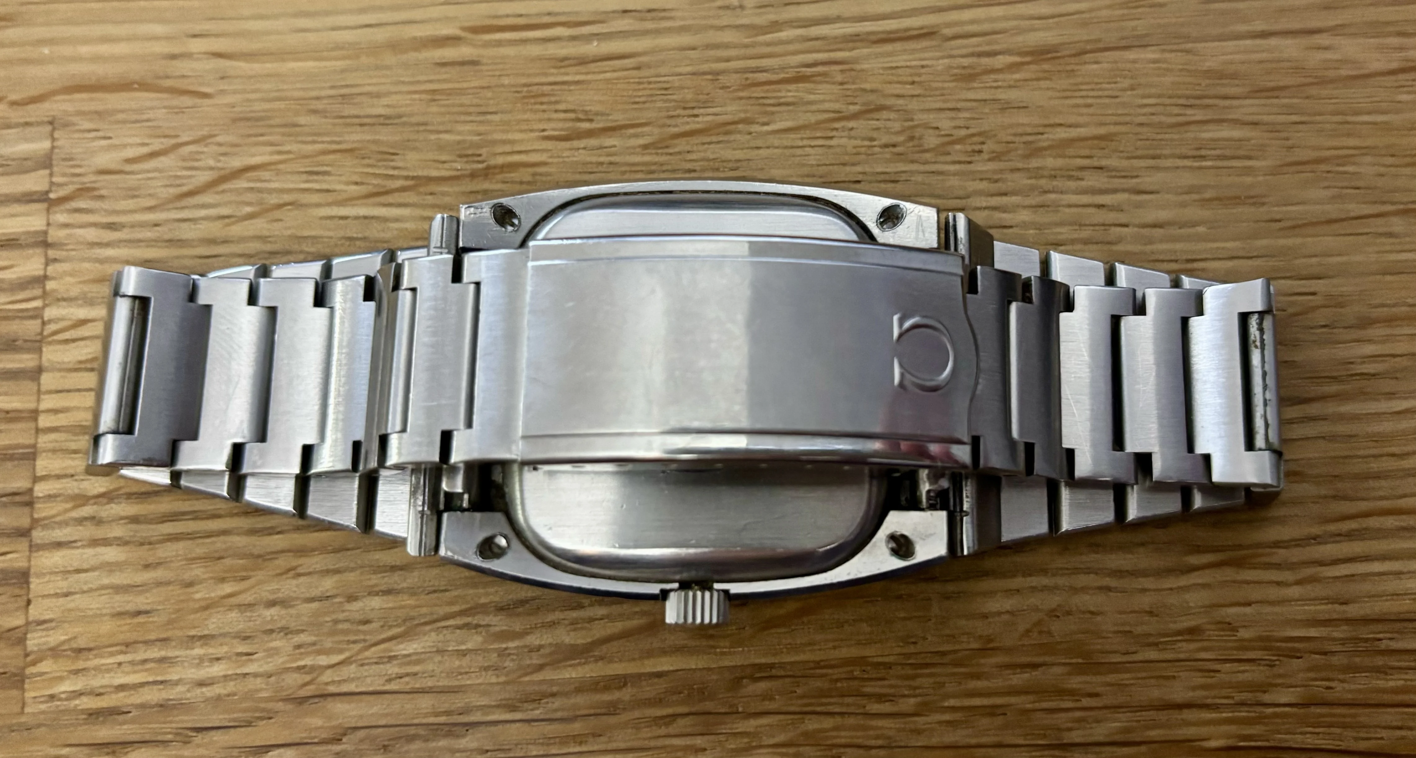

When I received this watch, it was fitted with a bracelet that fits well visually, but the lugs don't quite match the bracelet. The bracelet therefore tilts slightly. This is a) uncomfortable and b) leaves marks on the lugs.

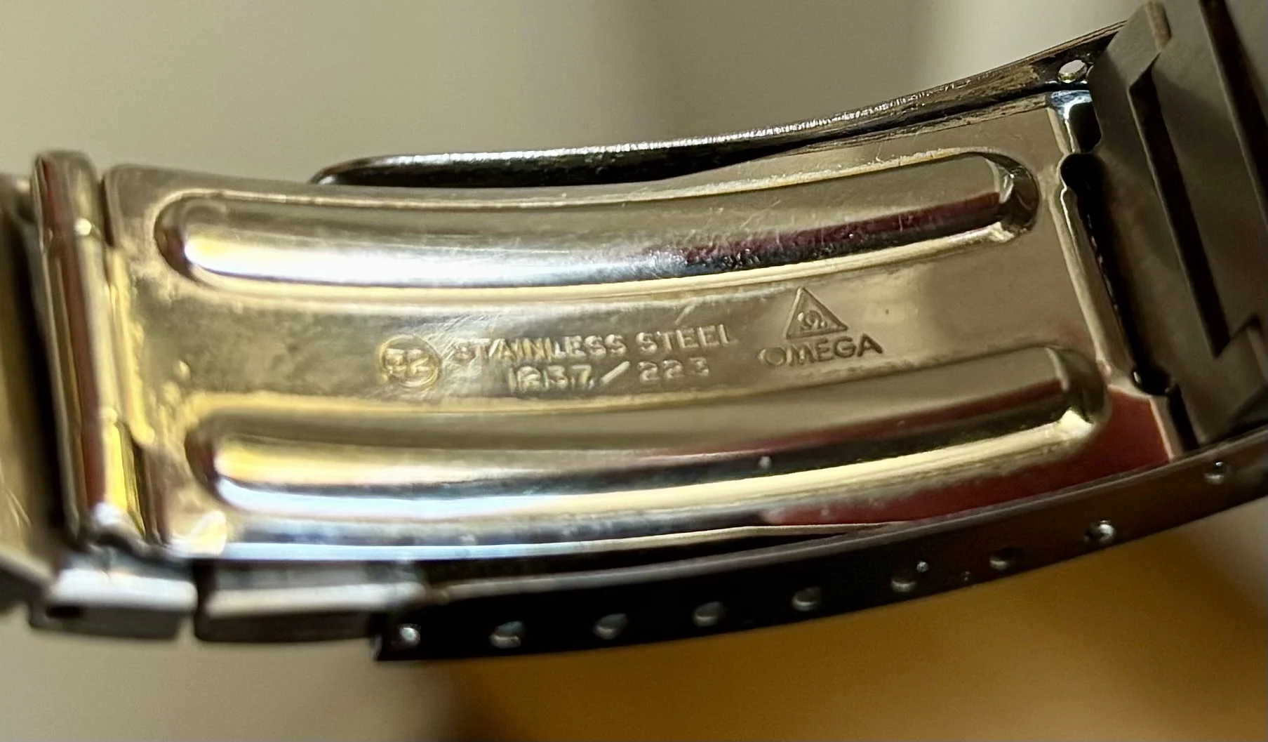

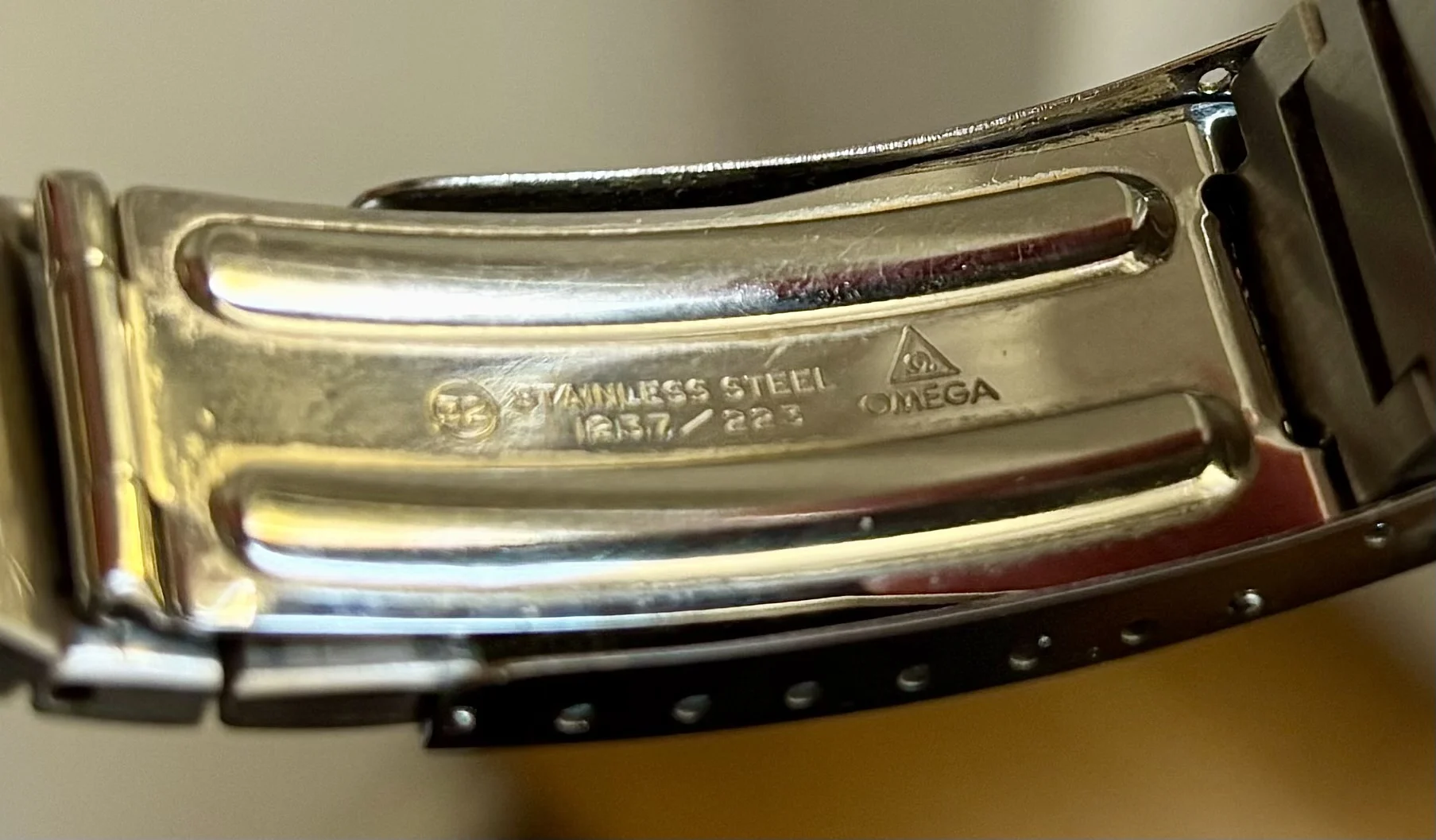

I have had the watch overhauled by an independent watchmaker so that it is now presentable again. The watchmaker pointed out to me that the bracelet halves are aftermarket and therefore do not fit the watch perfectly. The clasp, on the other hand, is original. The code on the clasp is 1237/223.
With this information, I went to Omega and was told that they could offer me a replacement bracelet with the reference O022ST1162172.
I believe that this bracelet will NOT fit the watch. According to my research, the strap O022ST1162172 has a lug width of 22mm. However, the watch has a lug width of 20mm. My assumption is that the clasp is original Omega, but did not originally belong to this watch. Omega probably determined the new bracelet reference based on the code on the clasp and therefore offered me the above bracelet. However, 22mm definitely does not fit this watch.

The watch after revision:
The bracelet and clasp:

The reference list indicates 1163 with 702 endlinks.
