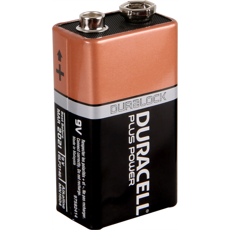

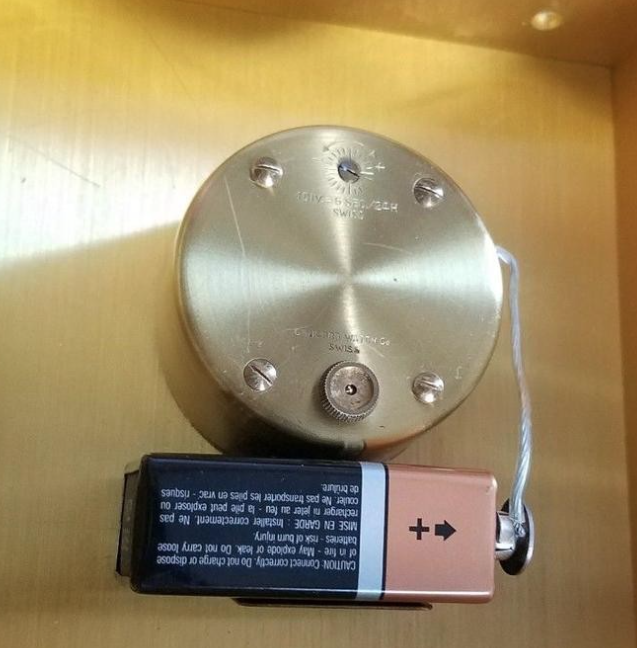

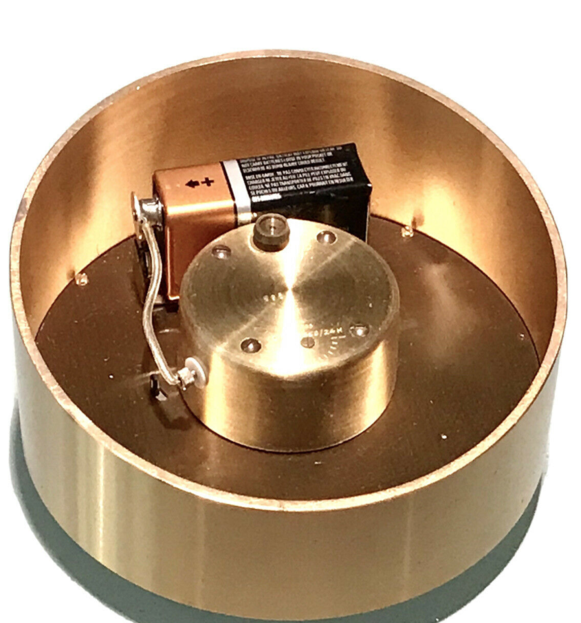

it uses a 9v standard cell

Yes the battery is just an "automatic recharging" of a mechanical movement.

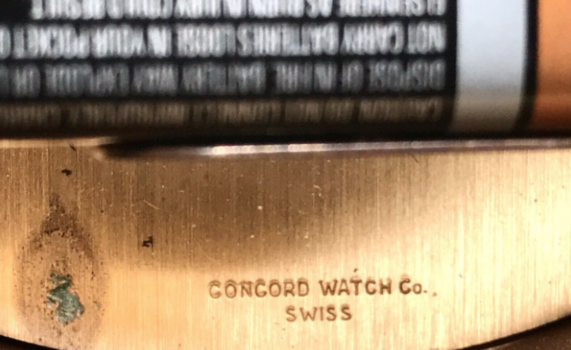

479
1,553

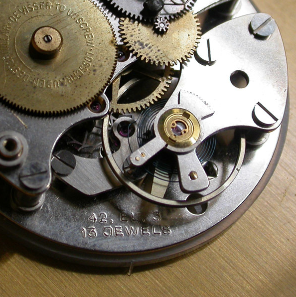

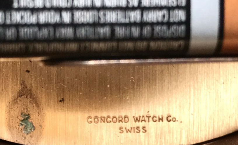

Pretty sure the movements are made by Concord Watch Company. There are a few non-omega examples out there.
Heres one on ebay now if you need an expensive donor: link
Another example:
EDIT:

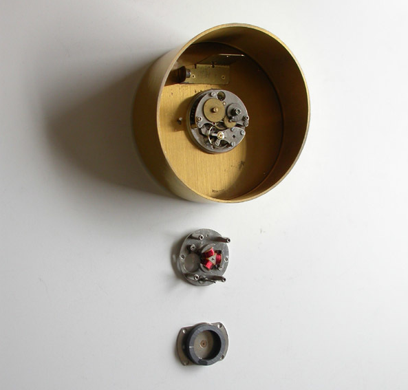

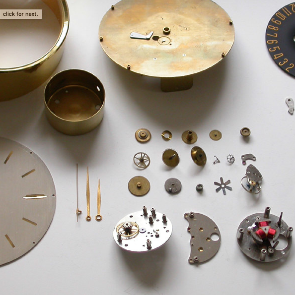

Here's a completed auction from yahoo Japan if you want to see one disassembled. HERE
Stamp on the movement makes it look like the caliber might be "42.EL.3" But who knows.

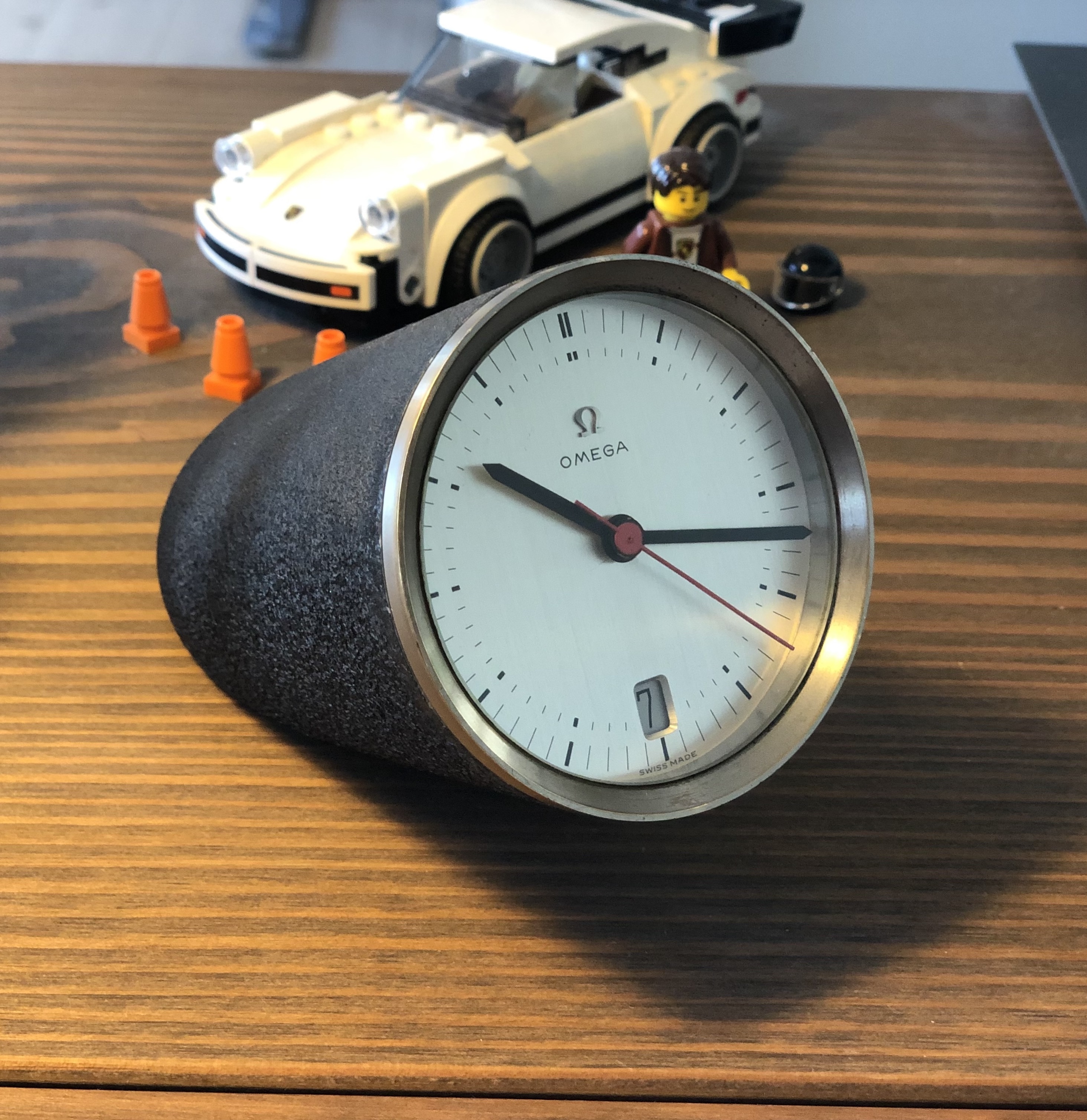

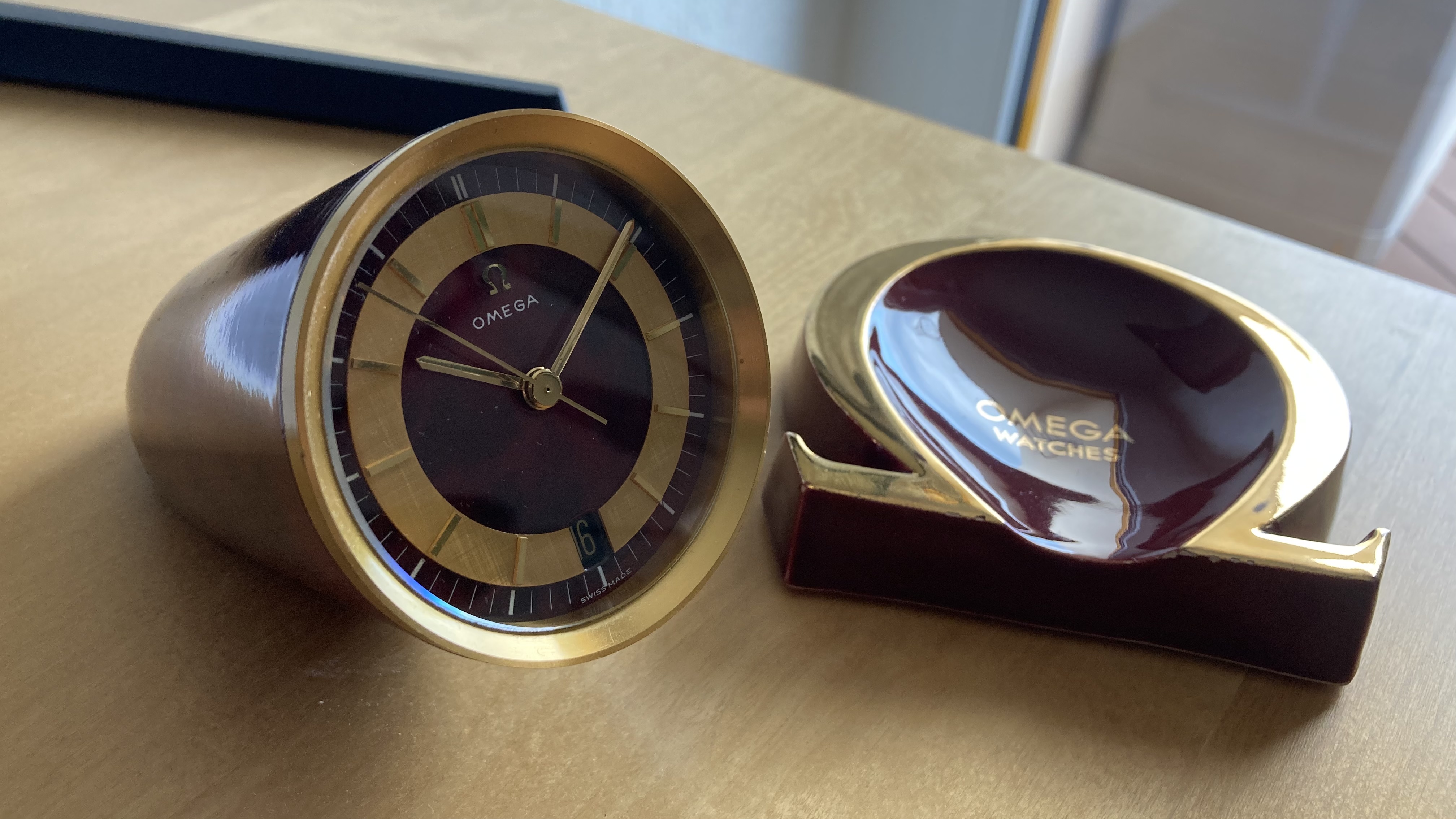

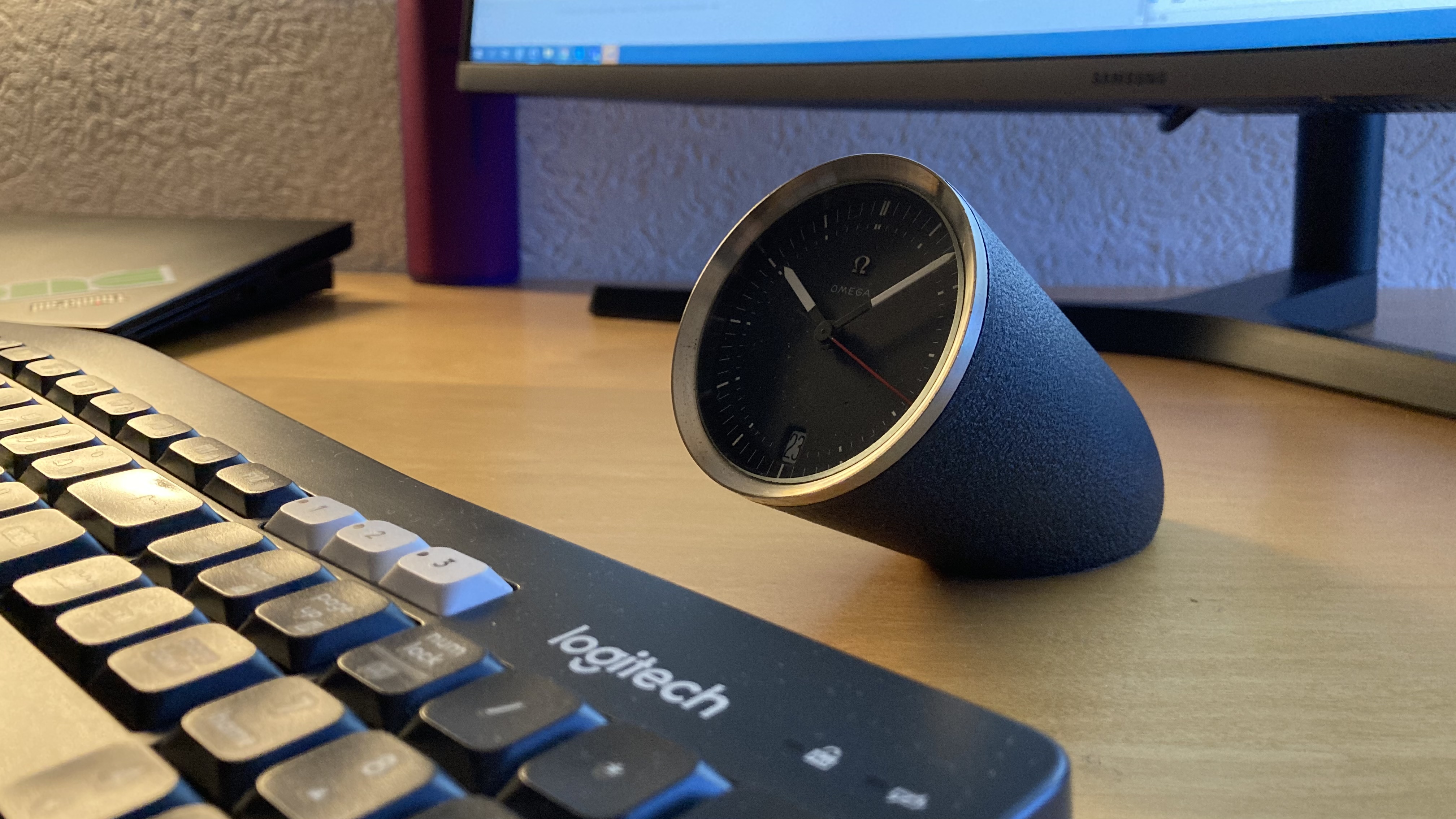

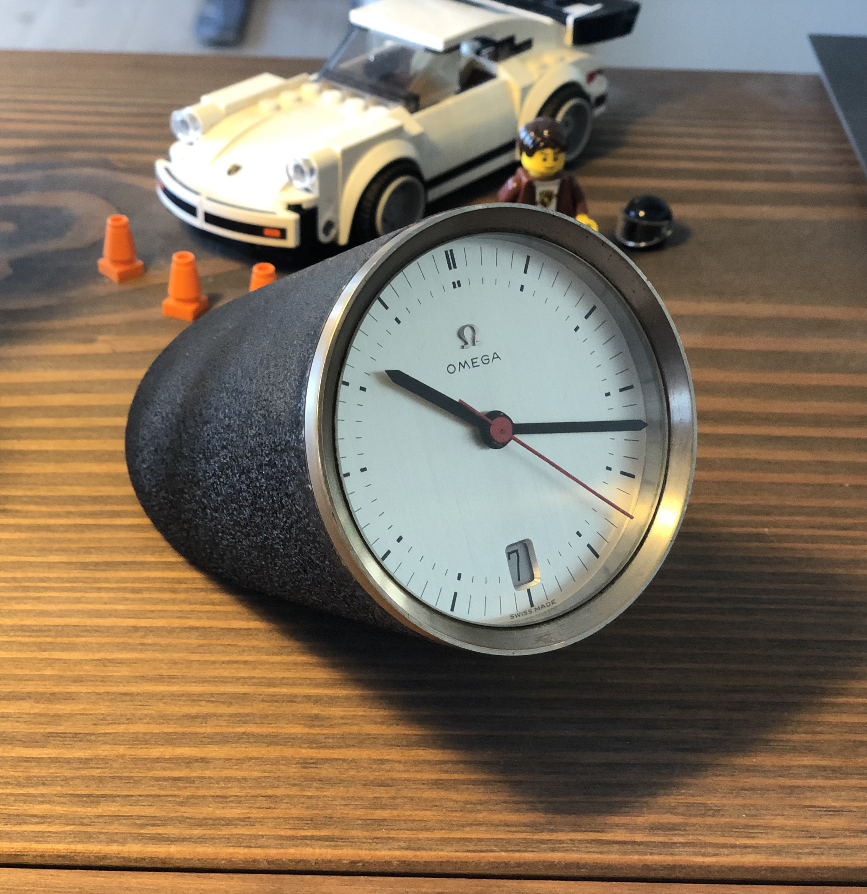

So I got myself a second 5556 ! Sadly the movement was replaced at some point by a "Made in Germany" Quartz (UTS ?)...pretty smartly done though since the date change is functional. Still looks the part and doesn't make a wuzzing sound every 20 minutes ;-)
I looked into getting a donor but might keep it like that now as a "beater" of sorts.
As a side note these "rockets" are seldom seen aren't they !
